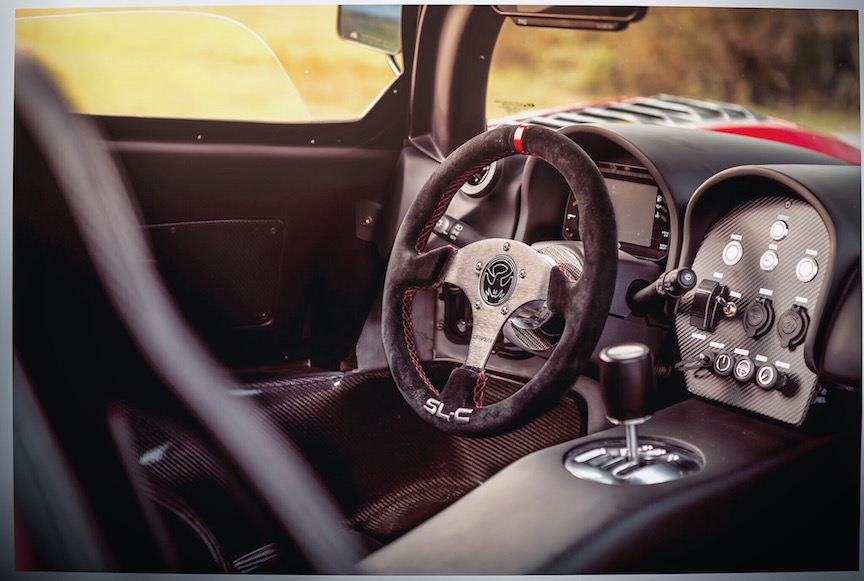

That is a good point. I have the carbon fibrer full interior tub with dropped floor pans and the Tillet B5 Carbon fiber M seats with 6point Oreca's.
The steering wheel is detachable and it can be released to make entry and exit easier, but I don't go through that.
