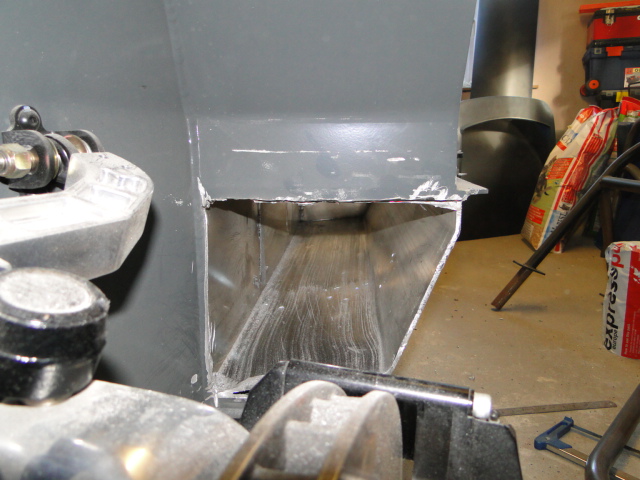

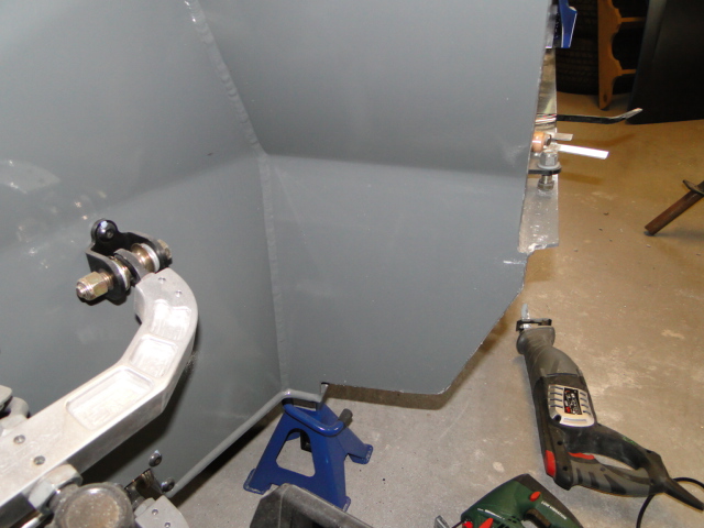

This is what i did
http://www.gt40s.com/forum/gt40-build-logs/24525-toms-rcr-40-trackracer-10.html#post246375
you also can see the water trap i built (not finished in that pic, but you get the idea)
Randy
to cover the gap between the buklhead and the opened NACA duct. I used this thick PP foil, sticked it all the way through the opened NACA duct to create a mould and covered it with glass from the front and backside of the bulkhead(picture just showing the glassing from the backside sorry)
TOM
