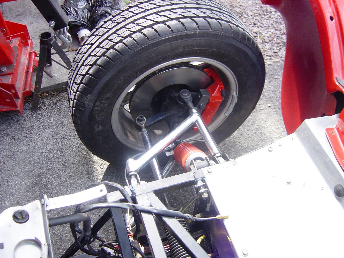

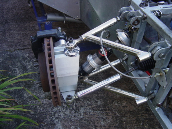

swapped mine to TVR Cerbera uprights came with discs and AP 4 pot calipers, a straight swap without modifying wishbones on my car which was based on a gtd setup. Have attached before and after I have bought a couple of pairs for @ £200 a pair with discs and calipers.
Forgot to say they are aluminium with steel top and bottom mounts which can easily be modified, hubs are Jeep easy to get bearings etc

Nice! Seems unlike the Granada MK2 still available new, about ~126/side (admittedly that's 'bare').
I presume the GTD was also Granada MK2 based? Looks like some TVR hubs are on my christmas list!

The TVR uprights have 291mm discs i think standard wheels were 16" but you may be able to squeeze 15"s over them there is some room around the caliper.
I used a spacer on the steering arm to raise it slightly they are lighter than the granada items.
hope this helps
