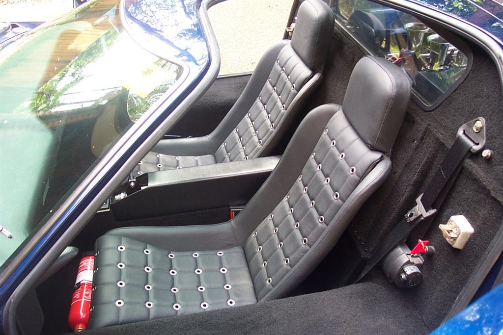

Finally some progress to report - throttle cable is now fixed (with a much shorter pedal travel - a bit more adjustment & should be able to heel & toe.
After chopping up the original DRB f/glass seat shells (narrowing, then widening again), I settled on a shape that worked for me. Off to the uphosterer, just a few more dollars, & viola - a set of seats that I am really happy with !
Next project is the door trims.

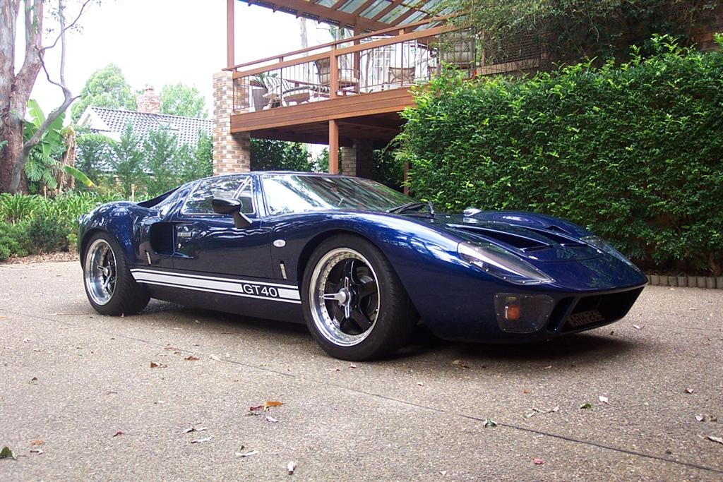

Thanks Jack & Paul - we are getting there !
Paul, the tyres are 235/45/17 Falkens up front on 8" rims & 275/40/17 Falkens on the rear on 10" rims.
Wheels are Simmons FR17's, fake knock-offs by DRB.
I reckon the front tyres are just right, but that the rears should be 285's or even 295's. Neither size is easy to find here in Oz, hence the 275's for the time being.
