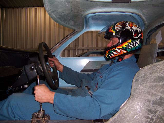

Hey Guys
Here's some pics of me sitting in the car.

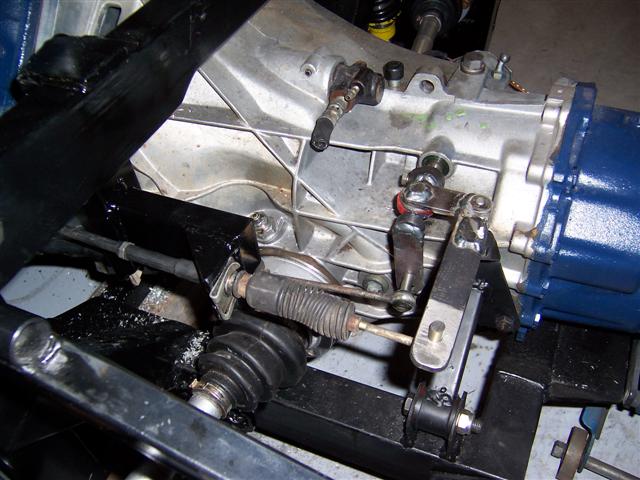

Fitted the shifter, ended up going centre shift using
a cable set-up. Works really well.
Peter - No real stories just knew from sitting in few standard
cars that I had to sit as low as possible. My previous Clubman 7
was only 75mm off the ground and I had no problems.

It looks like your tranny (and therefore presumably the engine) is hard mounted. Any reason why you're using cables as opposed to a stiffer tube / U-joint setup?
Chris
Dave's tranny mounts appear to have bushings at the frame bolt.
Hardmounting is a no-no.
Cable shifters are less costly, easier to install (especially on a center shift), and do not bind like rods can. For racing applications rods are probably
a bit quicker...but for most street applications a good cable shifter is fine.
Chris the gearbox is mounted using bushes. I went the cable option
because It seemed easier to make. The shifter is tight and the cables
just find their own way back to the gearbox. The other reason is you can change the shift ratios easily.

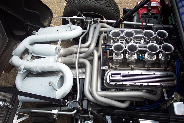

Hi Dave, I had to do the same thing with the exhausts - the "rego set" was all 2" pipe, CAT's, biggest mufflers that would fit, etc. I even had to shove 6 s/s pot-scubbers up the outlet pipes (held in place by 2 long, thin bolts at 90deg to eachother). And even then, we only just scraped through.
You might want to contact Pete (red DRB in QLD) - I know he used those multi-plate Super-Traps to quieten his down - maybe they are available for loan or rent (much cheaper than buying a set for a once-only use) !
For Version 2, I went with 2.5" pipes all round, smaller mufflers (SuperCats), & retained the original CAT's (there is an evil rumour circulating that they are in fact empty - now who would do that) !
For future Version 3, I am looking at Gonzo's (see pic) - pricey, but they look way better than the horrible loop-back setup I have, & I understand that they have an option which includes internal CAT's (spec sheet / receipt for same might be a useful bit of evidence if you are pulled over by any over-zealous boys in blue) !

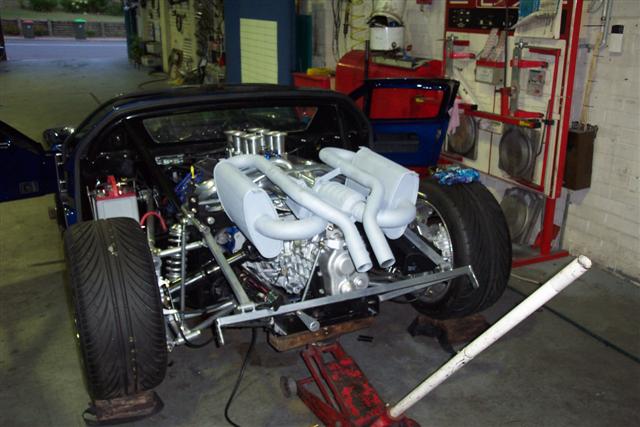

Dave - some pics of the "rego setup" (vertical mufflers), & Version 2 (horizontal mufflers) :
Kind Regards,
Peter D.

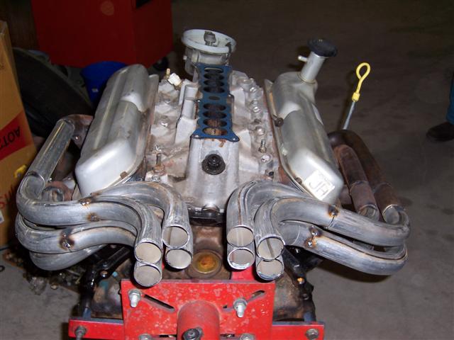

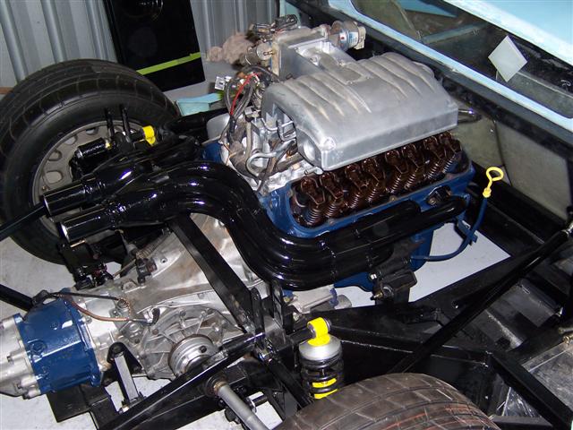

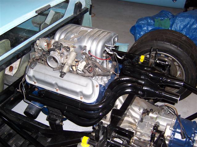

Thanks for pics Peter, I also need to make 2 sets of extractors aswell.
I have to go over the pits with the standard heads and the extractors
I want wont fit. So here are some pics of some extractors I chucked togethor
today, Will finish the collectors tomorrow and go with the 2 inch choker
set up. Anyone want a cheap set after I get back from the Rego?

Your intake manifold
Is that an EFI manifold or is it one of those Ford inline carb manifolds?
Just curious.
Thanks.
Doug
It's the base of the EFI manifold, We have to license our cars over here
with the standard unmodified motor.
Peter Delaney
Dave - that's a beautiful piece of pipe-work for something that was "knocked up today" - you have obviously missed your calling in life !!
What heads are you going to use (final) ? I have AFR 160's, & my headers fitted ok, both on the original 95 Mustang CI heads & the Alloy AFR's (even after the recent engine rebuild that involved minor block & head decking).

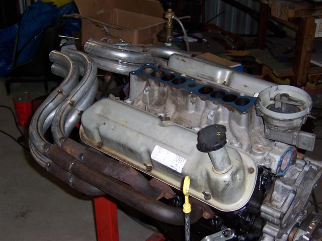

Well here is todays effort, Got the choker extractors painted and fitted.
Finished the collectors which drop down to 2inch outlet for my next job
which is the choker exhaust ( Rego & Engineering is APITA)
Peter - Charlie is a Shar-pei. The same dog thats on the toilet paper adds.
He eats like a King. I'm looking forward to licensing as then I can
build the real car. I'm not sure which to go with my motor as I have
had previous success turbo charging my clubman so am looking at
this at the moment which means I would need to fabricate turbo
headers.
