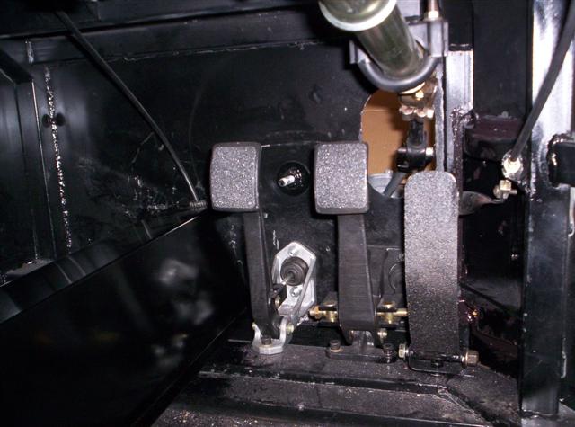

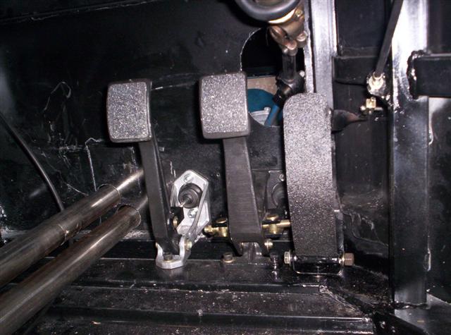

I thought that setting up the Acc pedal would be easy but it turned
out a bit tricky. Fitted a universal cable kit which all worked out well in the end. I've got another DRB GT40 to work on for a friend, He's bolting it togethor, I'm basically doing the fab work. Hopefully my rad will turn up
soon. Getting hold of front brake discs at a reasonable price is proving
to be a challenge.

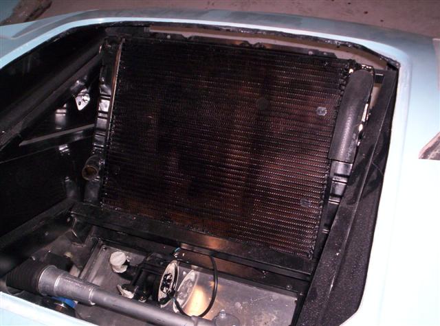

Hey All

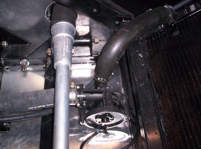

fitted radiator and electric water pump on the weekend.
Also plumbed rear brake and clutch bundy lines. The rad is
an Aussie desert Cooler job. Fitted thermo fan in front of
the radiator.

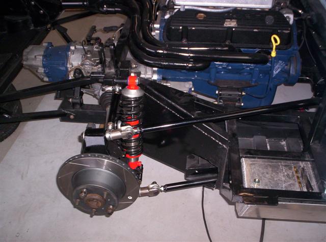

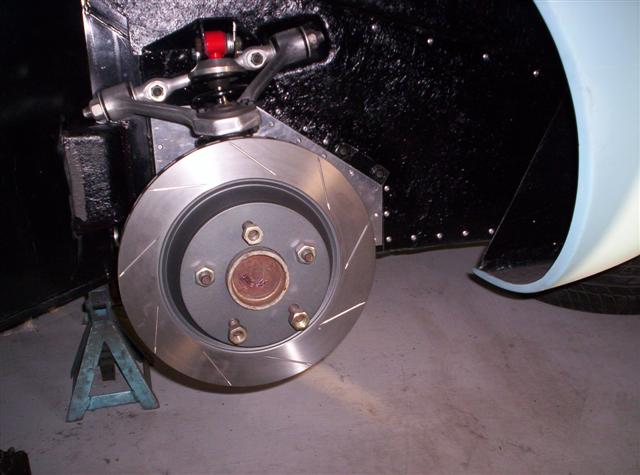

Re: Chassis #64 due in July

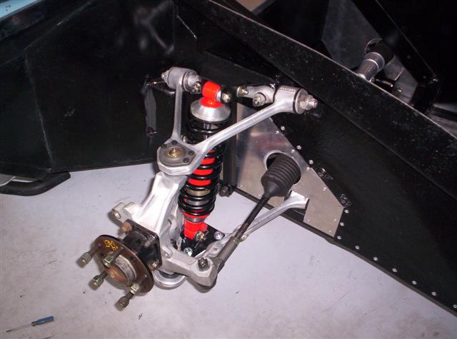

Not much progress happening as injured my finger with an exploding
grinding disc. My young bloke was kind enough to slide my front
rotors on.

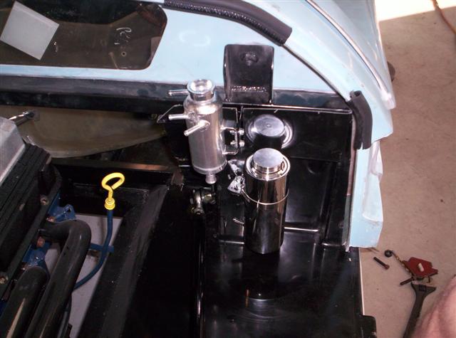

Fitted header tank and Overflow tanks today.
With all the other cooling system components fitted now I just need
to connect up hoses and that should be the cooling system finished.

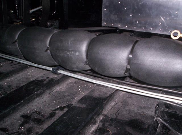

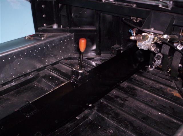

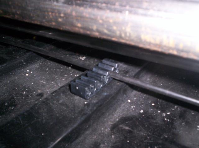

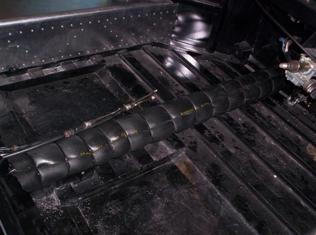

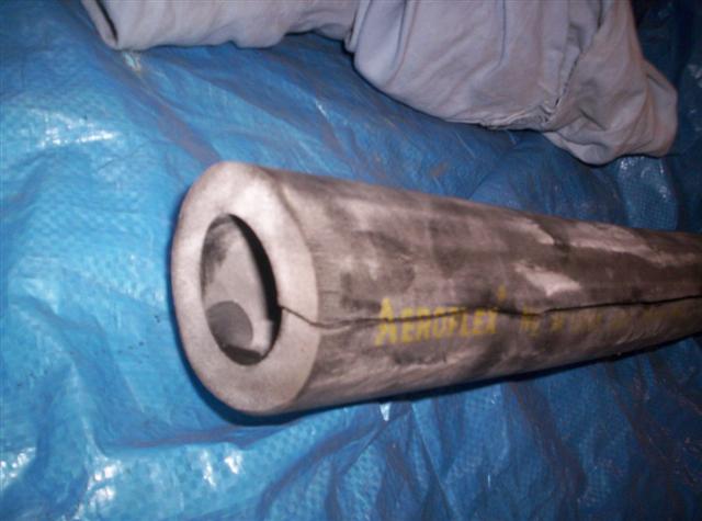

Sealed up the trans tunnel pipes with Aeroflex insulation hose today
and mounted trans tunnel for the final time, thanks to Flatchat for a lovely
gearstick knob. Gearshift feels good and positive (shifter is from a Corolla).

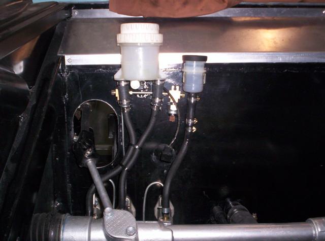

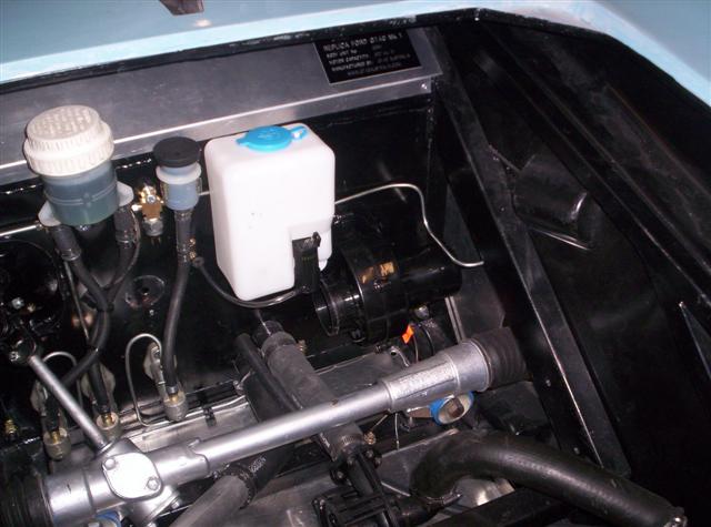

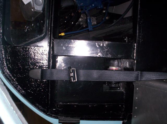

After spending a few days sorting out my clutch problems and
thanks again to Jim C for his help.I have fitted seat belts, Brake and Clutch
reseviors and plumbed the electric water pump in.

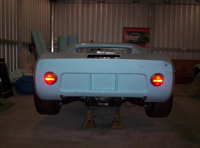

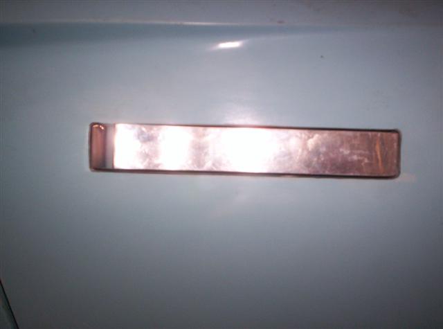

I think it's a milestone when you fit the Tail lights. DRB's door handles
fit perfectly in the door recesses. Just need to source some headlights now.

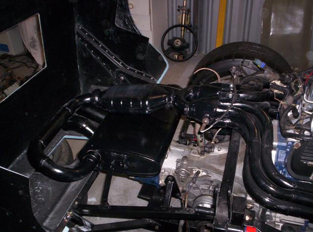

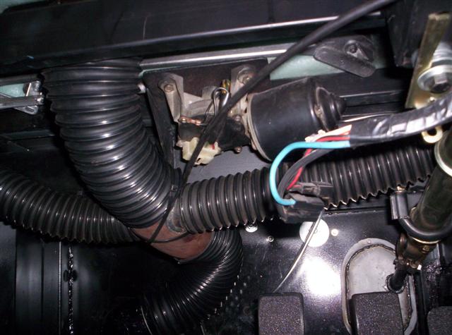

Fitted vent and demist system, hope I don't have to end up fitting A/c.
Finished my Registration Exhaust system which is hopefully as quiet and
restrictive as it looks. What a waist of money and time.

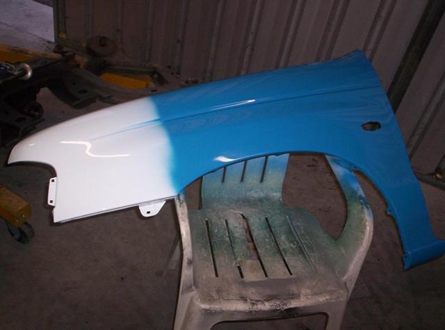

I think this is my final colour choice, The blue is a ford colour called
Bionic, I'm planning to add two wide white stripes and side white stripes.

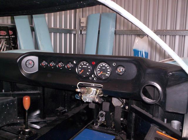

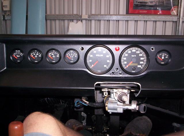

Got the horn unit fitted today and finally plucked up the courage to cut
the holes in dash. All worked out well and I am very happy with the finish.
Just need to get hold of few indicator lights and that should be the dash done.
I'm thinking of mounting fan and associated switches on the centre consul
as I like the uncluttered look of the dash.

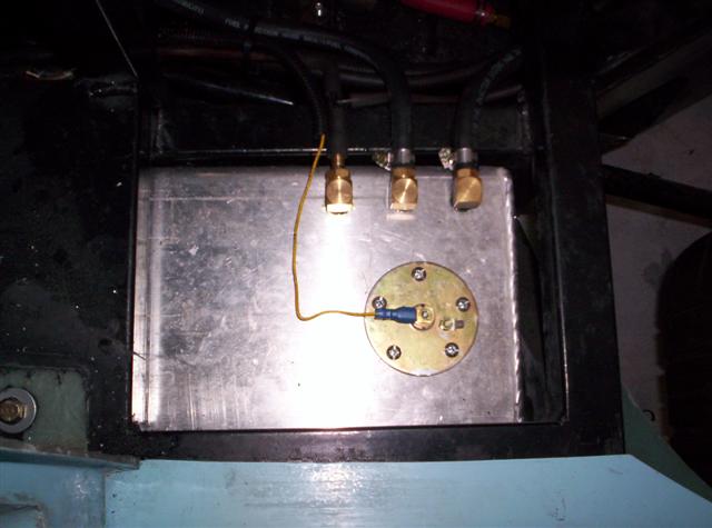

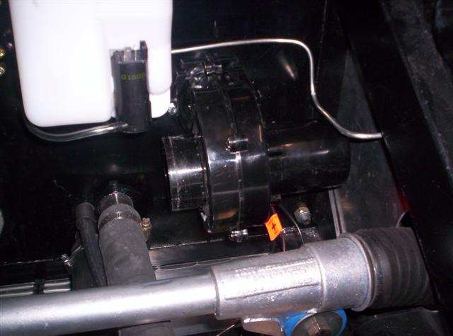

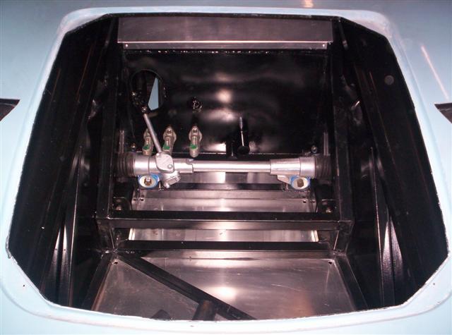

Still plumbing stuff, Fitted fuel sender and fuel pickups.
Fitted charcoal cannister and other ADR crap.:dead: :dead:
Can start engine with key now:pepper: . Hoping to have car driving
and lic late Jan. Decided to buy PR's GT40 headlight kit instead
of using those narrow cheap headlights you can buy.
I must say that the DRB GT40 goes togethor very easy.:D
