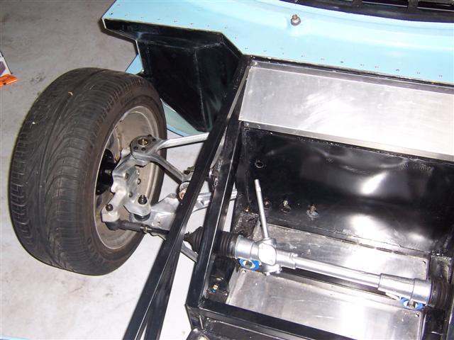

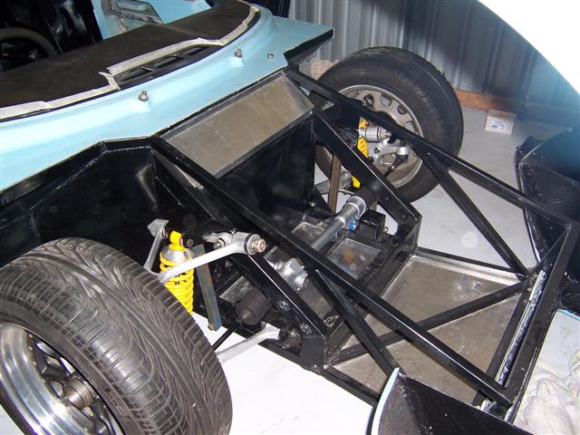

Well today I got the front arms cleaned and pressed in new poly bushes.
Also fitted a new set of balljoints from Ecklers aswell. Re- threaded the
steering rack and fitted it. Almost got the lower shock mounts finished
and I am going to make new upper shocks mounts, More like the old style
DRB items welded to the chassis.

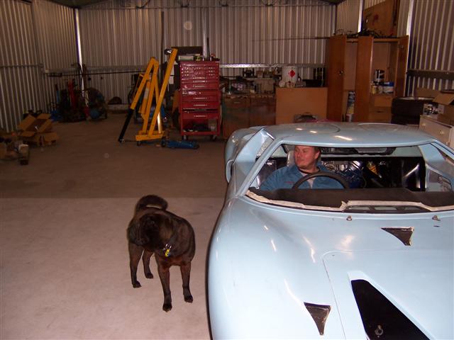

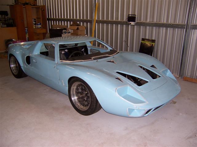

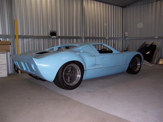

Anyway here is todays progress, I finally got the car on it's wheels
and rolled back and forth. I am just building a rego special at the moment and
it does get me down sometimes as you basically have to build 2 cars.

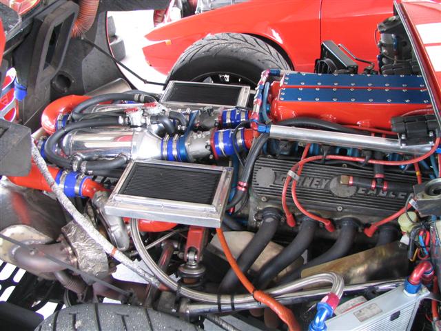

Craig here's a pic of Cossi's turbo GT40. I've seen it at Wanneroo a few times.

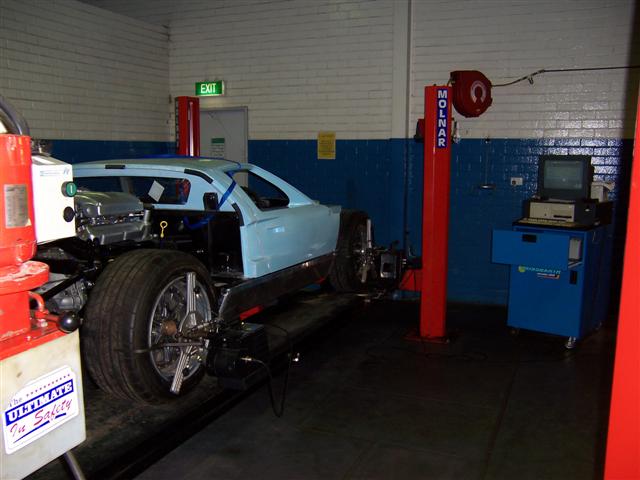

Well I hit the wheel aligner at work today and found that the DRB GT40 is
a very well set up car that only required marginal changes to get the wheel
alignment correct. With 0.02 minutes of geometrical driving axis (thrust)
the car should drive as straight as they get and shows that DRB has a very
square jig they build their cars on.
My intial settings to start from are the following
FRONT
Spring rate 200 pounds per inch
Camber 2.2 degrees negative
Caster 4.3 degrees positve
Toe total 1mm toe in
REAR
Spring rate 350 pounds per inch
Camber 1 degree negative
Caster 3.5 degrees positive
Geometrical driving axis 0.02 degrees positive
Setback front .01 degrees /rear 0.03 degrees.
Kingpin inclination +28.01 degrees
I'm hoping the car will have enough caster so the steering wheel will
self centre ok. I have also graphed the bumpsteer patterns for front and
rear over the full suspension travel. Looking forward to driving this beast.

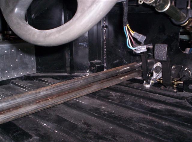

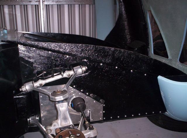

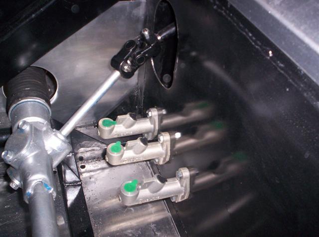

Got the camera working, GT40s OZ cut the alloy panels out and even
mark where the holes have to be drilled for you (how easy). Fitted the master cylinders, also fitted the centre coolant pipes. They are suposed to be
stainless but I'm thinking the guy at the exhaust shop stooged me.
Ordered my radiator, settled on an Aussie desert cooler's triple core/triple
flow copper item.
