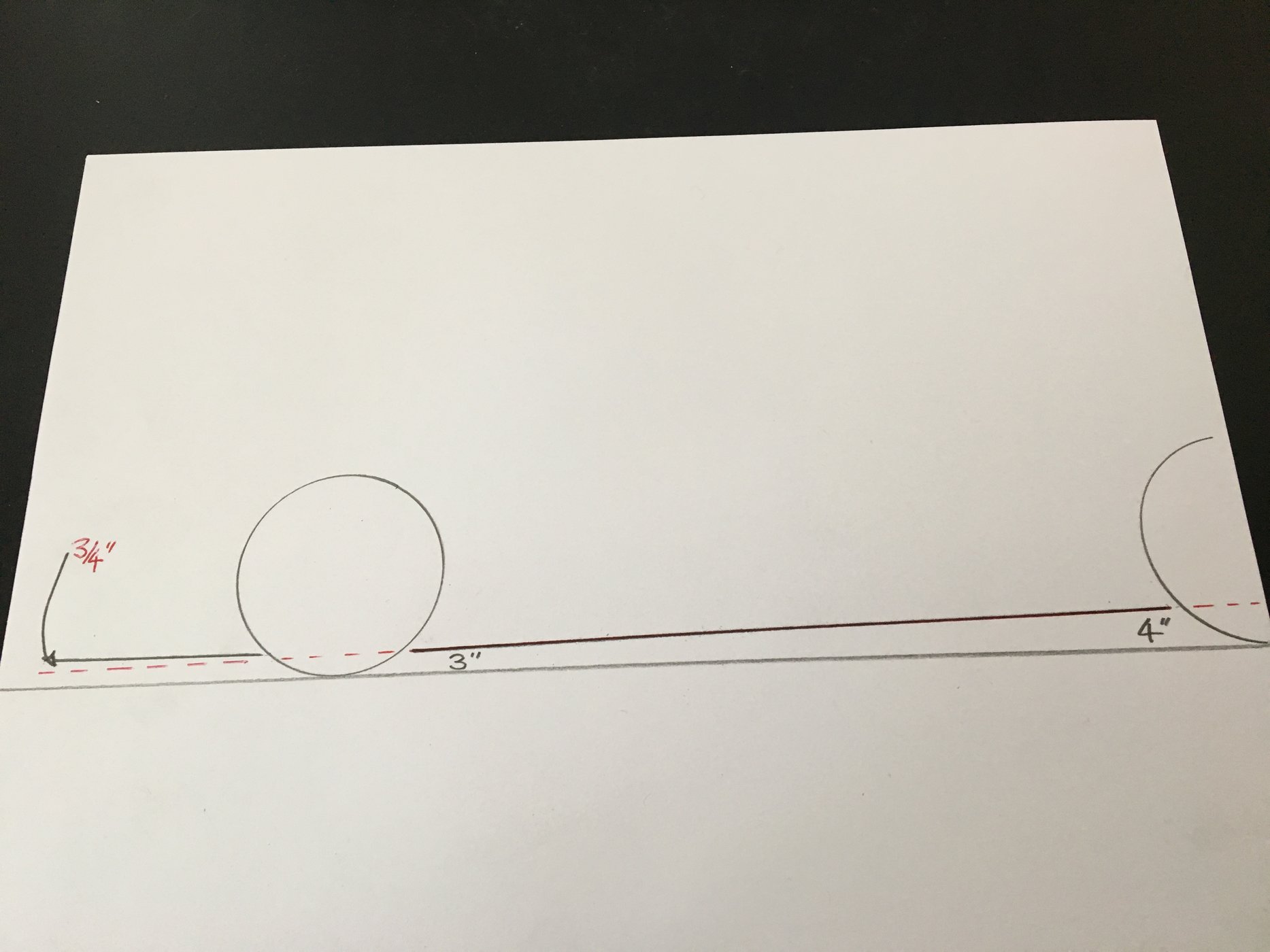

H just curious about raising the front spoiler I assume you gain 3/4 of an inch overall when completed but if you have the hydraulic lift kit does it even make sense to do this work I guess personal preference
If you don't raise the splitter then then you can't drop the front where it belongs and the rake is wrong from front to back, looks funky.
No Idea where you got the 3/4" from, more like 1 1/2" the leading edge of the splitter needs to be about 3/4" above the flat plain of the bottom of the car
iirc in the post with the modifications for the splitter, you mentioned that when you mold the aft end, you raise the front 3/4" sot hat when the car is at ride height, it will be level. followed by having to cut the front valance by 1 1/2" to make the nose fit nicely onto the newly positioned splitter.
I am not saying that you have to do any of this stuff to the front end, merely passing along what I did for the look that I wanted. You have to bear in mind that in order to run the ride height/stance that I wanted I also changed out the top ball joint and steering rod end to high angle ones from "Speedway" so as not to neck out the joints, all of this has been said before on either my build, Jareds or Steves, they have all had pretty much the same treatment.
What I've posted here is what I did, hopefully it will inspire others but in now way has to be done, each to their own.
