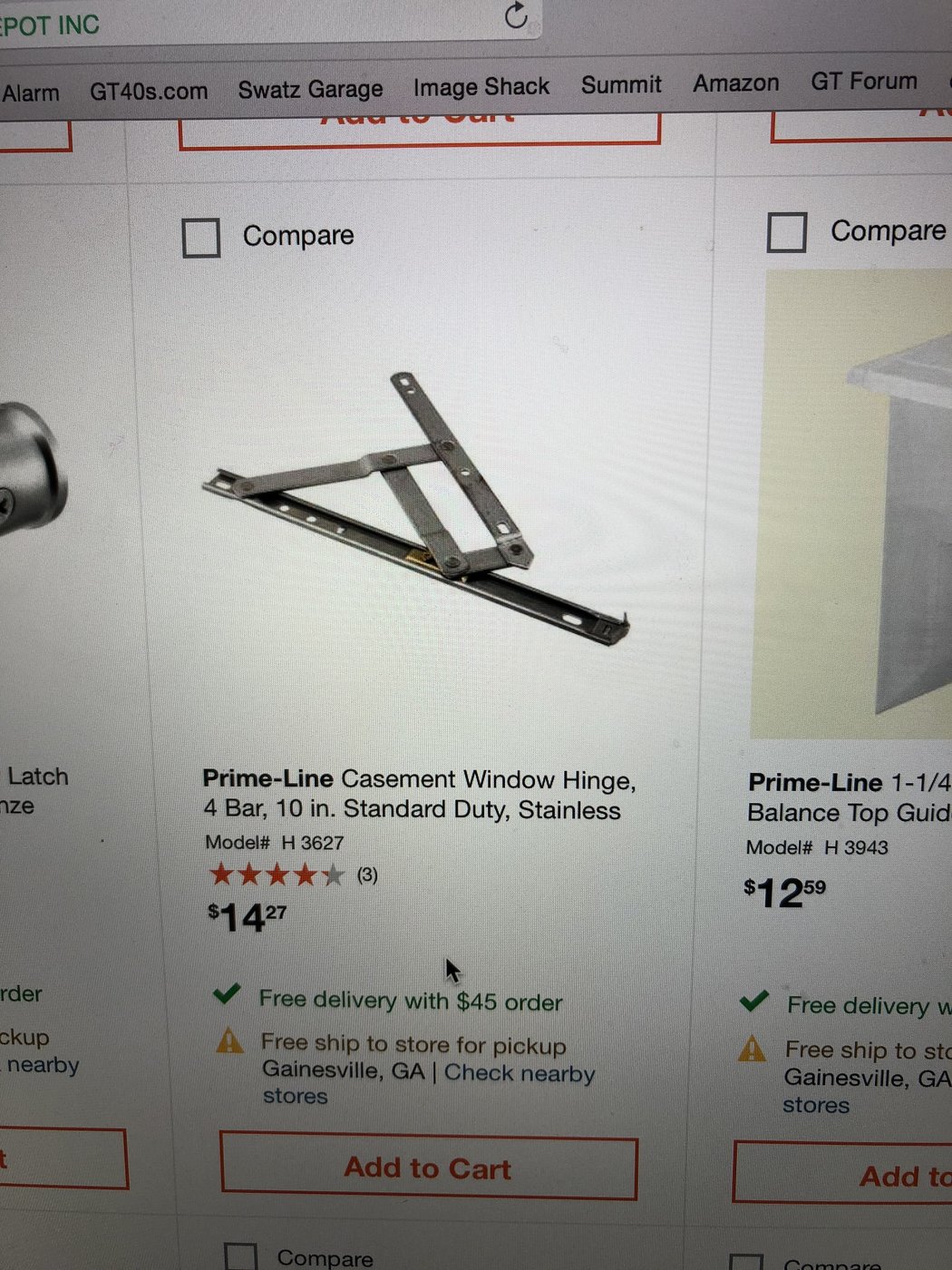

Question: what did you use as the hinge for the trunk? also what latches did you use for both the trunk and engine cover? I am assuming that you had a bunch of GT parts laying around and used them so am wondering if you have any suggestions for alternatives.

On Jared's car I used a set of window hinges like used on a plastic windows, you can get them from the Depot.

I would have never thought of using window hinges. So simple, yet so effective! As for the Aero Latches, I am not as fan of them in this context as it screams "kit car" in a loud obnoxious voice. I will keep researching things and hopefully will come up with a solution.

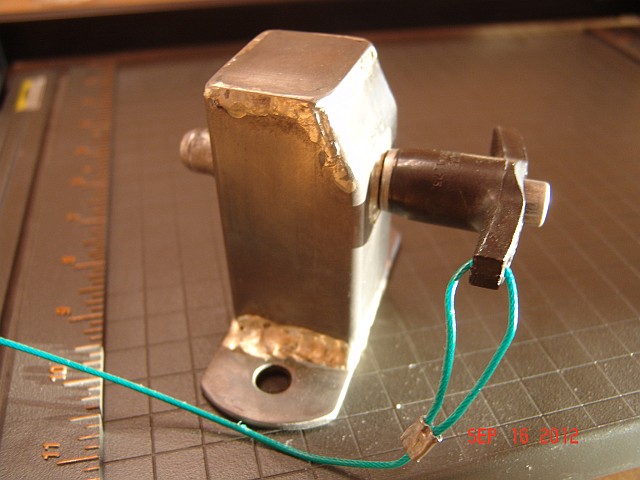

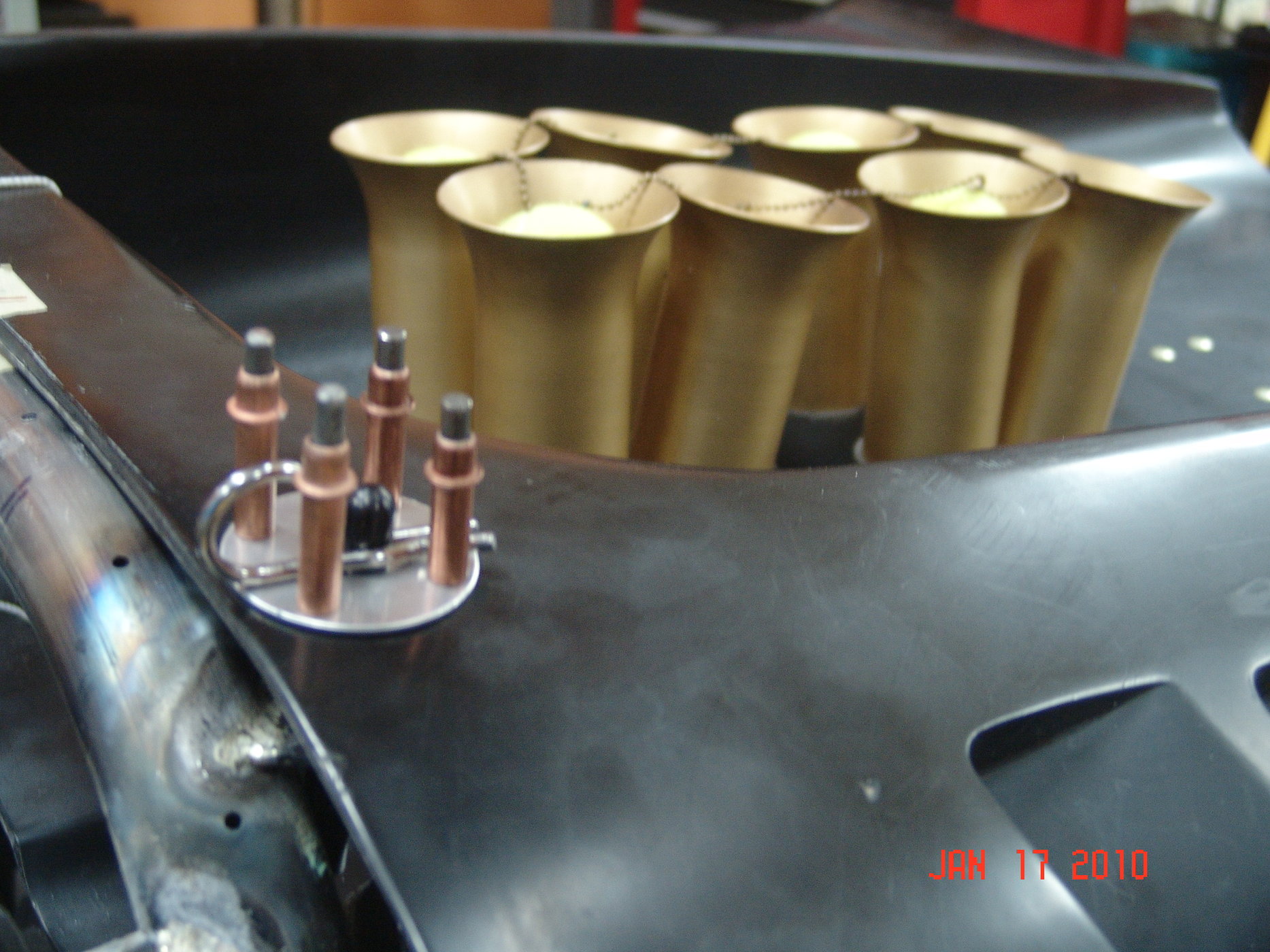

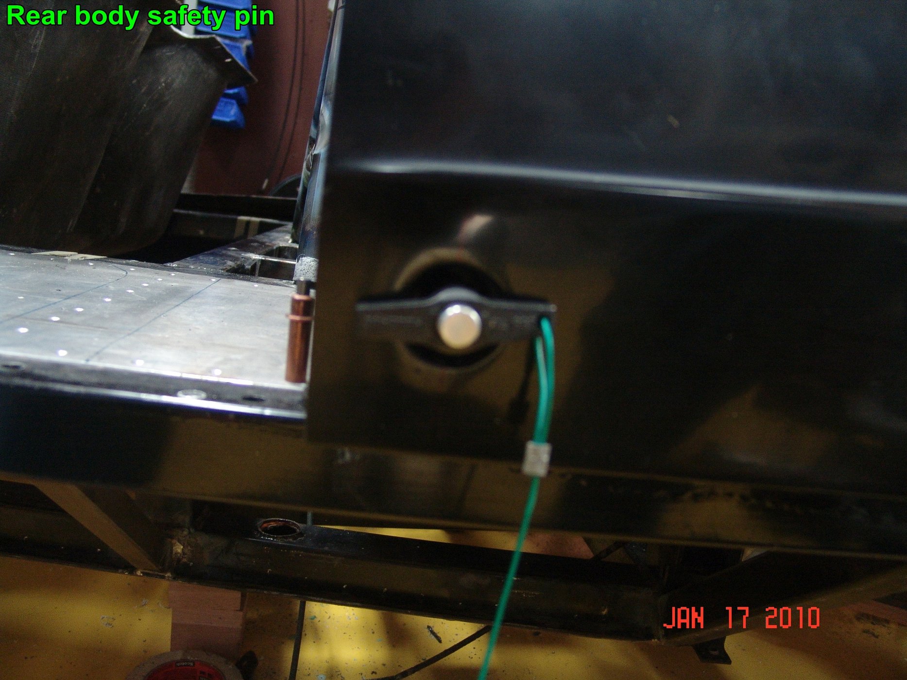

Pierre;
The rear body on my car (not a GT40) is secured with a 1/2" ball-lock pin on either side. In addition there are two hair pin-type hold-downs. That photo was taken when I had it temporarily secured by Clecos. These make a very secure system for holding the body in place.
