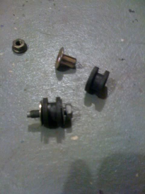

Ladies and gentlemen, I've been looking for the part in the photo, but am coming up empty handed. It would be used to isolate my radiator from the chassis.
It's like a rubber grommet with two metal bushings (inserted in each side of the grommet) and a threaded screw through it.
They may be used for vibration reduction, or some other application. However, I've seen them used for radiators.
A link to the item, or an alternative would be appreciated. Not my photo, and I couldn't find any useful information related to it.
If you're using it to isolate the radiator, just put some 1/8'' silicone (not rtv silicone, but silicone sheet) between the aluminum side tabs and the mounting tabs on the radiator. Then put somemore silicone underneath the rad (to kinda block air flow and give it something to rest on), and a nylon washer underneath the nut. Easy peasy.

Hi Ben
I think if you check you will find these used in lots of models and brands to mount the motors for the windscreen wiper motors.
Dimi

Thanks Jim. I'll go to the local Toyota stealership and see what I can come up with.
I've looked through the items at McMaster Carr, but didn't find anything that tripped my trigger. Thanks for the suggestion though.
Alex, what about the bolts that go through the chassis support and the tabs on the radiator?
Thanks Dimi. I'll also investigate wiper motor mounts. I appreciate the tip.
I would just use nylon washers underneath the bolt head/nut and call it a day. You're never going to get rid of everything.
I've made them in the past with; 1/4" id tubing,5/16" fuel line, rubber gasket material, a couple of fender washers and 1/4- 20 bolts not threaded all the way
