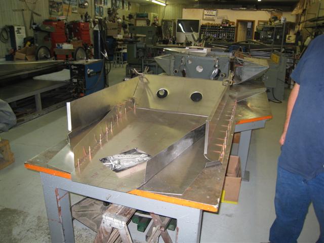

Made a trek down to North Carolina to Kenny Thompson's shop.
One of the projects that he is working on is a duplicate of the chassis of the Honker II, the Paul Newman sponsored, Mario Andretti driven CanAm car.... one of the prettiest race cars of the era.
Jim

The original Honker tub was made in England and, according to Kenny, utilizes different guage aluminium than what is/was used here.

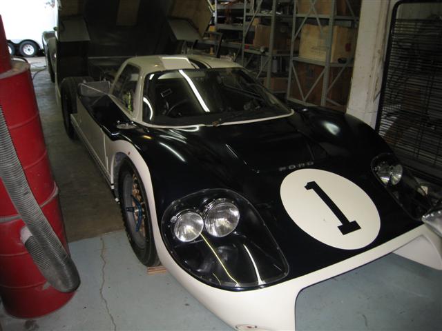

...and over in the corner was Ken's "J" car recreation. He fired it up and due to the different (non 180 degree) exhaust, sounded more like a Cobra than a GT40 MKIV.

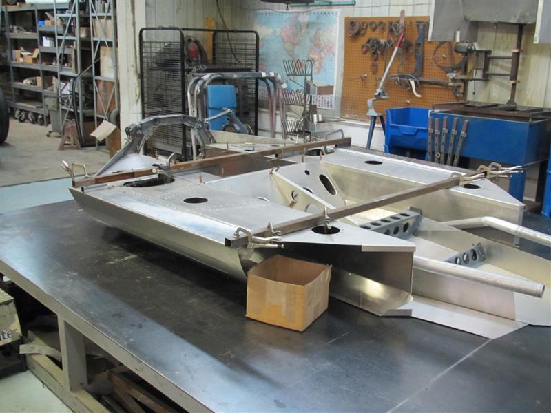

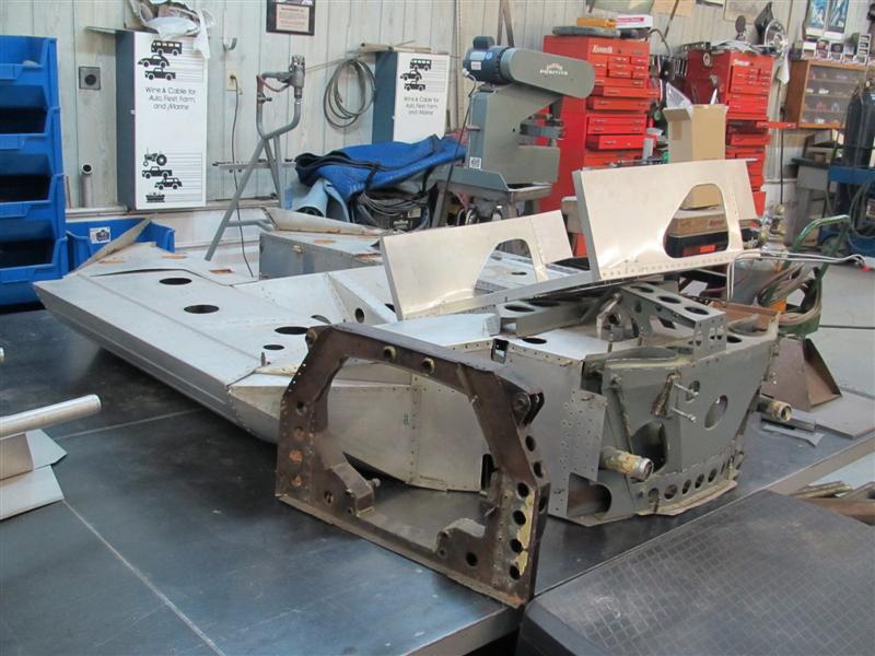

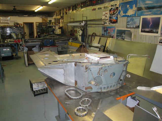

Back down at Kenny Thompson's recently. Here are some photos on the progress he;s made on the Honker II chassis.
First the original and then the recreation. Not the work on the rear "halo". On the original, te top piece is not removable. Kenny has faricated the new piece with an upper removable section much like the GT40 so that the motor and trans/dif (here a Hewland) can be reoved in one unit.
Beautiful work.
