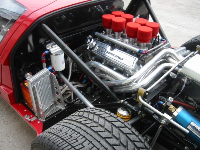

Can anyone advise /suggest a filter for the stack pipes that do not cut HP and look good? I started with these,
they look crap but work well.

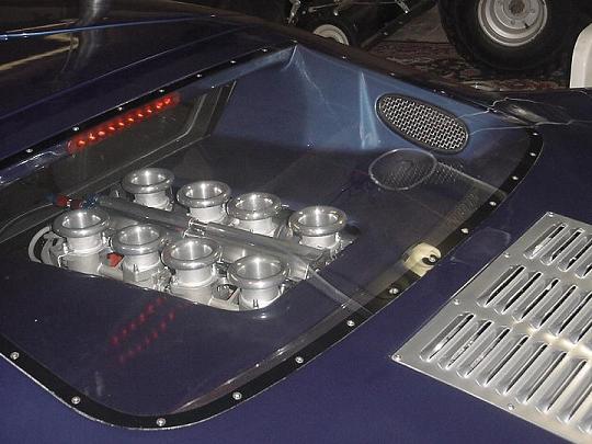

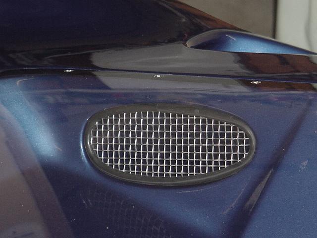

I made my own filters from 3 layers of household A/C filter media. The filters are held in place by a combination of a tight fit,vacuum, and finally stainless screen panels. I manufactured the gaskets from 1/4" vacuum hose, slit lengthwise, wrapped around the edge of the screen, and glued into the induction holes with black weatherstrip adhesive. If I ever get around to it, a turkey pan, sealed to the rear clip with weatherstrip, should completely seal the intake from any dust or foreign debris.
I have not had the car on a dyno since installing the filters, but I never noticed a difference.
If you have any questions, feel free to e-mail or PM me.

Hi Pete,
I have always felt that if I was to run a setup like yours on the street that I would fabricate a custom base plate to match the large oval Ford or Cobra type air filter top and use two elements stacked to ensure enough flow. The base plate would be mounted on studs mounted on the manifold and the eight holes for the ram tubes flared or flanged in a manner that would allow a rubber boot similar to a cv joint boot to be clamped to the base plate and fit snugly on each ram tube. If you still want the individual look have you checked out the K&N filters sold for Hillborn Injection systems. I have yet to see one of these fail or break up in service and you can clean and reuse them .
Cheers Jack.

Pete, I got my car through the emissions tests with red filter socks like your 1st pic - looked ugly, but did solve the problem of any spit-back adding HC's to the sniffer.
I then tried the Inglese filters (I think that looks like your 2nd pic) - not happy - 3 of the rubber rings failed in the 1st 20mins of driving, & not having the tuning right yet, a bit of spit-back dissolved most of the the foam filter material !
I read a post quite a while ago & for the life of me, I can't remember from whom, but the gist was that he had run his car in the US without filters for 50,000 mls & found no noticeable wear in the bores or anywhere after a full tear-down.
So I am just not going to worry about filters on the trumpets at all - but I will make up some grills/filters like Bill Bayard's for the side intakes - should help to keep the rocks & pebbles out ! A turkey pan might come later - cooler air input & less rocks & pebbles from underneath !

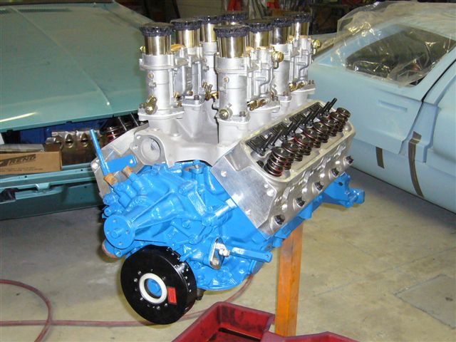

Pete,
The ones that came on mine from Webercarbsdirect.com have not been discussed yet. They are a elastic banded slip on, but are a mesh plastic material. The guy at Webercarbs said they flow the best, and while they look a little "sloppy" he preferrs over all others. I looked on their web site, but could not find them listed. If interested, may want to contact them directly: www.webercarbsdirect.com
Rob

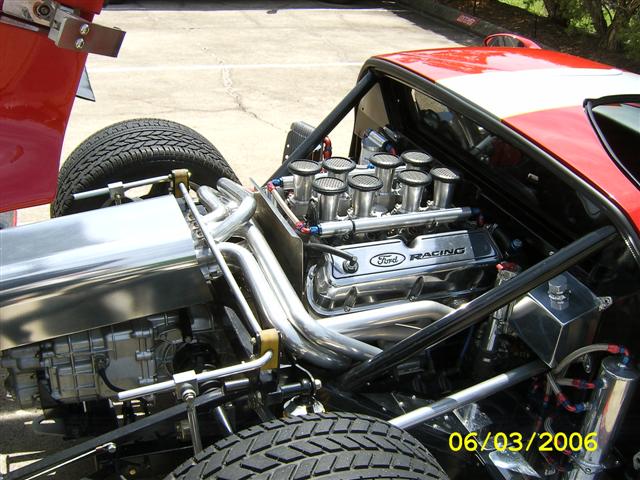

lets see if I can manage a close up....
