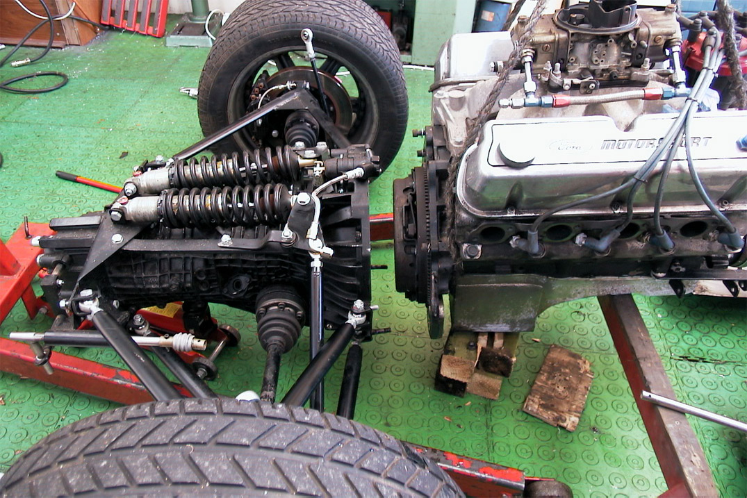

Is this suspension better?
How about you experts make some comments on this suspension. What is it called and is it similar to the new formula 1 cars? Looks interesting to me. /ubbthreads/images/graemlins/confused.gif

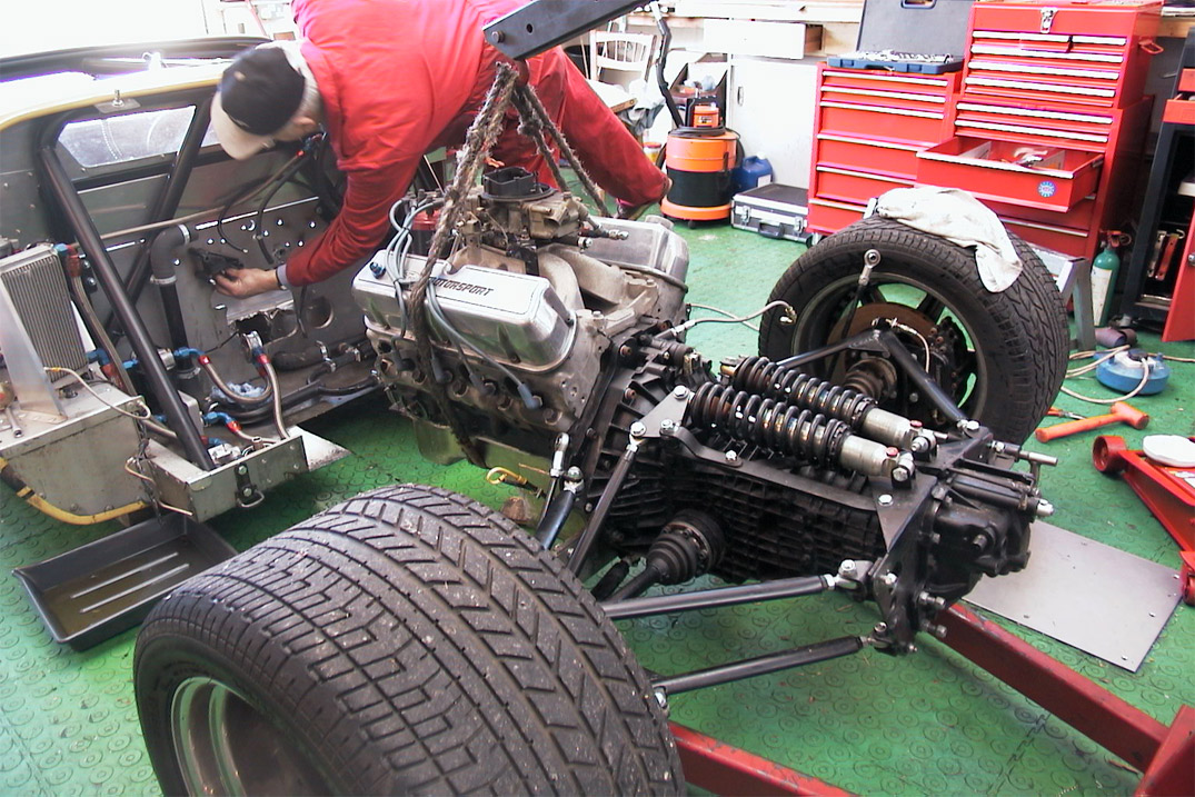

That is a push rod inboard suspension, there are several benefits to this. Mounting the coilovers horizontally on top of the gear box removes the coilovers from the unsprung mass, and essentially makes it sprung mass. You can tilt the coil overs any which way as long as the lever arm is situated in such a way that it will input forces directly into the coil over. This way of mounting the coilovers is convenient considering the ammount of space you're working with.
Another feature of this suspension setup is that everything is mounted directly to the gearbox, there is no additional frame work for the back of the car. Im not convinced this is entirely safe as the bellhousing will be taking all the twisting forces brought on by the rear wheels in cornering and bump. unless there is more to the rear frame that is not shown in the pictures.
A benefit of pushrod suspension in open wheel cars is reducing aerodynamic drag.
All of the GT40 suspensions ive seen on this site have had radius rods, in the rear, which is kind of an old suspension style. This style you are seeing in the picture is used today in open wheel racing.

I have my doubts about this as Clay said, this Renault bellhousing and gearbox was not designed to become a stressed member.
I also wonder about the exhaust system? you would have trouble with the regular crossover system and heat transfer into the shocks?

Hi Joseph -
check THIS LINK for more on the setup you show above.
The front connections of the upper and lower suspension arms actually bolted to the steel adapter plate that connects engine to bell-housing and only the rear was attached to the G-box, via the cage to transfer loadings across the box. This car was only generally used as a track car and was very light, so whilst the G-box was not designed for the loads applied, it did not fail in operation. If used regularly on our (UK) bumpy roads, the story might have been different??? /ubbthreads/images/graemlins/blush.gif

[ QUOTE ]
That is a push rod inboard suspension, there are several benefits to this. Mounting the coilovers horizontally on top of the gear box removes the coilovers from the unsprung mass, and essentially makes it sprung mass. You can tilt the coil overs any which way as long as the lever arm is situated in such a way that it will input forces directly into the coil over. This way of mounting the coilovers is convenient considering the ammount of space you're working with....
[/ QUOTE ]
You do <u>not</u> remove the dampers from the unsprung weight simply by using linkage. They still have inertia and require force to be accellerated. In fact, unsprung weight is added by the linkage. Inboard dampers originated as an effort to get them out of the airstream on formula cars. Once there, designers figured out it was much easier to make adjustable anti-sway bars with the inboard setup, and the layout migrated to closed-wheel cars. The horizontal setup is probably a space and structural variation to allow more room for the driver's feet.
Another advantage to inboard shocks: with a belcrank transferring the suspension loads to the shock, you can easily control the motion ratio between the shock and the wheel. You will notice on many Formula cars the distance from the belcrank pivot to both the pushrod and and the shock are vastly different. Cars with much less suspension travel will typically have belcranks that have a very short distance to the pushrod and a longer one to the shock. This INCREASES shock travel for a given amount of wheel travel. If you kept this ratio at 1:1 then on a car that is very stiffly sprung, you won't have much shock movement and you lose resolution in damping.
By controlling the belcrank ratio (and the inclination of the pushrod or pullrod) you control that motion ratio. It's nice to have one belcrank with different mounting points for the pushrod and shock to test different wheel rates. Or, you can move the shock to a different hole, change the spring so the wheel rate stays the same, but now you have changed your damping!
Sorry about the misinformation about the unsprung vs. sprung mass info, I was sure i read that in one of the suspension books i read, but when i went back to look for it to double check i couldnt find it. Now im wondering if i actually ever read it at all lol.
The only info i found was that half the coilover assembly is sprung, and half is unsprung.
Chris Kouba

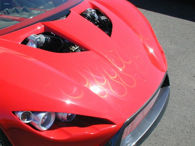

This front suspension looks pretty interesting. I'd like to see the upright/linkage, but I couldn't find any "exposed" shots. It looks similar to the rear of a Porsche 956/962.

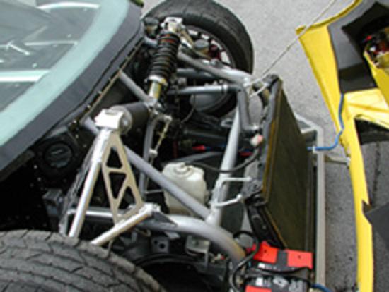

Found a better shot which shows the bellcrank from the upright to the shock. Very interesting.............
Triangulated and gusseted as it is, this this bellcrank setup sure does look STRONG! /ubbthreads/images/graemlins/cool.gif

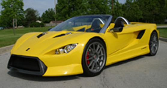

FYI:
The car in the photos is a Venom Racing Attack. It has a 4 cylinder, 250HP engine, 5spd, 1850 lbs, 150MPH, and supposedly handles extremely well. I swiped the photos from an auction on ebay with a 49.5K Buy It Now price tag.
Pretty neat little car! Mid-engined too! /ubbthreads/images/graemlins/cool.gif
