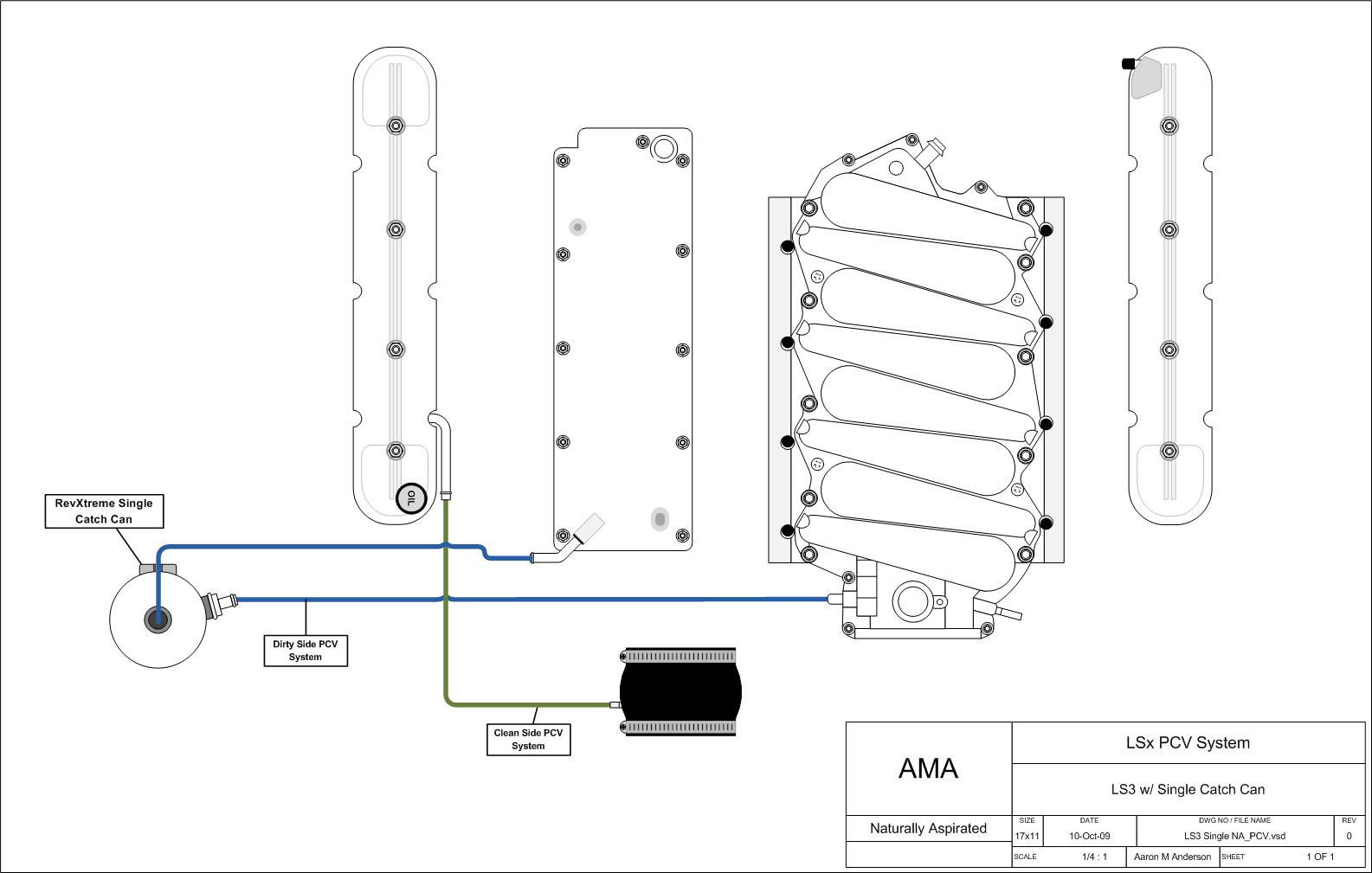

Intake and throttle throttle body connections are all proper, as far as I know. Perhaps somebody could confirm this is correct:
- brake booster on back of intake manifold - plugged
- port on right-hand side of throttle body - plugged
- port coming out of passenger side valve cover - connected to air intake tube after maf but before throttle body
- port coming out of valley cover connected to left-hand side of throttle body
- rear driver side valve cover port plugged

The port coming out on the right side behind the throttle body is the one that connects to the valley cover.
The left side port is the one for the EVAP that gets plugged if not using.
Not a big mistake though. They are both just vacuum ports behind the throttle body.

I've got #3 (left side of throttle body, with intake manifold reversed) connectd to #5 (valley cover) and #1 (right side of tb, w/ intake manifold reversed) plugged

I consider #3 the right side and you call it the left side. Misunderstanding. You have it installed correctly!
Flip the oxygen sensors Alex. Your passenger sensor might be bad.
Just take the "catch" can out of the mix and you'll get one option.
