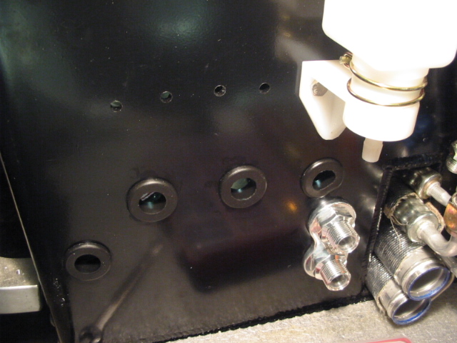

I like the bulkhead adapter for the heater hoses. Would you have the mfgr and part number handy?
How did you handle the connections on the inside to the heater core?

So it takes a special O-Ring style AN adapter for the heater hoses it appears rather than a common AN Tapered seat. Correct? Any part numbers would be helpful as this is the way I plan on proceeding..
Randy, when I read the description, it seems misleading. You want 2-port heater hose fitting. But the description says -6 an heater hose and -10 an AC with o-ring. Mine are both -10 AN, taper, (no o-rings) on one side with slip-on hose fittings on the inside. The picture is what I have, the description doesn't seem to match. I think I would give Jegs a call and see, especially with the cost of the fitting.
Unfortunately, the integrity of the seal is untested on my car.

from their picture it seems that there would be something other than a tapered seat - but it sounds like you rec'd something different.
I'll give them a call for clarification and to ensure that I purchase the correct Aeroquip fittings from them as well.
In polished finish only, these CNC-machined billet bulkheads feature a barbed end for a push-on style hose and clamp setup, and they are designed to work with 5/8'' heater hose. AC bulkheads work with one -6AN and one -10AN AC hose with O-ring fittings.

Well, I am glad you had me looking closer at these. This is one of the first fittings I installed, and I guess I have learned a bit since then. I have the 10AN AC style o-ring fittings. I will obviously have to change this fitting. Luckily, I have (for some reason I cannot explain) a pair of -10AN flare bulkhead fittings and one AN to hose barb adapter. I will need another barb adapter and I'll be set. Anyone want a double barb to 10AN AC-o ring bulkhead fitting cheap?

if you want to use this type of fitting, get the -6an flare heater hose fitting. You will end up using short runs of 6 an heater lines, but I don't think you will have any trouble getting the cabin to warm up.
I accidentally bought the -10 AN AC o-ring fittings. That is where the link takes you. You don't want that.

The pass through fittings for the heater hoses were obtained from Hot Rod Air, Heater Bulkhead, #10 O-Ring x 5/8 Barb 14-1432. We used two 45 degree angled fittings to secure the heater hoses to the bulkhead fittings, Heater 45 Degree Female O-Ring, 05-1400.

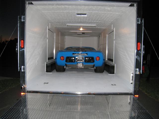

Delivered!
Loaded and delivered to Val Burd. Very excited about them keeping me out of any trouble.

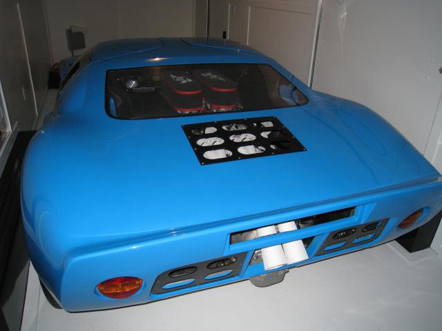

They were very impressed with the tub, and they don't give out praise easily. We talked for about 3 hours going over every aspect of the car, what I had done, what I had planned, and what needed to be done. First step is going to be finishing the chassis setup, establishing alignment and ride height. This will require my transaxle subframe to be made, which is going to mount the sway bar pillow blocks and give clearance for the axles. I'll report as it goes along. I didn't take any pictures there, but I snapped a few as we loaded it.

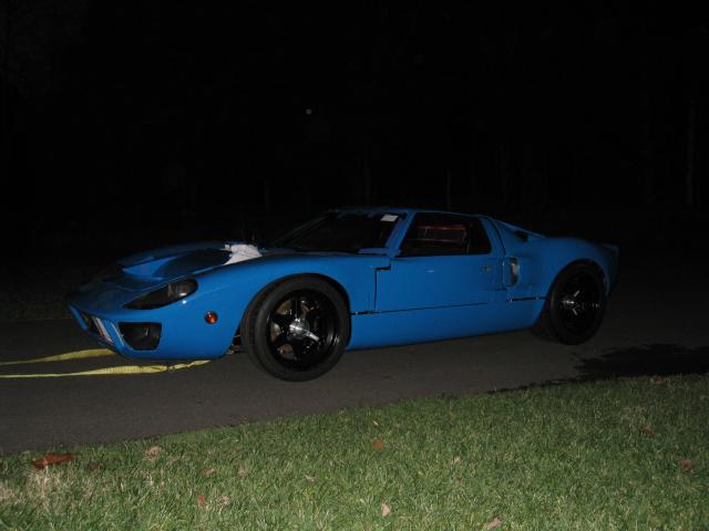

It was dark by the time we got it into the trailer Thursday night. But for a few minutes it was sitting outiside in the fading light with all the body panels on it, sitting pretty close to final ride height. Seeing the car in the wild about blew my mind. In the garage or a closed space under fake light, you just do not get the full impoact; not even close (nor in pictures for that matter, but I snapped some anyway). Outside, in one glance you see how special the shape of this car is. How low is is. How flowing and proportioned. It's a design that is now 45 years old, and I think it has not been equalled since.
I wasn't prepared for how well the white headers look through the bodywork. Fantastic.

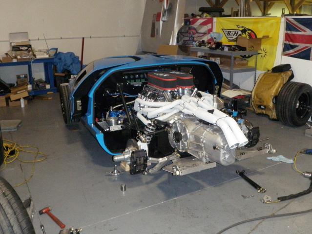

Went down and hung out at VIR with Val. Dad drove the Cobra, but I left my gear behind and spent the day in the garage. We got the rear clip pretty close to final and removed it. We then set about getting the rear of the car together. the locating rods for the rear panel have to be relocated. We are going to support the top of the transaxle, we made double sure the axles fit, And we made plans to mount the coolers. The sway bar is another story. We are looking at how to do that. It is very tight above the tranny.
The car is in good company, sleeping next to ex-James Hunt Heskith F1 car.

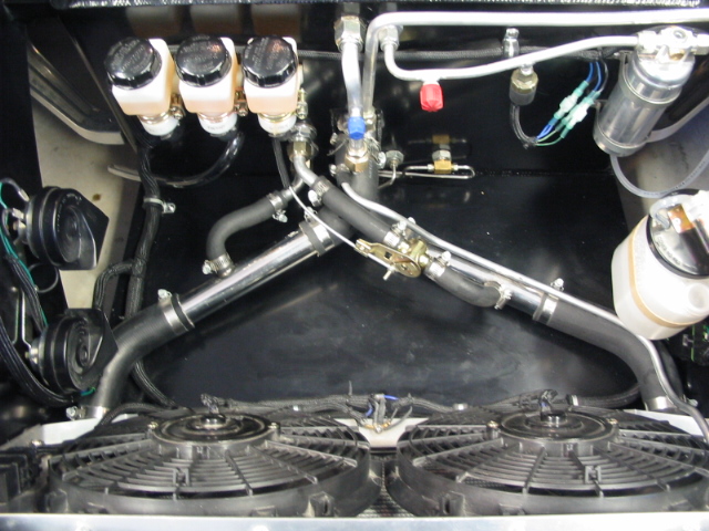

...and still groping for a few fittings, but I have answers to some questions: I drilled three small holes in the thermostat at the suggesting of the guys at Meziere. This means I have a little bit of flow past the valve when closed to help remove air. This will also reduce my concerns about the 6 foot -6 bypass hose. I am plumbing a bleed line like everybody else from driver's top corner of the radiator back to the tank.
By the way, Hot Rod Air is gone, so I have made my own adapters for the bulkhead fitting with two steel AC style o-ring fittings and two weld-on AN fittings. I'll get pics when I get a chance. Back to work.
