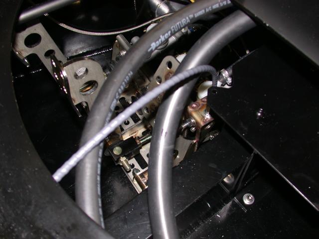

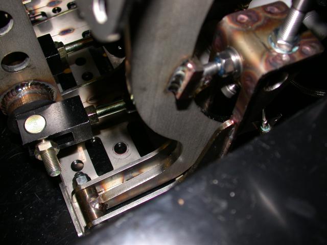

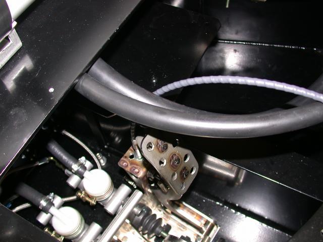

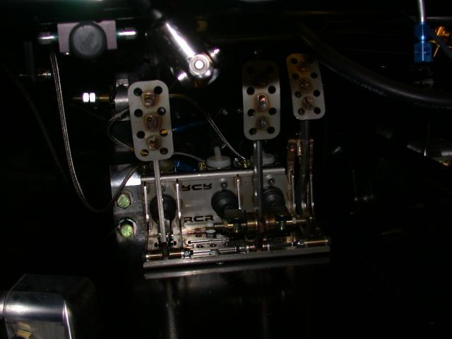

More pictures of the progress. Obviously the pedal box is in. I got my throttle cable from Control Cables (Control Cables, Inc.). I needed to redrill holes in the bracket, and let me warn you, the stuff is HARD. Required very good bits, resharpened with each cut. My throttle pull is right at 2.5 inches, and I added stops for both ends of the pedal travel.

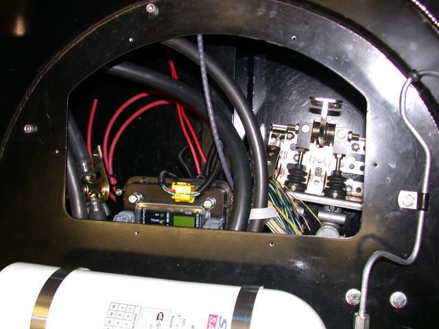

Next to the pedal box is the bracket I made to support the Mastercell for the Isis system. Actually, I used the bracket that was with the parking brake system. Since it was steel and a bit of a boat anchor (and now it doesn't have to support the parking brake handle) I cut squares out of the sides to save a few ounces. Painted black, it looks pretty good.
BTW, that line-lock I put in the front circuit works great!!! Good thing too, since I cut up the hand brake bracket.

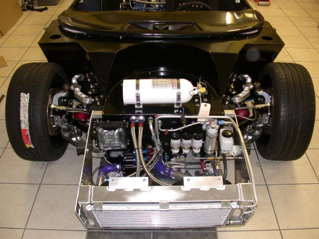

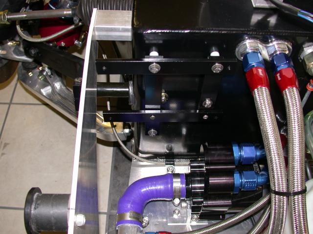

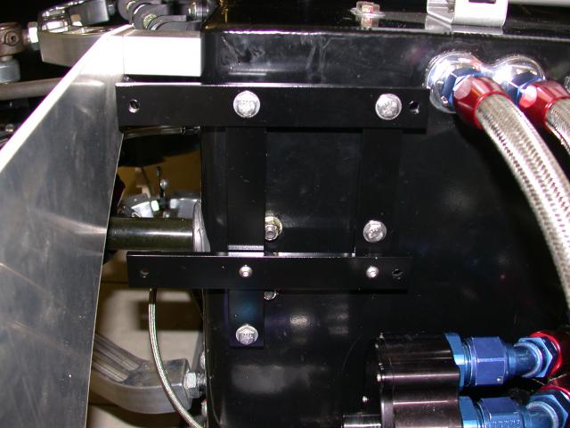

Since the bracket for the Mastercell weighs 80 pounds, I decided to use a minimalist approach on the front Powercell bracket. I built it up out of pieces of 1/4 inch thick aluminum. Nylon spacers let it clear the bolts for the sway bar.

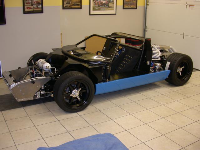

With springs installed, the suspension is ready to be set up and aligned. I need to move the car to the lift and get under it to do a few things. So I put on the wheels and set it down. Seeing the car sitting there was a huge boost. It also meant I had to sit in the driver's seat and make motor noises. Progress is good!

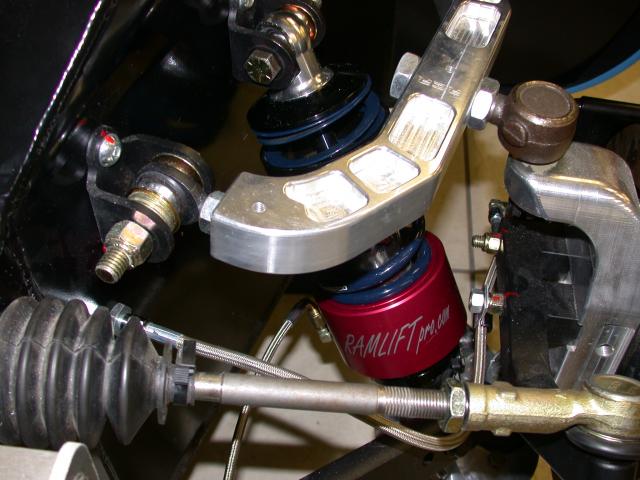

I agree the lifts would reduce unsprung mass by being at the top, but there is no room. The lift is significantly wider than the spring and will not clear the chassis. The SLC is setup the same way, and it goes unnoticed. I would not use it on a race car where every ounce counted, but for me, no worries.

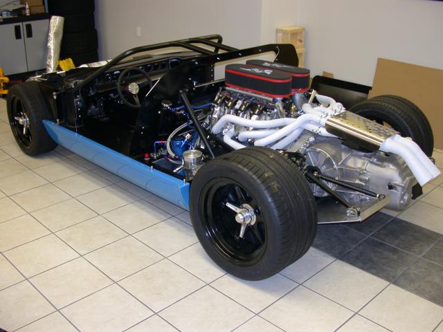

I am reaching the end of my part. What needs to be done now primarily includes fiberglass work (final dash prep and body fitting) and fabrication (rear transaxle subframe). I have gotten done what I need: the driving position is set, the gauge layout is done, and I understand all of the workings of the car, both mechanical and electrical.

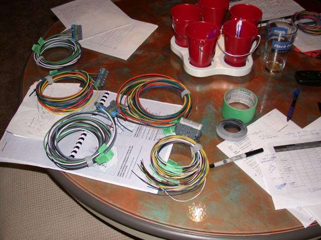

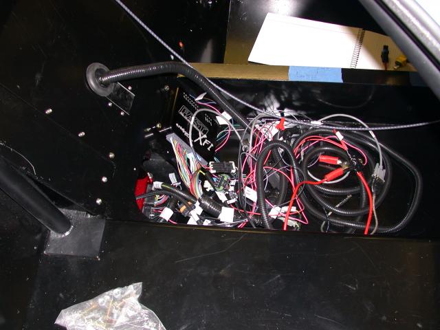

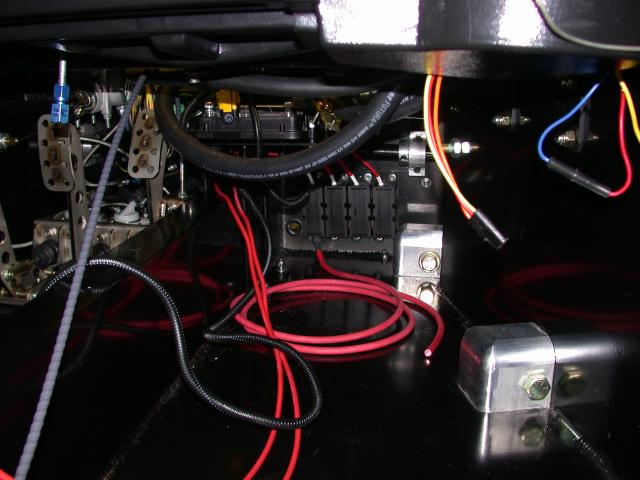

On Friday I plan to haul the car to Val Burd Racing at VIR. Val and Charlie are going to take it from here, although I will still be heavily involved (of course). In the meantime, I have finished designing the ISIS electrical wiring and dissected the FAST system.

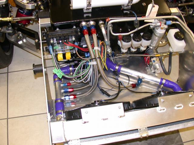

The ISIS is great. Once you get the hang of it, it is really easy and very flexible. I sorted all of the wires out and marked them as to exactly where it goes. I then taped it all up. Now I am getting it ready for transportation.

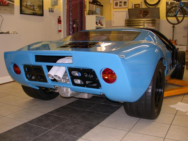

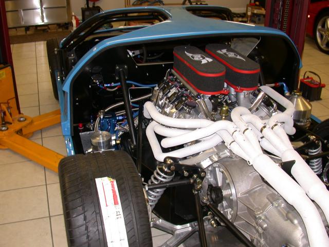

Delivery prep continued...

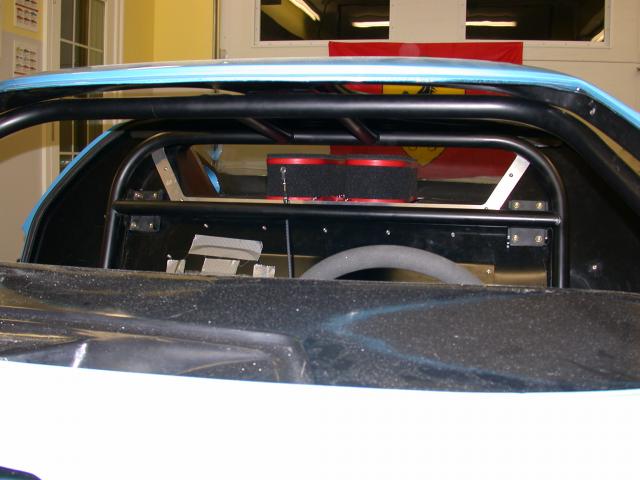

I got a bunch of friends to help me set the rear clip. It does not fit like it did when I got it, but it all needs to be aligned. And not by me :)
The rear view mirror is not going to be very helpful, but the view will be nice.

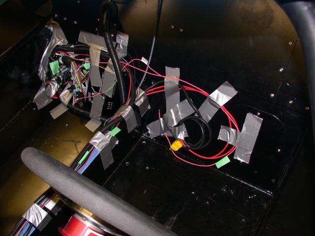

Wiring is marked and secured.
I think one of my favorite views is the completely flush undertray.
