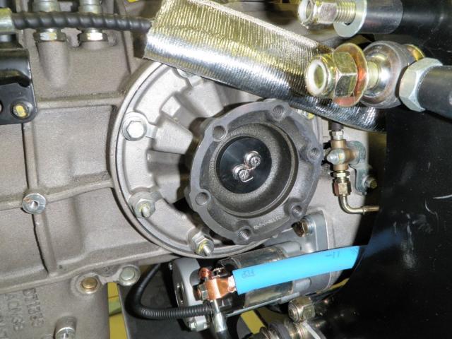

If you are familiar with the Ford GT guys, you know that they had issues with the flange retention bolts that hold the splined in-board axle flanges to the transaxle. These are hidden behind the CV joint once it is put together. The factory bolts would break or back out (not sure which) and the axle would pull off the output shaft. This was a source of much frustration.
Not wanting any issues, I bought a set of the Accufab bolts from a guy that had sold his GT and never got around to installing them. They are 8mm 12 point bolts with holes for safety wire. I got flange bolts too, but they are too short for these CV joints, so I spent an incredible amount of money on what will ultimately amount to 4 nice bolts. Oh Well.
Torque specs for the Accufab bolts is 15 ft/lbs first pass, then 22 ft/lbs. Since they were drilled, I safety wired them.

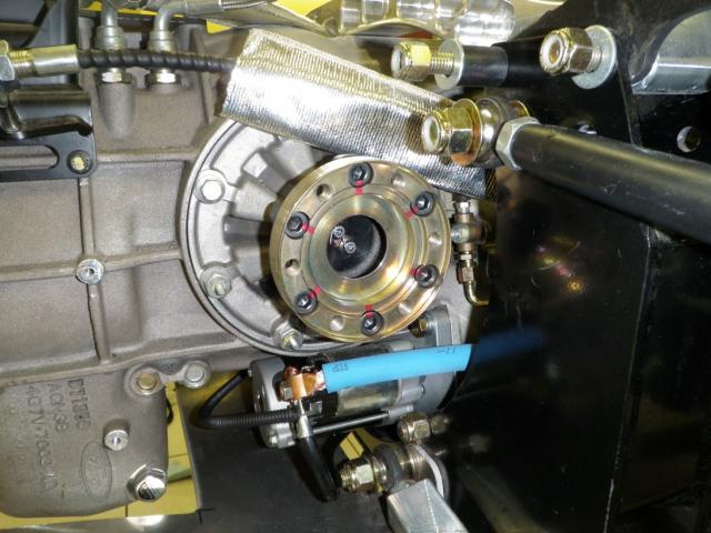

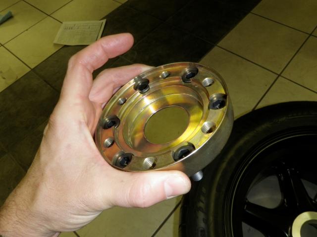

The Porsche CV joints don't actually fit the Ricardo flanges. They are close, but the bolt spacing is not exactly even. So you have two choices to mount to the Ricardo: you can machine the holes a smidge bigger so that the bolts will go in, or you can get an adapter plate made by the Driveshaft Shop (they made the axles too, and there will be more on that in a minute....) I chose the adapter plates.
The adapter gets mounted to the flange: 30 ft pounds first pass, then 57 ft/lbs.
When I went to bolt up the axle I realize, these things are WAY too long. WTH?
The original axles were too long when I got the car. So I sent them back and they shortened them. Then we went to bolt them up and the flanges didn't fit. So I sent them back again, this time to get the adapters and to have the driveshafts shortened yet again to make room for the plate. This second time they went straight to Val's at VIR, where they sat on the floor for who knows how long. I never thought to hold them up when they came back, just made sure I had them. I mean these are clearly not mine, so I guess some poor SLC guy has driveshafts about 6 inches too short.
Looks like they will have to go back, yet again. I am really bummed!

The adapters are made by the Drive Shaft Shop. Looks like they mistakenly sent me SLC axles. They have the spec and make the axles for RCR. I should have the correct axles next week.
I like the adapter plate. It is more expensive than simply opening the holes a bit, but it seems more precise. My father's slc must have the open-holed axles, because he does not have adapters. He mentioned that he has had the axle bolts loosen up, but I don't know which ones or any more details. Possibly the bigger holes let the bolts loosen?
The use of Bellville washers and locktite should keep them from loosening.
If in doubt, you can always safety wire the bolts.
The Drive Shaft shop provides bolts and the spring-style lock washers. I am not sure the dimensions beyond 8mm hex drive. I do have some extras though if any one needs them when I am done.

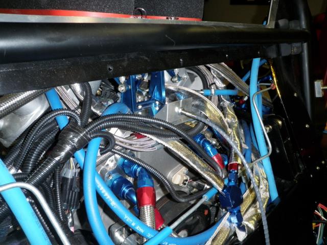

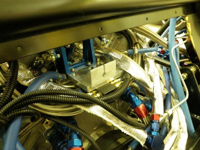

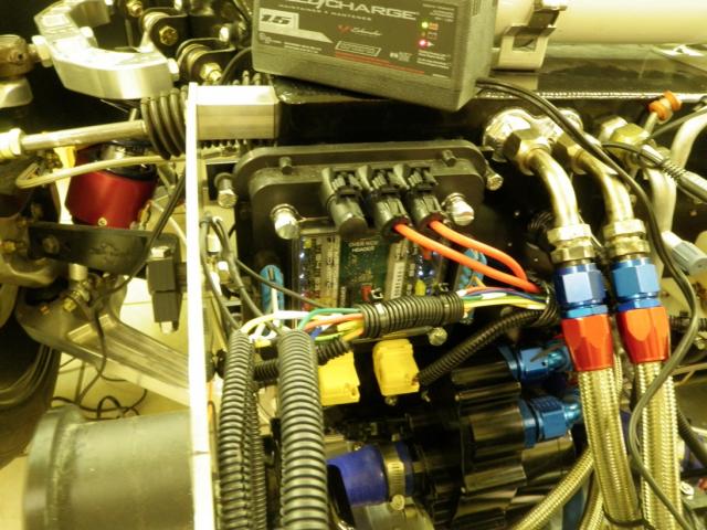

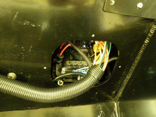

In the meantime, I have completed the chassis wiring and bundling the mess. I have started building my battery box and pulled the dash back out to wire the switch harness.
Completed wiring
This was the area I thought I could not handle, and I am so very glad I did it. I know where everything goes, and it works just like I want it to. I learned: to solder, to crimp, to crimp and solder, how to plan a circuit, how to use a relay, all kinds of stuff that I only knew superficially from physics years ago.
More of the Isis system:

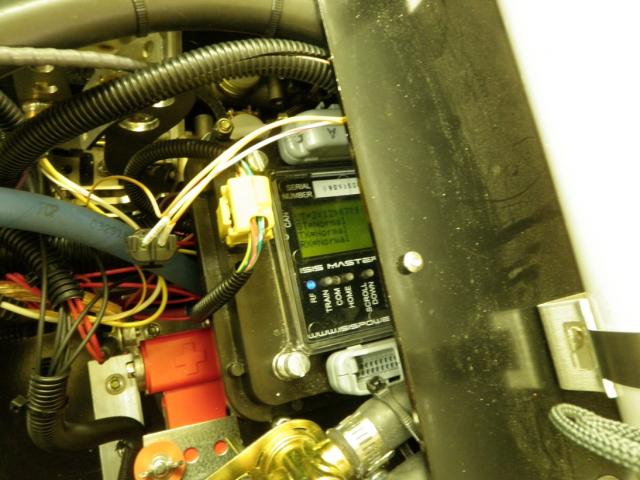

I love the trouble shooting function. I love the flexibility. I immediately found a glitch in my switch harness wiring, which was easy to fix. I wanted to change the way some things work, and that took less than a day.
The base programming includes what is called a "soft start" for the headlights and high beams. It ramps the power up slowly to help extend bulb life. I wired my dash lights off the power to the running lights which don't have this feature, so I had the programming changed. Also, the RF key fob security flashes the running lights once when security turned on, twice for off. This flashed my dash lights, which I didn't like. So I had the programming changed and now it flashes the hazards. I put indicators for the hazards in the dash (turn signal indicators, plus head lights and high beams) and so the green lights flash inside the car too. Nice!
This means I don't have any need for a key. The ECU is disabled with the security on, and the car will not run without the fob. I didn't want to have to fool with a key, and I didn't want a key chain hanging there while driving.
When you power it up, LEDs show which circuits are "hot". When you activiate the corresponding switch, the LED for that channel gets brighter to indicate what is happening. If there is a problem, the mastercell can tell you some of what may be wrong. I know it is not in any way a period look, but I think we are way way past that with this car. The mastercell and rear powercell will ultimately be under covers.
I am working on a spreadsheet which will document where every wire goes.
I mounted the battery in the passenger footwell. I will have a partial encloser that covers the hot side. I also have a custom machined aluminum footrest from Brian Sullivan of pedal maker SRP. If you need something done, he can set you up.
I have aluminum switch panels made. I am going to wait until the car is running and then fit them.

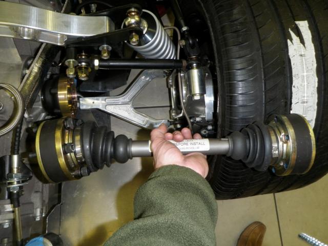

Axles fit.... sorta
I mounted the axles and I am not sure I like them. The angle is really extreme. This picture is at 5.5 inches rear ride height, which will reduce to 4.5 ultimately. Still, you can see the CVs are at a pretty severe angle. You can also see the gold adapter plates. I like them, but I am almost sure they will have to go to help reduce that angle. Going to talk to the driveshaft shop and see what they thing.

Re: Axles fit.... sorta
I'm told the off-road guys run the same CVs, with up to 22 degrees of angularity without problems, so the angles you see, if less than that, should be OK.
Possibly different boots might be called for, but those are relatively easy to change when and if there is an issue.
I think the solution set that doesn't involve using adapters is to drill the CVs to the FGT flange size, or remake the FGT bells with the correct bolt circle as the CVs, or adapt a set of the FGT CVs to the axles (in which case you'd have an axle with different CVs on each end. You could also mod up a set of the FGT axles to use 930 CVs on the stub axle side.
The adapter route is clearly the cheapest one. Of the other options, I would look hard at the idea of just using the FGT CVs on the transaxle side.
Let us know what you decide. :thumbsup:
I measure it at just under 19 degrees, and that is still 1 inch higher than ride height. I may get to keep the adapter plate yet. I have not safety wired the bolts though, I'll wait until I get approval from those in the business.

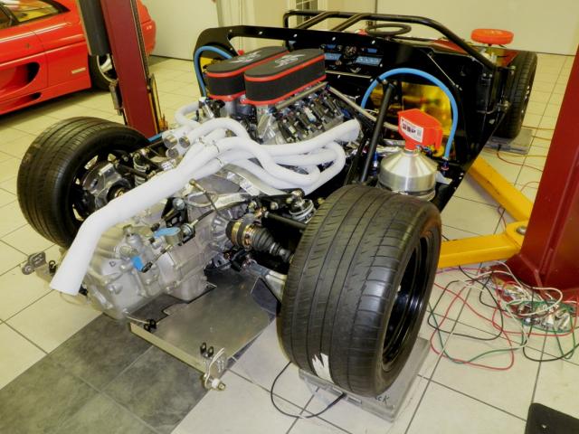

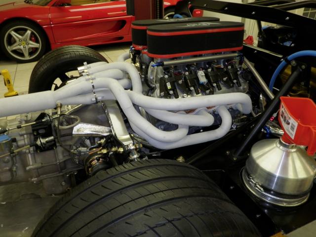

Headers on. I used copper gaskets from Street and Performance, and locking header bolts. I am modifying the hanger to have a bit of play, more on that later.
12 quarts of oil should do it, with some of that in the filter.

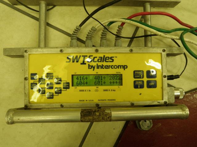

Just out of curiosity, I threw the scales under it. This is dry weight, no body work. I hope to have a wet weight tomorrow.
Pretty decent corner weights for being right out of the box and (I assume) no attempt at weight jacking to make them perfect. You should be able to get very close.
Like the headers- they must have been made specifically to clear the Ricardo?
Will, I did absolutely nothing to balance the corners, just luck so far. It will be spot on when done. Fran made the headers specifically for this car.
