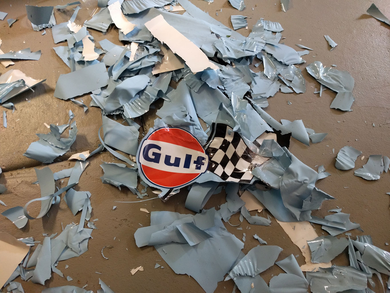

Do not leave the sanded primer for many weeks then apply basecoat. Follow the product instructions to the letter. My new painter uses PPG all the time. The first one did not and I paid the price, an expensive price.
Dont let the image below happen to you!
Anyhow the car will look even better this time.

Thanks for the tips Jason...
It must've broken your heart to see that paint peeling like that..
Sounds about right Jason.
When I built the build table and painted that I went out to body shop paint supplies at Bayswater. Told them that I wanted "Ford light engine blue". First question they asked was what undercoat I wanted.
This then followed with me explaining what undercoat I had already used (a regular hardware store product) and them being unable to sell me something compatible. Lesson learnt. For the best results you really do need to use the whole box and dice from the one manufacture.
It was evident when I was wiping down the build table prior to paint that the recommended cleaner was dissolving the primer. I can only imagine what sort of reaction would have occurred had I used something incompatible.

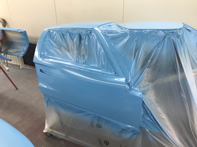

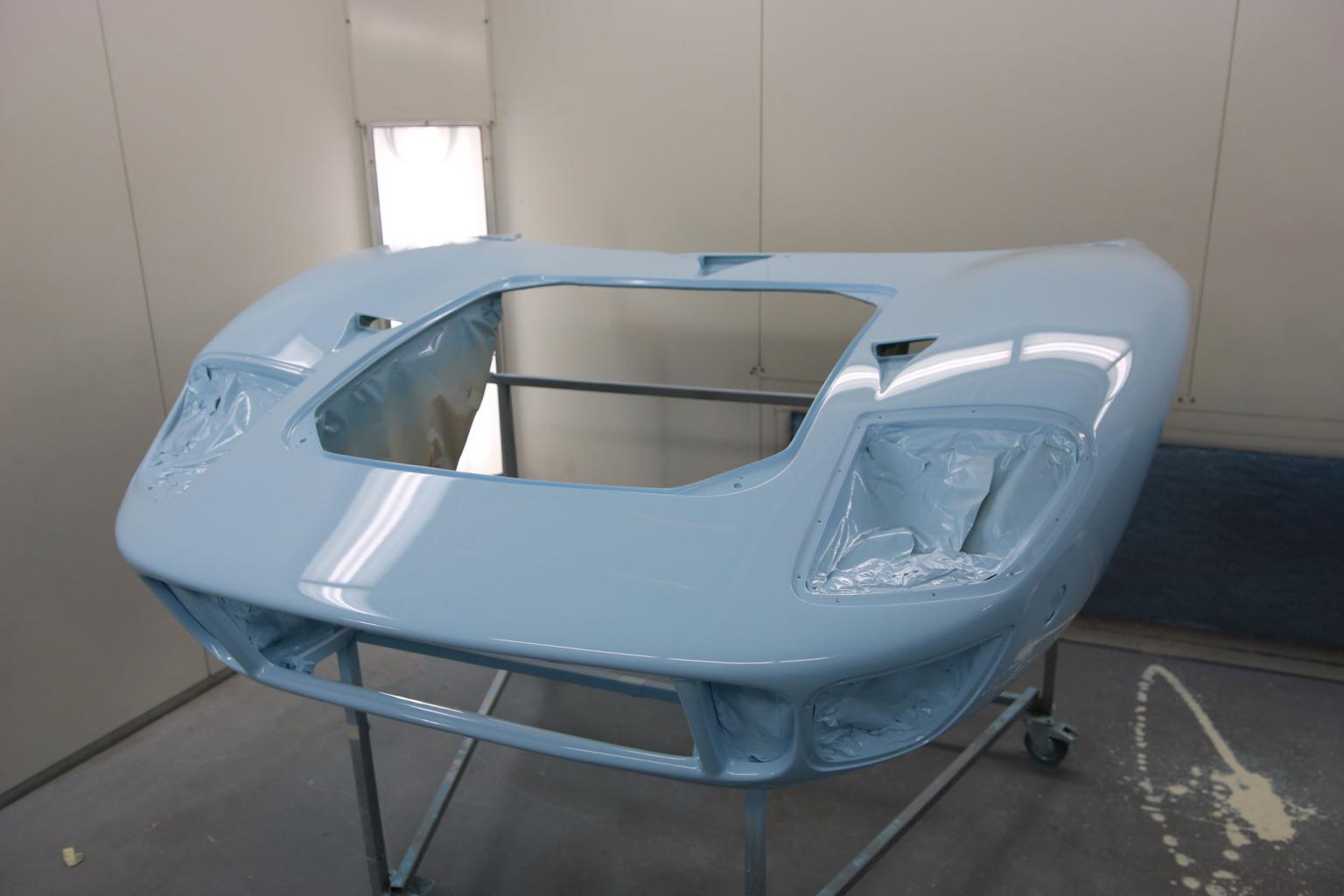

Car is in primer (tinted primer). I know its been seen 100 times on other cars but when its your own its exciting, even for a second time!
Now it gets blocked down and its ready for the black underside and accents. After that the basecoat colour.

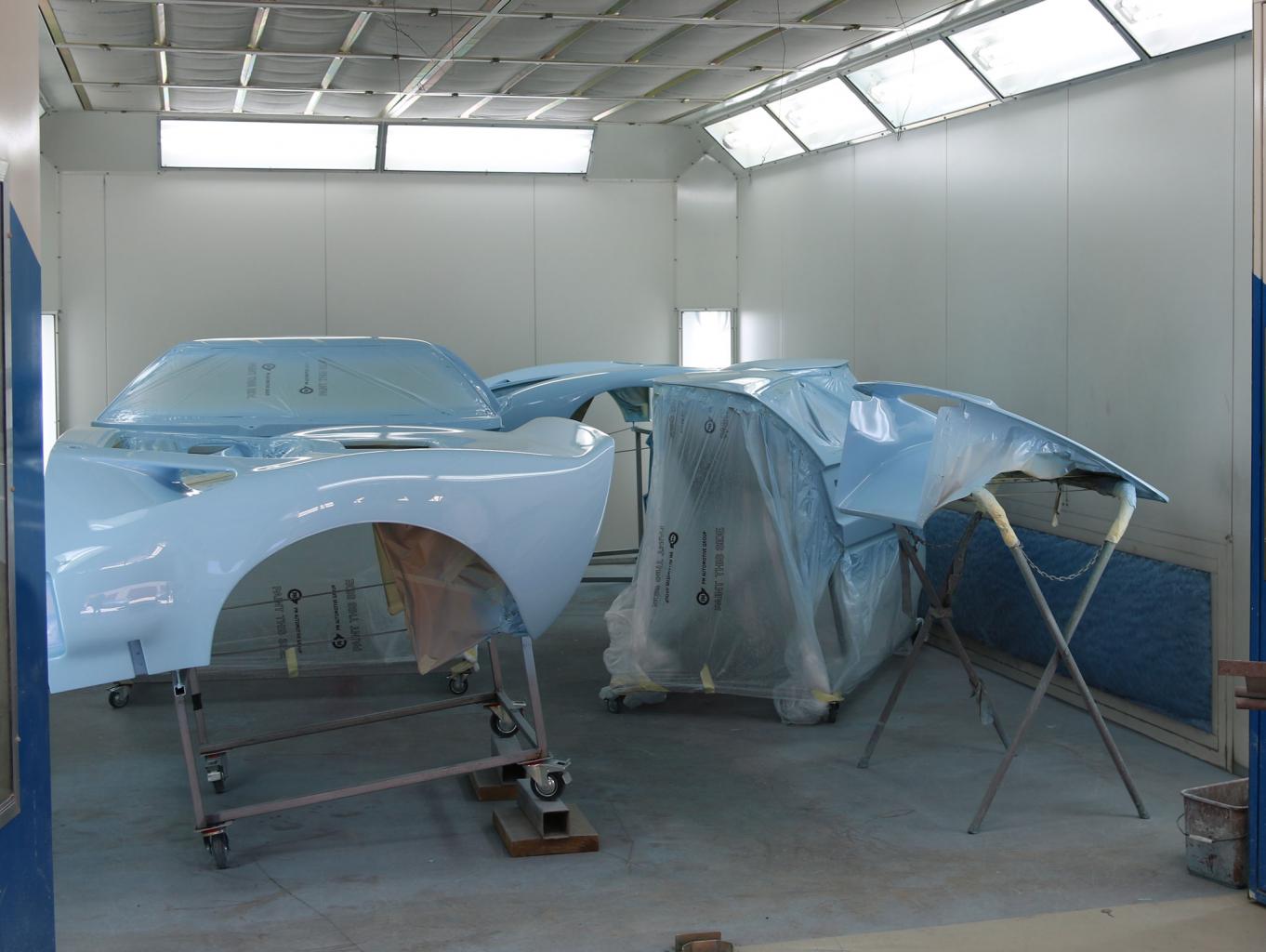

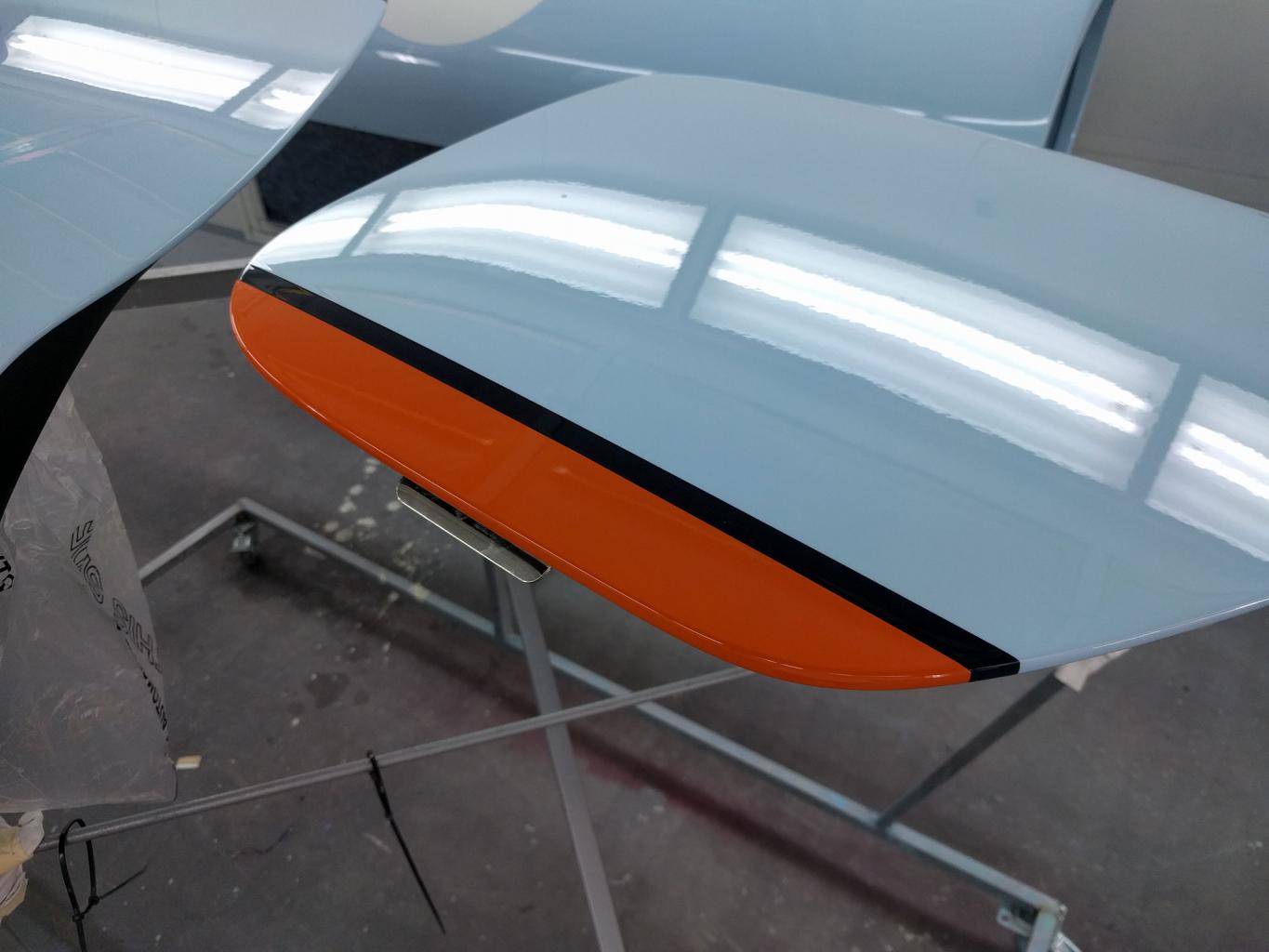

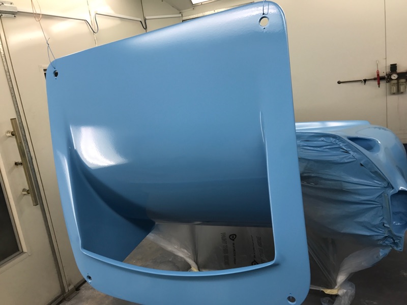

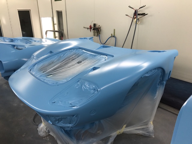

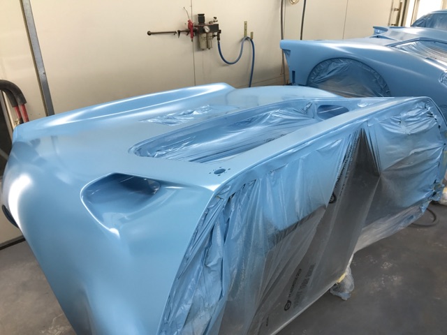

Base coat is done with a clear sealing coat. Now to rub it down and prep for the stripes and then the real clear finish. Its looking better than it ever has and its not even finished, the painter is doing a great job.

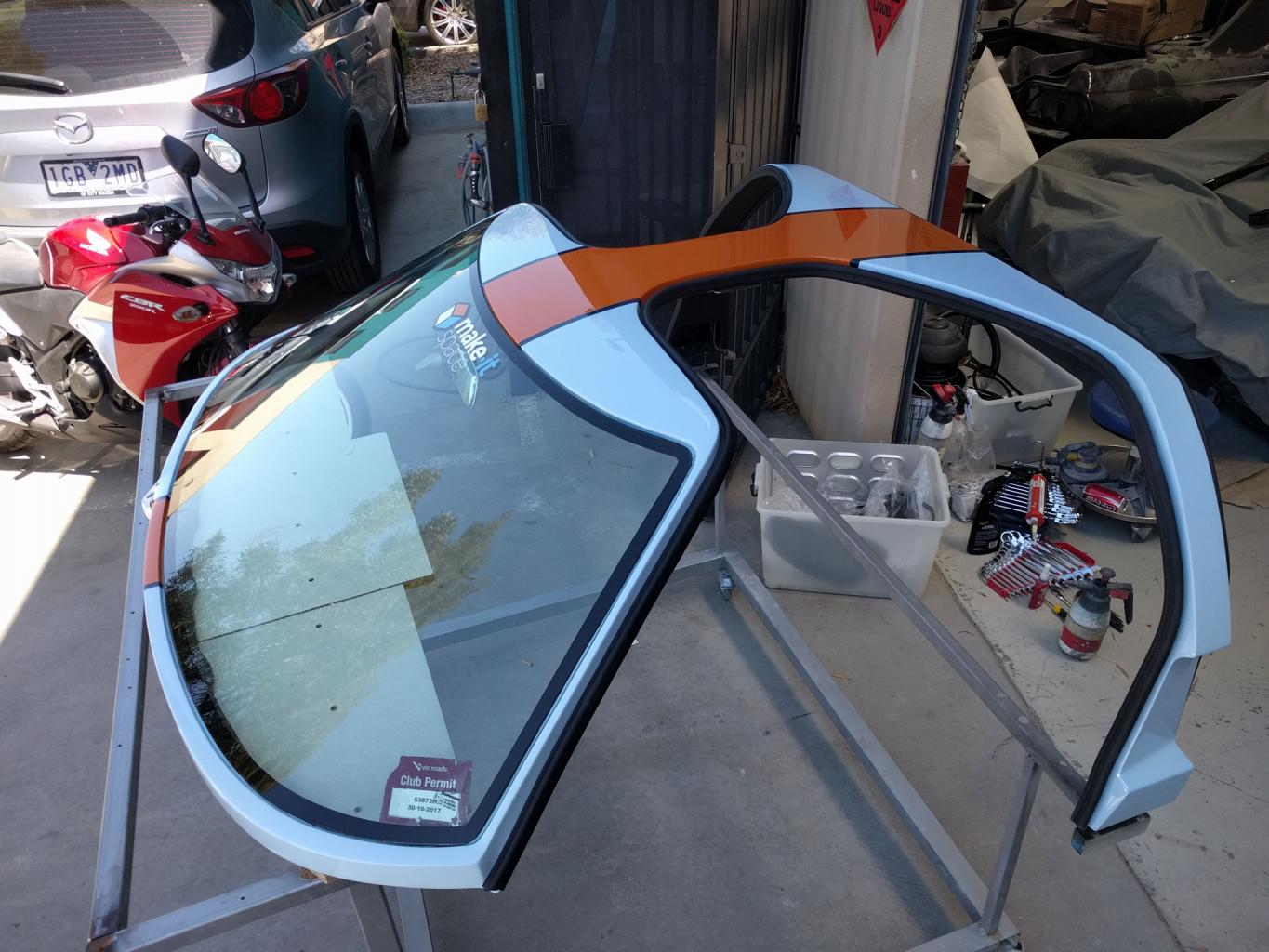

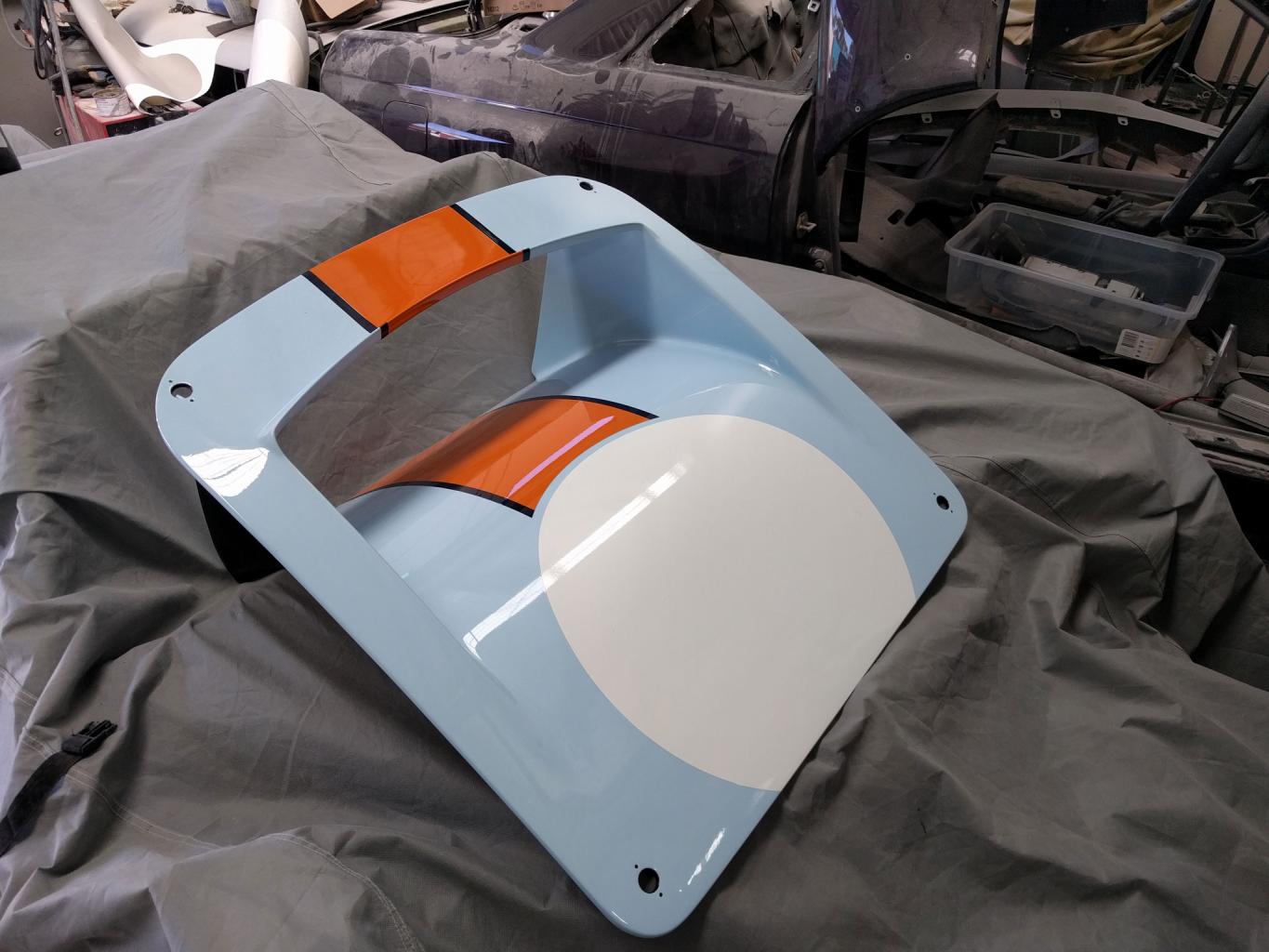

Car is back from paint and now I just need to put new decals on again. Glad to see the end of that!

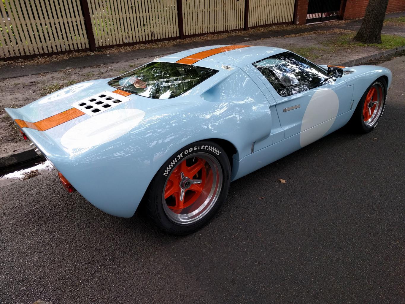

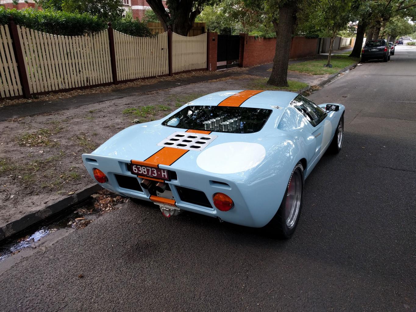

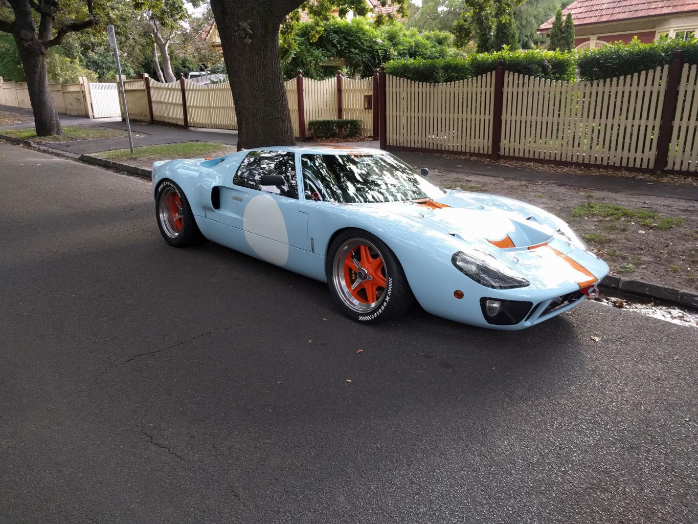

Just a few more images before decals. Must thank PPG for awesome color matching and great paint as well as the painter SL Customs here in Australia. Absolute attention to detail. The PPG CeramiClear is the best, it looks 100 times better than before.

Now that the car is all painted its time to blast it all off again! Starting to move into using the car as it should be. Ever so slowly though :)
It really is a great car. Simply drive it to the track and home. The car has now done over 10,000 Kms and not missed a beat.
