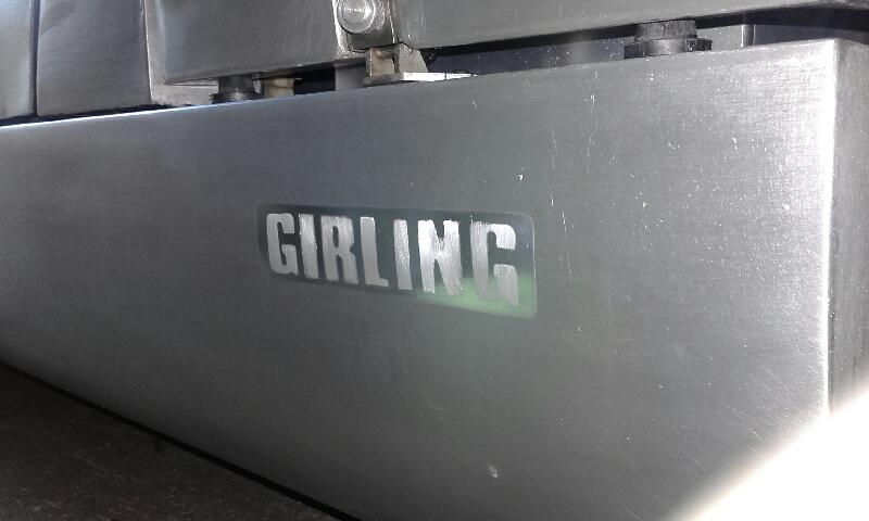

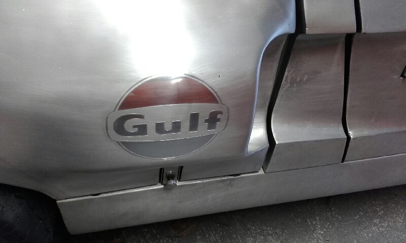

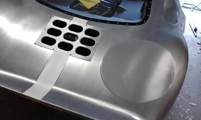

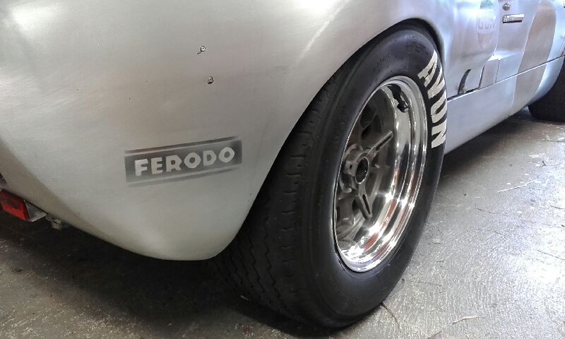

Did a re scotch bright on the car on my break.
I decided to make some changes.I had vinyl stickers and roundals so I removed them.
I polished and sanded in the stickers.
I sanded in the roundals in the opposite direction and also polished in pinstripes.
The first gulf pic is not coloured it is my sons orange car parked next to the 40.
Jim
