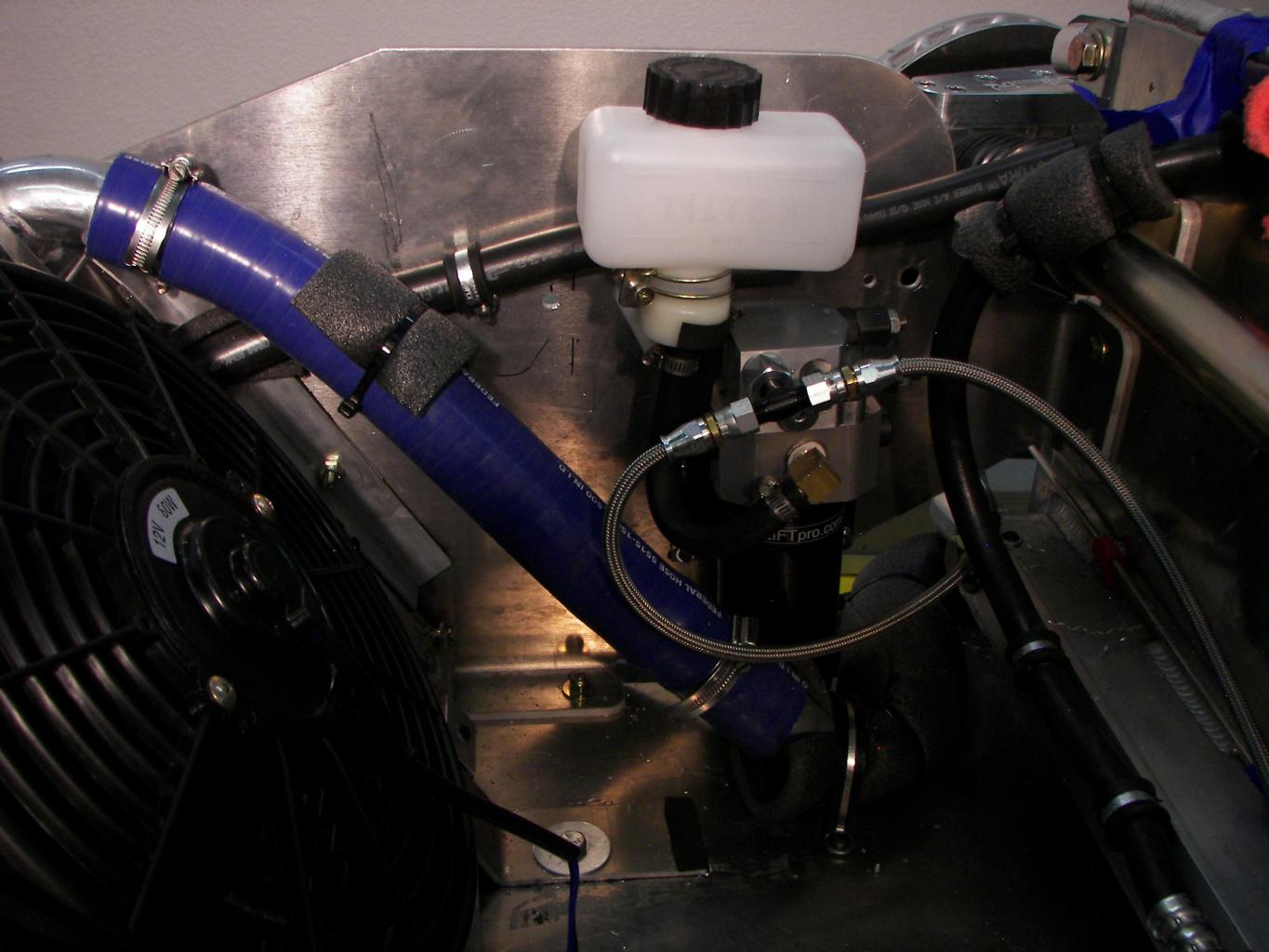

Last week I showed you the mock-up of a fitting we made out of PCV pipe. The radiator shop finished the fitting and it fits perfectly. Originally, I planed to run the hose from the radiator, through the back of the nose piece and to the passenger side coolant hard line. The problem was because of the location of the lift pump, the bend in the hose was to radical and kinked. The solution was the a hard line with three 90* bends and as I stated earlier, it worked great. (pic.#005)

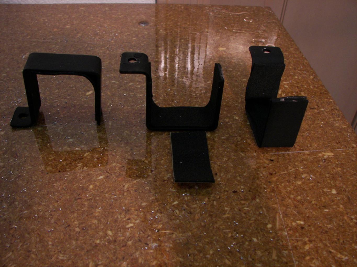

George and I fabricated some rectangular shaped “U” flanged brackets that would allow me to stack the two coolant lines and the two heater hose in a nice neat cube. (pic. #001) I lined the inside of the brackets with some anti-abrasion adhesive rubber.

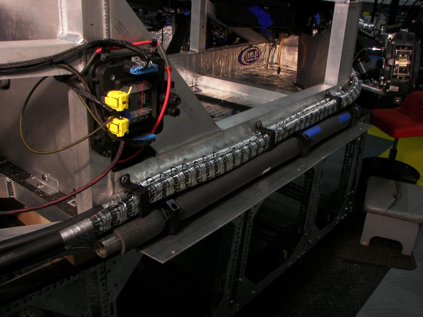

I wrapped the the two coolant lines and the two heater hoses with some Dynamat heat reflective tape.(pic.#002 & #003)

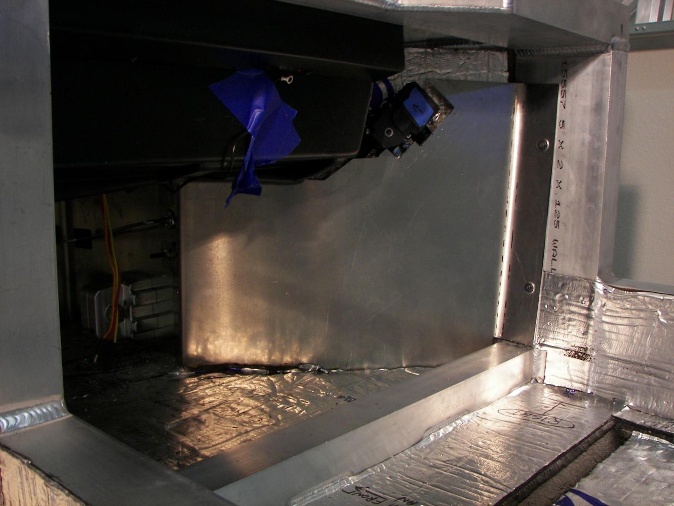

Solution: I fabricated a cover that hides the hoses and can be easily carpeted over. (pic. #004)

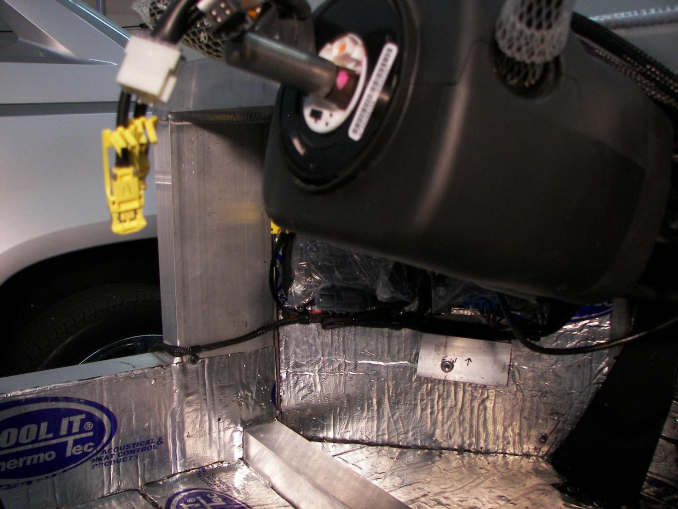

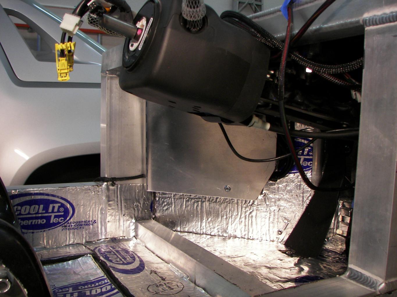

Driver's Side I.S.I.S Cover:
We mounted the two I.S.I.S electric control panels on the 45* angle portion of the street side driver's foot well. Although not as ugly as heater hoses, I wanted to conceal them so I fabricated a cover that would hide the control panels and could be easily carpeted over. For someone that didn't plan to do a lot of fabricating....I find myself doing a lot of fabricating!
Jim

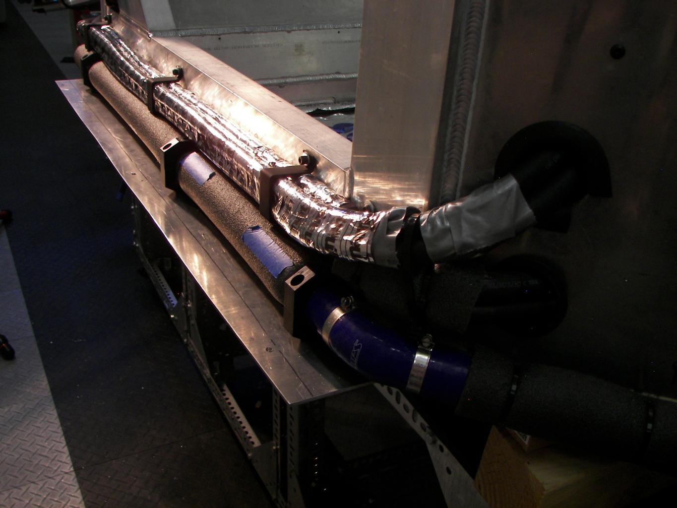

A couple more pictures:
pic # 007 is the naked I.S.I.S control panels and pic. #006 is the covered I.S.I.S control panels.

Jim - just a thought. If you have to change fuses or access the ISIS power module on that "B" pillar.... it's going to be a PITA.
Agreed - that's a very bad location for it.
Thanks guys, I plan on mounting the fuse box on the rear bulk head around the corner from where I presently have the ISIS power cell installed. The fuse box will be fully accessible from the engine compartment.
I have seen where other builders have installed their ISIS P.C in the same location I choose, so I assumed that the frequency of accessing the unit is nil.
Where did you guys mount your rear P.C and could you please post a picture.
Thanks,
Jim

Finished a long time ago (at the beginning of the year). Although right now it sits crippled because my rear power cell (boy, can't imagine why I said that location would be a bad one :D ) blew and had to be replaced. On a side-note Jay has been great to deal with and warrantied it even though I bought it in 2009.
I would put it on the rear firewall or if you want a clean look, on one of the horizontal beams within easy reach.
Thanks Alex! So much for my theory that I would never have access the rear power cell. After reading your post, I turned off the football and am off to the garage to scout out a new location, but I'm running out of real estate.
Thanks again!
Jim

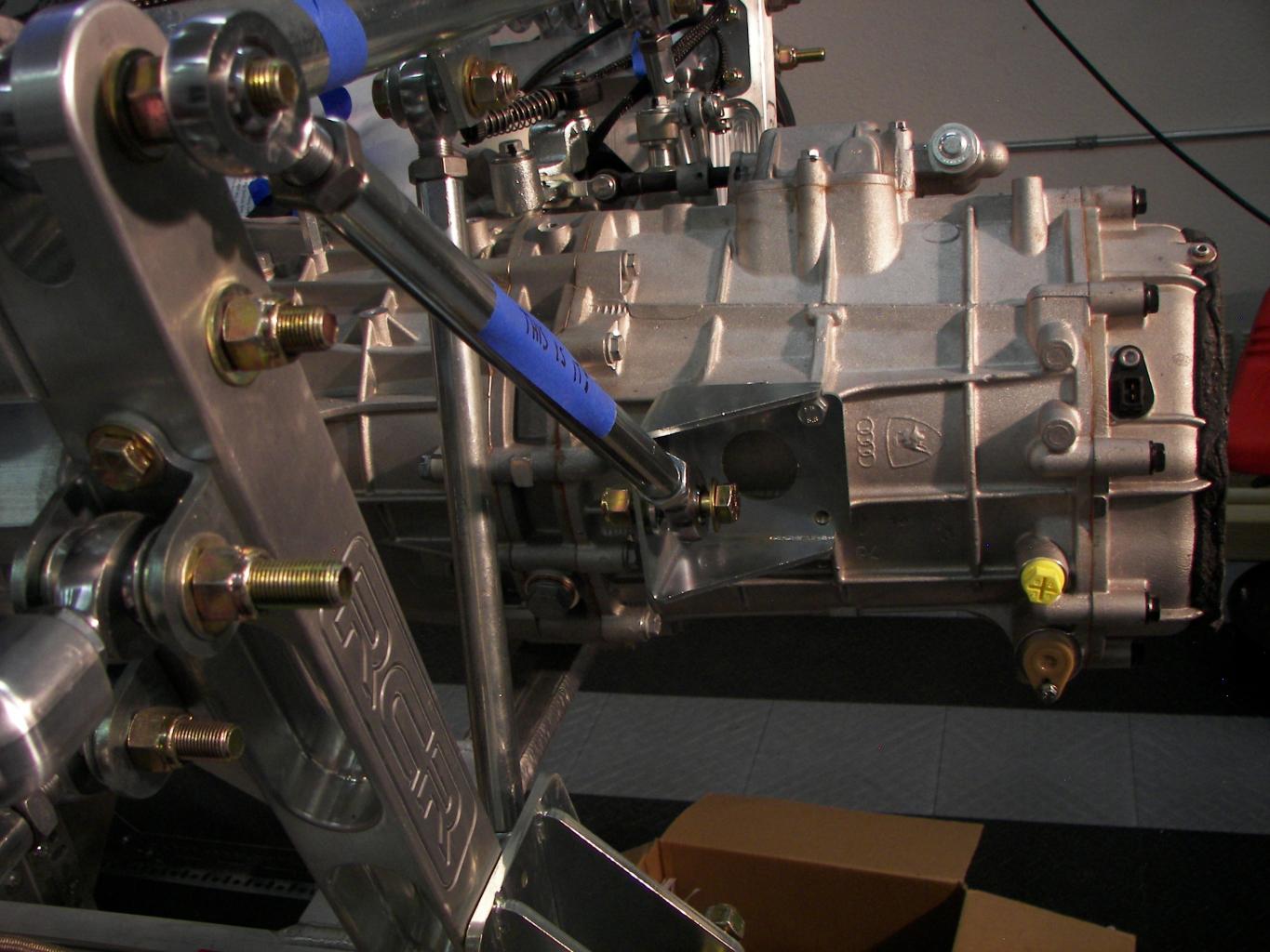

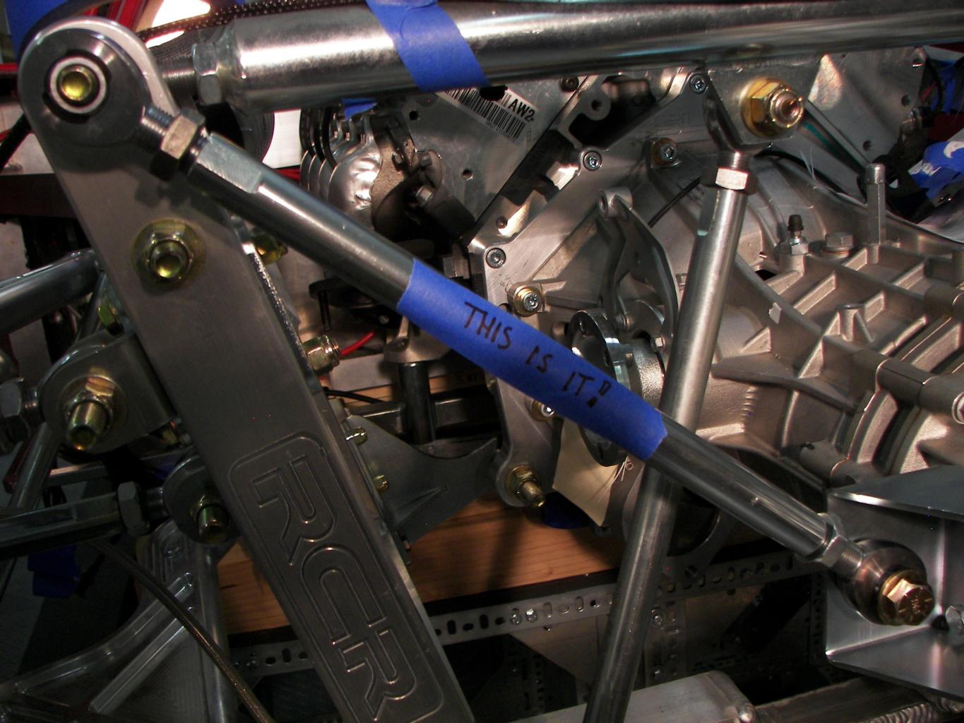

Fran, I just received my Graziano shifter and transaxel support braces today (thank you). Please look at the below photo (pic. #004 & #005) and tell me and the other Graziano builders that too are just receiving their parts if I installed the assembly as intended. :huh:
Thank you,
Jim

The lower rod end fits on the other side of the trans bracket...the larger flat surface and yes the upper rod end is held on by the nyloc nut currently shown under it..
