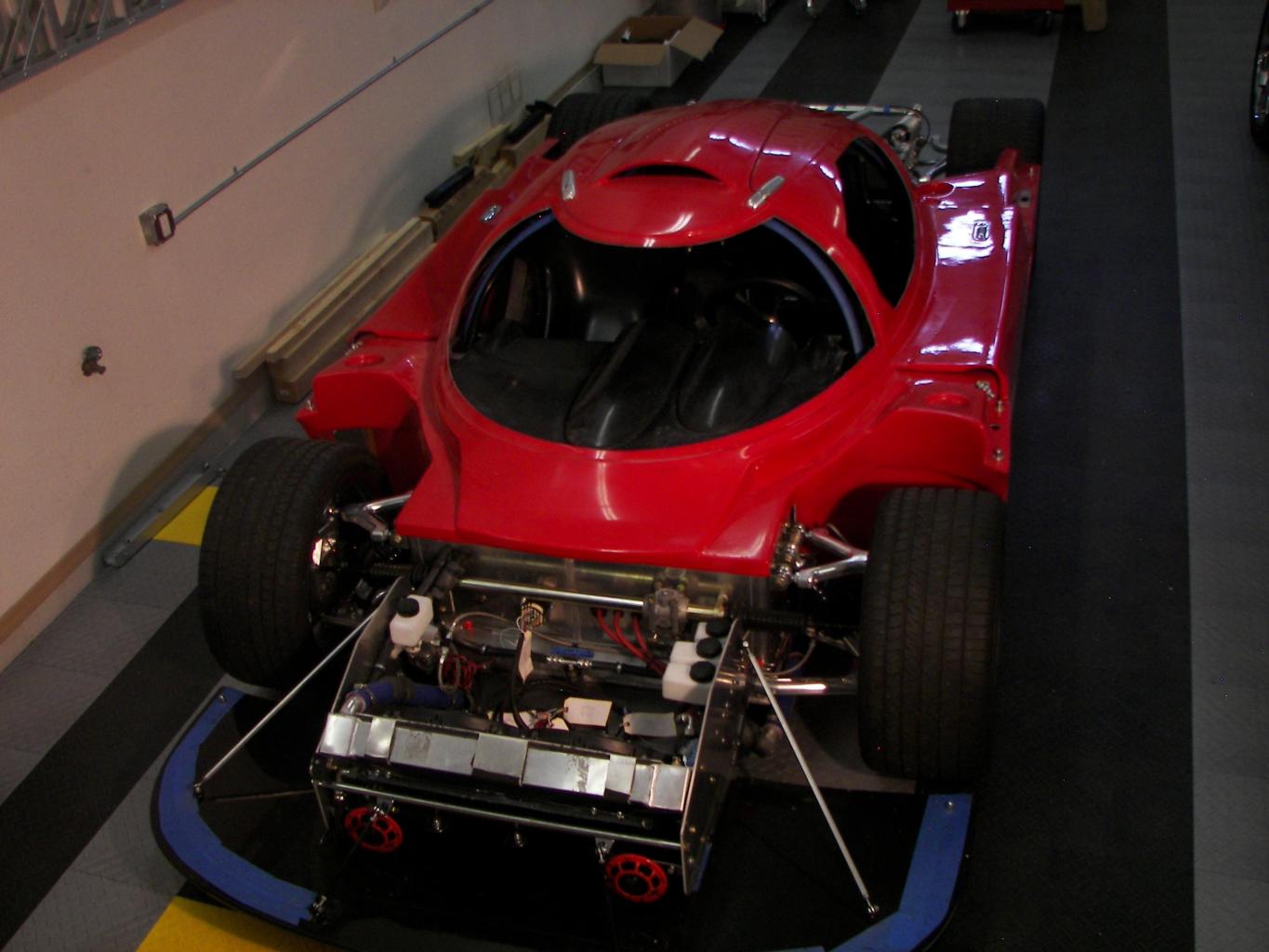

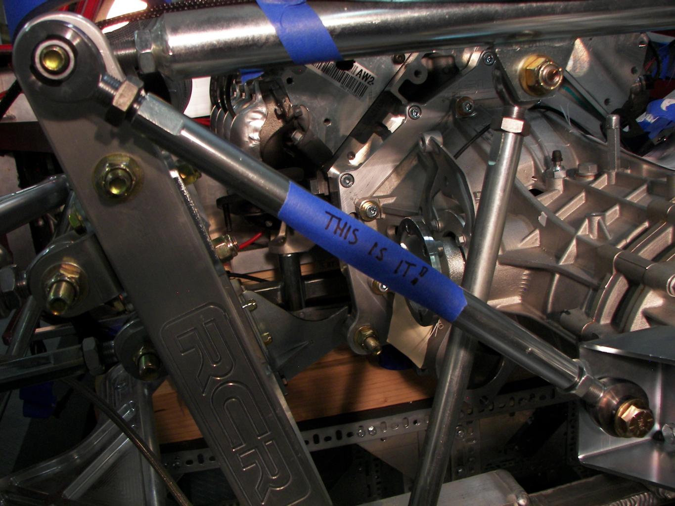

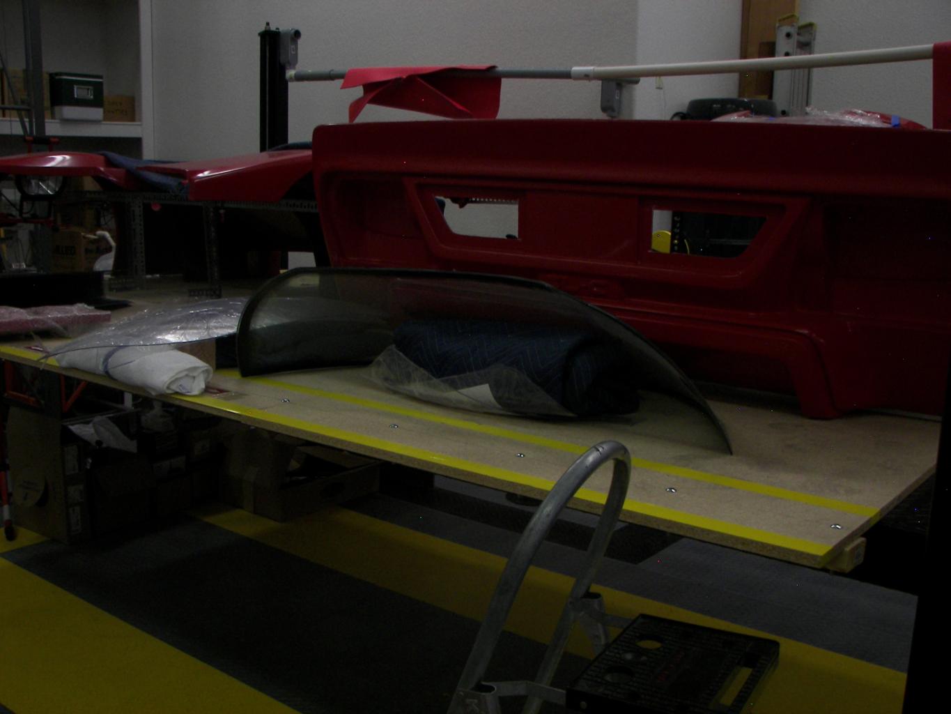

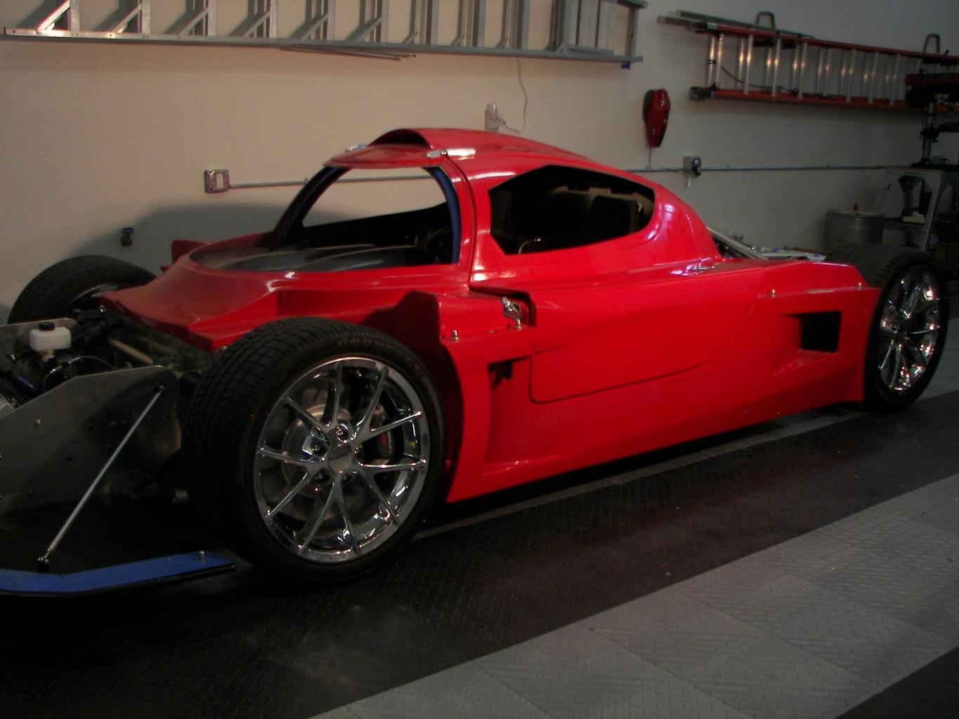

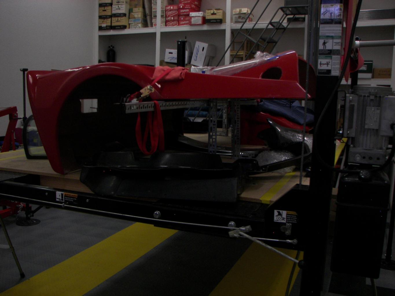

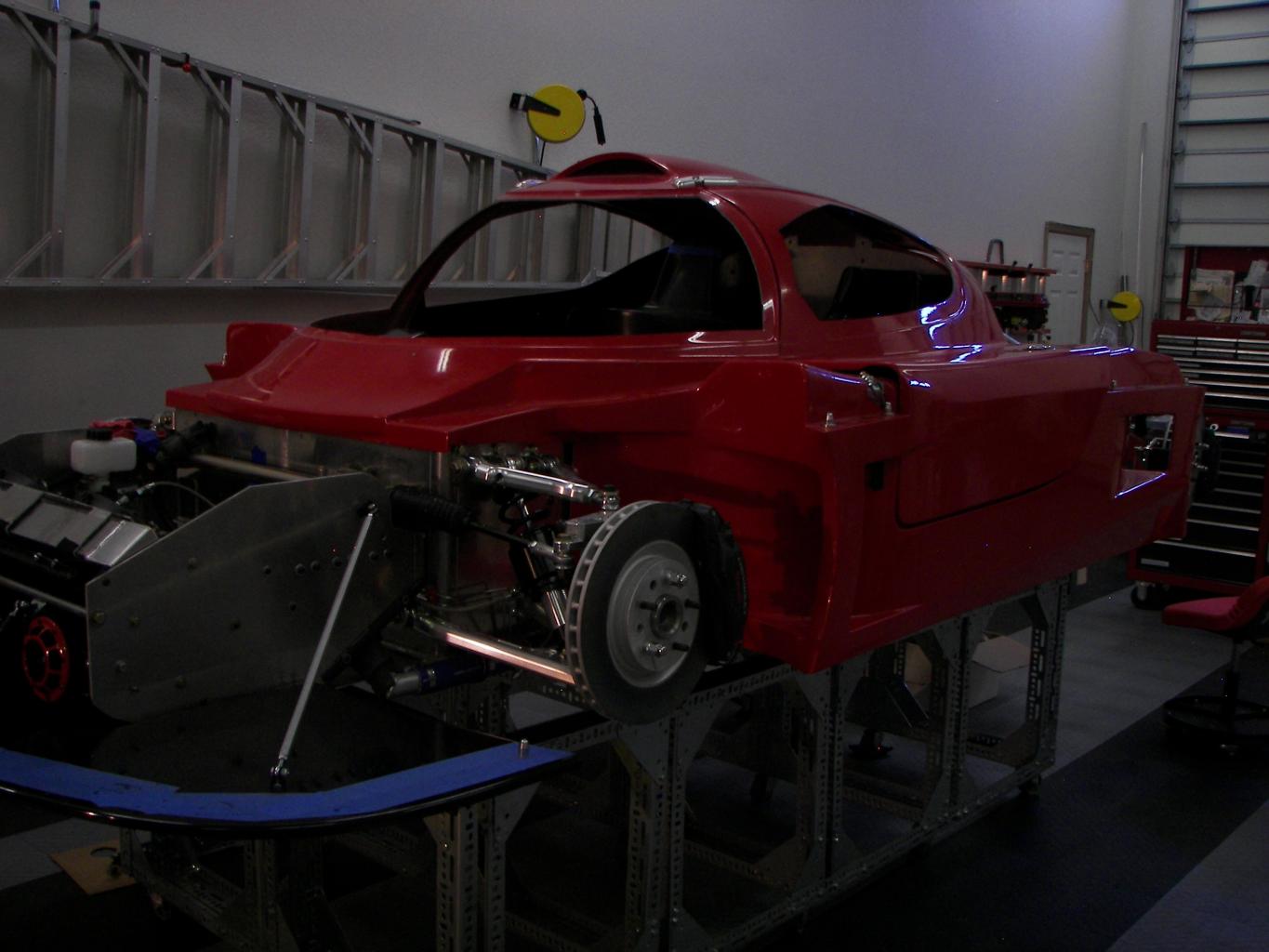

We fitted the center section of the body ( about a half a dozen times) onto the chassis (pics. 001, 002, & 003) to make necessary cuts for stand-off's, brake fittings, coolant hoses, etc.

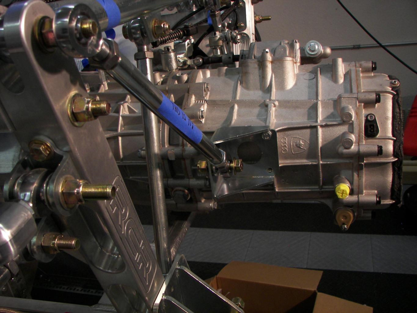

My back ordered Graziano braces and shifter/cable bracket arrived. Here's a couple of heads-up for you Graziano builders just now receiving there parts.
FYI Graziano support braces:
  1. All these months of staring at the Graziano I never realized that the Graziano is off-set and not centered. Therefore, the braces are not the same length. The longer arm goes on the drivers side (ask me how long it to figure that one out). That little piece of info should save you so time.
  2. The 4 bolts on the gear box bracket are symmetrical; so that means it could bolt up any of four different ways. Again, having never seen a Graziano and not having a manual, I guessed wrong a couple of times; (see pics. in post #97 for the correct orientation) and I still guessed wrong about which side the support brace went...inside or out side!
FYI Graziano cable linkage bracket:
  1. The 3 mounting bolt you will need are 8mmX20mmX1.25 pitch.
  2. The holes on the bracket do not line up with the tapped holes on the Graziano; therefore, they must me enlarged.
I also just received the back ordered clutch and fly wheel for the Graziano but can't do any thing with it until Fran gets me the rest of the missing Graziano parts. I can just imagine how much fun that will be without any instructions!

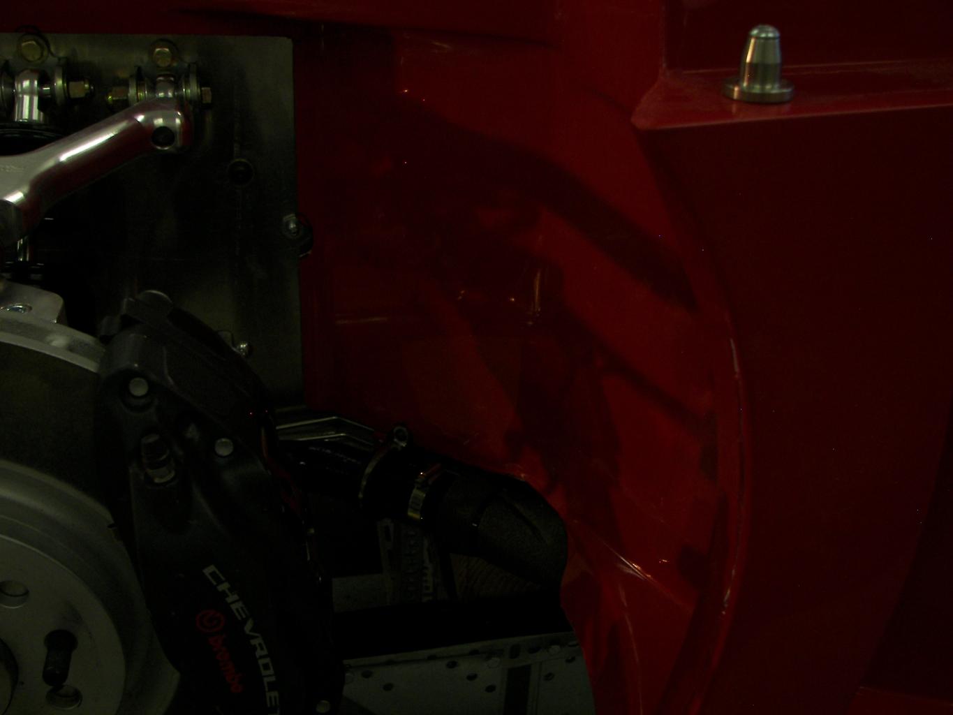

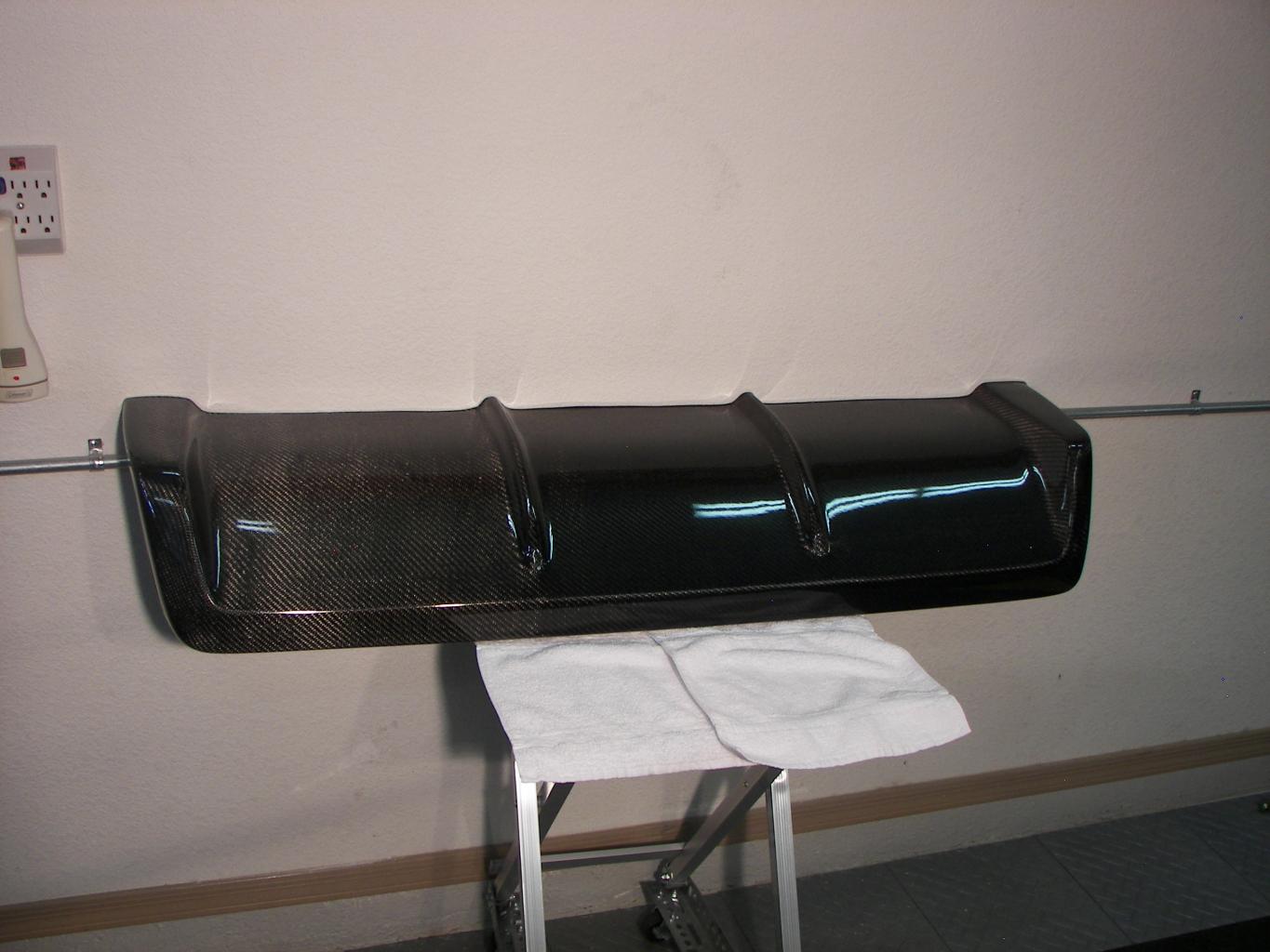

I'm in the process of tiding up loose end and reinstalling the body; as I get the rest of the body installed, I'll post some more pics. Pictured in pic. #007 is a beautiful carbon fiber rear tail peace. This a $495.00 option and I forgot to list it in my ad; therefore I'm going to include it any deal made.
