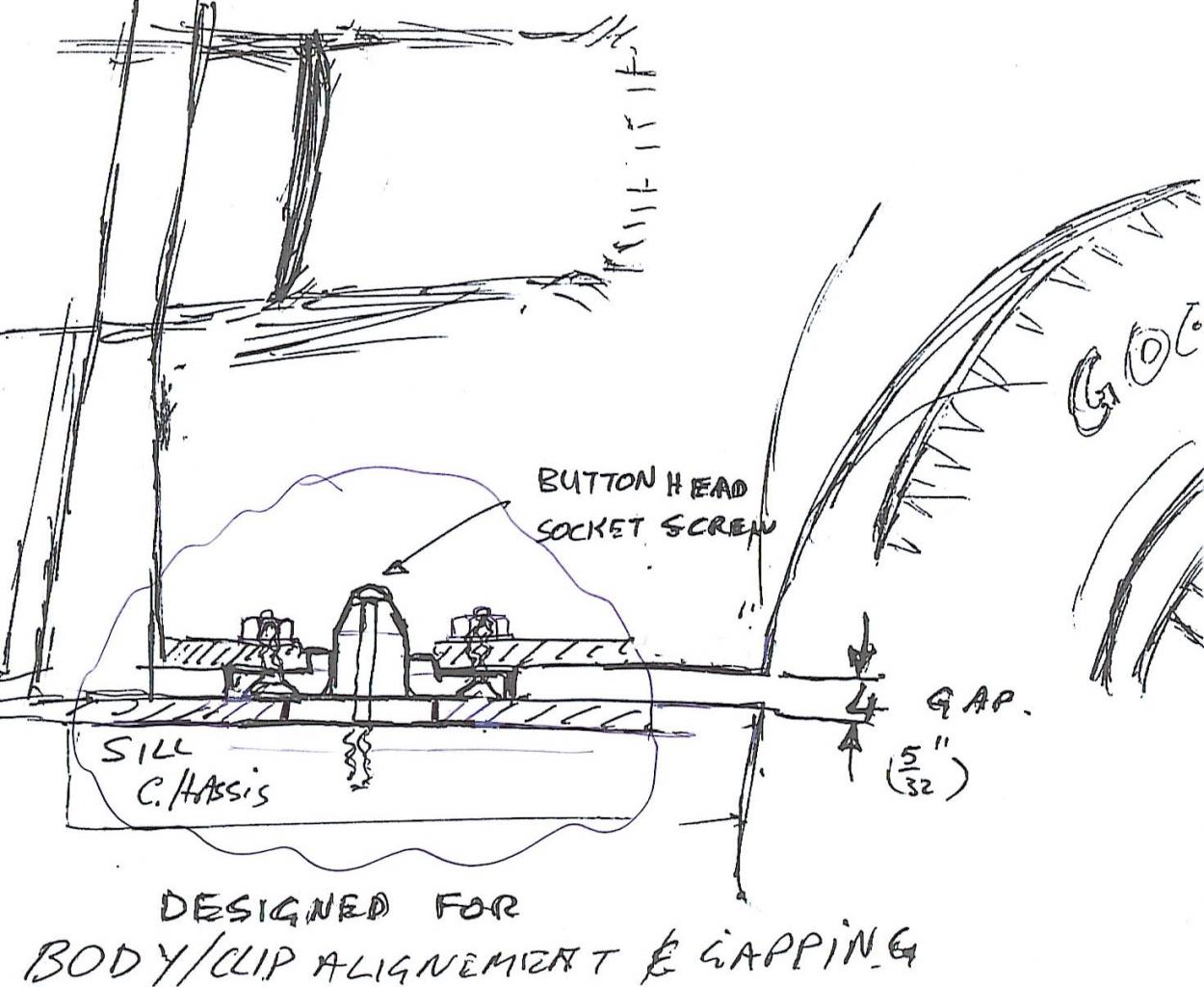

Ok... Someone have a photo of the correct orientation for the these? I think the protruded side goes up but.... Thanks
If those are the alignment pins for your clips, The black plastic part goes in the clip and the stainless pin is screwed to the sill... or am I misunderstanding what i am looking at?
Chuck
Those don't look anything like the clip alignment pins on mine. Don't recognize them. If, hypothetically speaking of course, they were alignment pins, I would point them upwards into the pocket on the clip. Perhaps there is a cone missing?
Give us another clue . . . .
The pin with the screw has a "conical" shape that you would think goes in the clip but the black plastic part has two holes that are counter sunk. The odd thing is the counter sink would be facing down which doesn't make sense. I think I saw these in Rob's car in one of his photos with the cone up. I also saw something like this on Jason's car but the flat side was facing up. Not sure which one is correct. I'll take more photos. Anyone have a photo of there pins?
Chris Kouba
They are the alignment pins for the clips.
The allen head cap screw gets threaded into the sill, the black nylon gets recessed into the flange on the clip. I don't think I have a pic but will hunt around shortly.
CK
edit: found one-
Cone goes on the sill with the bolt through it threaded into the alu sill, black nylon insert (no pic, sorry) goes on the clip in the "correct" location.
Thank you guys! Chris, so the black plastic flange sits flush with the aluminum or is it proud of the aluminum? Wouldn't that cause the rocker to not sit flush on the aluminum? I'm referring to the "squareish" shape part. I realize the round plastic part goes into the aluminum.
Appreciate the help!
OK...
the stainless pin is mounted to the rocker panel.
A hole to match the size of the round raised circle is cut into the lip on the bottom of the tail edge.The black nylon shoe is attached to the inside of the tail with the roundraised circle protruding through the hole.,
The 1/8 flange on the stainless steel pin then creates a 1/8 body gap when the tail is closed.
Due to differing thickness of the fiberglass layup, it may be necessary to smooth the mounting surface on the inside of the tail to give a flat, solid mount for the nylon shoe.
flatchat(Chris)
A rough sketch of how they were originally intended ---but there's no wrong way to have them mounted -- why, they even use them quite effectively as door hinges

Chis,
thats similar to how we install them but we use the stainless pin to actually clamp the rocker panel in place...hence the flange on the stainless pin creates our body gap vs the flange on the nylon shoe...
This only for the RCR40...the SLC has a pocket moulded into the body for the nylon shoe....
Chris Kouba
Nope. Nylon (black) piece gets flush mounted with/into the flange on the fiberglass clip.
Be precise when drilling your holes because, like Fran says, you sandwich your sill panel between the stainless cone and the alu chassis to hold it in place (like in my pic). I can take a better pic for you later today or you can call if you still have questions.
CK
I got it! Thank you guys for the clarification... Honestly, I'm really good at building cars! :) Hey, some of this stuff is complicated! Two pieces on that one!
