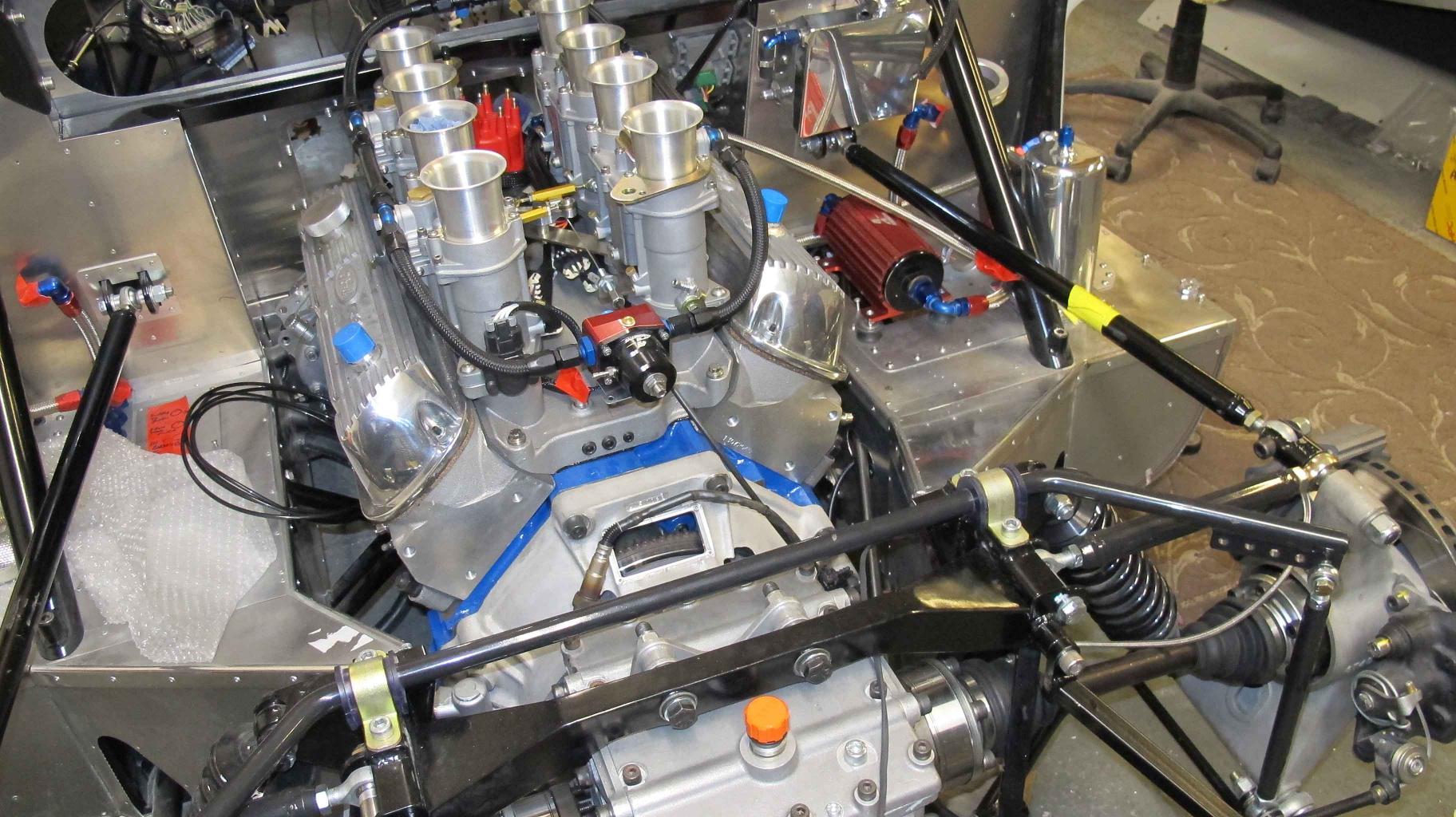

As discussed the wiring loom for the 8 stack injection was huge. Care would be needed to cut out excess wiring and circuits not needed and this is beyond my capabilities.
I have had this done by someone else, remaking the wiring at the connectors and the result appears to be far better.
Some of the loom will be seen above the manifold and what was not cut away is hidden in the drivers engine bay area.
The ECU is also in there with wiring for the laptop exiting into the car for future setting up.

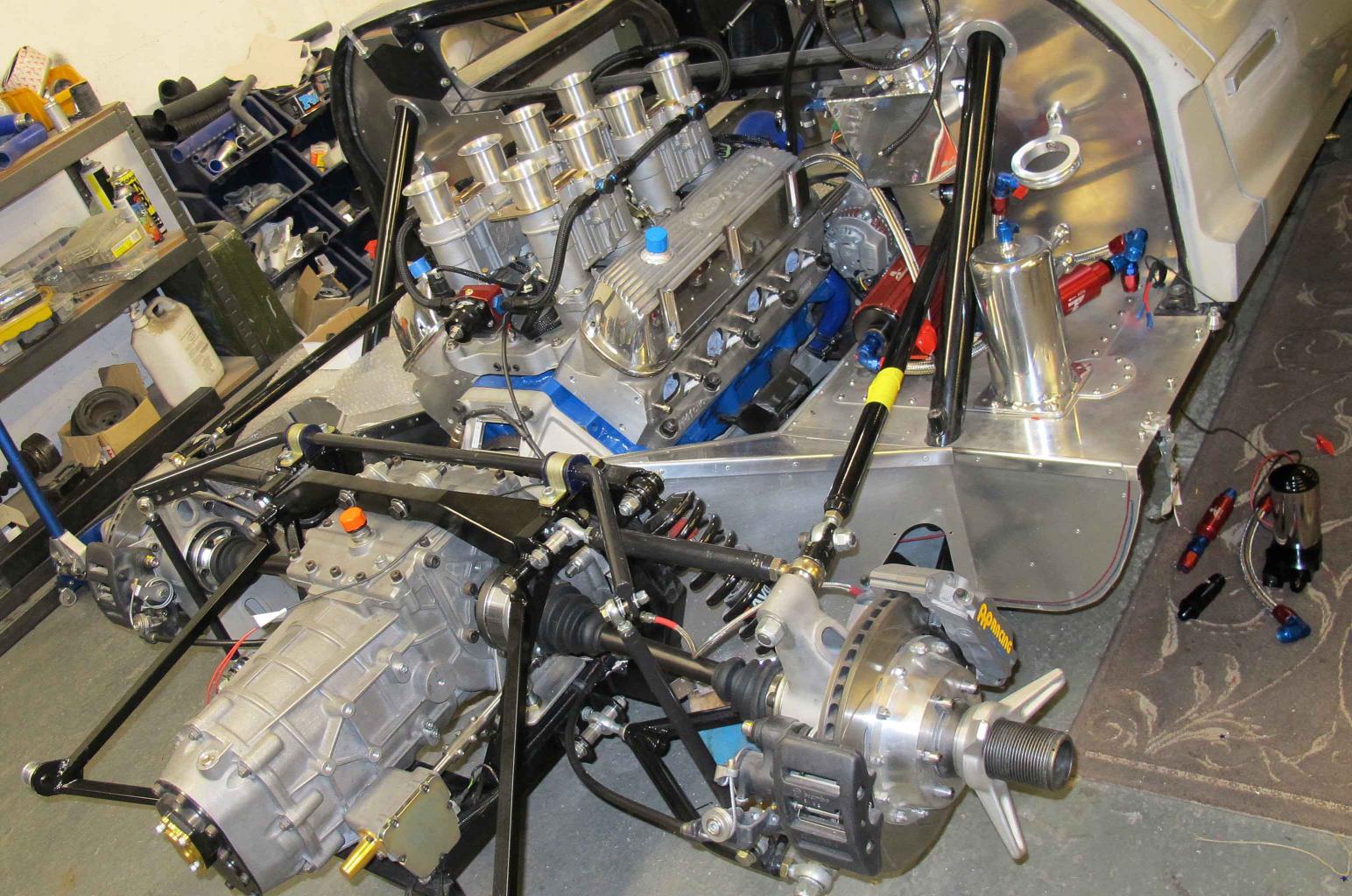

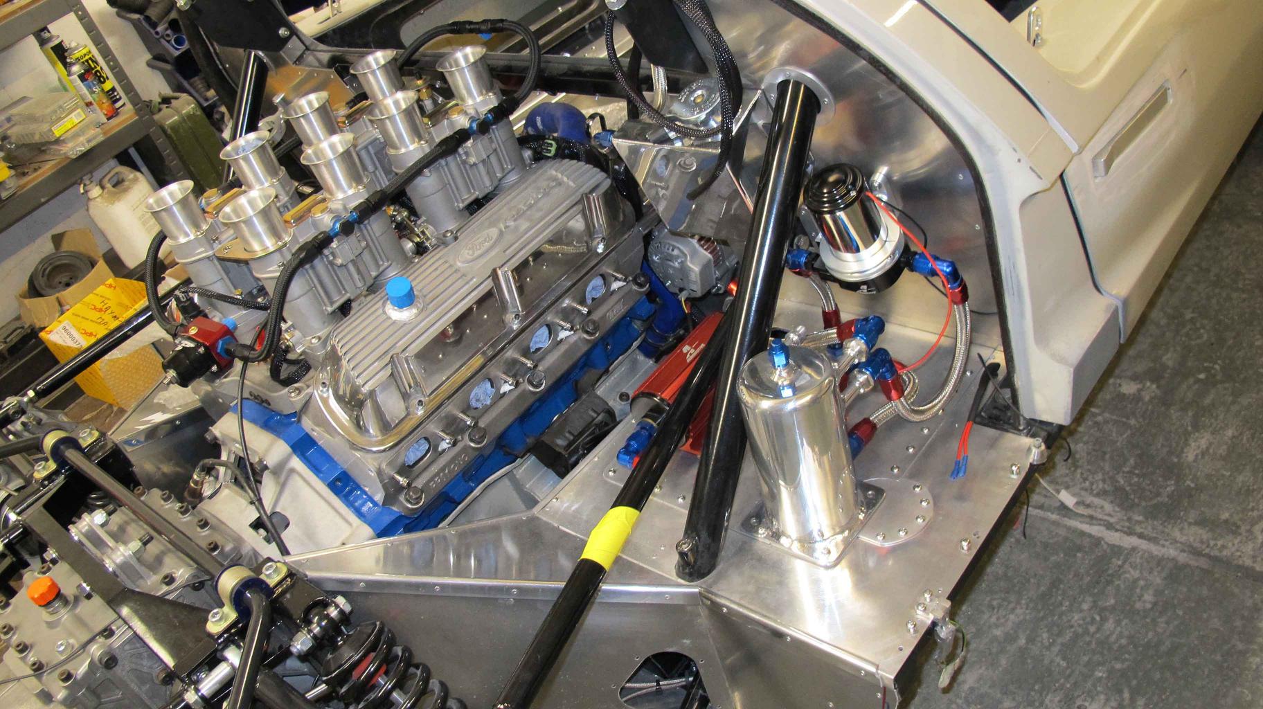

Although there are shortages for completing the fuel system, the drivers side pumps can be finished.
The Aeromotive NRV will be installed from the tank and before the filter thereby hopefully keeping the filter and the pump primed with fuel.
The fuel regulator will be mounted on the bulkhead somewhere

Hi keith will send you some pics by email tommorow dont know how to post pics on gt40s.You can leave it where it is but the plastic will get very hot as its close to exausts we move it to the front to get it out of the way .

Can the throttle sensor not be heat shielded or is it easy to move ?

Keith, as Mick says, you must move the throttle position sensor, but I also suggest you move the fuel pressure regulator as well, you are going to run into all sorts of problems where it is, the ali body of that unit will swell with heat and seize the internal valve very quickly, I would turn the whole system around and keep it as cool as possible, Frank
flatchat(Chris)
Just imagine a big hot air gun set at around 300°C blowing hot air from the back of the motor towards the front--right about where you have all those heat sensitive thingys (thats from experience as well)

The regulator will be moved it's going on the bulkhead it's only shown where it was when dyno'd and to lazy to move it yet.
Point taken about the plastic bits, There'l be gone before you blink !

The fuel system on the driver side is getting there, still got to decide the best route for the tank air bleed / rollover valves and the fuel return lines.

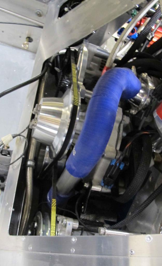

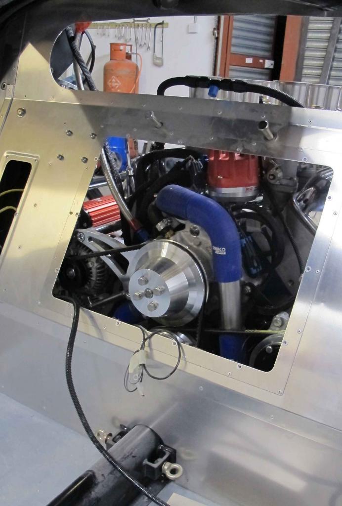

The water pipe route is all but decided and the best option for the water temp. sender will be to weld a 1/8" threaded block in the ally down pipe. It could go elsewhere but once the down pipe is fixed it will be out of the way.
Getting tighter for space everywhere now.

that V-belt is very close to that water-pipe...may hope it clears enough when the heat is in it otherwise it could be scary? or is there still a little room to play with so they clear enough room.
Hi Rene,
Picture is not that clear but the pipe will be clipped back and will be ok.

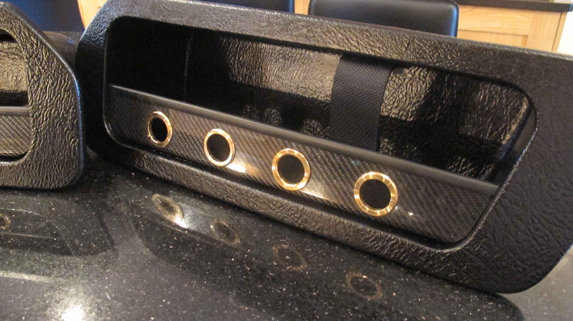

I prepared and painted the door boxes in satin black. I used Hammerite satin black, it's self priming one coat and hand painted with a brush. Because the finish is crinckly / leathery you need not be to critical.
As mentioned before prep the surface well, degrease and paint.
Dont put a second coat.
You CANT scratch this off.
Now the rest of the spider will be done later.
You could pull the door shut with the carbon and it wont move but the strap is there to shut it.
