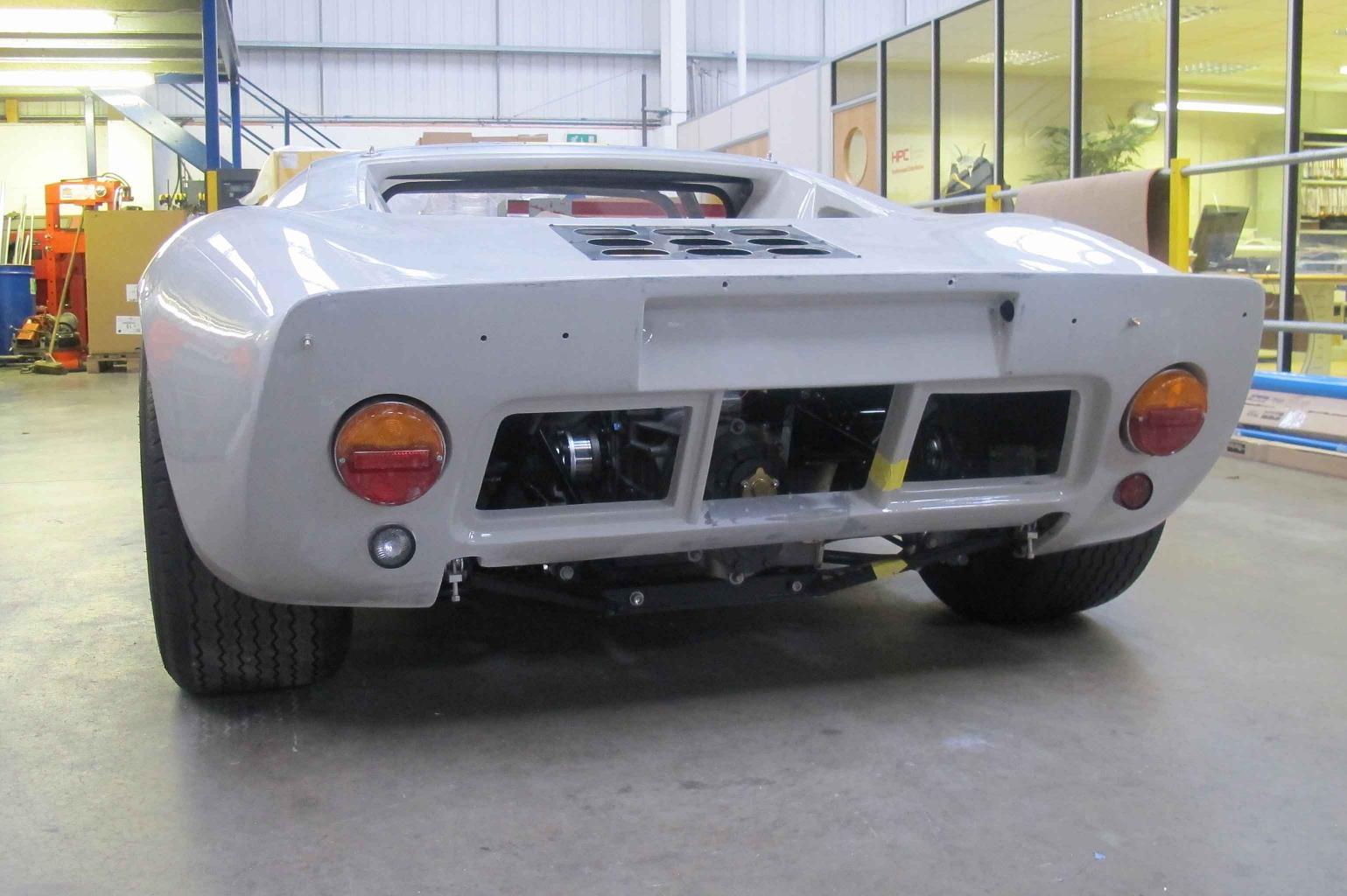

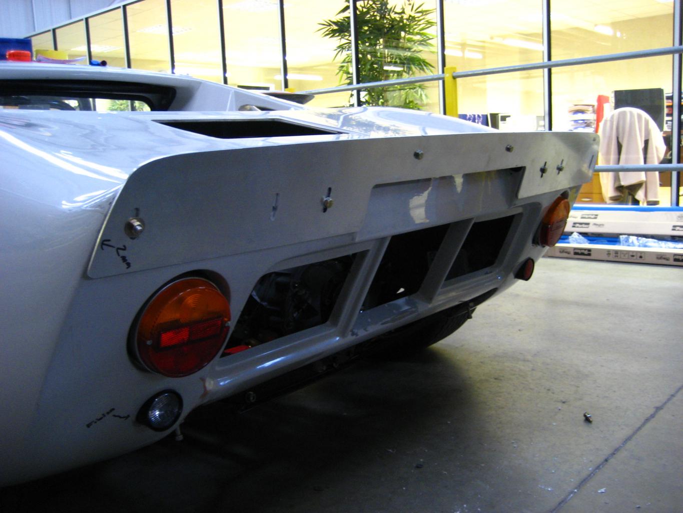

Trial fitted the rear diffuser made from 4mm thickness aluminium, laser cut with 6 fixing holes.
It will need two more fixings above the number plate to ensure a good fit and the edges will need a haircut but good value for money at only £ 65

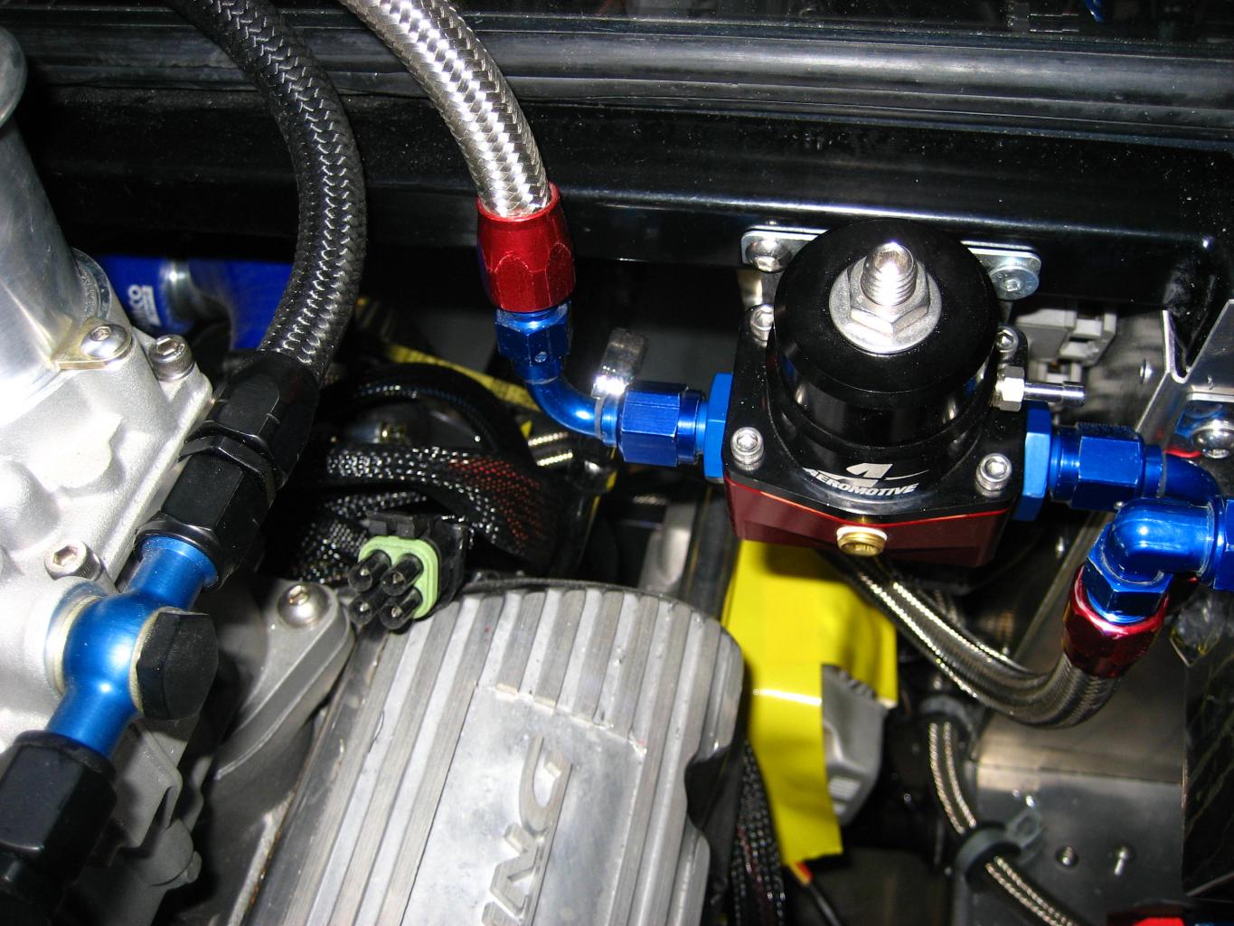

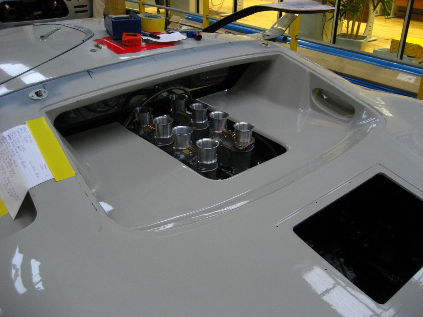

Pre fitting the fuel regulator, having to watch where things are fitted as space is tight.
Quite often you can fit something and then find it is in the way of something else.
The rear deck for example just touches the injector fuel line fittings on the bodies.
It will require about 3mm to clear but to keep cosmetically similar I will trim out about 5mm on both sides.
Trial fitted the rear defuser and all that was needed was about 6mm of one end and a bit of a haircut. It will be powder coated when fully prepped.

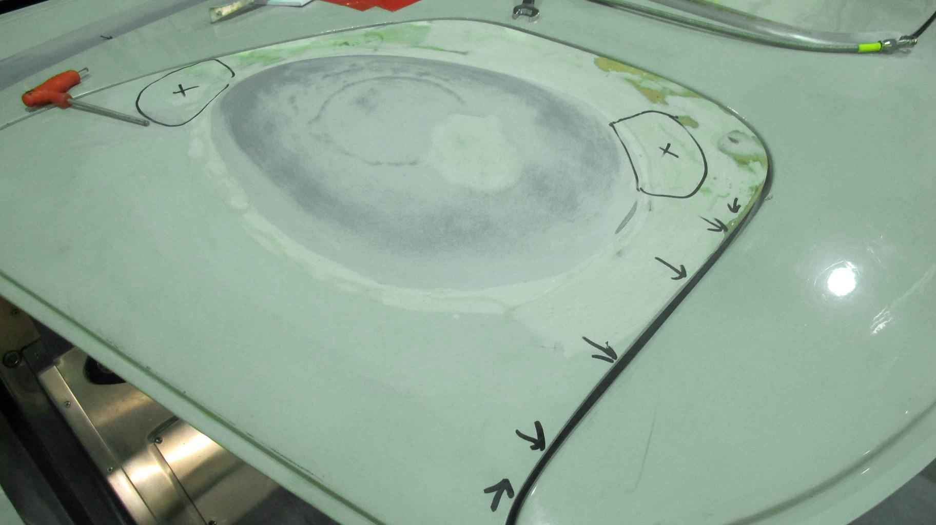

Today the painter came and had a look at the car and will put a price together.
He knows what is expected of him as he has painted many of my motorcycles. I marked areas of the car that I think need attention such as gaps, uneven areas etc. Most cars will need priming and blocking off to get rid of ripples and uneveness and mine is no exception.
Pictures show where the Gurney bump was fitted and how this distorted the shape of the door top a bit, but it's no problem.

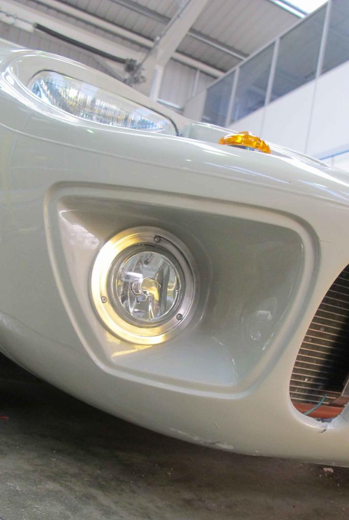

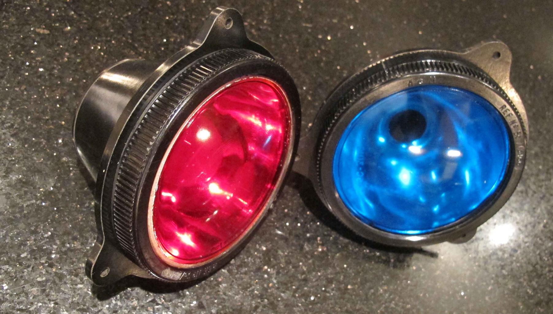

I have opted for high intensity spot lights under the headlamps. These are smaller than the originals but now have an ally ring surround which will be polished or chromed.

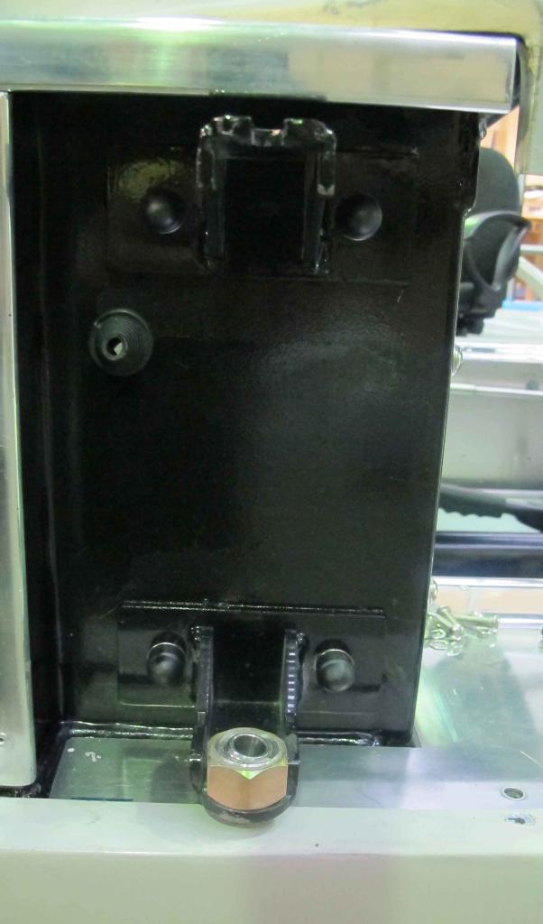

I have decided to have SGT fit one of there Central locking systems so thinking ahead have drilled the doors and the chassis section by the doors, The wiring can then be installed without further cutting of panels. In my opinion the doors are hung OK so all lock nuts and stainless washers are fitted and any paint touched up.
There will be a light fitted for the door roundel so the wiring will be needed for that as well.

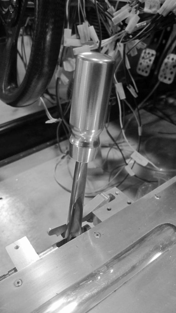

The Gear assembly from SGT is really nice and the gears are smooth.
The gear lever is only rough cut stainless that needs polishing.
Also gear Knobs that you buy have silly plastic inserts that dont fit well, so I machined up a collar for inside the gear knob that threads on the SGT bits and it's solid as a rock,,, and shinny.

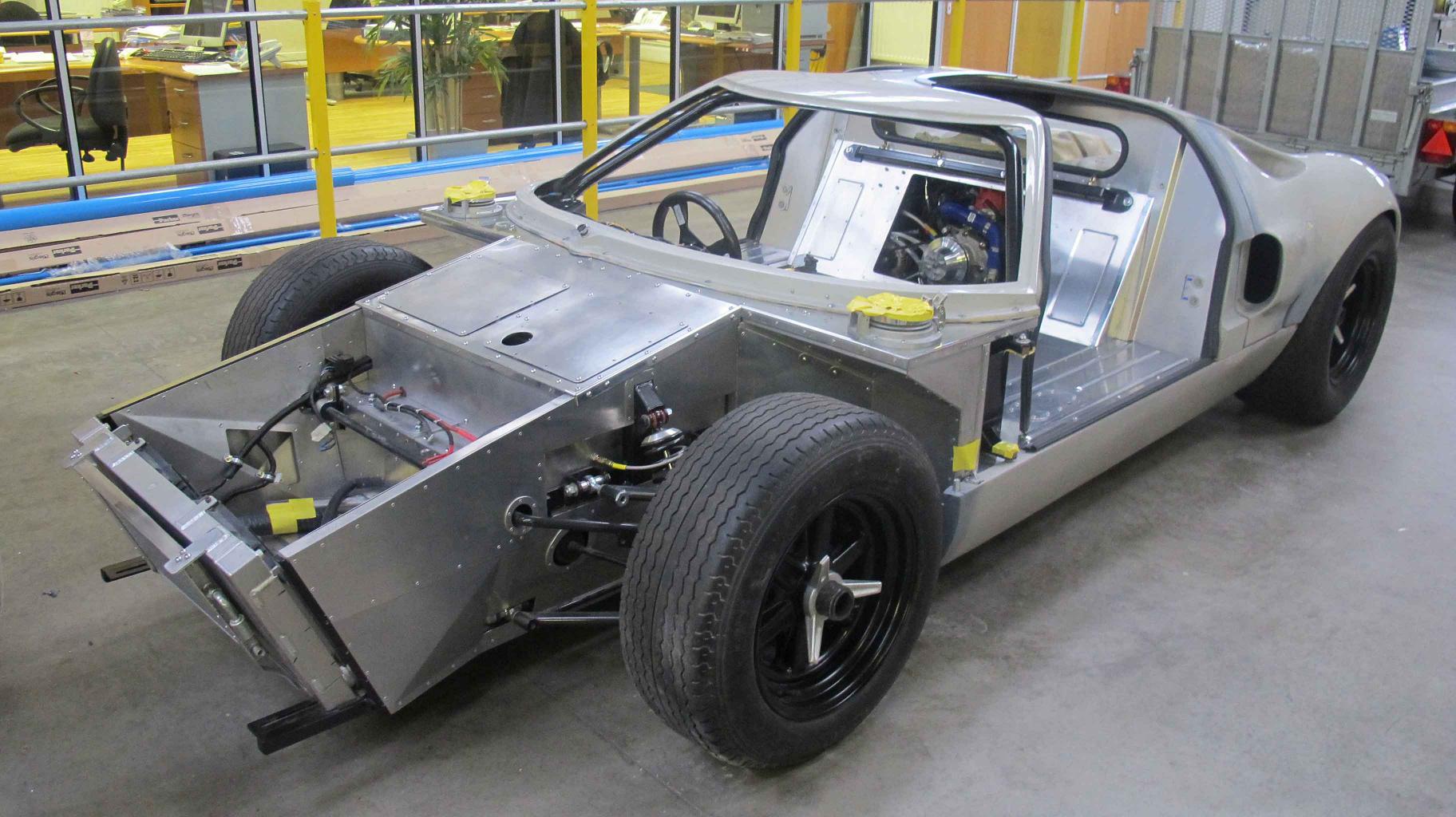

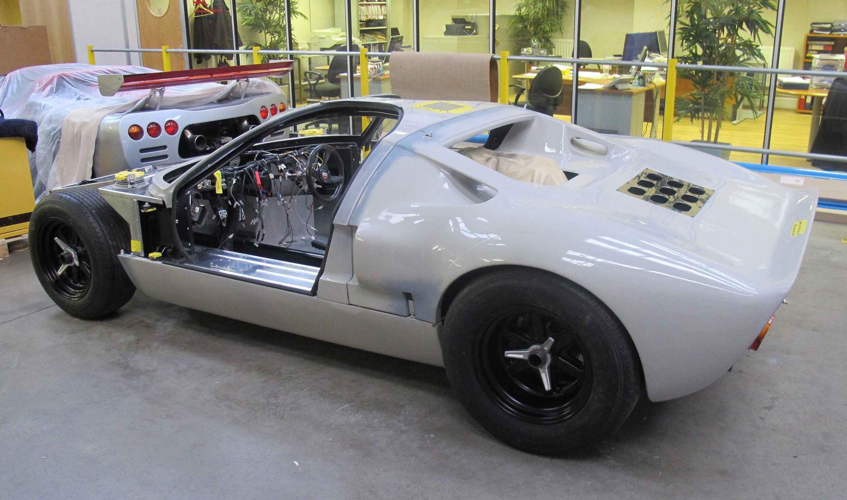

Car stripped again just before it goes to SGT to have the exhaust system made, this will take a week or so and then it will be sent away for coating.
The car will be returned after the exhaust is made so that I can carry on.
I have removed the parts that SGT wont need like doors, front section, all brackets, door handles etc that need either polishing or finishing off.
So were looking a bit backwards again.

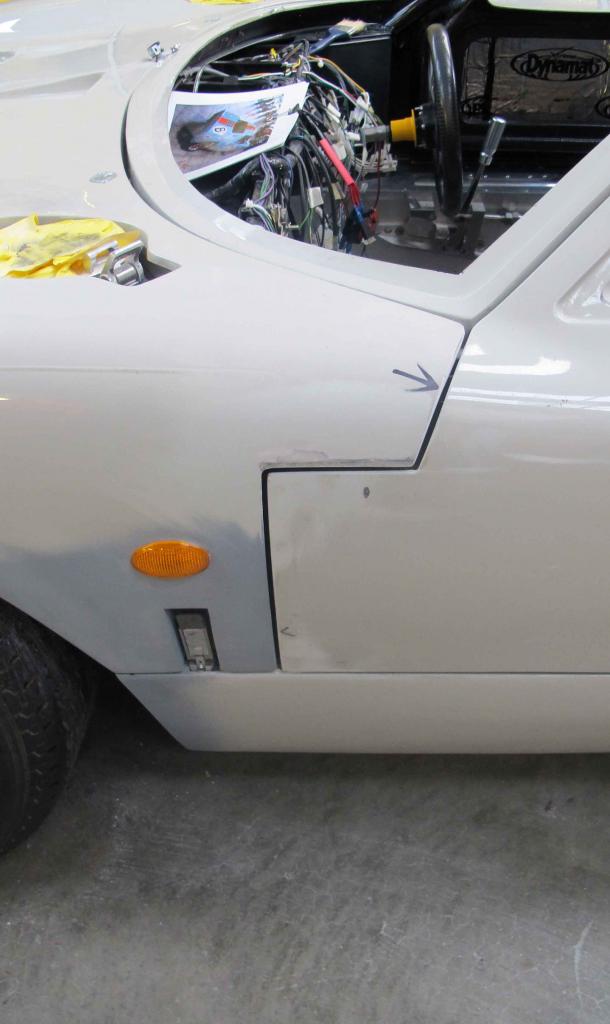

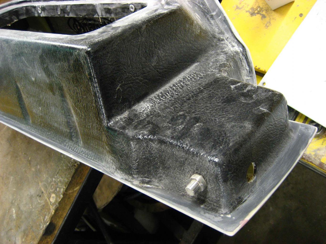

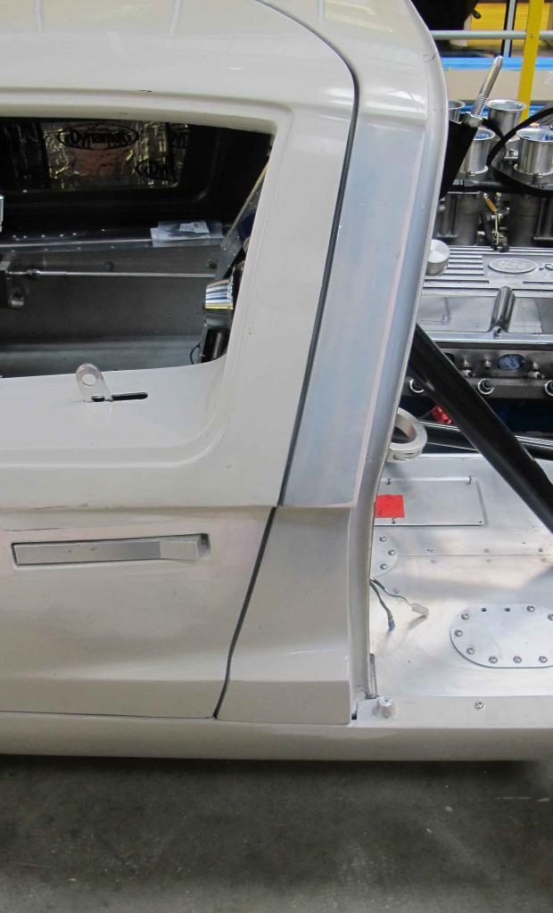

Since getting the body and doors pretty good, they seem to come off and on really easily. To remove, fitted and aligned in seconds.
So it's a good time to get the gaps better as they are on and off more times than a whores draws.
On talking to the painter, the more I do the less he has to do and therefore cheaper.
On the passenger side ( shown in the picture ) there was a larger gap by about 3mm which I could not get closer, so I cut a 3mm piece of fibreglass panel, 5 ally rivets were countersunk and bonded onto a pre roughed up edge. The result was rubbed down with 240 grade and it's solid as a rock.
the door gaps are as good as I'm going to do.

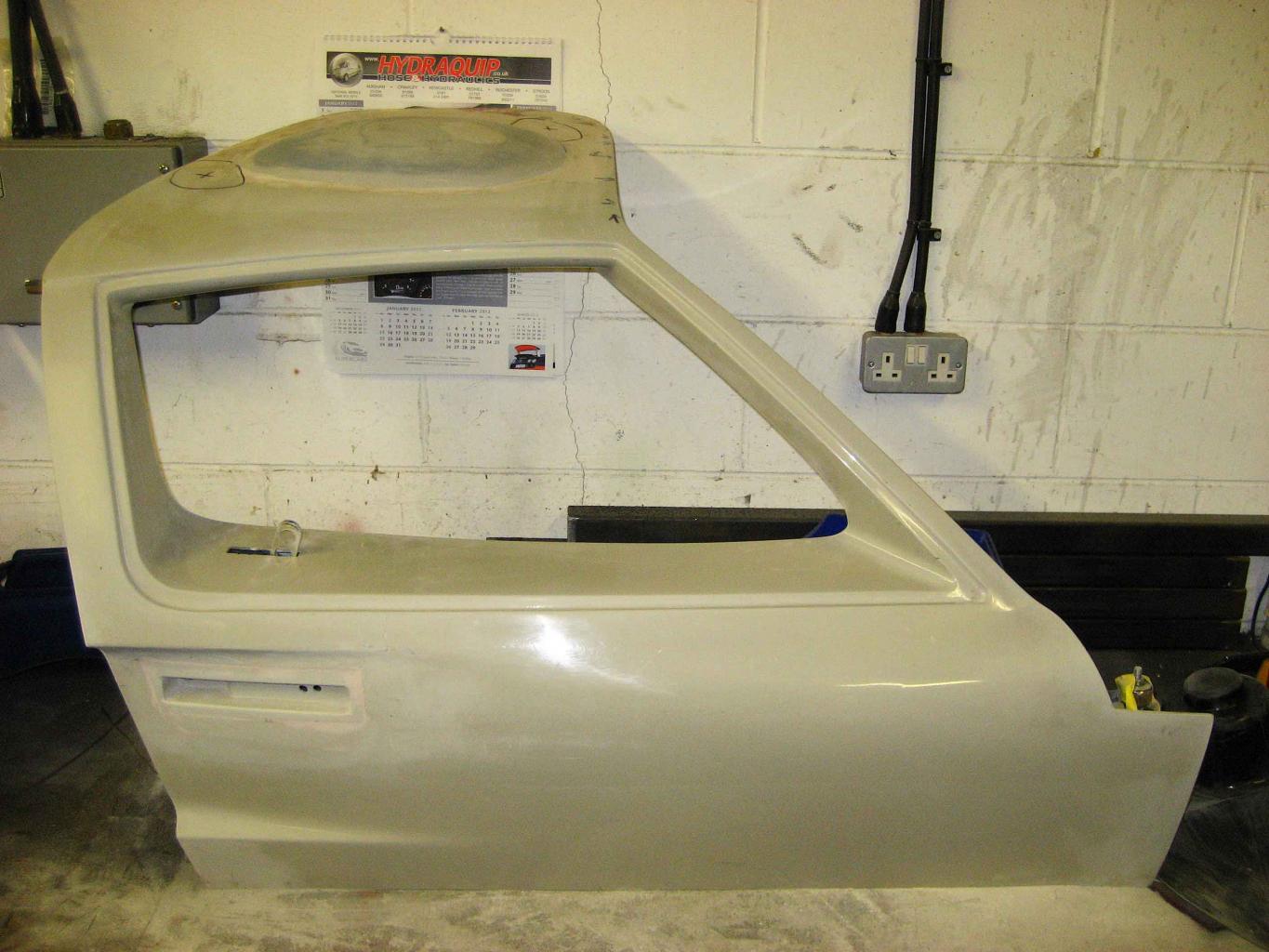

Started to smooth off the edges of the doors, around the locks etc and get rid small chips and digs, the paint shop will do the rest.

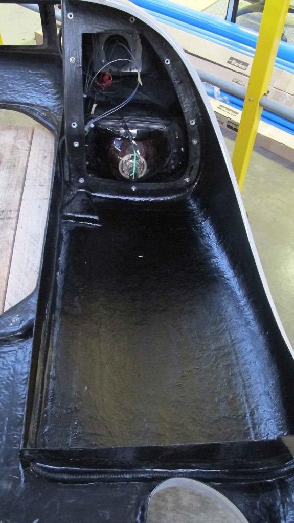

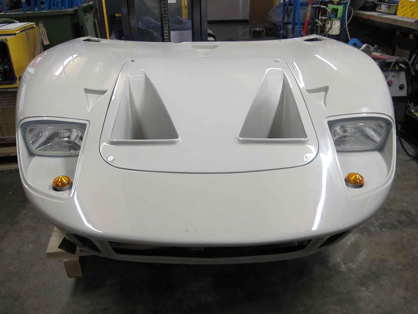

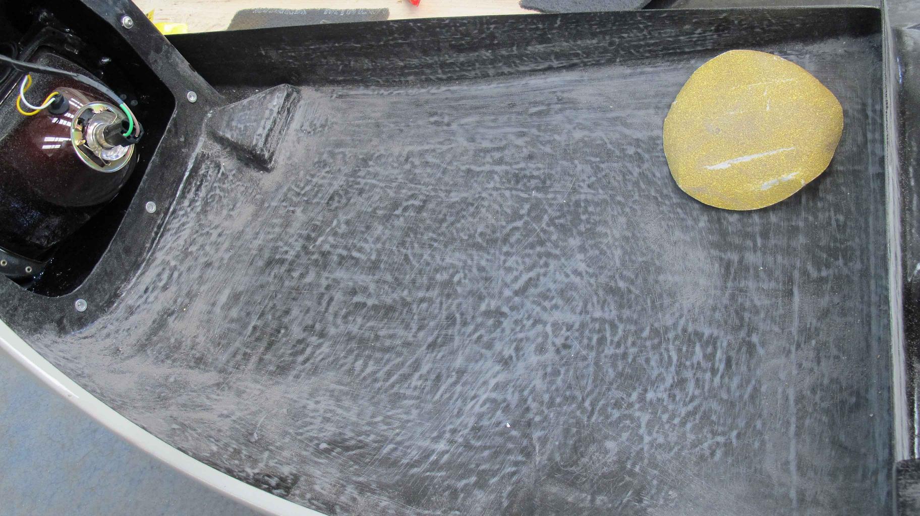

The front light covers just touch the bulb holders of the headlights so I made a cap to get the clearance . The cap is actually a spray can top, cut and bonded into the panel then strengthened with filler on the inside. The whole panel will be sprayed with body Shutz stone guard, as will the inner wings where stones can be thrown up.
As it's sought of rubberised it will stop the chips that make spider marks in the gel coat that are hard to get rid of.

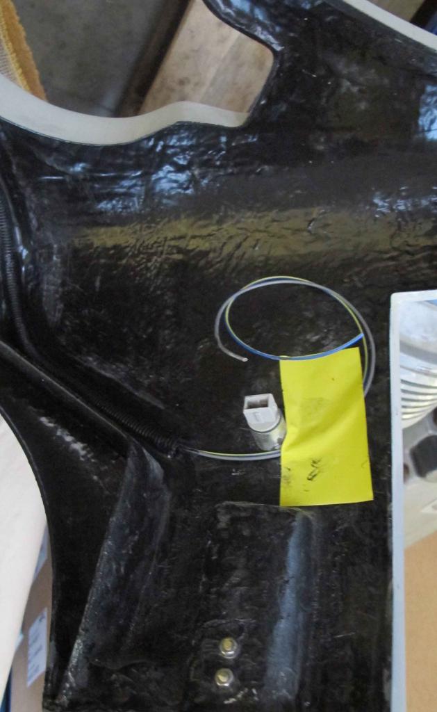

I have been tidying around the headlights, fitting the wiring to the repeater side indicators and putting a coat of body Shutz on the wheel arches to stop stone chips.
It will require a further spray Shutz after the car is painted
I have taken the side repeater wiring from the indicators and just piggy backed it of them.

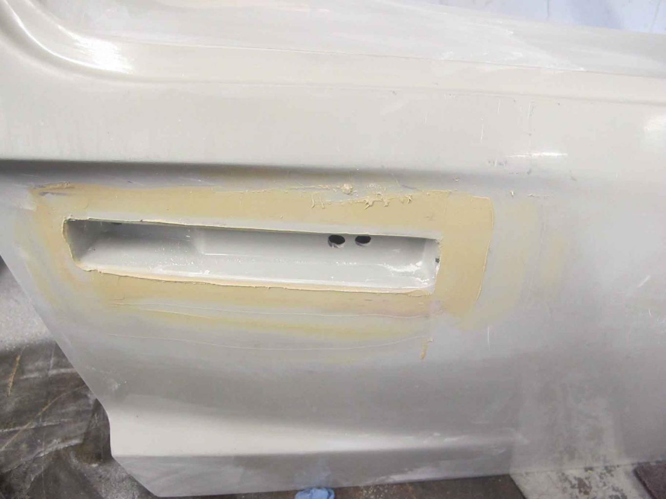

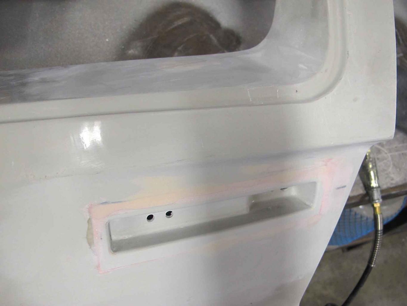

The door latches were upgraded to the latest style from SGT, which meant they had to be cut into the doors. I finished them off today, also I decided NOT to use the standard door openers on top of the door but have them inside in the door boxes.
This meant filling in the lever hole which is also now done.

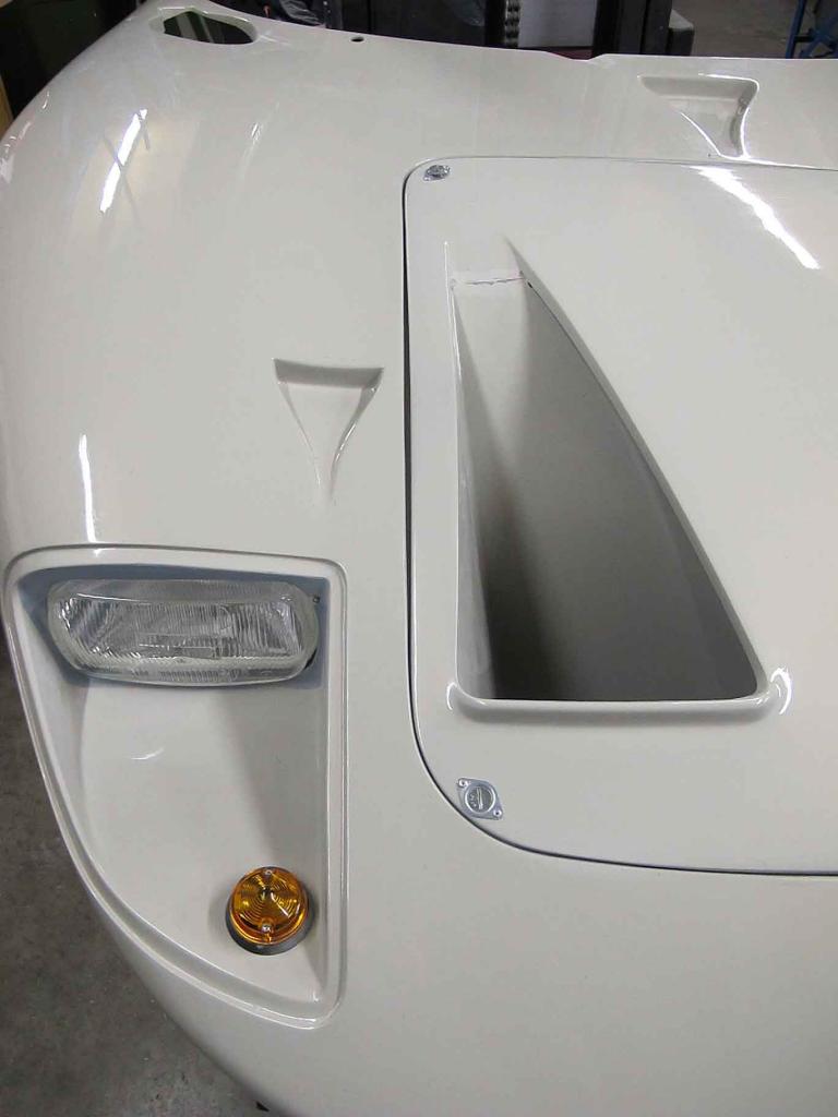

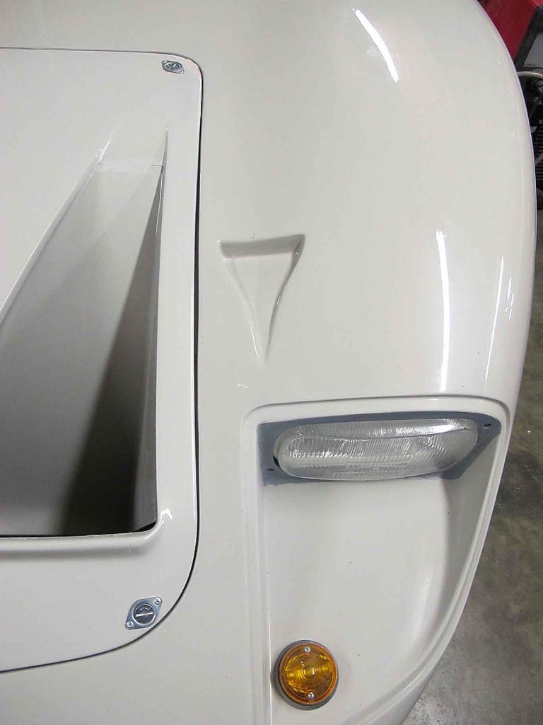

I fitted the front nostril panel which needs a few hours on it still.
As you can see in the pictures there is a bow in the side of the panel. A lot of people leave this bow but I will make it better and the bodyshop will finish it off.
Made good around the headlights and spots..
