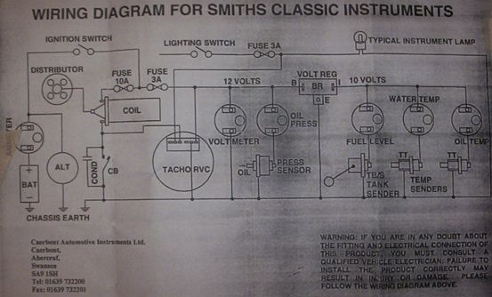

According to this wiring diagram, oil pressure should be 12v. Oil temp is 10v.
12v:
Volt meter
Oil pressure
10v:
Fuel level
Water temp
Oil temp

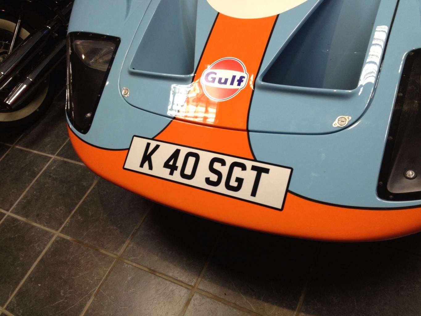

Hi all, been putting a few hundred miles on the clock but still got a few jobs to do. The car runs well though.
Decided to replace the front number plate as it actually covers over half of the cut out for the radiator, nevertheless the car only ever runs at about 90 deg, so with the plate removed it should never run hot even if we ever get a summer here in the uk
Fitted a stick on plate which not sure is legal ,,,probably not.
