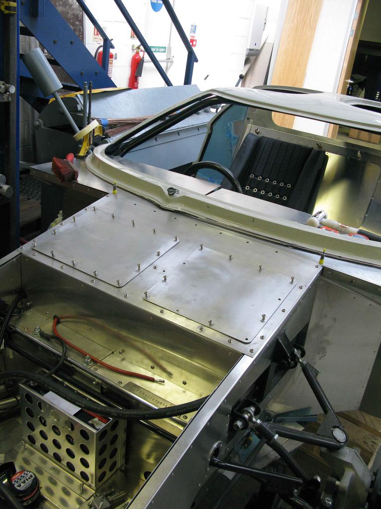

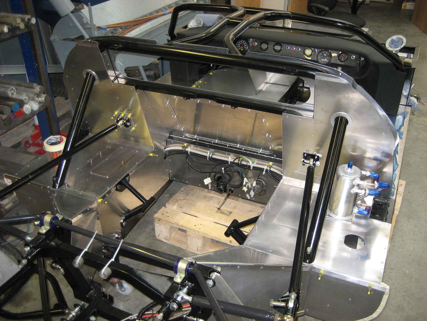

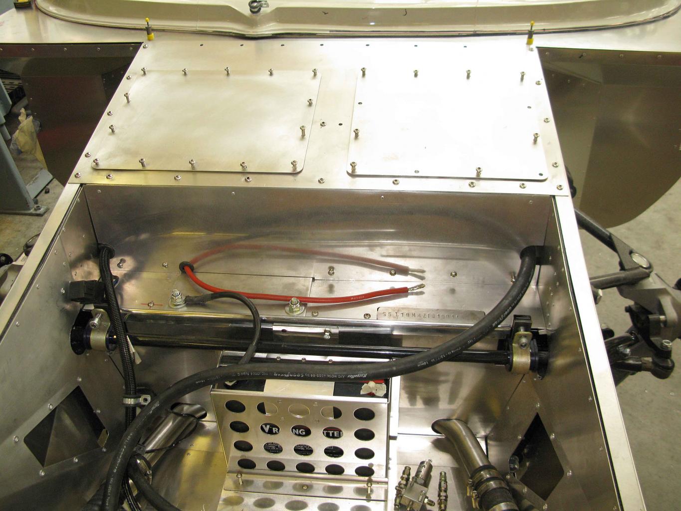

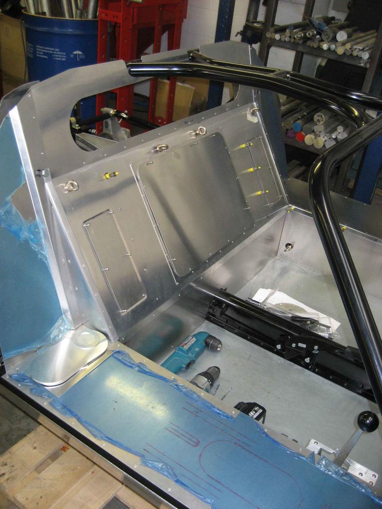

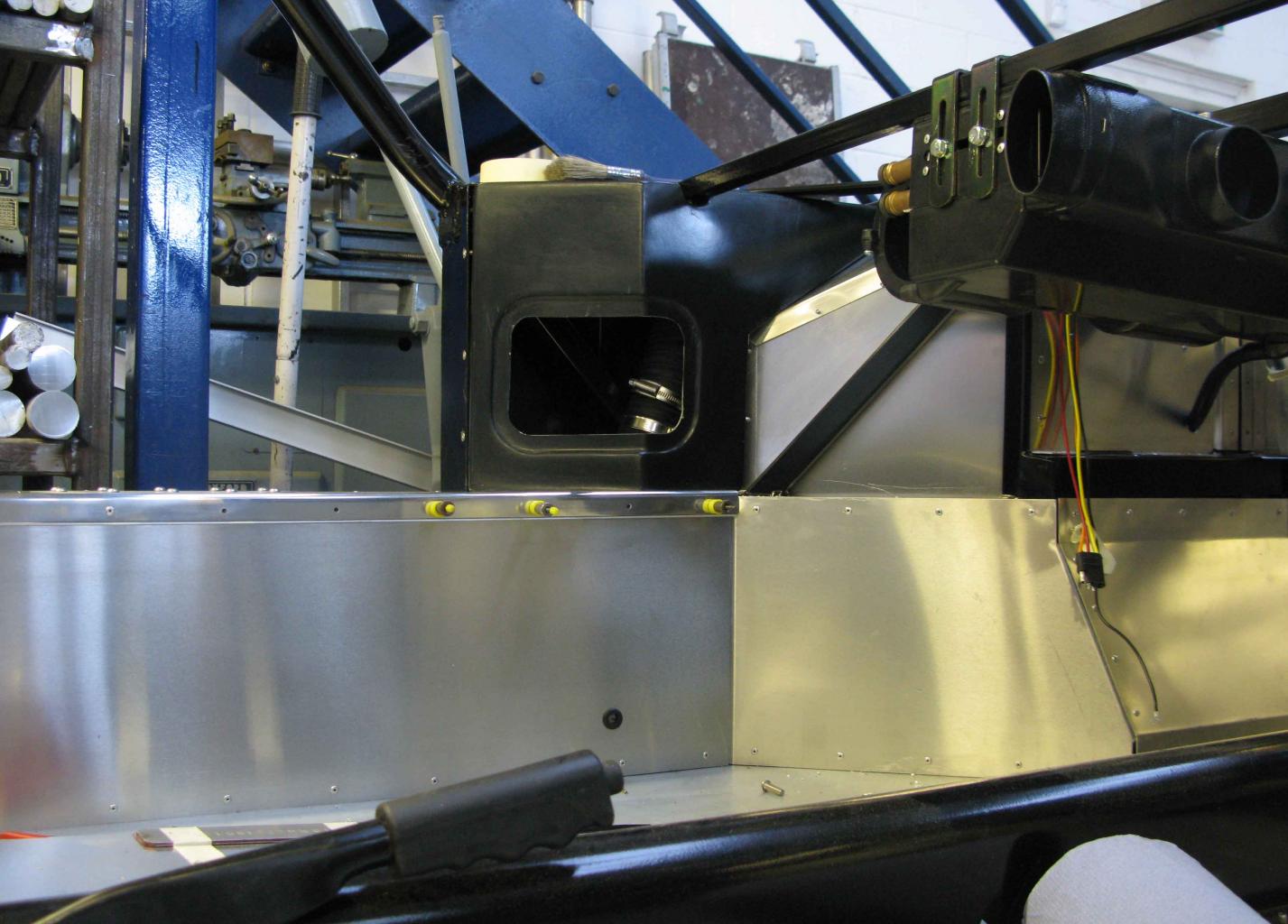

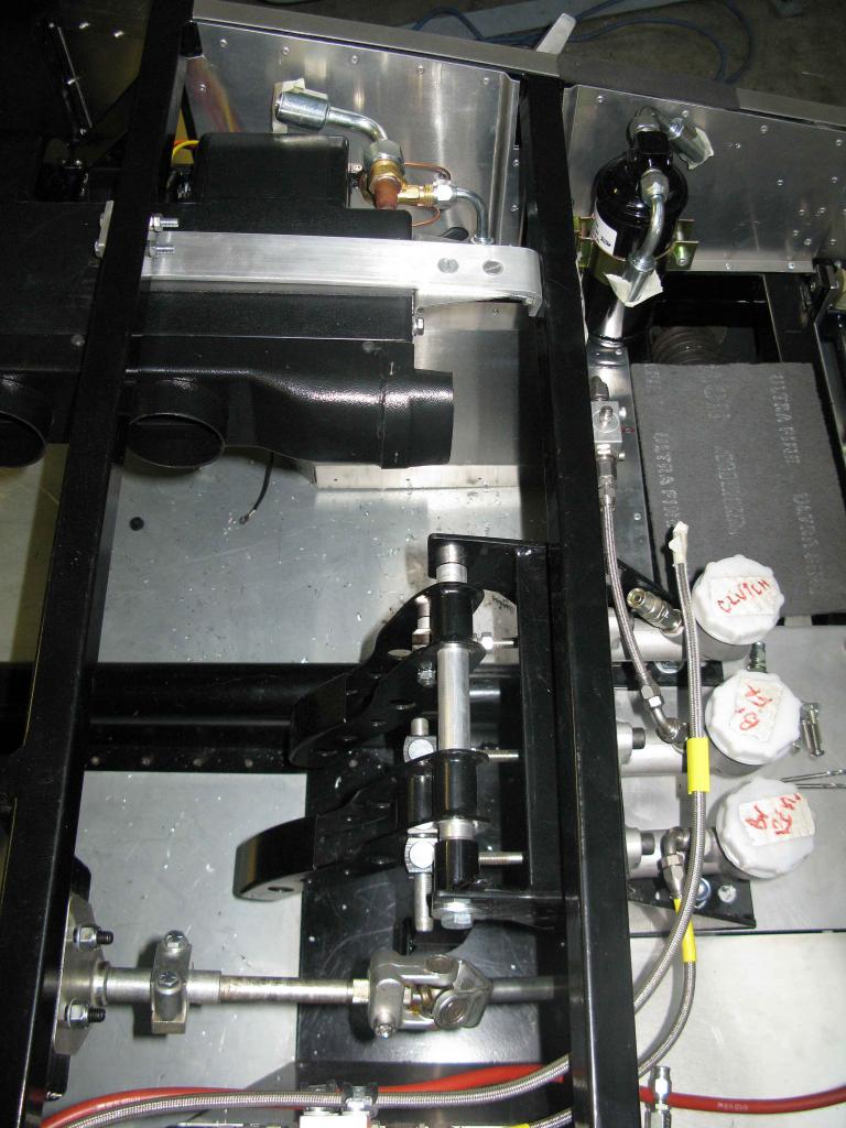

Hi all, Here's an update on the Southern GT build with pictures.
Mainly early pictures of the chassis panelled and some of the air con assembly under the dashboard.
note the covers in the cockpit / under the dash which is an IVA requirement to seal the fuel tank area completely from anywhere else.
These are supplied by Southern GT and are a tight but good fit.

Re: New southern gt on the build
Wow! Doesn't that look neat and tidy! :thumbsup:

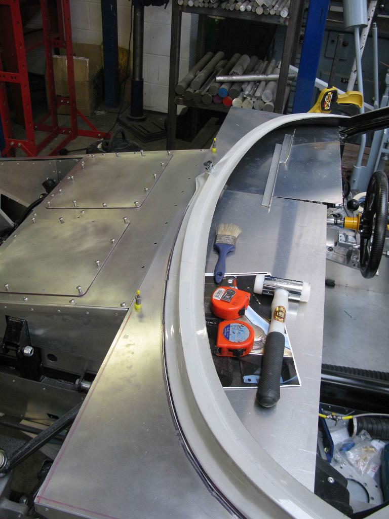

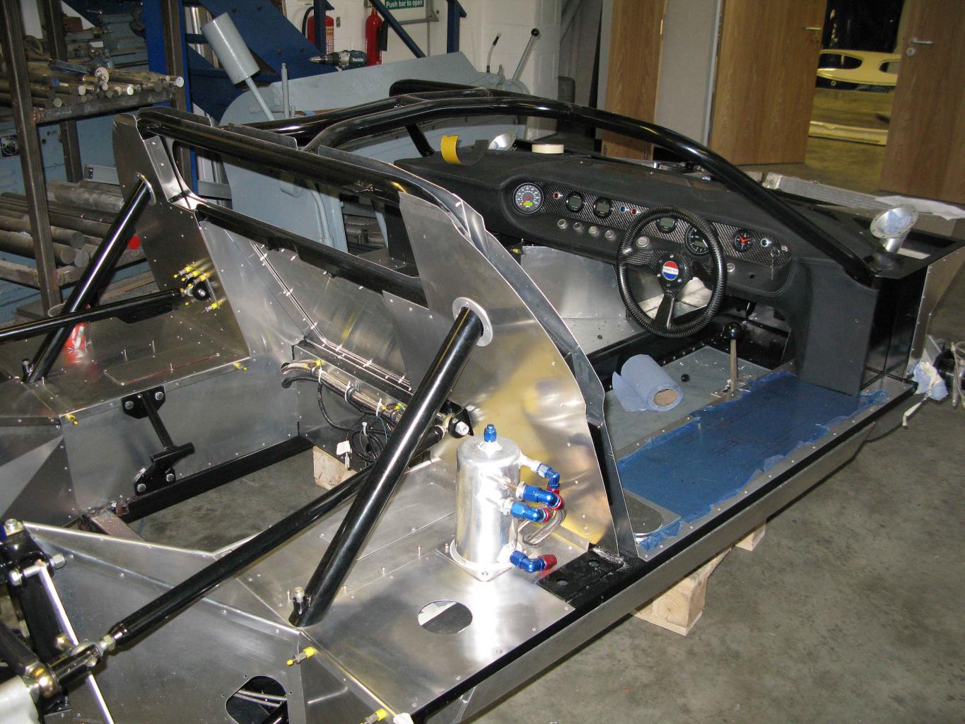

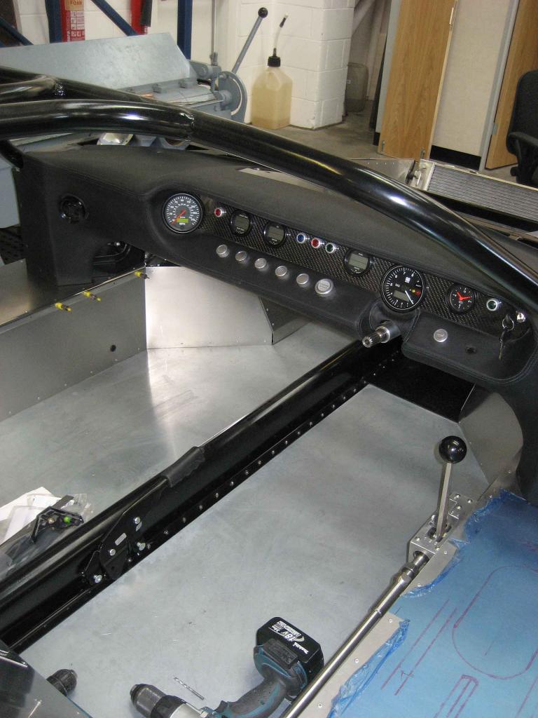

The dash board had to be cut to fit around the roll cage.
The water and air con hoses are all now in, just the fittings to be hydraulically clamped ( this is done at a later date when the final position is confirmed.
I have settled on a colour just got to get the correct specification for it. Metallic blue same as the 2010 Peugeot 908 lemans hybrid.
At this stage I know what wheels are needed and these have been ordered BRM in Matt black, Avon tyres ordered.
Waiting for AP brakes & black seats.

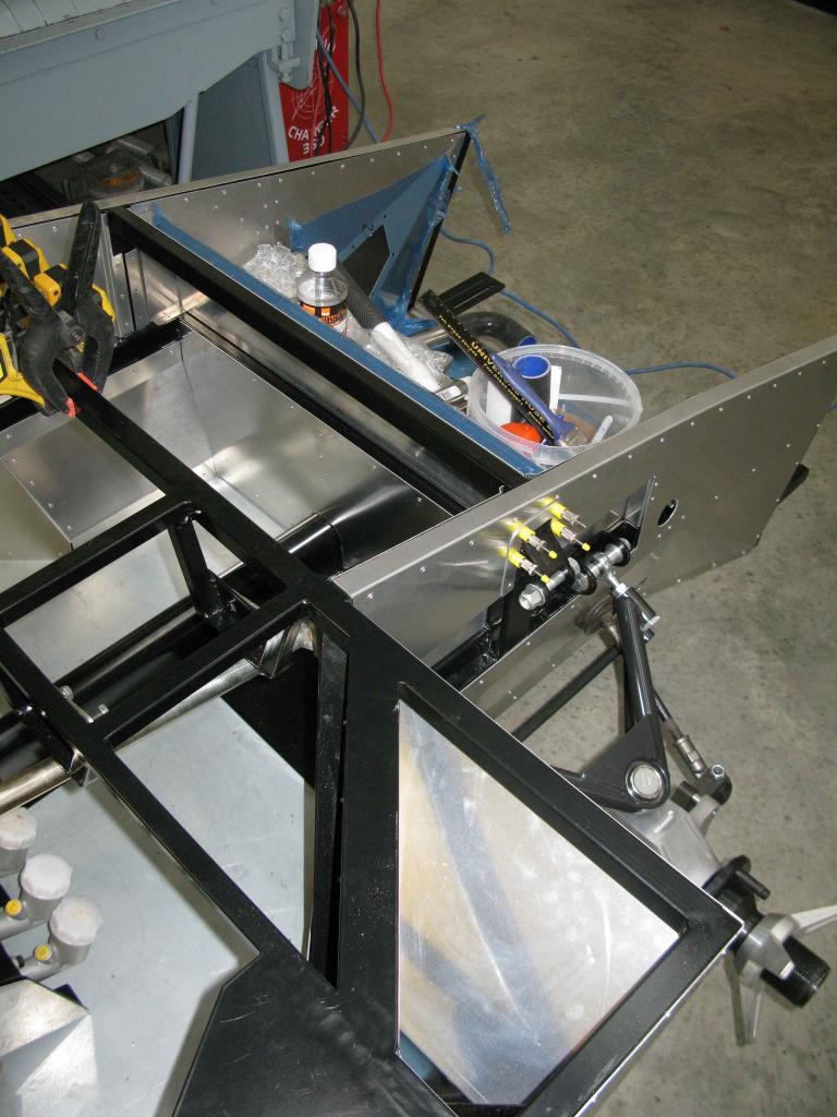

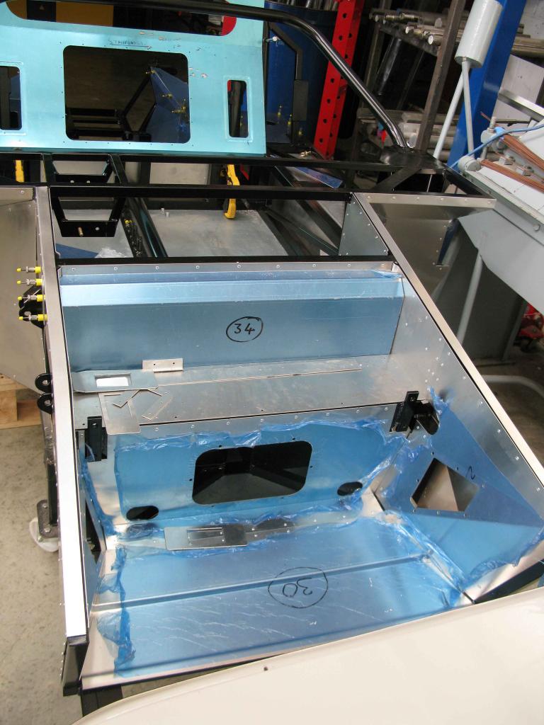

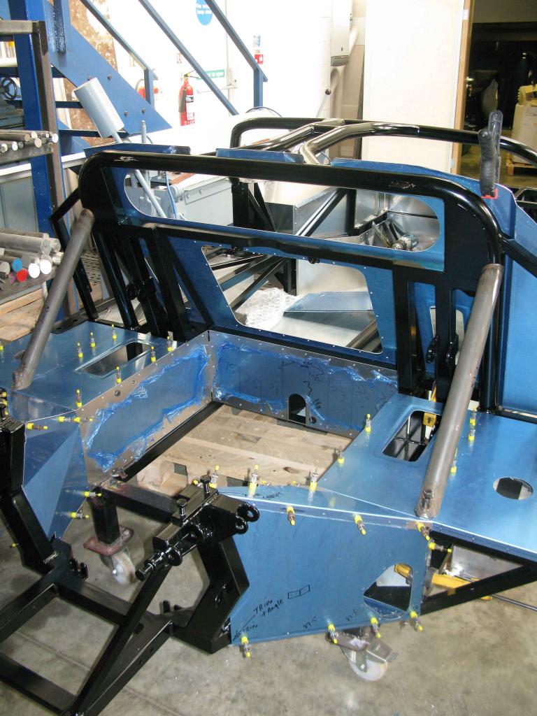

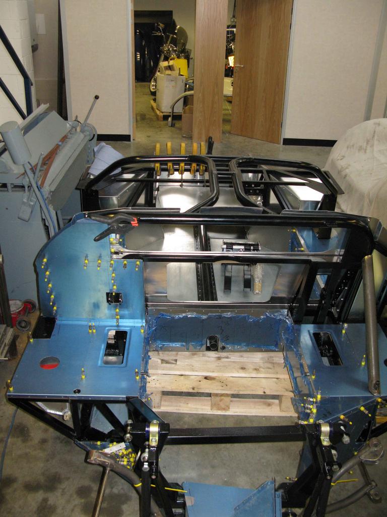

Jumped the gun a bit .
Here's a few pics 1,2, & 3 are about 4 weeks or so after the bare chassis arrived ( not powder coated at all ).
The last two are more recent.

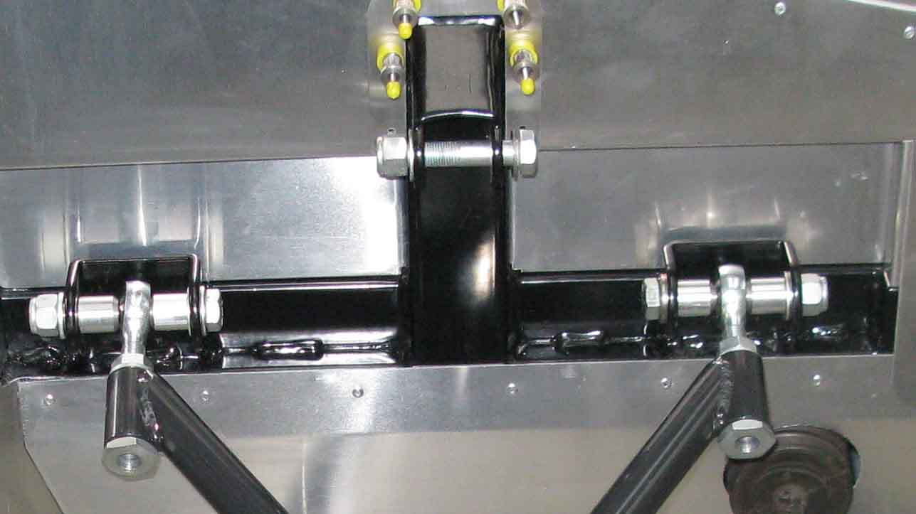

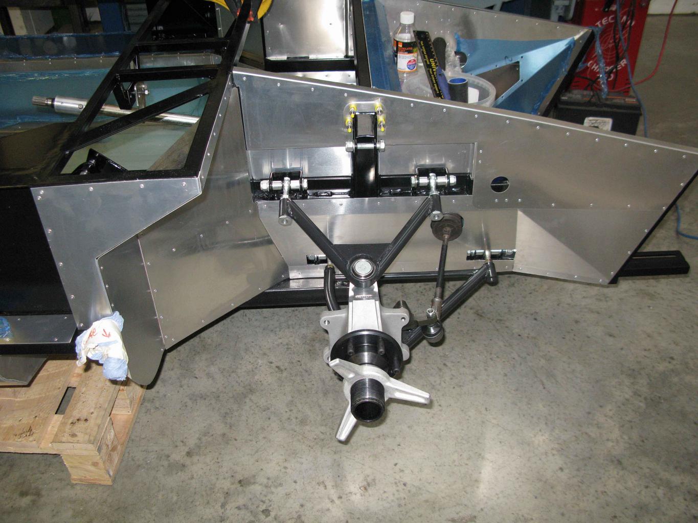

Note the spacers on the front and rear suspension.
These are aluminium, they were always stainless on GTD's but Southern GT suggest that the suspension is better for them and less noise transmitted.

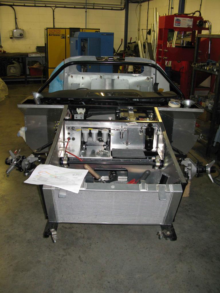

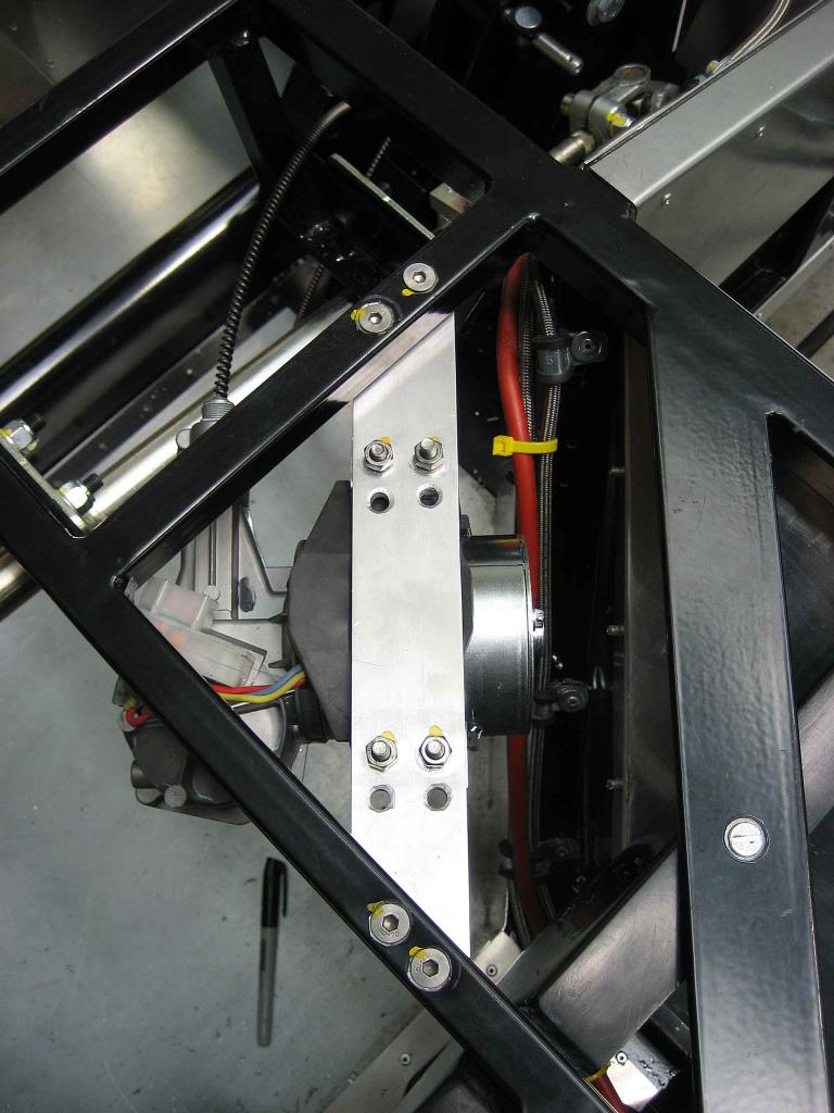

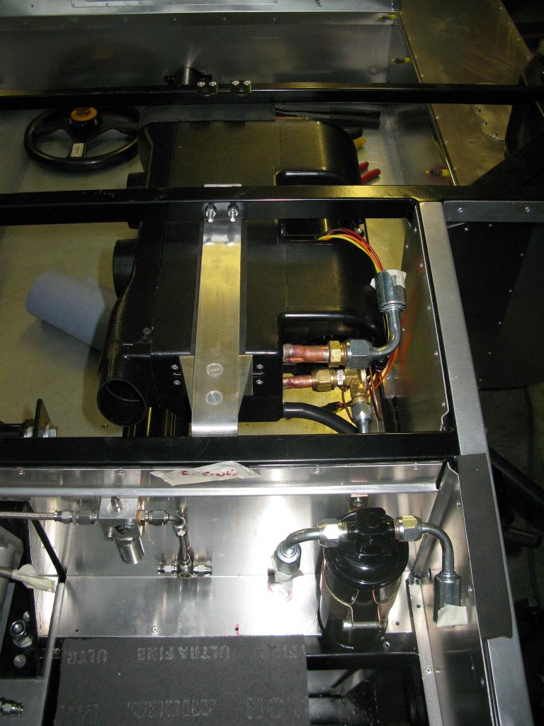

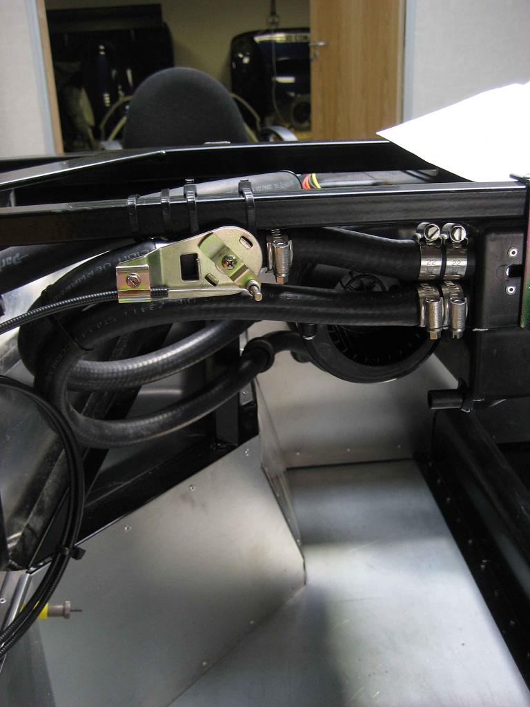

Today managed to complete the air con system.
Not being able to install the air con unit side ways due to the pedal box it had to go in length ways. Not a problem with space but the routing of the hoses and making them tidy was not easy. Anyway all in and looking good.
Due to the panels under the dash that seal off the fuel area there becomes a restriction for the air vents, therefore I used an alternative vent and the hose has minimal restriction now.
Wiper motor now mounted driver side.
going in to watch the F1 now.

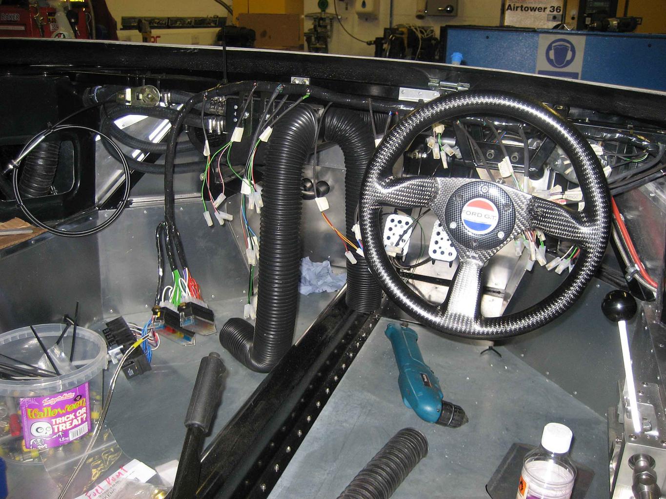

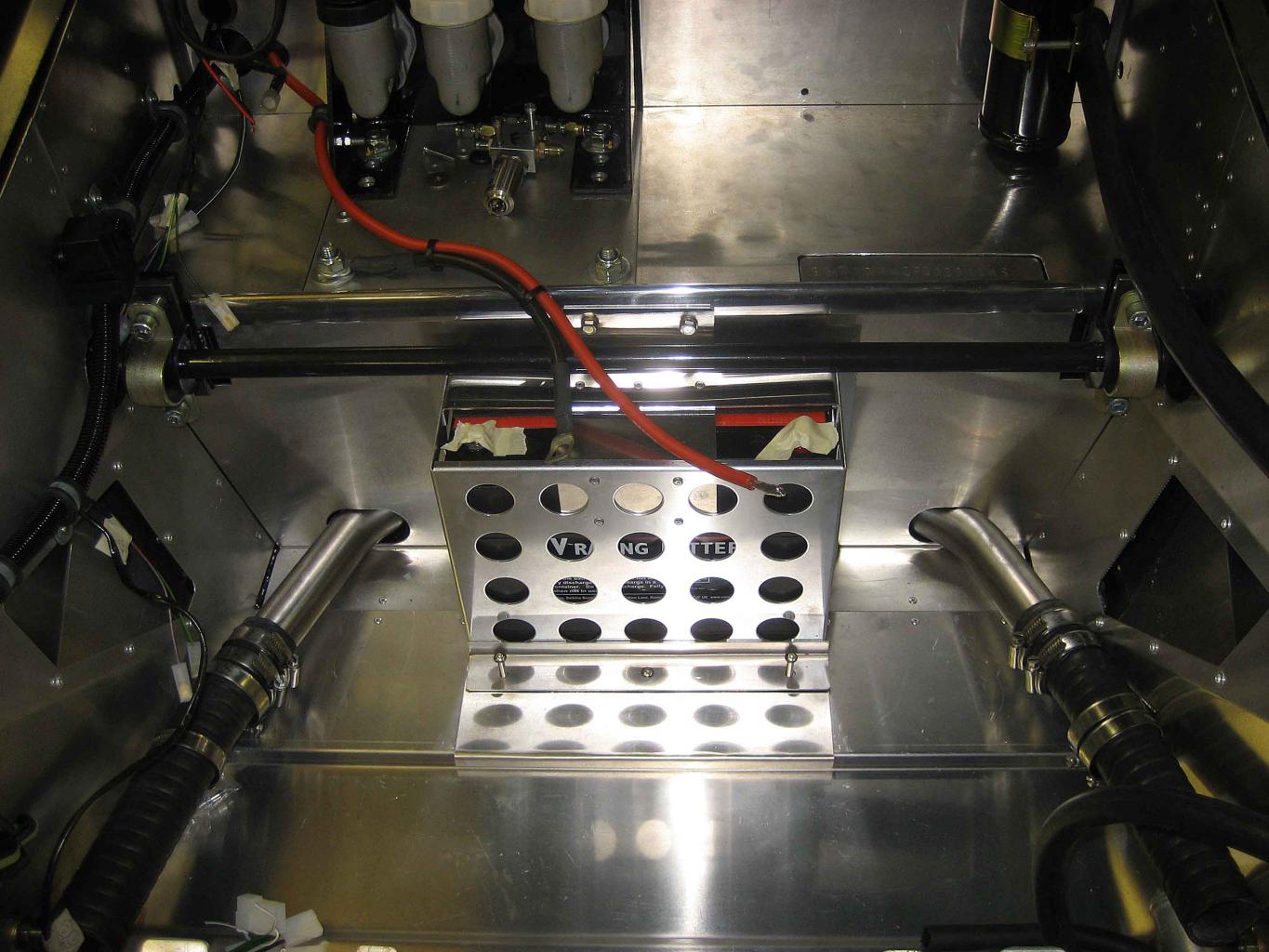

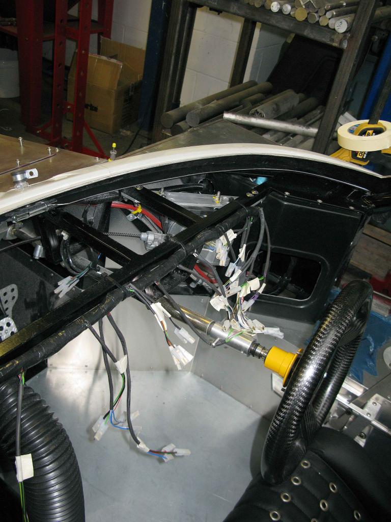

Decided to mount the battery in the front so I needed to make a suitable box.
The dash wiring is installed and marked up ready for the squeezzzzing down , laying upside down for connecting to the gauges.
The wiper motor has been mounted onto a suitable aluminium bracket.
Lastly the air con and heater tubes are all in.

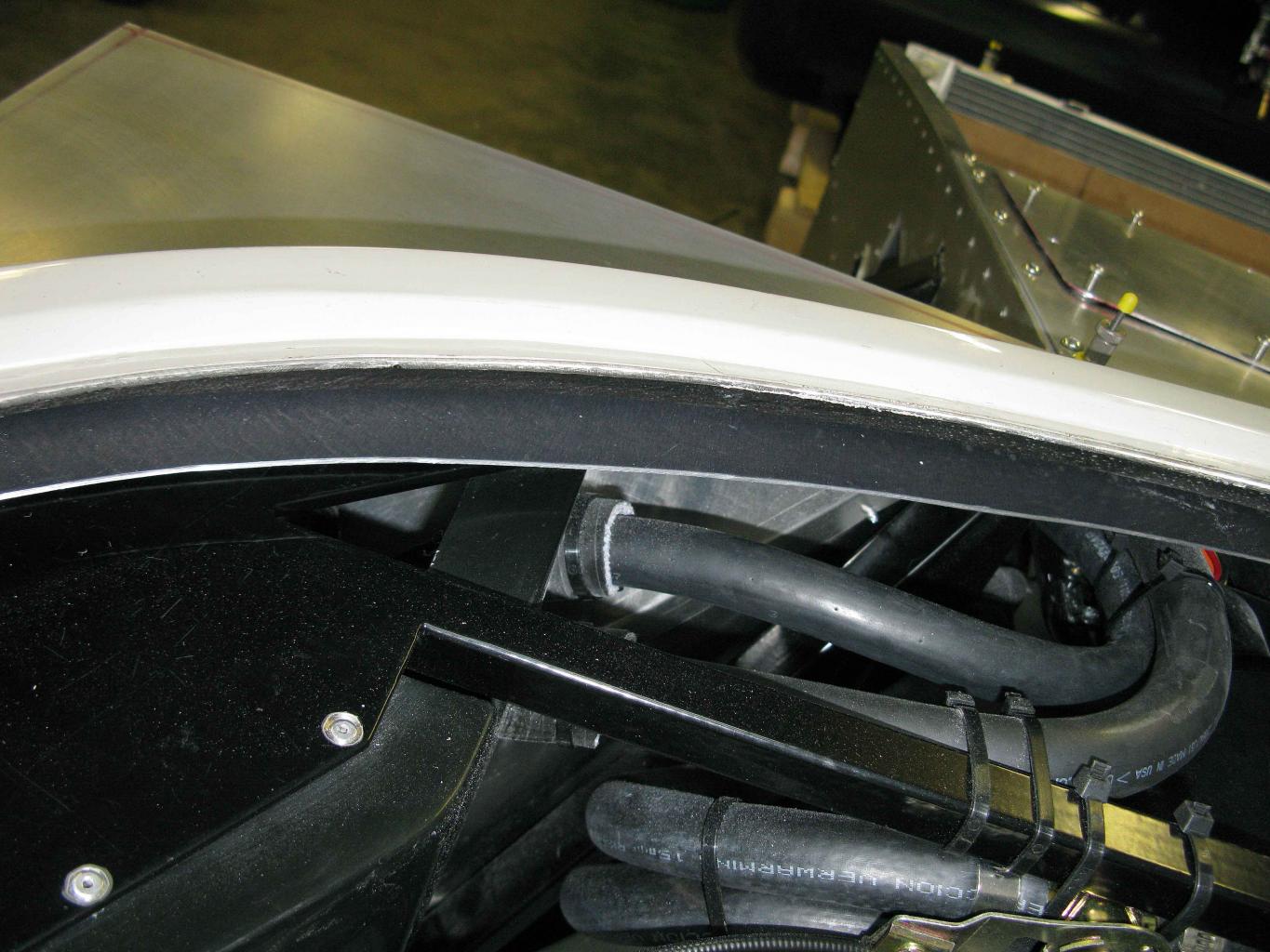

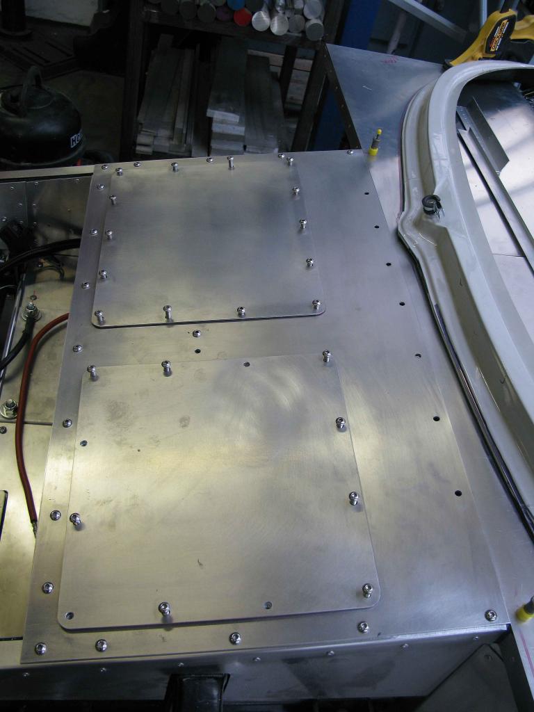

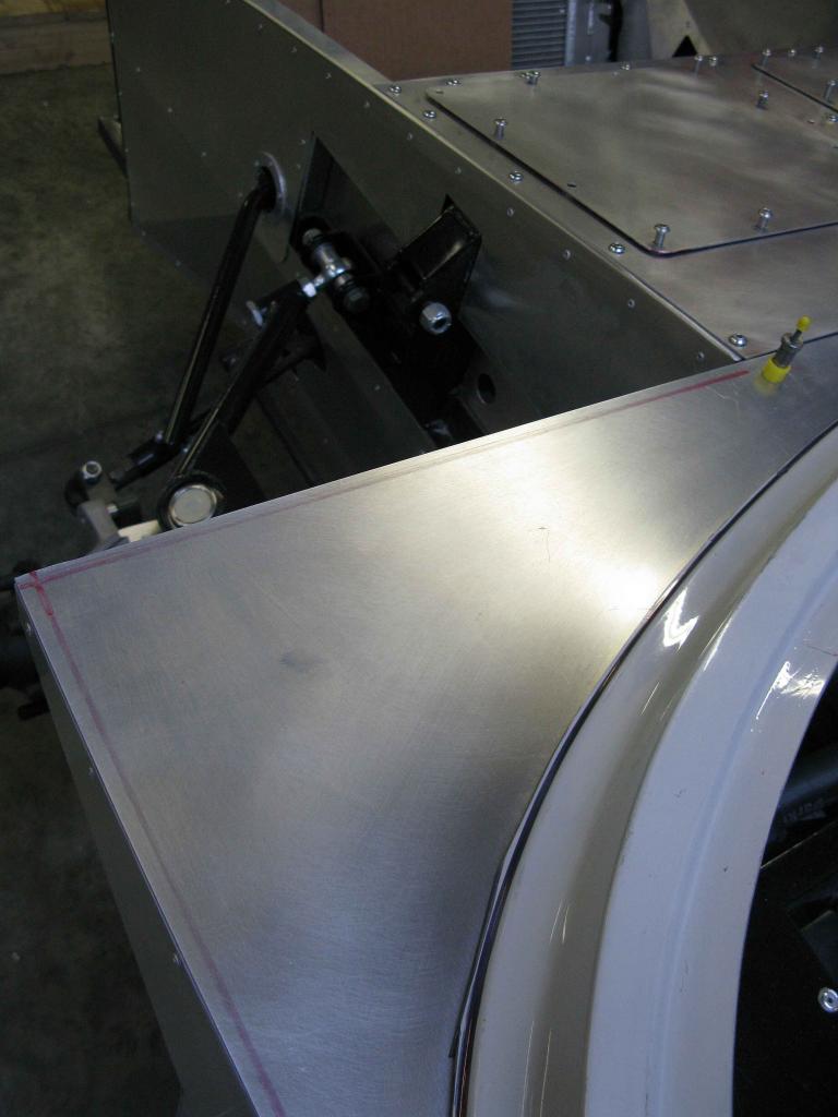

I have decided to add an additional aluminium section to the front of the car to tidy it up and look a bit more GT40 'ish'
Having balls'd up the 1st top section by drilling two holes incorrectly I had to make another section, in the end it all fits well and I'm happy with the result. When it's polished a bit it will look good.
pictures 1-4 are before trimming all the edges.
5-8 are nearly there, just a bit more work then the edging trims to fit.
Missing a few countersunk M6 inserts to finish the job.

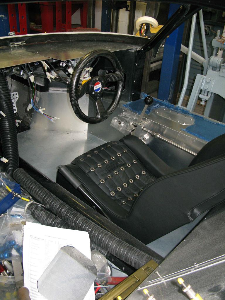

Trial fitted a seat and then realised how much I'd forgot how cramped these cars are.
As the seat is fixed to the floor the only adjustment will be with the pedal box position.
I could fit an adjustable seat runner but that would raise the seat about 1". so I'll have to think on it.
Testament to Southern GT that you get parts that fit first time. Try building an MDA ! That would turn your hair grey real quick (or in my case fall out).
Wished I'd gone for a Southern GT. Shame they weren't on my radar when I made my decision. It would have saved me a lot of pain.
Good luck with the build, looks great.
Martin
