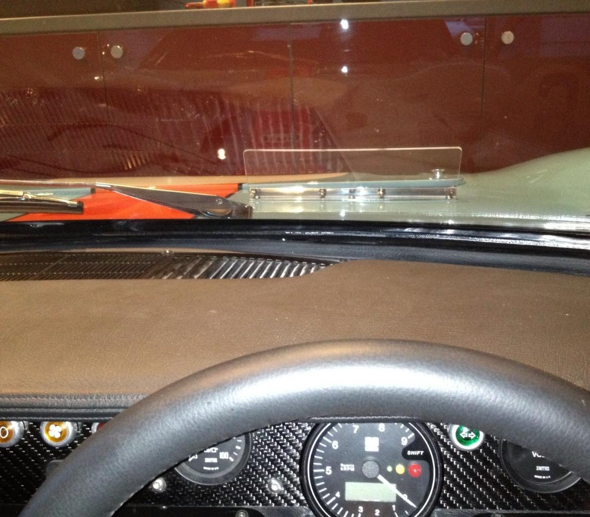

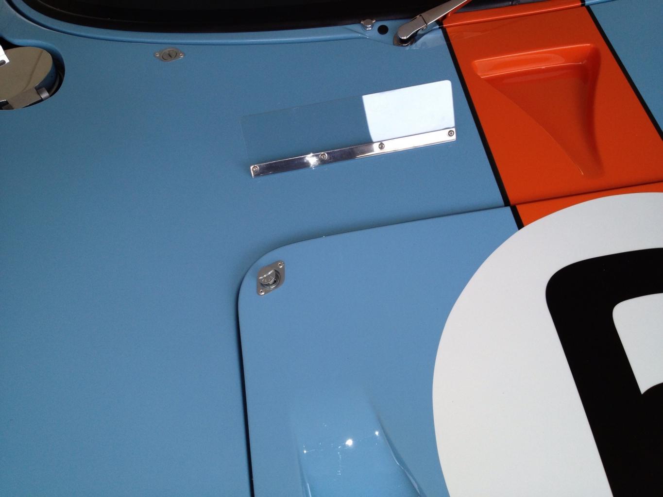

Tried to get a pre formed polycarbonate angled section for the canopy bug deflector but decided to make one, it's in line with the steering wheel and the drivers central vision.

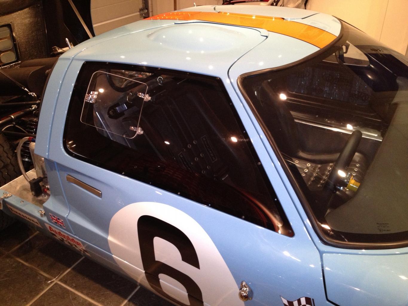

Also fitted the side perspex windows, just a little touch up paint in one place to do.
Lubricated all the door locks prior to putting all the door boxes in.
Another view, can only upload one picture at a time from my I Pad

Side Perspex windows are now fitted.

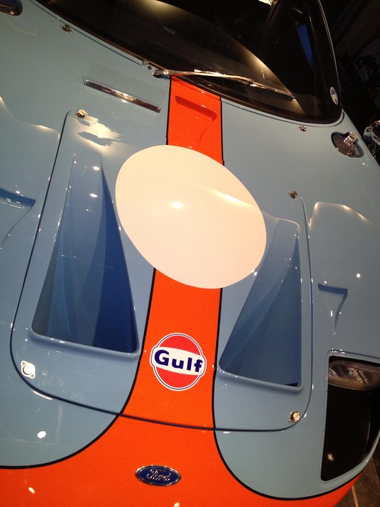

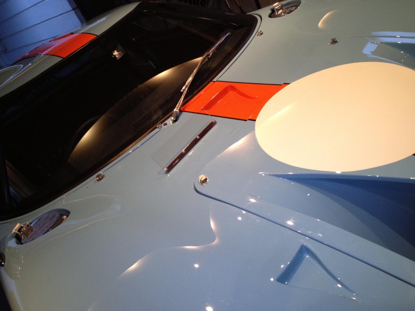

The two vinyls from Raceline came this week so fitted them ok.
Just a few pictures.

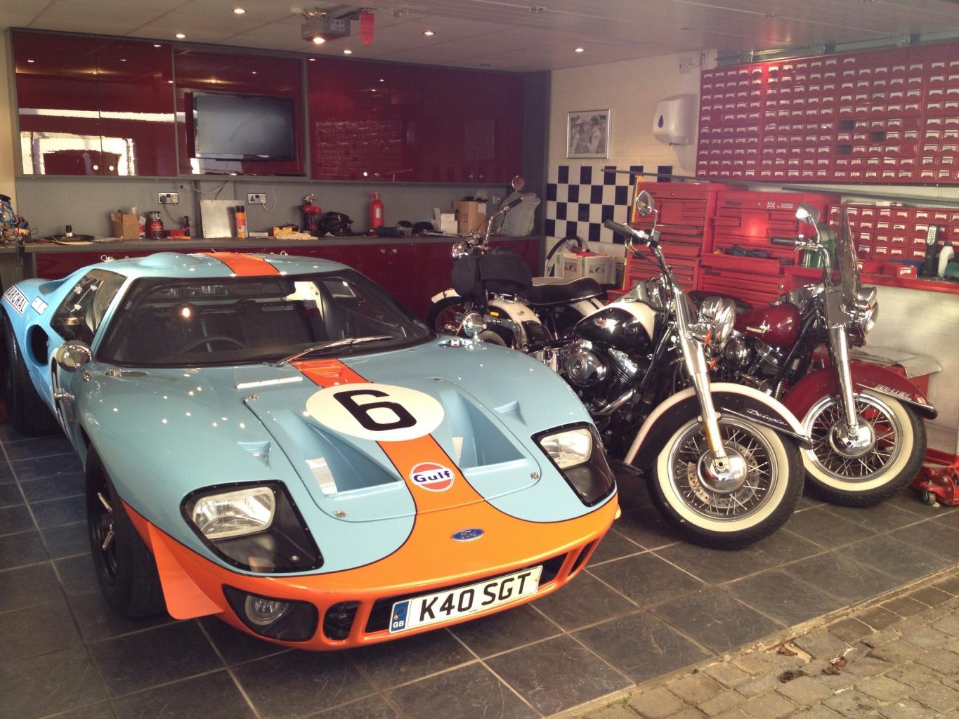

Can only upload one at a time but another

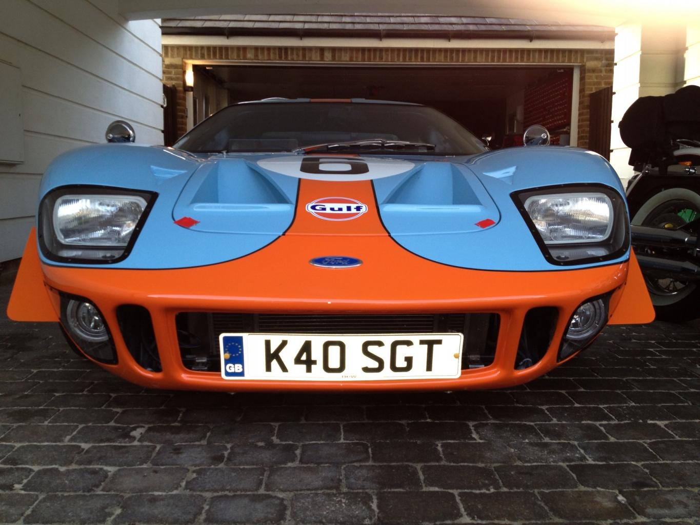

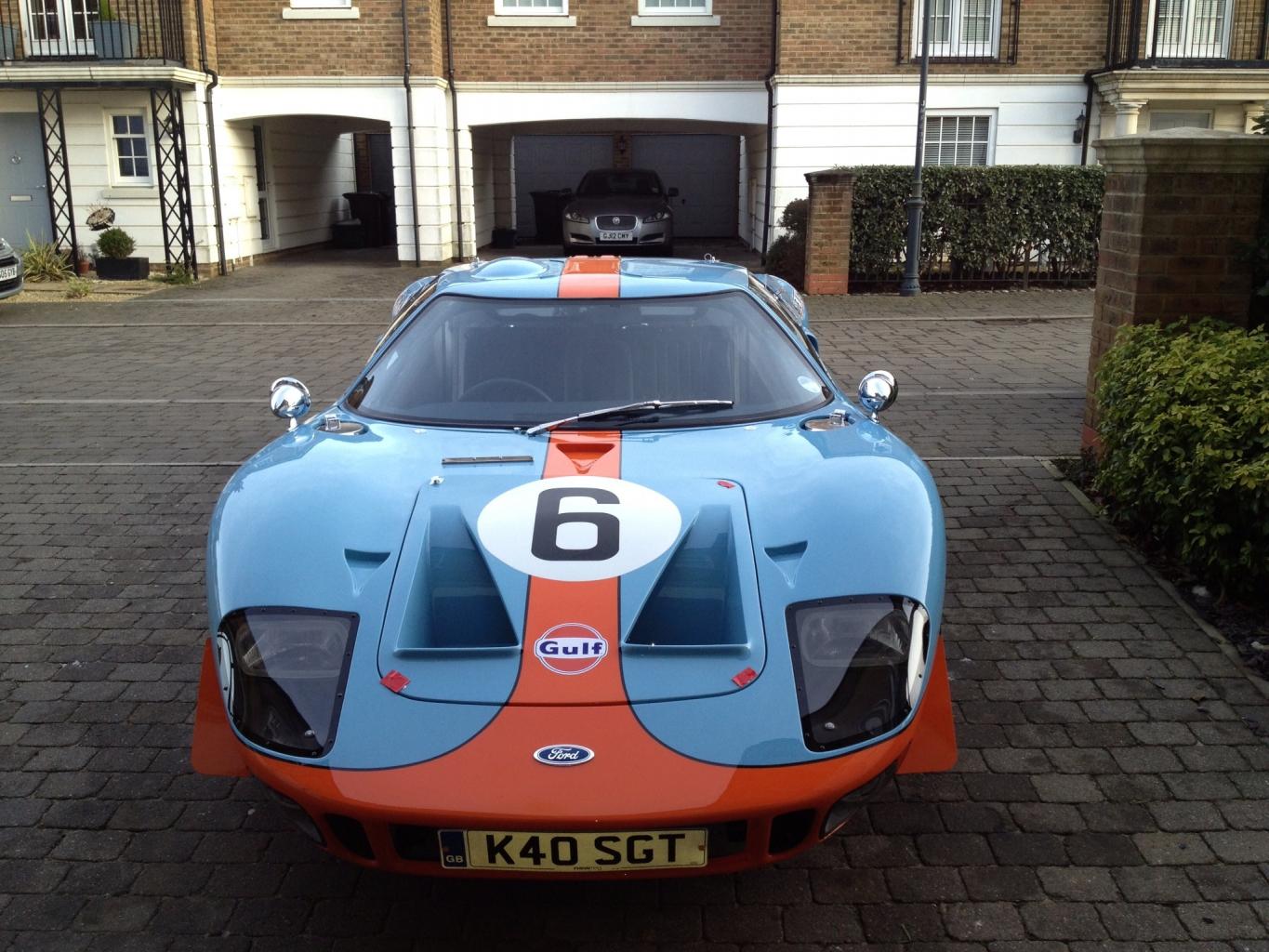

The spotlights are high intensity lamps and with the chromed ally surround have turned out well.

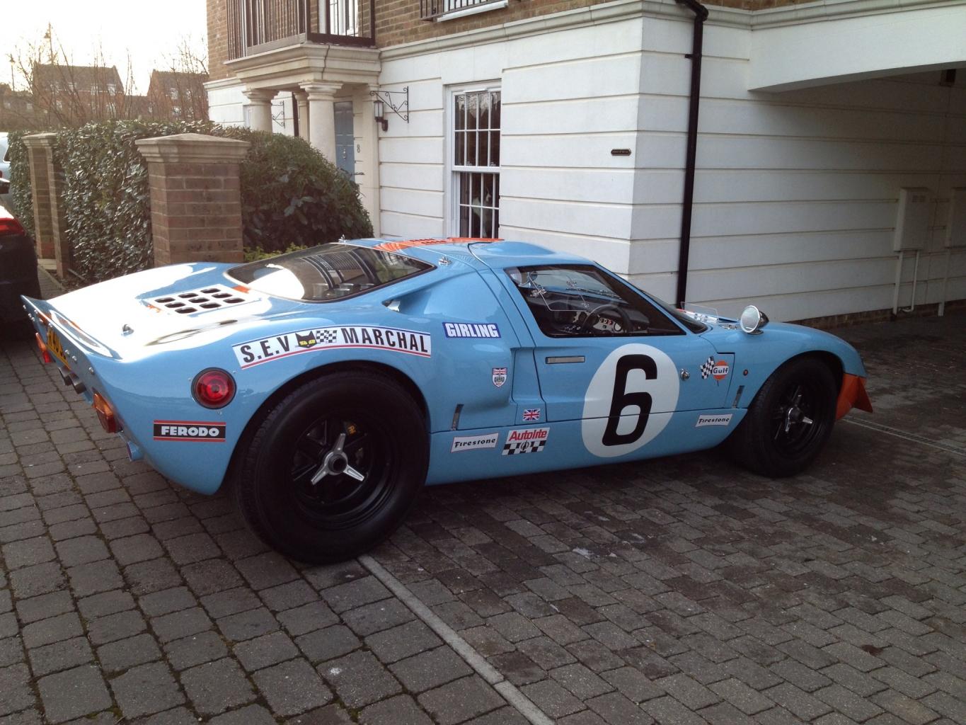

Side on.
Can't seem to upload more than one picture at a time from the I pad !
