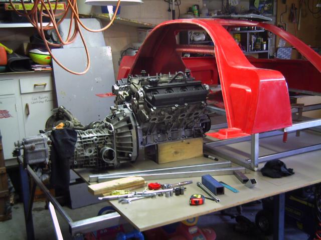

Hi All,

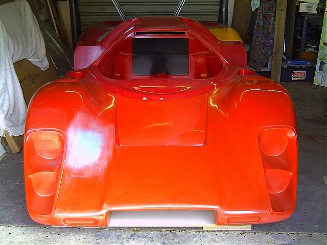

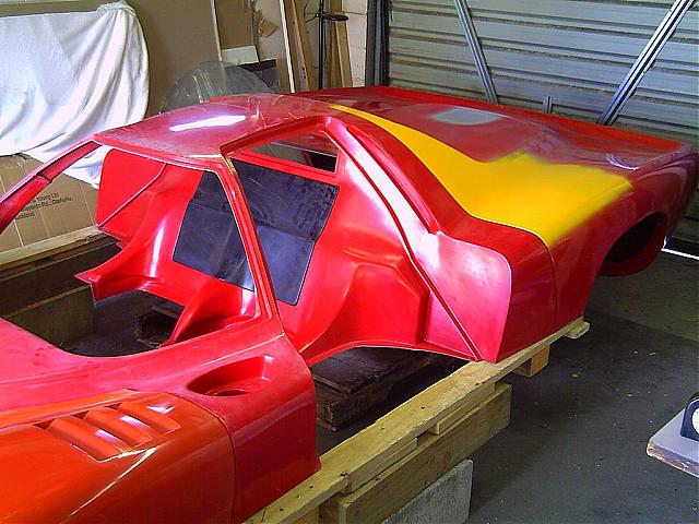

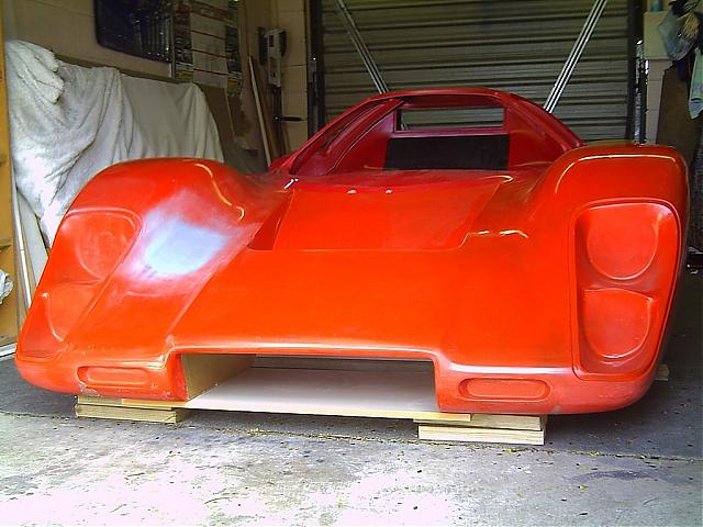

First time posting on this site so be gentle.I have been visiting the site for the last 6 months or so and thought it is about time I added my project.It is going to be a M6GT track car only.Front and rear suspenion is from/based on JZ80 model Toyota Supra,engine will be Lexus V8 with ITB's,headwork,cams and aminig at 350-380 reliable Hp(if there is such a thing)and transaxle maybe Audi 012.Still gathering parts at this stage so will keep you all posted.
One thing I have noticed about this site is the amount of help/ideas/badgering etc you all give each other and I look forward to the same.I have had the pleasure of meeting Russ Noble and Lim and there creation(it will be a weapon,photos do not do justice)as I live in the same city.I have included some photos so I hope they work.Cheers Leon

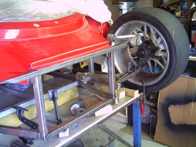

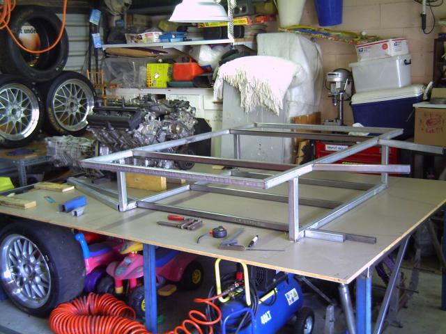

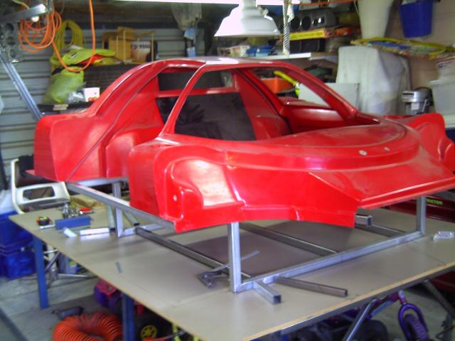

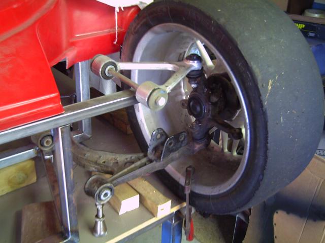

Well I thought it was about time I updated my build.I finally started on the basic chassis layout back in November.It hasn't progressed much more than what the photos show,but as they say Rome wasn't built in a day.At the moment I am working on the front suspension layout.I am using Supra uprights and will be making my own upper and lower arms.As I have been helping Russ Noble and Lim the last month or so at nights it has been great working with them picking up on little things here and there and inspiring to see his car progress in such a short time and really gives you idea whats invovled in a scratch build.
I will proberly update monthly or as I make good progress.
Cheers Leon

Leon one thing and you of all people should be aware of it, Brake pedals etc, pedal MUST NOT protude past the centre line of the front axle when fully depressed
just a thought other wise looks great
cheers John
cheers John
Hi John,the pedals are not in there correct position yet,they were just in that area when I took the photo,proberly from when you know you sit it and make car noises and get the seat/steering position right.Thanks for noticing anyway,when I uploaded the pictures I actually thought I bet someone comments on the pedals.
Cheers Leon
No probs mate i wasnt insulting your inteligence, just checking. must say its looking good , where abouts are you in gods own.
cheers john
cheers john
Alls good John,funny as I checked some photos of the F5000's I have taken recently and some rear engine sportscars and NOT MANY at all would pass on that rule,strange ah.I'm down here in Christchurch.
Cheers Leon
leon, yeh your right there, Radical comes to mind as do a couple of others running in our class, strange how its not policed all that stringently.
better be safe than sorry
cheers John
