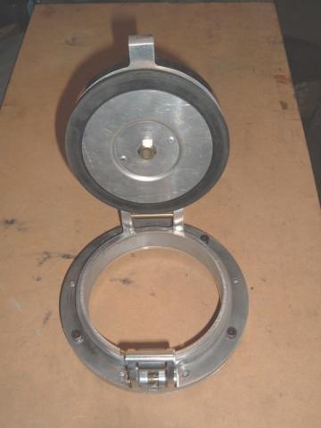

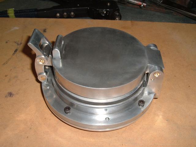

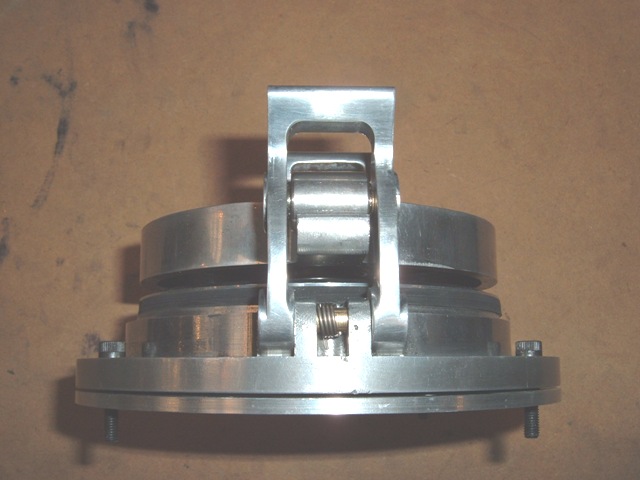

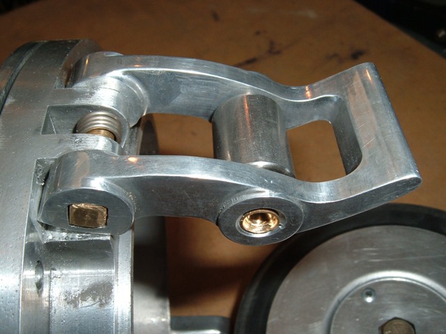

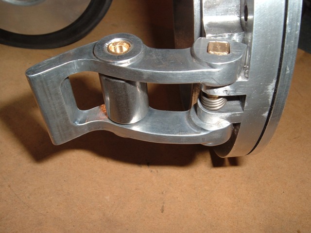

Whilst I have been finishing off the electrics, Lim has been quietly working away machining the castings for the door handles and fuel caps and mounting up the door handles. There is a minor issue with microporosity which doesn't show up until the item is polished. Lim is working with the casting guy to try and get perfect castings. Lim is a perfectionist and is treating this casting process as a learning experience. He uses his 80x magnifier to check the quality. Me? I think they look good the way they are!
So here is the fourth attempt at getting decent castings, still with some microporosity. Lim is struggling trying to get the quality he wants from the foundry that he is out sourcing it to. He has his own theories as to how they could do it better and is frustrated that the casting process is outside his control and taking so long. I can see the next step for Lim will be to build his own foundry!
Apart from that, the work in machining the fuel cap components is quite intensive. Particularly the relatively insignificant spring loaded locking latch, this involves the most work of all. It's not until you start building these things that you can see why they cost what they do.....However Lim's work, as always, is absolutely top quality and the latch operation has a very nice feel and crisp click as it snaps shut. Top shelf!

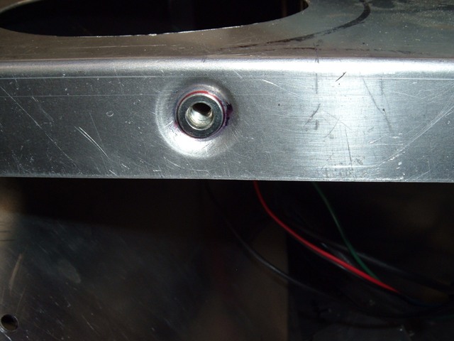

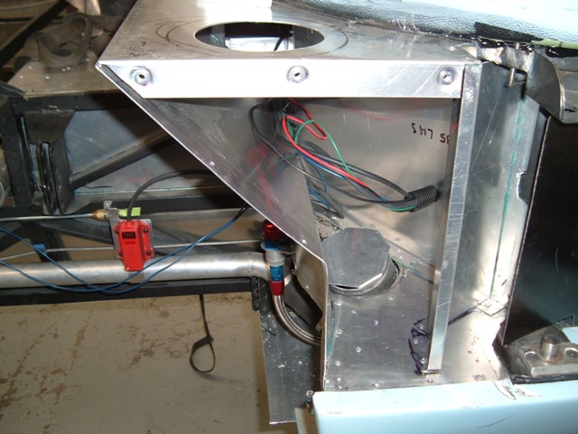

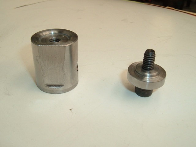

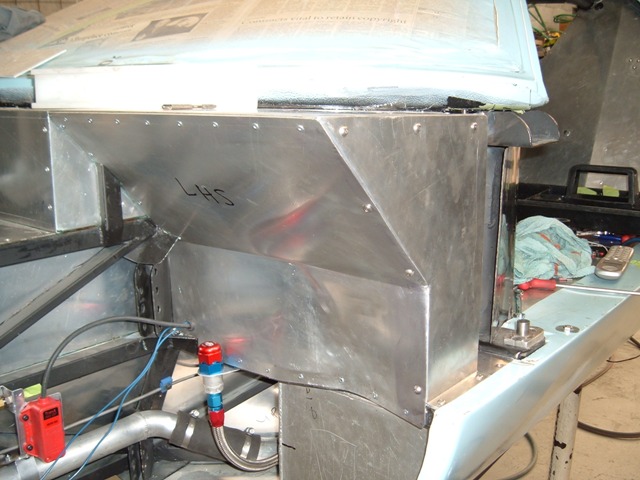

Anyway work continues on the Kiwi 40. I'm using nutserts in places to secure removable panels. Only problem is they sit proud of the surface so the panel wont sit flush. One could always make a gasket thicker than, and clearanced for, the nutsert shoulder but I felt a tidier solution was to countersink the panel slightly so the top of the nutsert was flush with the panel. This involved making up a former to do the job. Another handy little tool in our arsenal.
The side panels on the scuttle were two that needed to be removable in order to run wiring, connect fuel filler hoses, and get at the nuts retaining the front of the spider.

Nice job on the former, is it under a patent yet ?

Come on Iain spill the beans. Russ the panel under the sloping one with LHS on it looks a bit wonky, is that the finished article? Will you be ready for SFOS 2010? I'd like to be there for the first flight.

Wonky!!!??? Shonky?! Whatever! That panel has been crafted with loving care and provides for the conflicting clearance requirements between the wheel in front and the fuel filler behind!! Hence the sexy 'S' bend at the lower panel edge. The RHS (no fuel filler) just has a nice, gentle, even curve.
