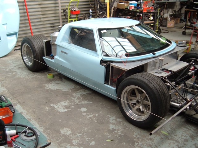

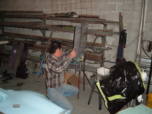

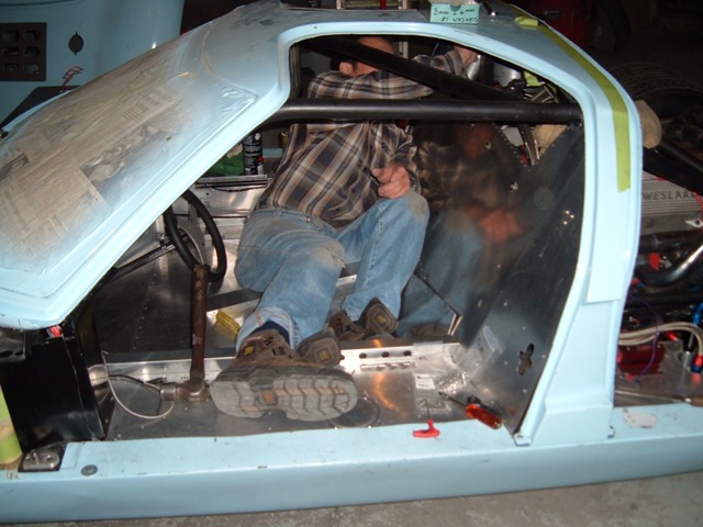

Nevertheless the work must continue! Tonight we worked on shaping and mounting the polycarb panels. Finished the rear screen, rear bulkhead and the vertical one at the front of the rear clip. Still got to do the side windows. Pics of linishing the rear screen and helper lying down on the job!
I need to have the car sufficiently finished to test this Friday so its still all go!

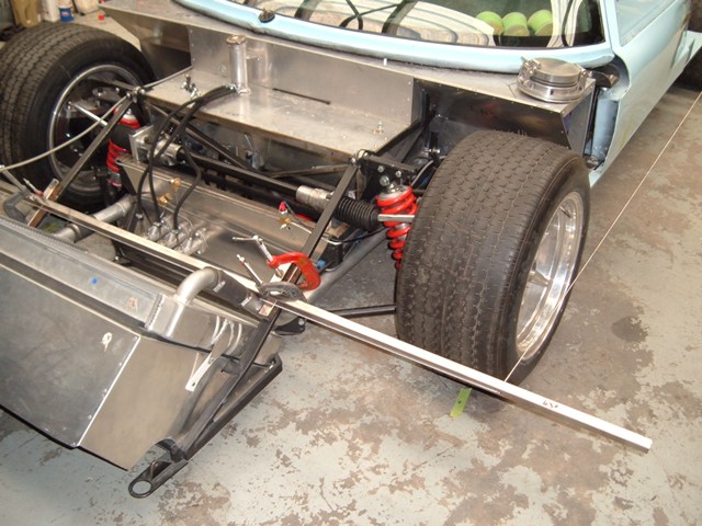

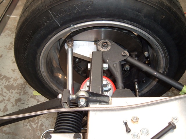

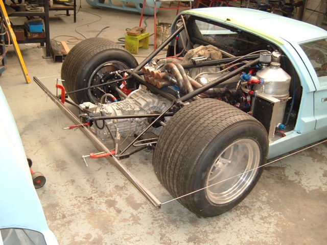

Steering arms and tie rods made and fitted. So then we could set the ride height and do the wheel alignment. I was very pleased with the results when we measured everything. It took minimal adjustment to get the wheelbase and the diagonals all down to +/- 1mm.
Been finishing off a whole lot of wee jobs the last day or two, adjusting pedals, bleeding brakes and clutch, mounting catch tanks, changed out the break in oil, put in a new filter, fitted the race plugs, fitted the rear clip hold down pins. Now fitting the seat belts and have to mount the mirrors and fuel cap.
The plan for testing now is Tuesday afternoon. Fingers crossed for good weather
