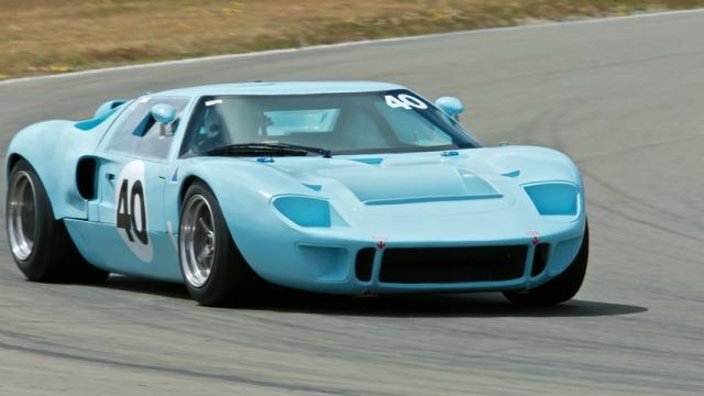

I have just received some pics from my test day at Levels last month.

Looks great Russ. Well done! Best get those headlight covers on if you're to reach max top end... :)

Great shots as well, I showed one of my mates the other night and he asked why I'm not building one of those,
The answer to that Leon is the M20 will be lighter, faster, quicker to build, and more importantly, real race cars don't have a roof!

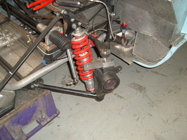

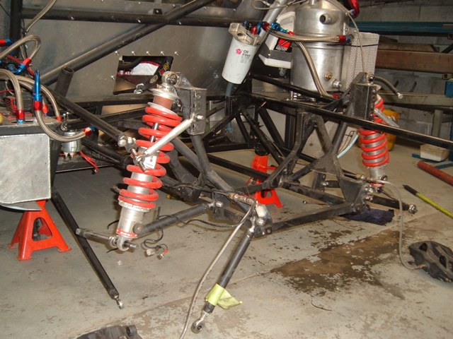

Have just whipped the motor and trans out of the car to give them a bit of a check over and stripped out the uprights to check everything there too. Have found that I've got a problem with the ball bearing that takes the side thrust, it is not standing up too well, a lot of wear. I am going to have to go to a heavier duty version in the same size. Lim is teeing up some from Singapore in the next few days, the cost of buying them locally here is ridiculous, particularly if I have to replace them every few meetings.
So the car's in bits again......

Interesting about the bearings, is it just the rears or are the fronts doing the same?? if you give me the bearing inner and outer specs I will compare with the Tapper Nissan ones, it might not be a big deal to change and you can buy a set for both sides for around $200. Looking at your set up it is similar to mine, and might just be a case of sizing. Are you using the same size bearings front and rear??
Anyway thanks for the Mag and will hear from you latter, and send me your address so I can post this back once I have read it.
Cheers Leonmac.
Russ Noble
Cheers Leonmac.
Front and rear are the same size and are both showing excessive wear. I have a needle roller for the outer and these are fine. It is just the deep groove ball bearing that is on the inner and takes the side thrust that is chopping out. It is a 6308, 40x90x23 and is commonly a Hi Lux rear. The heavy duty version that I am going to try is a DL308 and it is shielded, not sealed, but that shouldn't be a worry.
Changing to taper rollers inner and outer is a major, major mission and it makes more sense to just have a strict bearing replacement regime. However the DL308s may be all that is required to overcome the problem. As always, time will tell......

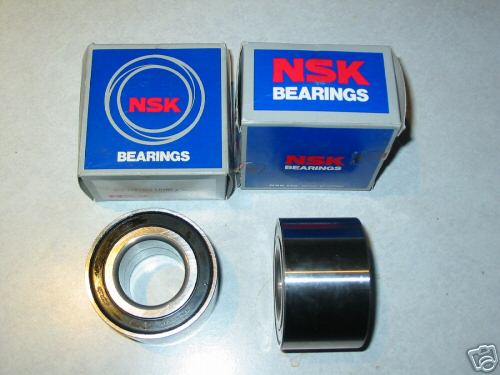

I wonder how the rear hub bearing assemblies on the likes of Commodore, Falcon, Corvette maybe some Japppas and no doubt others would hold up under the racing loads imposed by 14" wheels configured with a small back spacing....? Or indeed the average GT40 road car? From what I can gather RF use Commodore, DRB and RCR Corvette. Something like that could be a good option for your car. Commodore stuff has got to be readily available in our neck of the woods. Or maybe you could just go with more widely spaced tapers.....
Kevin Box
Russ
IRS Commodores and I guess Falcons use a double row ball bearing as per picture.
This type of bearing is also common is FWD vehicles
In the case of the Commodore I think from memory they are 37 X 72 x 37 or close to that.
Corvette is the same arrangement I believe
This bearing is also used on the front of Nissan Skyline, Cefiro etc
A heavier version of this is used in the front of the Skyline turbo 4WDs
