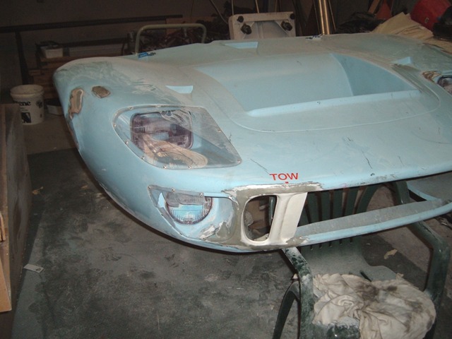

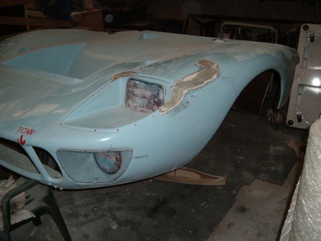

Had a very interesting visit from Kevin today. Not a member on this site, AFAIK, but appears to have spent a lot of time on it, and is wanting to scratchbuild. Came in armed with two good sized portfolios with lots of engineering drawings and 3D CAD chassis work with pushrod suspension and opposing horizontal shocks at the front. He came in looking for some measurements and was enquiring about screens and bodies. Go for it Kevin!

You might as well pull another front clip and keep it as a spare. When the racing season gets going you won't want be farting around with fiberglass repairs. I hope you told Kevin about the hair loss that comes with scratch building. The thining parts on the side of your head from scratching it all the time.
Dave
Now that's a good idea!
But this is my kiwi scratchbuilt, nothing is ever that f***king simple! :mad: :shrug:
The front guards have been modified to Gulf spec, the radiator outlet is part of the front clip and has been changed from twin nostril to single, and because the front of the spider had to be spread to get a good fit for the screen, the back of the front clip needs to be given the chop and widened.
The plan is to do a new mold off the altered body, and pull another nice lightweight one out of it and keep the current clip as a spare, since it's starting to get a bit heavy with all the mods and repairs. But that's not going to happen until the season is over. Ideally, I want to have a complete spare body sitting there so as to have all the bases covered. I have at the back of my mind too, that I would like to build a really nice road car......
Also, if some lucky kiwi punter decides he wants a body, then I can supply one straight away with no hassles. At present I am trying to get some body parts out to take south for a guy when we go down to Teretonga in three weeks. I could do without that sort of pressure right now.....

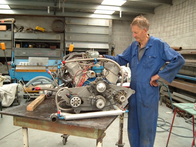

Absolutely gutted!

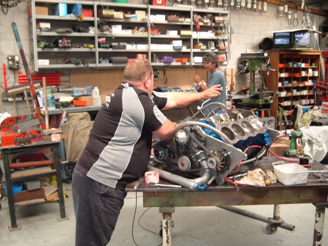

Testing Tuesday, only three laps and temperature climbing. Pumped out the water, and this time water in the oil too. Both these failures have occurred immediately after retorquing the heads. Back to the workshop for a teardown. Motor out in order to remachine head and block surfaces which were .002" out of true. Probably not the cause of the problem but in this situation worth getting everything 100% anyway.
Had to pick Ross Nicol and Andrew East up from the airport late Tues night, they'd come over specially to watch the SKOPE SFOS meeting and are staying at my place, so I felt terrible having to inform them of the latest developments.
Talking to various engine gurus revealed the Cometic gaskets don't require retorquing and, depending how you do it, you can break the seal if you do. Several also suggested that the 85 ft-lbs stud torque rcommended by ARP for alloy heads was a bit low. The problem with the latest graphite gasket I had did appear to be insufficient clamping force.
With the head and block trued up, I am planning on going back to the Cometics and not retorquing and at this stage am undecided whether to increase the clamping force or not.
Anyway, today we stripped the motor back to a bare block and got the heads ready too to go to the machine shop for first thing Thursday. Lim, Ross and Andrew assisted with the teardown and clean up. We'll see how we go.
Unfortunately competing at the SKOPE is now out of the question and the Levels round is also looking doubtful. And if I don't make Levels I'm also not sure that I want to drag an untested car all the way down to Teretonga either. I might have done that in my youth, but I'd like to think I'm older and wiser now......
So a couple of pics from today....
Sorry to hear that. Especially because after seeing all the thoughts and works going into this engine i was shure it will be troublefree, but thats racing. At least now i know what it means if someone says he has engine with a belly pan.

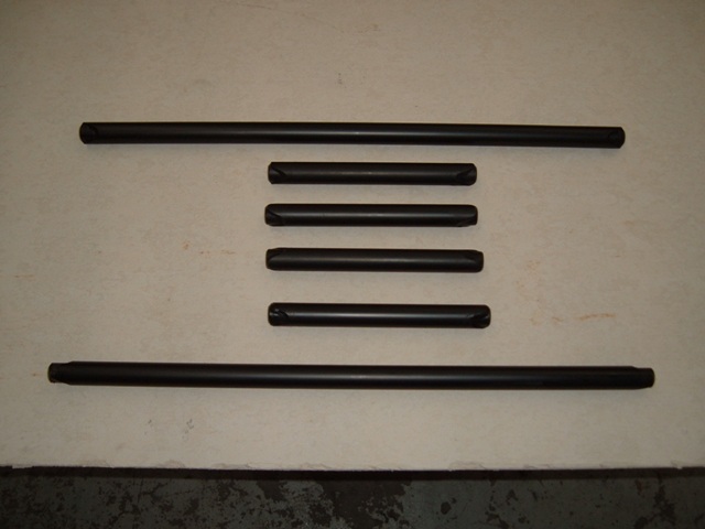

Russ, if you can source some heavier wall pins to offset the material removed the balance issue can be avoided----do you have the weight, length & wall thickness specs, might have some here.

Hi Russ, sorry to read about the trouble, a real pain in the butt. The look on your face in the picture says it all. At least you had a couple of mates to help with the pull down and clean up.
