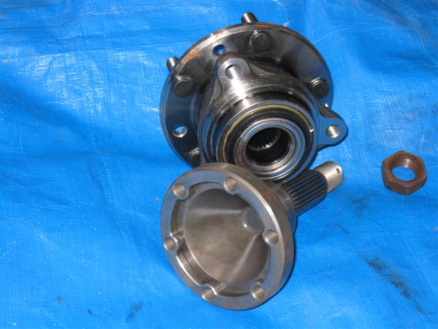

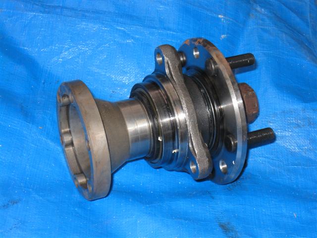

Hey boys --this is what we use , Corvette C4 /5 wheel hub --just bolt on and go ( the CV drive spindle is extra)
Kevin , those bearings are good ,but fitting them is a PITA ---they're pressed into something and retained by a large circlip
Just had a quick look on a Corvette forum and it would appear that there are longevity issues too with the C4/5 stuff when used in anger. And you have to replace the complete unit which is not cheap. Hmmm....

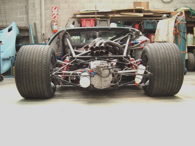

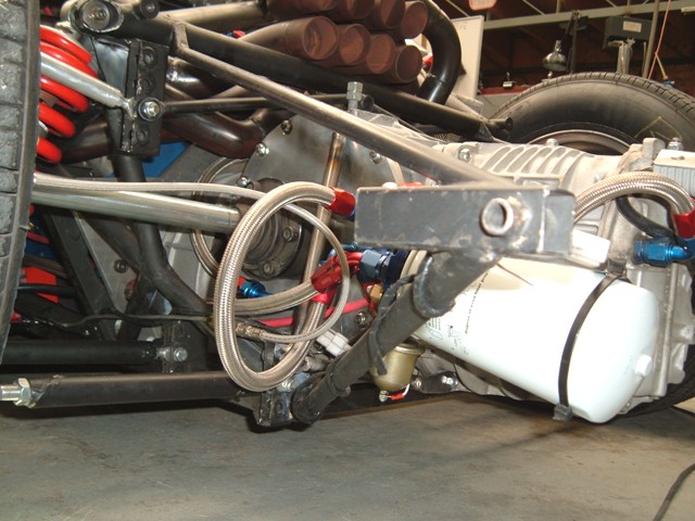

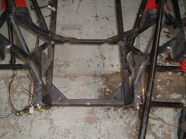

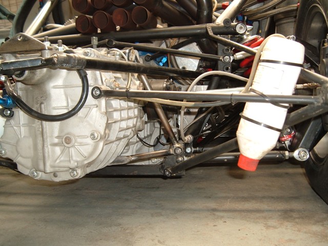

Besides the bearing issue on all four wheels there were a couple of other areas that needed attention in the back. The trans which is only supported by the adaptor plate was found to be moving up and down as the plate flexed due to torque reaction from the driveshafts. Not something I had expected with 12mm 7075 aluminium tooling plate!
I also found a crack in the rear chassis crossmember, this was caused by chassis flex as that area was essentially untriangulated. The original plan was to fit a plate under the chassis at the rear to stabilise it, but the bellhousing was going to get in the way so I temporarily threw it in the too hard basket!
So the logical step was to tie the trans into the rear of the chassis which is well structured to resist the vertical trans movement and also to tie the suspension pick up points into the bottom of the trans to stop sideways chassis deflection. I have done this on both sides, and at the rear we now have a 'birdcage' GT40! Tubes everywhere! I also put a couple of flanged gussets on the rear crossmember to spread the loads. These have a hole in them, not so much for lightening but as an attachment point for the shackle and chains used to secure the car on the trailer. Killed two birds with one stone. Actually, I did the gussets the night before the 13 Dec race meeting as I spotted the crack during my pre meeting preparation. Welded it up and fabricated and welded in the gusset to spread the loads in the tube junction.
Anyway, car is now back together with all the essential work done and suspension reset. I have reduced the camber to 0.5° all round and reduced rear caster to zero. I'm hoping this will lead to a further improvement in lap times. We seem to be going in the right direction. We will be using a digital thermometer to measure the tyre temps this weekend and will further refine the settings based on the readings.
Pics.
#1 is the original chassis configuration
#2 shows the gussets added to the rear crossmember
#3 shows additional right hand support
#4 and #5 show it's starting to get quite busy round the back now
#6 is how it all looks from the back with suspension and ride height set.

Russ,
Lots of bracing. If you still have problems you can always cut out the rear main cross member do a bit of welding and put in a beefier version done in plate. I've seen quite a few versions even in my car.
Dave
Russ, you have a very nice looking rear end of the car...

Russ, wont you need something along these lines to fix the flex issue, even when you disengage the clutch it must try to bend the adapter plate slightly.

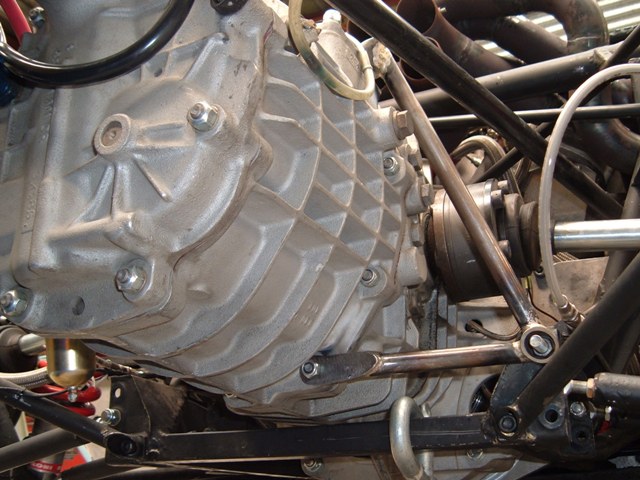

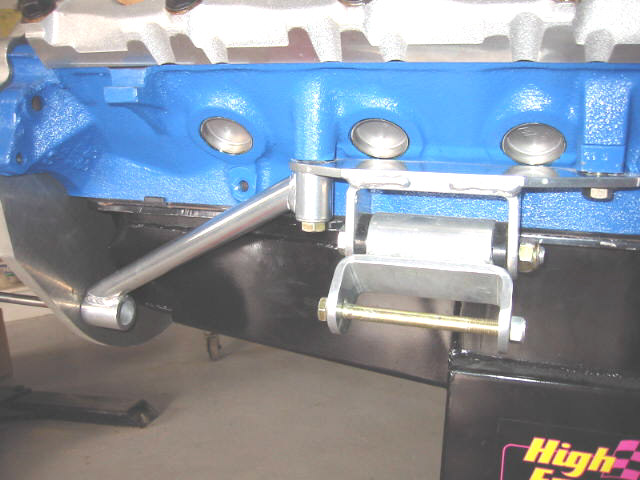

flatchat(Chris)
Spot on Jac -- the trouble with Ford motors --ther'se no support for the bell housing below the crank centre line -- the natural torque of the trans is to try and lift the motor --or fold the adapter plate under the engine.
So,- the trans needs to be supported and the adapter plate braced --the motor needs to be mounted fairly solidly as well.
Our solution for eg. :-
Chris old buddy, I feel the real problem is the super expensive Porsche bolts that Porsche feel so guilty about that they only fit four of them to the bell housing, the same problem would occur when you try to adapt one of those other highly regarded [ by the few:thumbsdown: ] motors from the other camp as well, if they were only capable of some long term power output.
Mind you, if the only trans being fitted to these replicas were ZF & T44 & mounted in similar fashion to the originals we wouldnt be discussing this as they were mounted on the two top lugs of the R&P cover & the lugs on the bottom of the bell housing along with the engine mount pads... 6 points in total.

Exactly right guys, but there is no room to run the stays forward to the engine mount bosses and also that doesn't cure the chassis flex situation.
Now, since the motor is solid mounted, it is much easier to kill the two birds with one stone and tie the trans into the chassis, as I have done, and this will stiffen everything up. QED

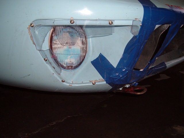

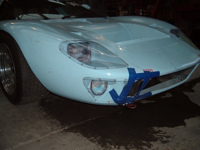

Looks great Russ. Well done! Best get those headlight covers on if you're to reach max top end... :)
Done!
Lim finished those the night before the most recent race weekend. Looked good, unfortunately the extra 2mph must have been my undoing...... RHS spot cover and LHS headlight cover now need to be redone. Not to mention some fibreglass......
Some good news from the weekend though. I thought my best time was a 35.7 which I had found a bit disappointing after a months solid work on the car. That time was from official qualifying on the Saturday. I have just had the opportunity to check my transponder for Friday times and see I did a 33.4 in the free practice. That was the level I was aiming for last weekend, so all good. Progress continues.....
