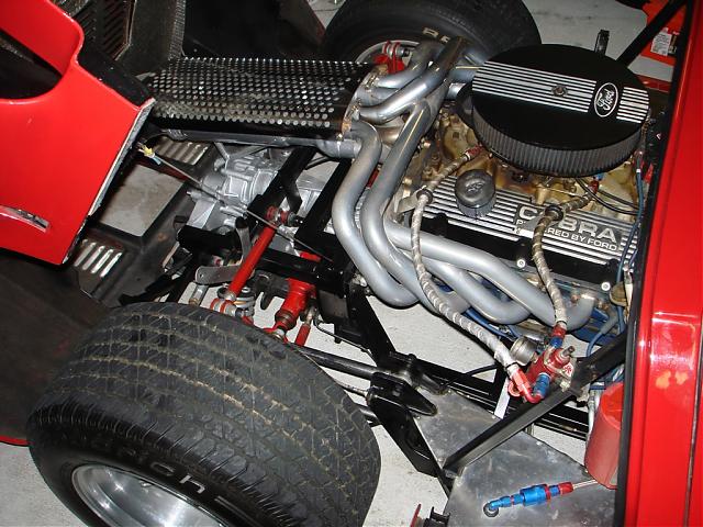

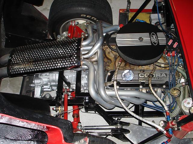

Post pictures of the frame design and we should be able to tell you. It may be a KVA looking at the body. Must see the frame sections front and rear, Scott

Here are a couple of the rear suspension. Don't have any yet of the front but will get some this evening. Thanks for any help. I think it is a KAV with the "C" series frame. But would love any help.

Boy I know the first thing I would do is re-route those fuel lines. That is a good way to get vapor lock or a fire even with the insulation.

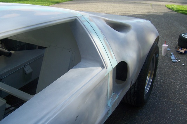

Looking at the radious rods and the rear body section I would say it's not a KVA. The rods are to short (might have been an early type frame?) compared to the "C" type chassis. I have a KVA body on my car with a CAV rear section (long story) and they were not the same. The wheel arches are more like a CAV and door to center section to rear body "line" is CAV. Hope this helps.;)

Larry,
I have a KVA and except a few minor differences, yours looks just like mine. The front suspension upper control arm has a minor design change. A company named Sabre, I believe bought KVA and was later purchased by Integrity Works (I may have the line of succession in the wrong order). Mine dates back to late '94 when it was purchased by a prior owner. Let me know if you need more info!

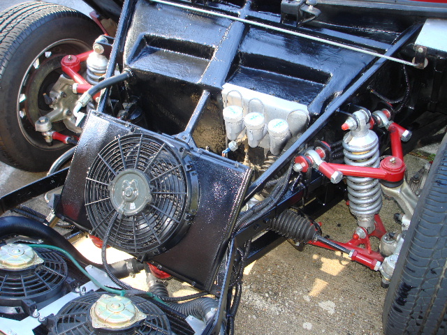

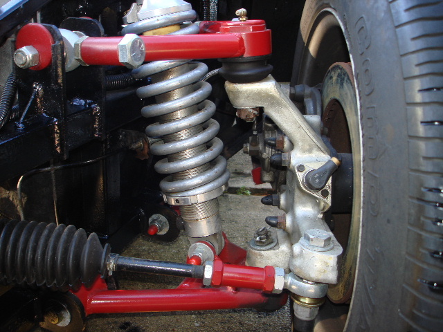

Some of the Sabre cars use Corvette C4 rear uprights , I believe and that dictated the short arm syndrome....
Larry's car uses Corvette C4 front uprights as shown above...

Larry, as a side question, what is the set-up with the front coils? Is there a near horizontal radiator and an upright air conditioning condenser?
Dalton
Dalton, They are adjustable coil over shocks with lots of adjustment left.
Yes the radiator is almost horizontal and the a/c conditioner is about upright.
Larry
