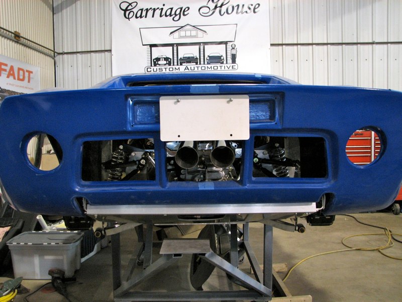

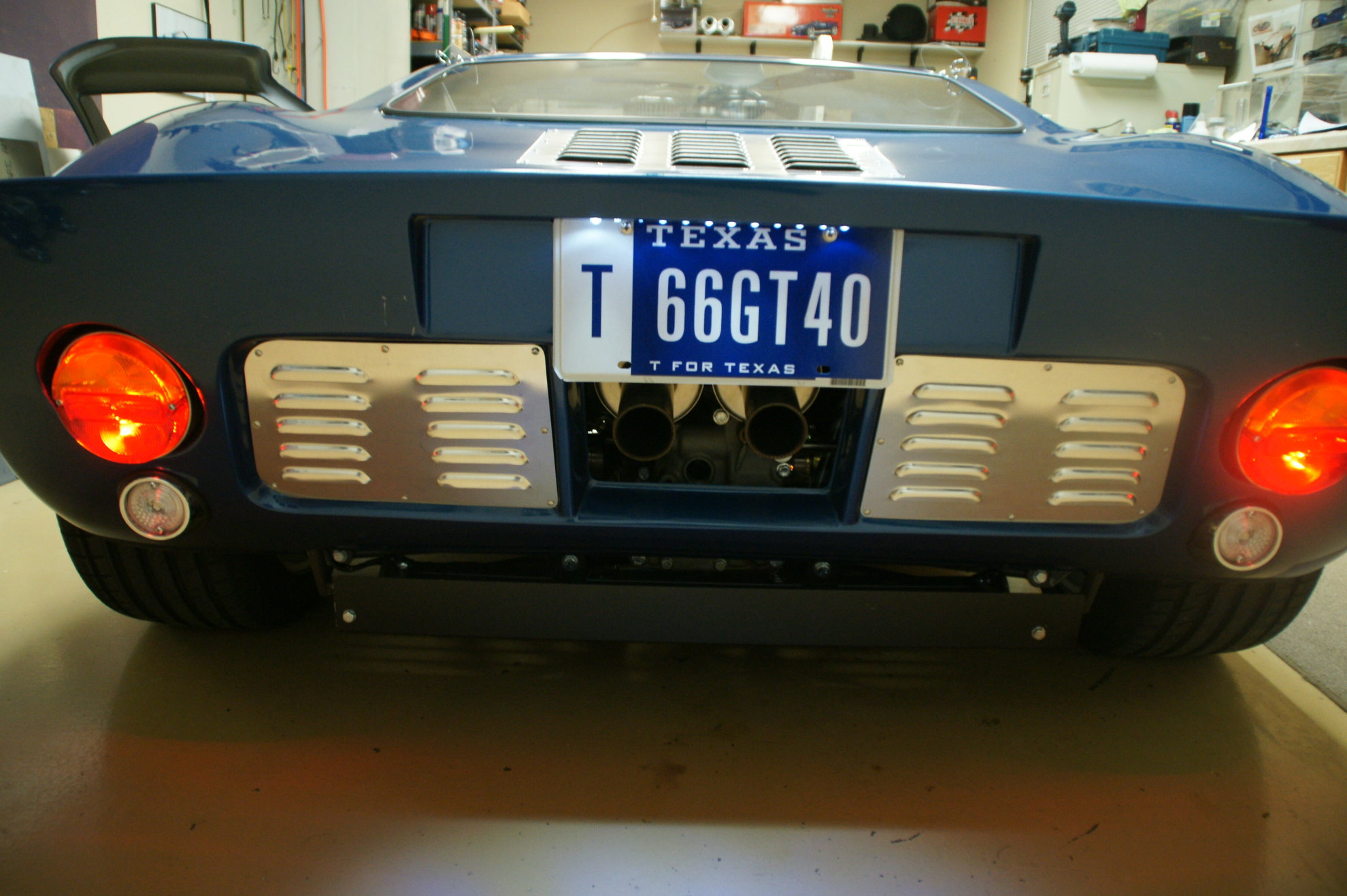

P2388 is now in the final stages of install and being the enthusiastic person I am, I got ahead of the DMV and already have title and plates for the car. I'm wondering if anyone has an elegant solution to attaching the rear plate other than just fixing the frame to rear grill. All pics and input welcome.

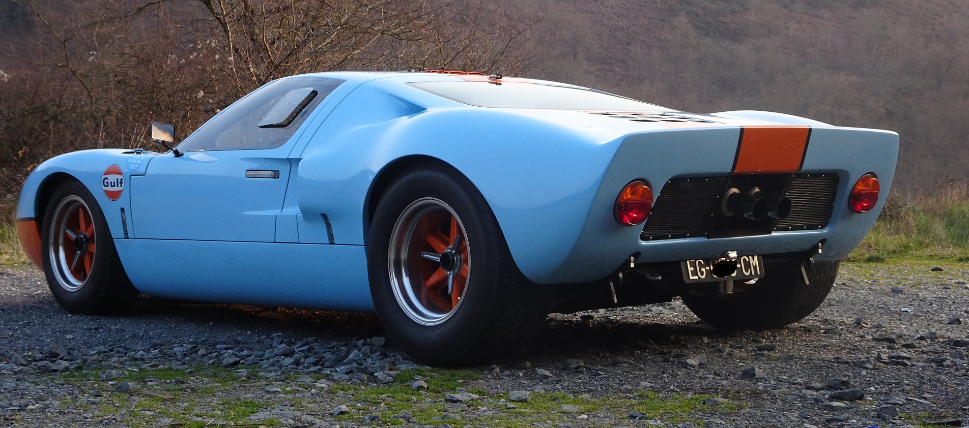

Dave Hood

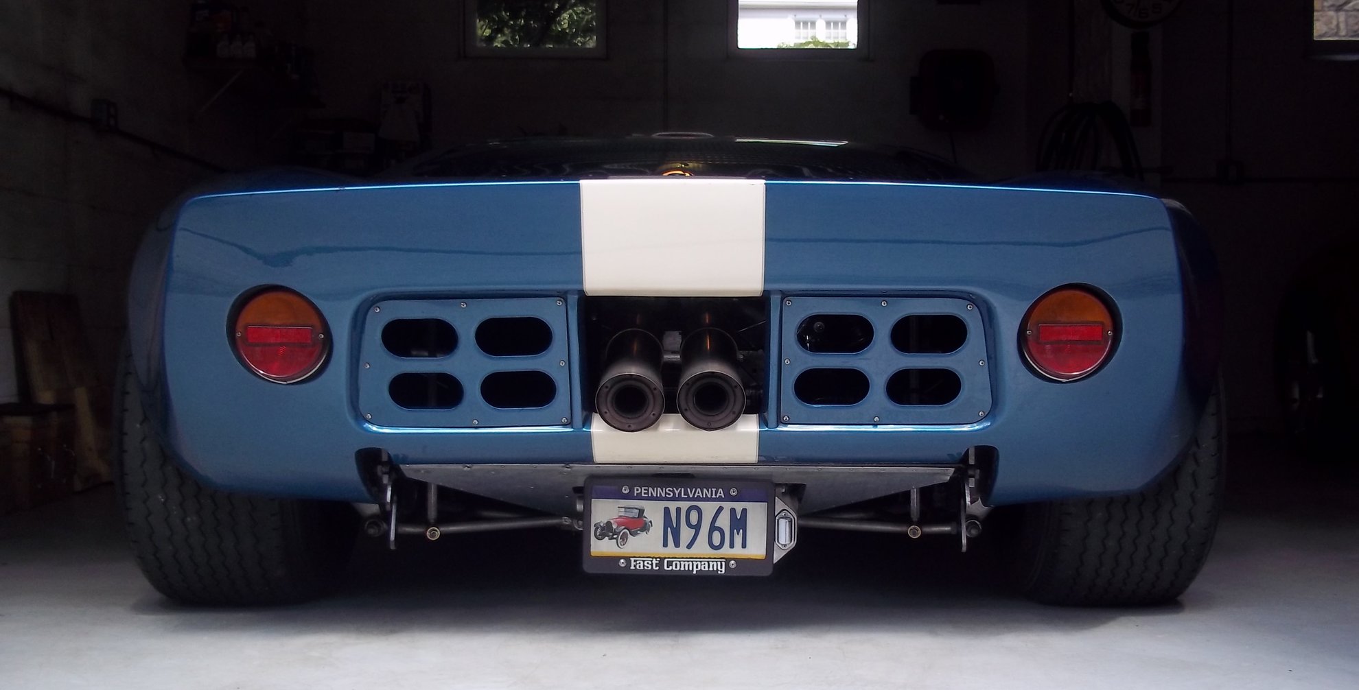

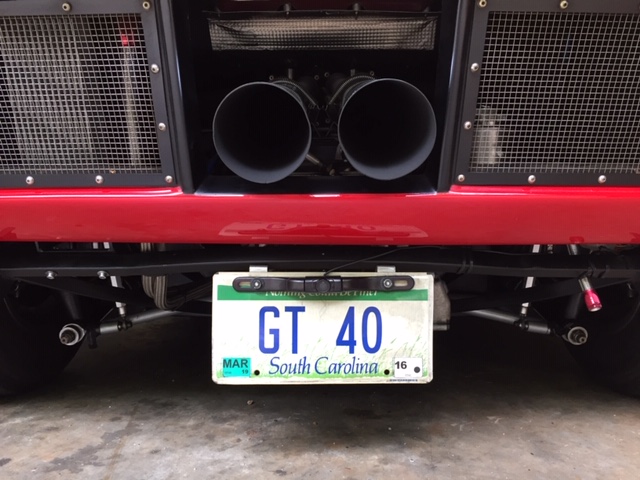

When Dennis Olthoff set up my car seven years ago, he used a very simple solution that I really like. He fabricated two 1 inch brackets that are screwed underneath the back frame rail. This centers the plate and also minimizes the visual impact on the back of the car. You can also see in the photo that I've attached a rear-view camera on the plate as well. Perfect position for helping me to back up into parking spaces. The camera is attached to a wi-fi device that syncs to an app on my iPhone which I sit on the dash.

Dave, what model of back up camera are you using? I'm also looking for a wireless model to use with my iPhone

Thanks for all the suggestions. As I plan to drive the car home from the installer ( what could possibly go wrong!), I will go with Ricks solution and then look at it over winter. I need something to do!

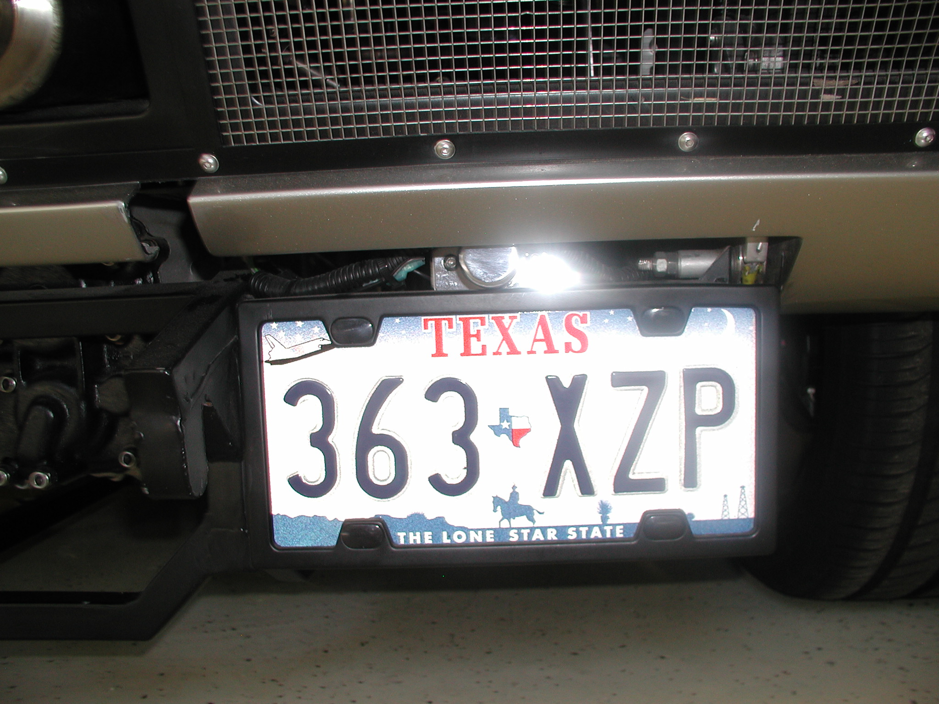

Cameron,

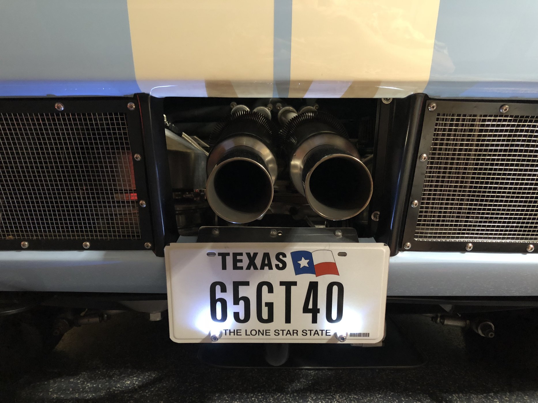

You can see what I did on post 90 and 99 of page 5 of my build log "Tornado GT40 in Texas". See link below. This puts the plate about 1/2" up into the body work. The Texas plate must be larger than Randy's since even with my insert into the body, Randy's and mine look about the same, but then everything in Texas is bigger...
Here is the final look.
-Bob Woods
https://www.gt40s.com/threads/tornado-gt40-in-texas.42186/page-5#post-449612

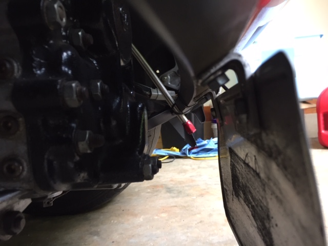

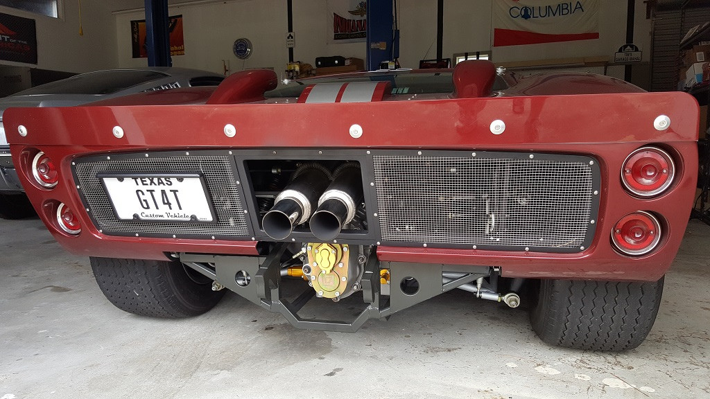

P2306 with a Camaro bracket, heavily modified, and Rick's Lite n Boltz:
Bracket: https://www.summitracing.com/parts/sle-59388
I cut about 3" of the mounting flange off, turned it upside down and used it as a clamp. There are no holes in the body. 3M tape underside of the body to stick it, and rubber tape over the paint to protect it. Yes, I know the muffler tubes are crooked, working ... :(

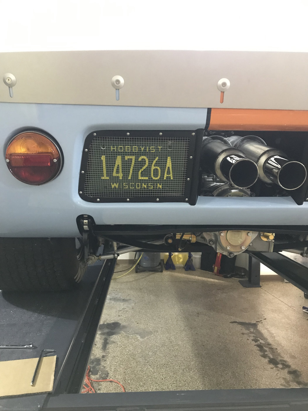

After the multitude of suggestions. Thank you! I mounted the plate below the center of the exhaust, and just didn't like it. So after consulting a few other GT40 owners, I did this. Required some liberties with the license plate, but I like the solution. For now!
I will bolt up tomorrow and wire in the lights and be done.
Thanks to Rick Muck for the lead on the LED bolts.
Cameron
