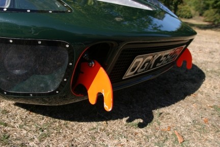

The quicklift points are usable, but use both in each end at the same time. I think Olthoff sells a usable device, and I think I have seen the dravings for one on the forum if you want to make it yourself.

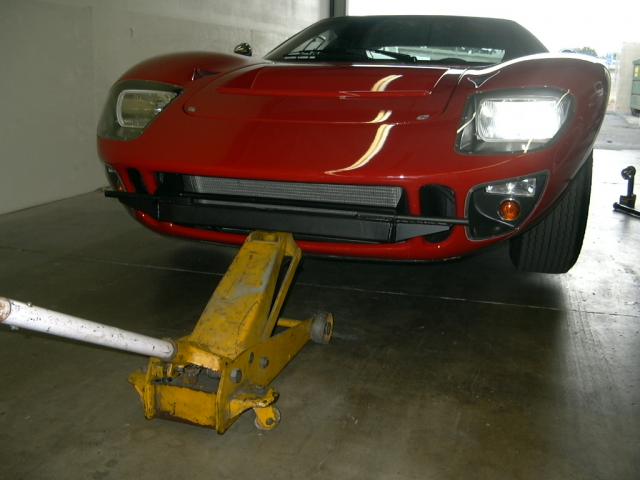

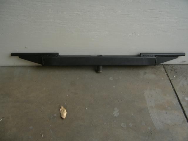

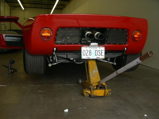

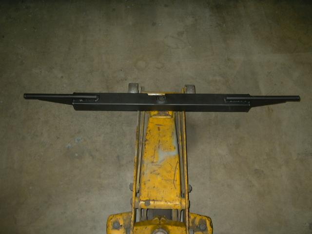

Here are some pics of a floor jack fixture I made to lift my car.

The rear subframe is also triangulated and is designed to support the rear clip and provide a jack point. It is bolted to the rear of the monocoque at the top and bottom of the gearbox/suspension mount surround. Do not be affraid to use the quick jack points at the front or rear of the car as long as they are used together. (Meaning to use both front or both rear together and not just one corner)
Thanks for the info and photos Rick. Would you mind providing the size of material you used to build your lift? I assume you used tube not bar stock, correct? If its not asking to much, measurements? :shy:
I'll second that. It looks like a very practical little welding project. Nice, simple design.

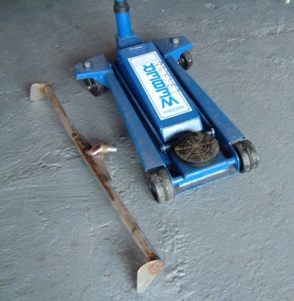

This Weber Trolley Jack is great as it's a very low profile and can get under every part of my car. The rubber pad on the end lifts out and the
quicklift stainless bar( beside the jack in the picture) simply slots in and the 'fences' on either end inhibit the bar from moving laterally and, if fact,
locate the whole thing centrally. My quicklift was made by Henry Atherton,
who has now left the UK. He now has a fabrication shop in France - in a small town called Tanus. Watch that space as it was Henry who fabricated most of the Safirs in High Wycombe at Adams Mcall Engineering.
If you ask him, no two Safirs were made the same. Why ? - because he felt like it.
