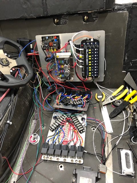

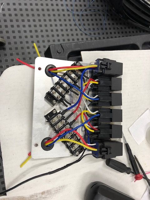

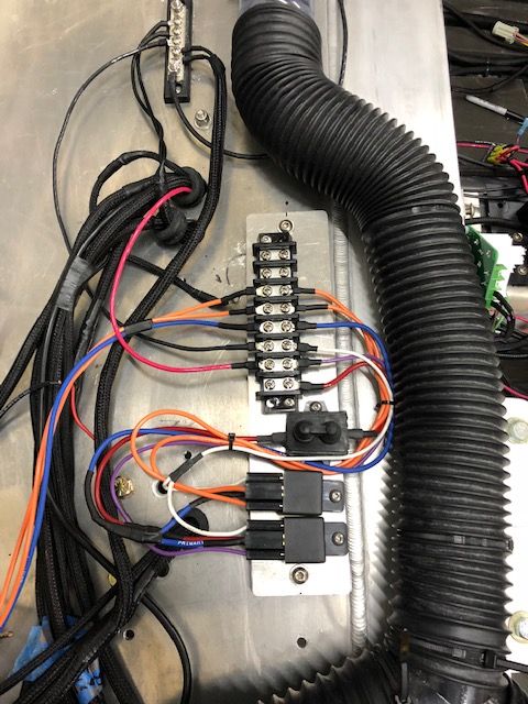

The wiring is almost complete. This one relay board is just used to control the running lights, turn signals and four way flashers, so that the running lights will shut off it either that side turn signal is used or of the four way flasher is used.
This look a little messy now, but it will be organized and neat when I am done.

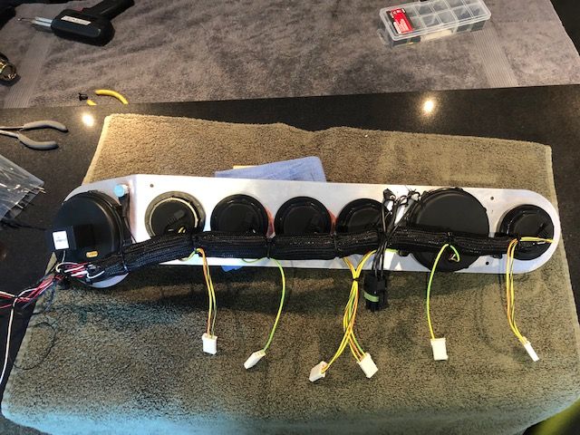

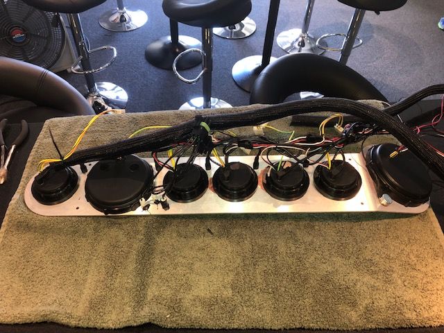

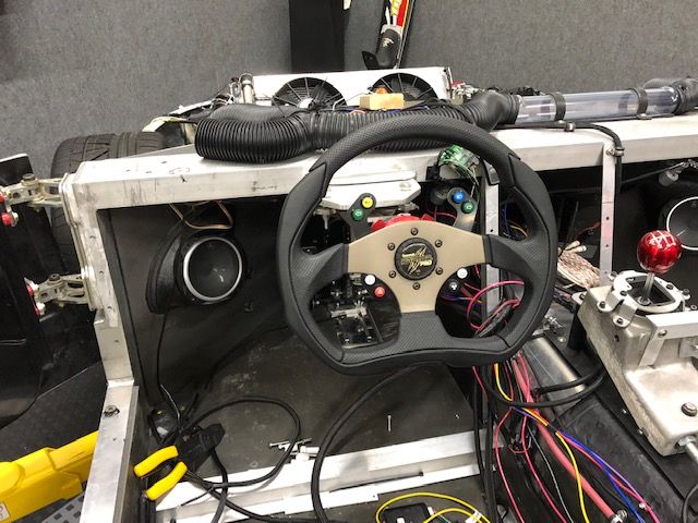

This is the dash gauge set final wired and organized. I want the final install of every component to be as easy and least likely to get scratched as possible, so these wires needed to be wrapped.

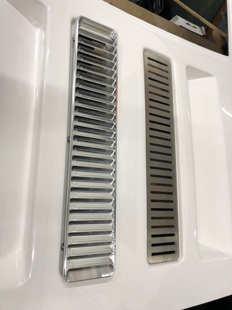

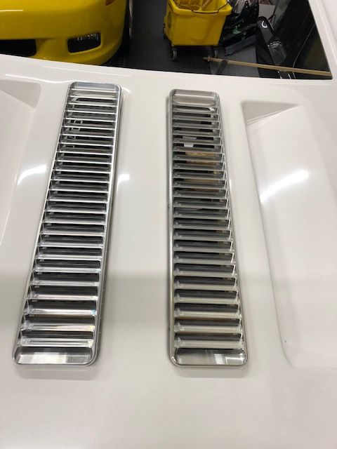

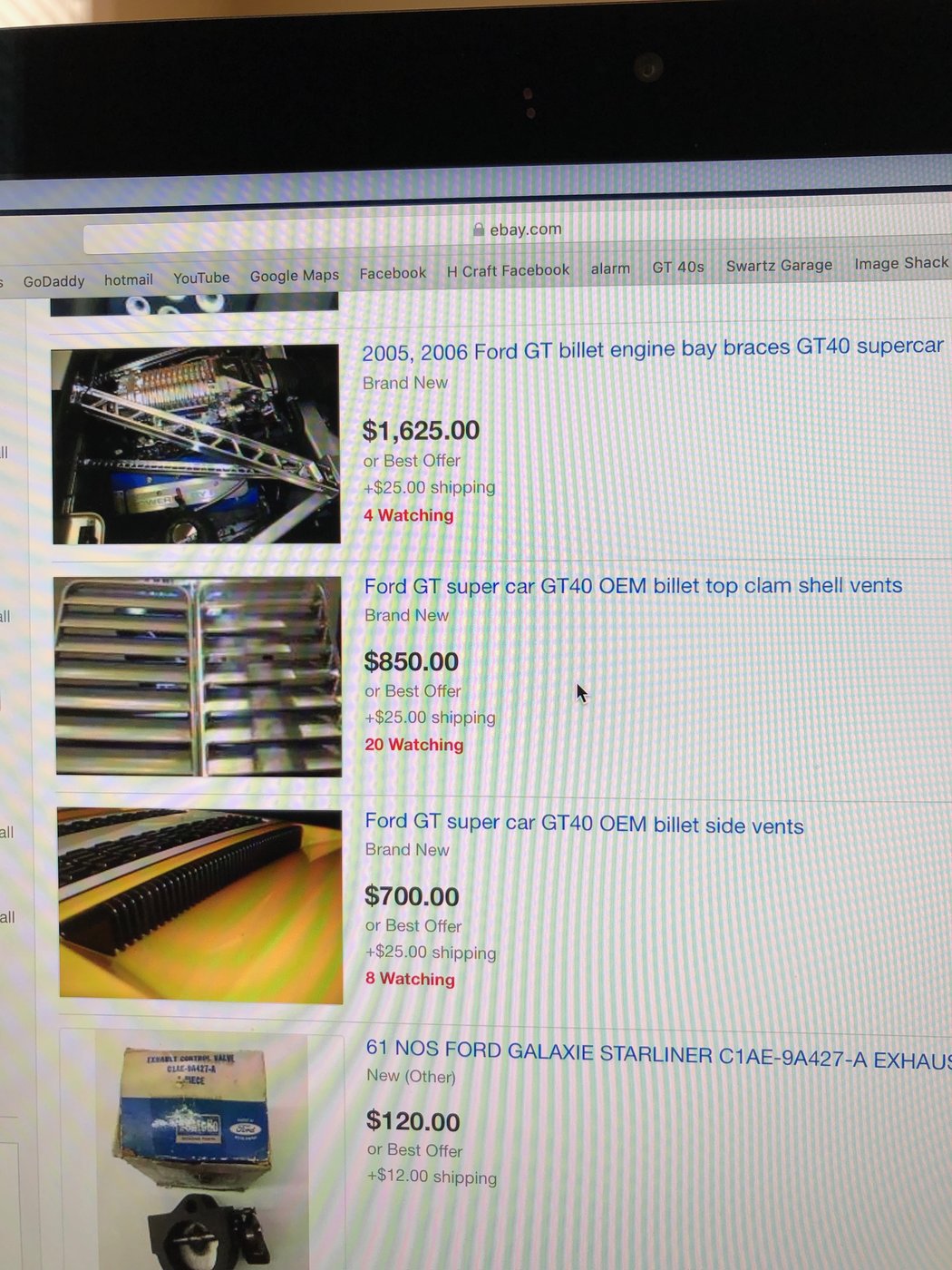

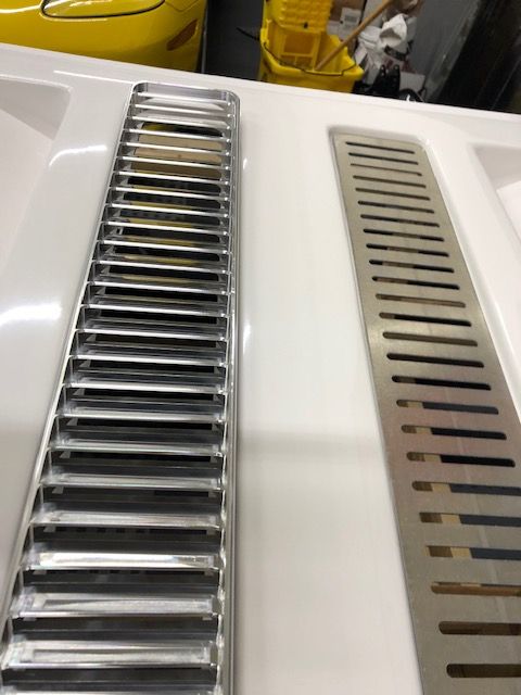

The members of this forum have helped me again. Luke S suggested I consider adding billet louvers to the rear clam to add to the look already started with the carbon fiber intake and valve covers. I never really considered it until he mentioned it. He was absolutely right. They look great. H used them so I should have been more alert to see then in his build. Thanks Luke for following the build and making the suggestion. At the beginning of my build, Ken suggested a change in the air cleaners and the diameter of the intake tubing leading the throttle bodies. He was also absolutely right. Wait until you see what that that looks like when I have that finished!

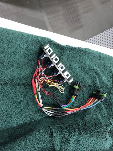

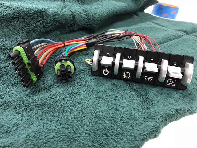

Still working on the wiring, getting closer to having it finished. This is the switch panel I will be using in the overhead console. Watson Streetworks made the switches. Really nice stuff. Ignition On, Headlights/Running Lights, Fog Lights and Interior Light, all with indicator lamps. I will make a backing plate to the exact shape of the overhead panel indentation out of stainless, then clearcoat red over that stainless panel to match the other red accents. The stainless will only add about a half inch border to the top and bottom, and about 3/4 inch to each end, but it should make the look more precise, given that I could not get and exact fit from Watson's available sizes.

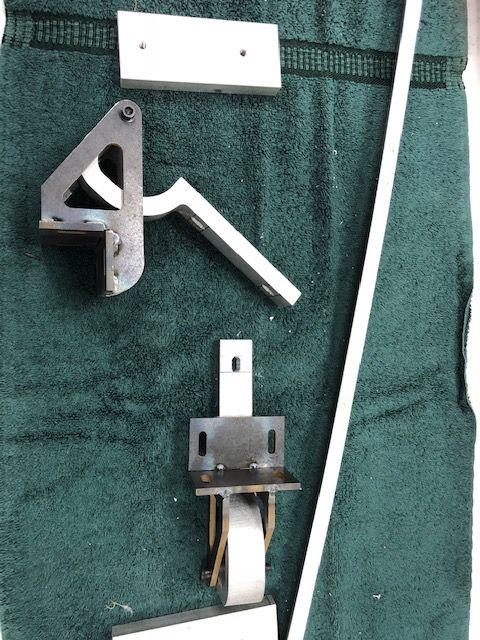

I just received the rear clam hinges I asked H to make for me. Again, the master delivered. The cross brace for re-enforcing the clam is curved to fit the inside of the rear clam perfectly and I know the hinges will work. Thanks H.

The relays and circuit breaker here may look familiar to most of you. This is my circuit board for the Vintage Air System. After looking at some YouTube videos on installing this system and hearing the pros and cons of reducing the wiring that was provided by Vintage Air, I decided that the people at Vintage Air must know the reasons to install the system as they designed it, so that is what I have done. I just need to add the trinary switch wiring and that system is installed.

I have the wiring almost complete, and went through testing each circuit. Most of them tested great, until I got to the circuit involving the Summit Raptor Pro. As soon as I put power to that system, the right turn signal started blinking not having tough any buttons. Pushing the right turn signal button would not turn it off. The only way to turn it off was to push the 4 way flashers. The right turn signal would then only turn on occasionally after repeated pressing the button. I got in contact with Summit Technology, but they said they could not help me, that I had to go through the retainer I purchased if from. So far no response from my contacting the retailer. More to come, I hope. Dead in the water on the electrical until this get fixed.

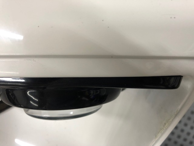

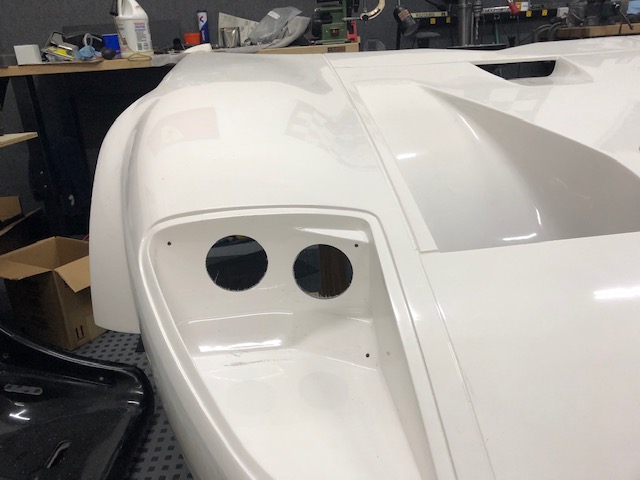

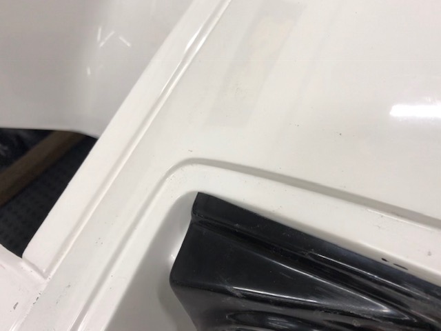

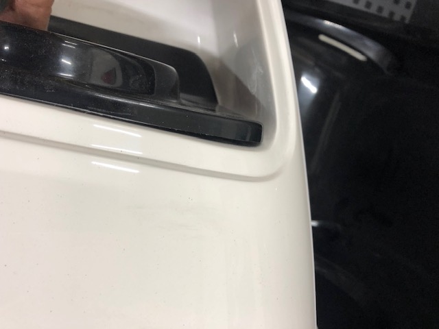

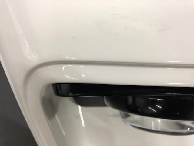

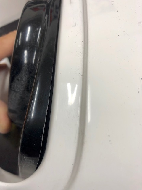

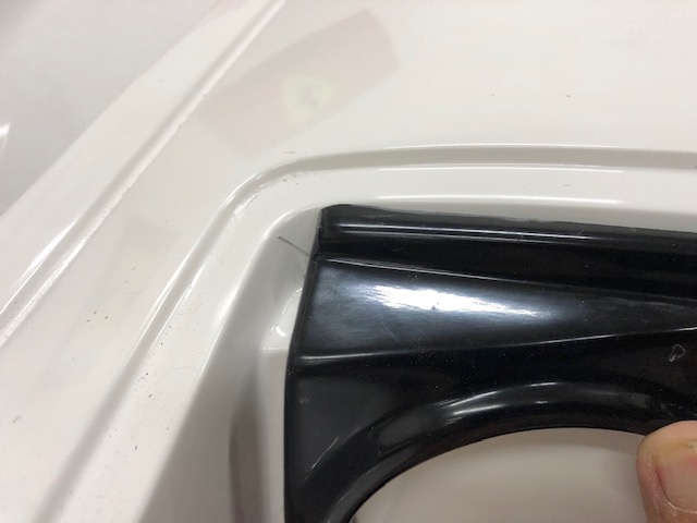

The body is the next step. Headlight frames need some fitting.

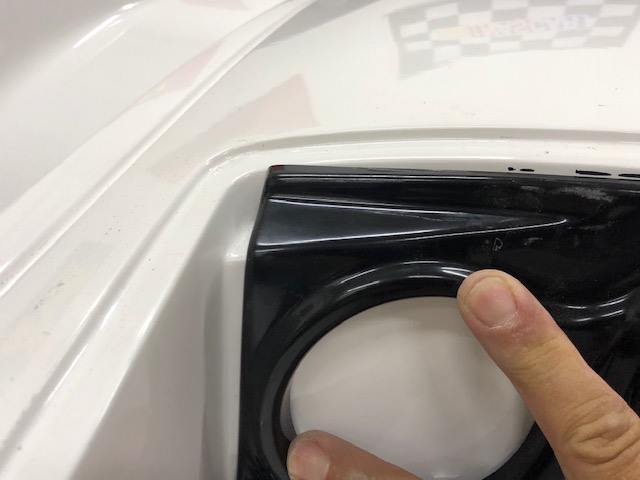

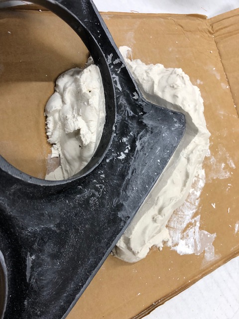

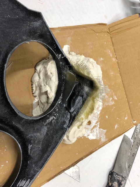

Used some plaster to make the mold to extend a few areas. After roughing up the areas needing additional material, I added the fiberglass. Selective spot trimming and finally got a reasonably fit. This is the before.

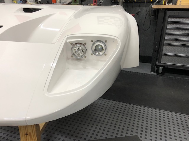

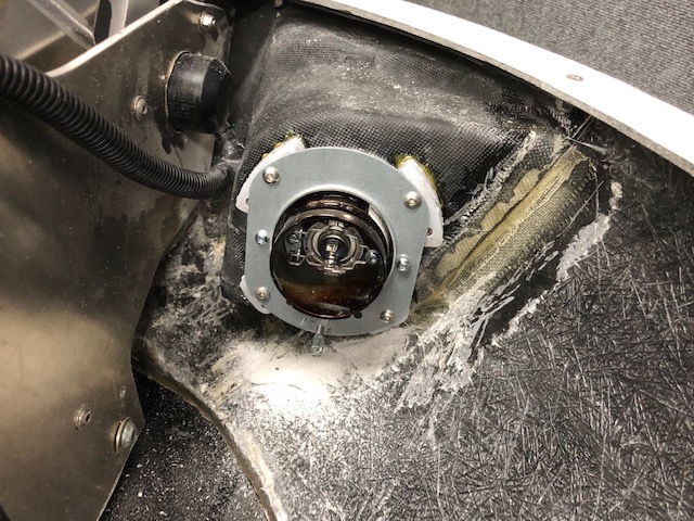

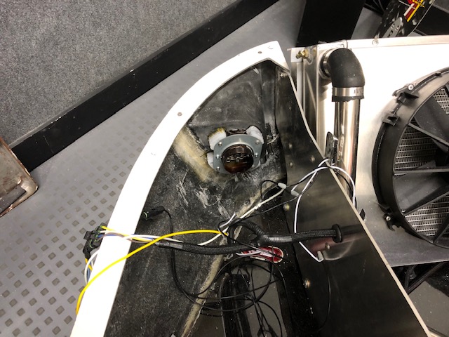

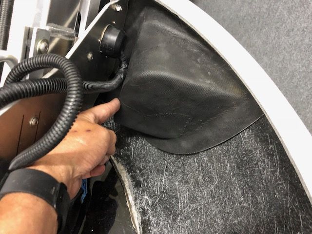

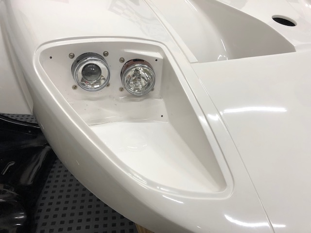

I will be painting the inside of the headlight buckets silver, matching the strips color. The headlight are in position, but still need spacers to get their depth correct.

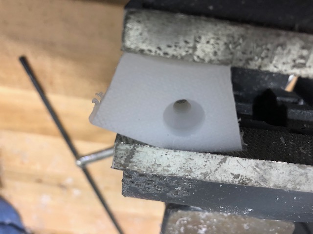

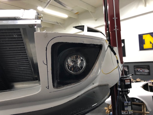

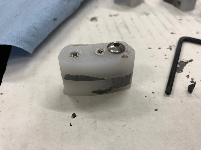

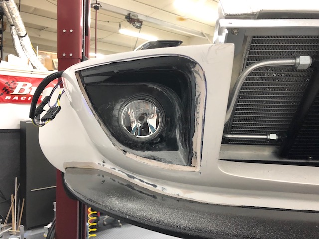

Mounting the Fog Lights is a little more complicated than the head lights. The head lights have a trim piece to cover the mounting screws. The Fog Light buckets have no trim cover. I did not want the screws to show, so I used some plastic boards. The Fog Lights needed to be set back an inch from the bucket surface, so I used half inch plastic, shaped it to follow the curve of the light mounting, but made the four mounting spacers allowing space for the light to move within the frame to adjust the focus on the road. I drilled matching sets, but inserted a nut between the two half inch plastic sheet, then screwed the two half in together to make a one in spacer. Contact cement was used tp attach the plastic the back of the bucket.

Mark two questions where did you get the louvers for the rear tail and how large are those switches if you hold them up to the dash like the original location was back in 2006. I assume you should be close to firing up soon.
