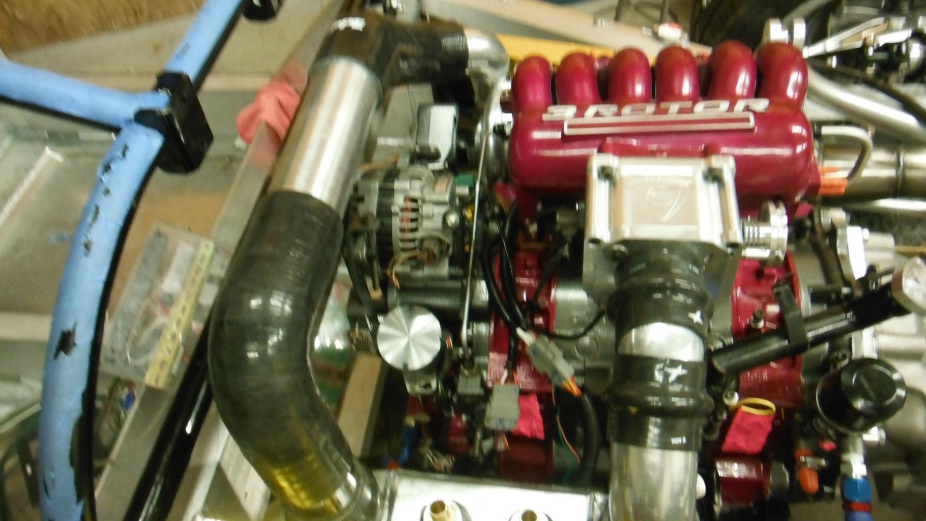

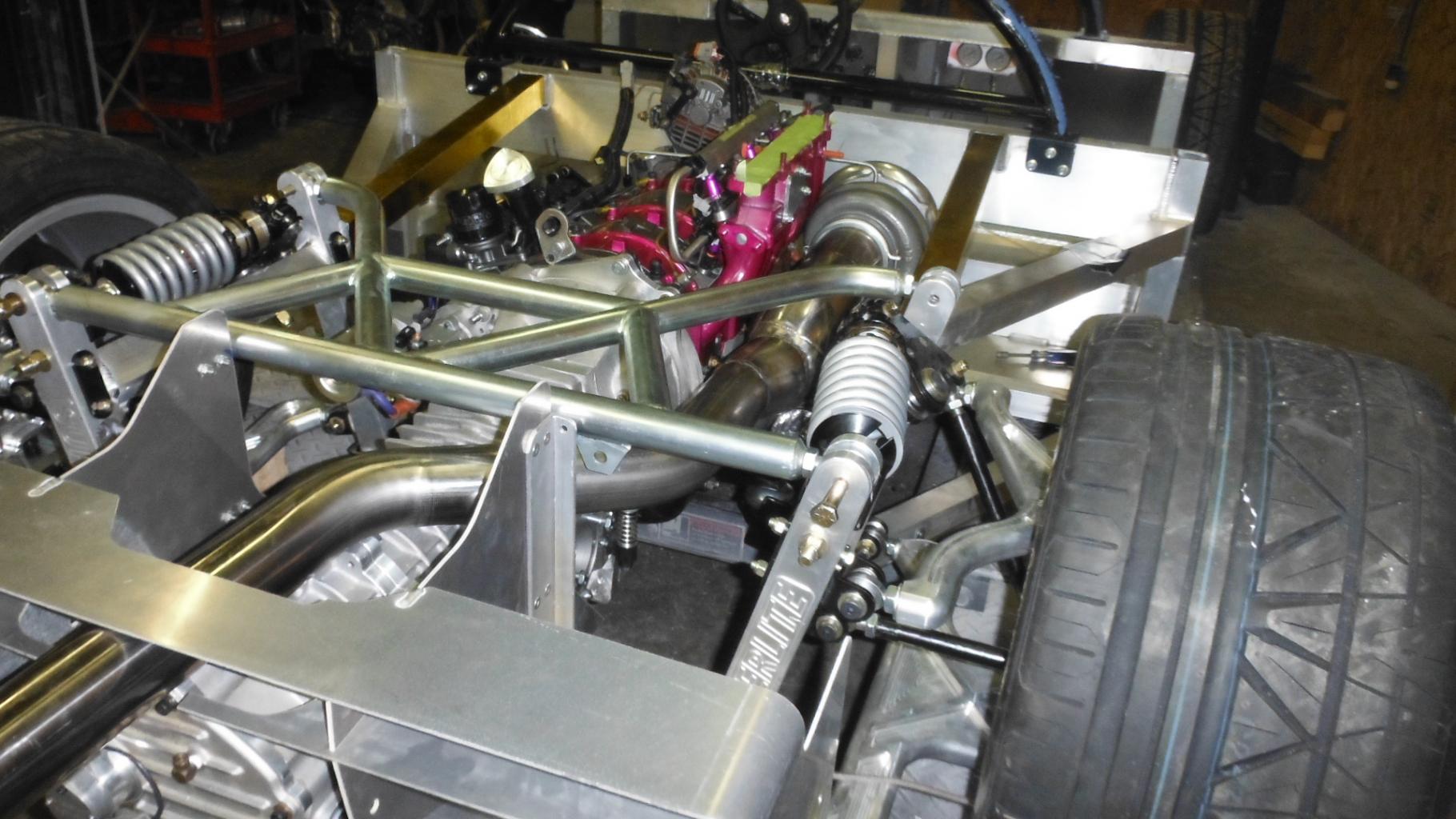

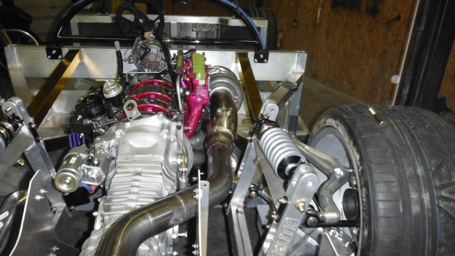

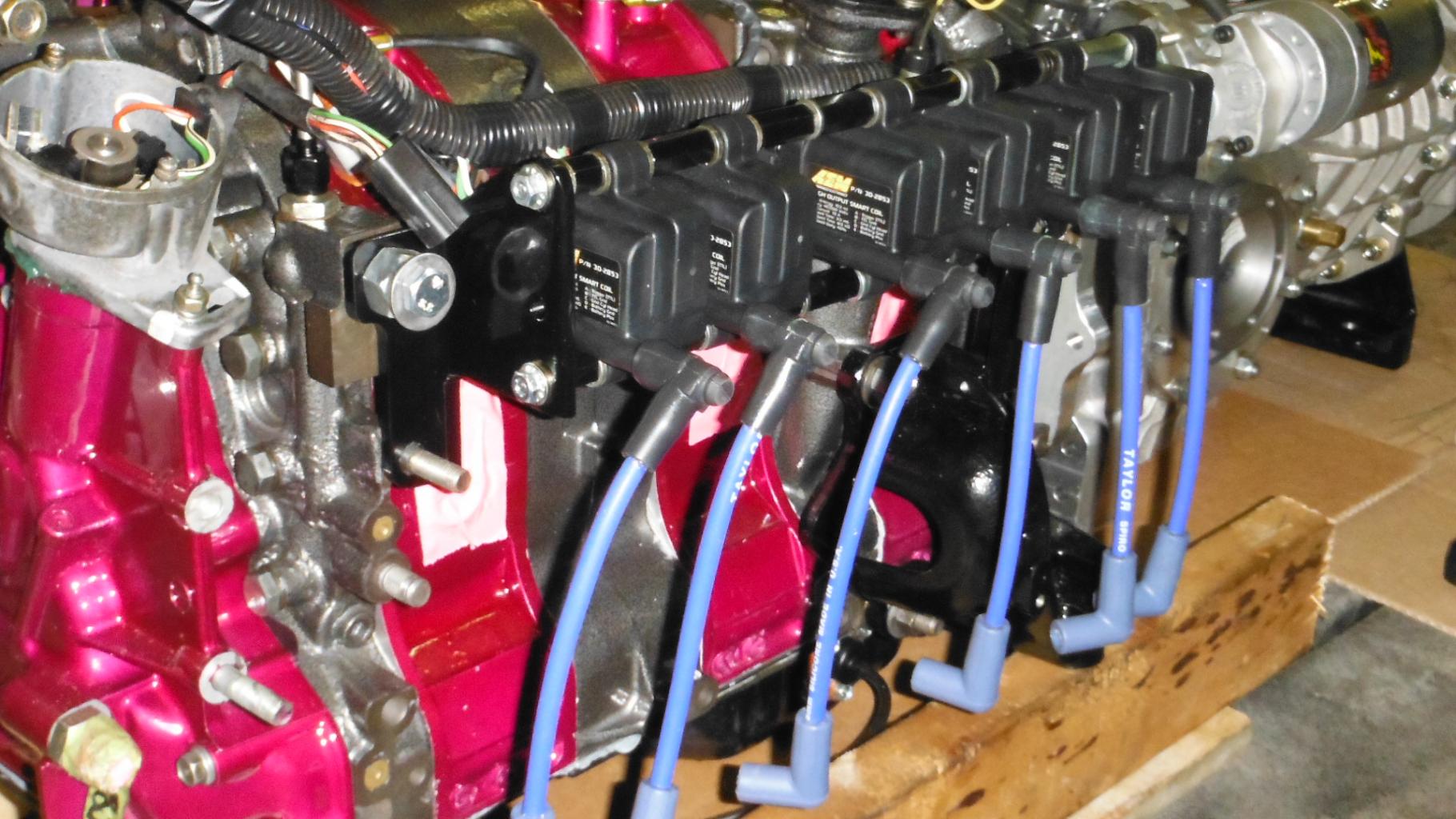

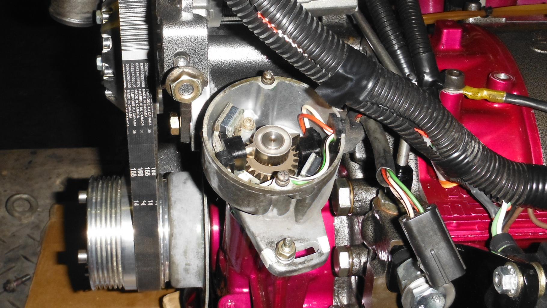

Here are some more pictures of my motor in the car, wiring harness made for the coil packs, and injectors. Going with water to air intercooler, that will be here tuesday along with the oil cooler, getting close to starting up, next couple weeks hopefully.

That looks Glorious! Too bad most morons will look ask if its electric! LOL! Plus your going to need a muffler that is HUGE to have your neighbors not kill you.
Well, people tell me to run straight, the turbo quiets it down, so I will go with that for now.
The shipper bill was 385 lbs for the motor less the alternator/turbo/and manifold.

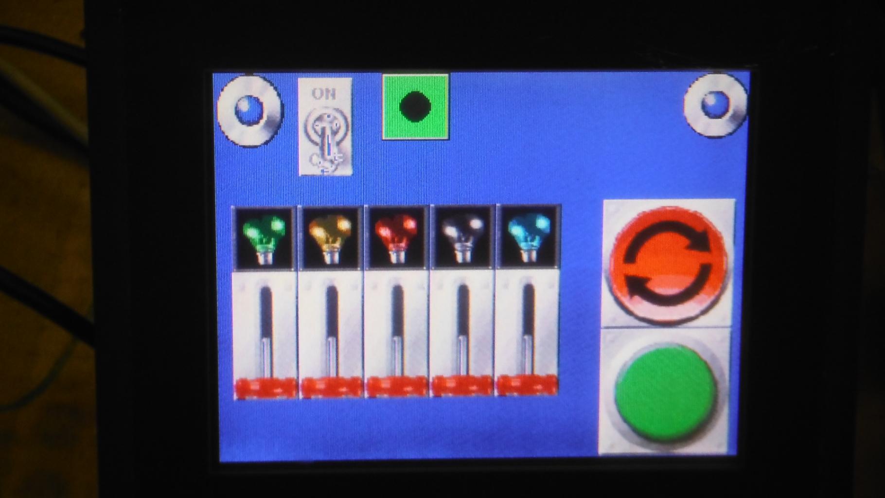

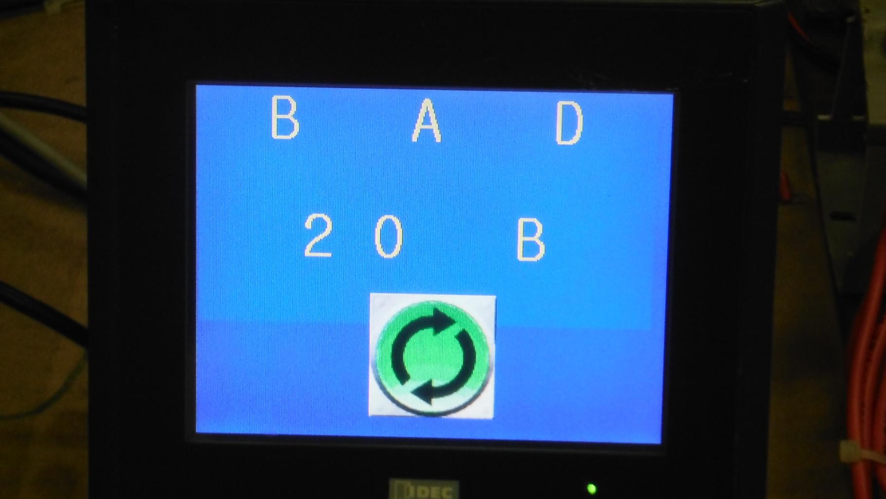

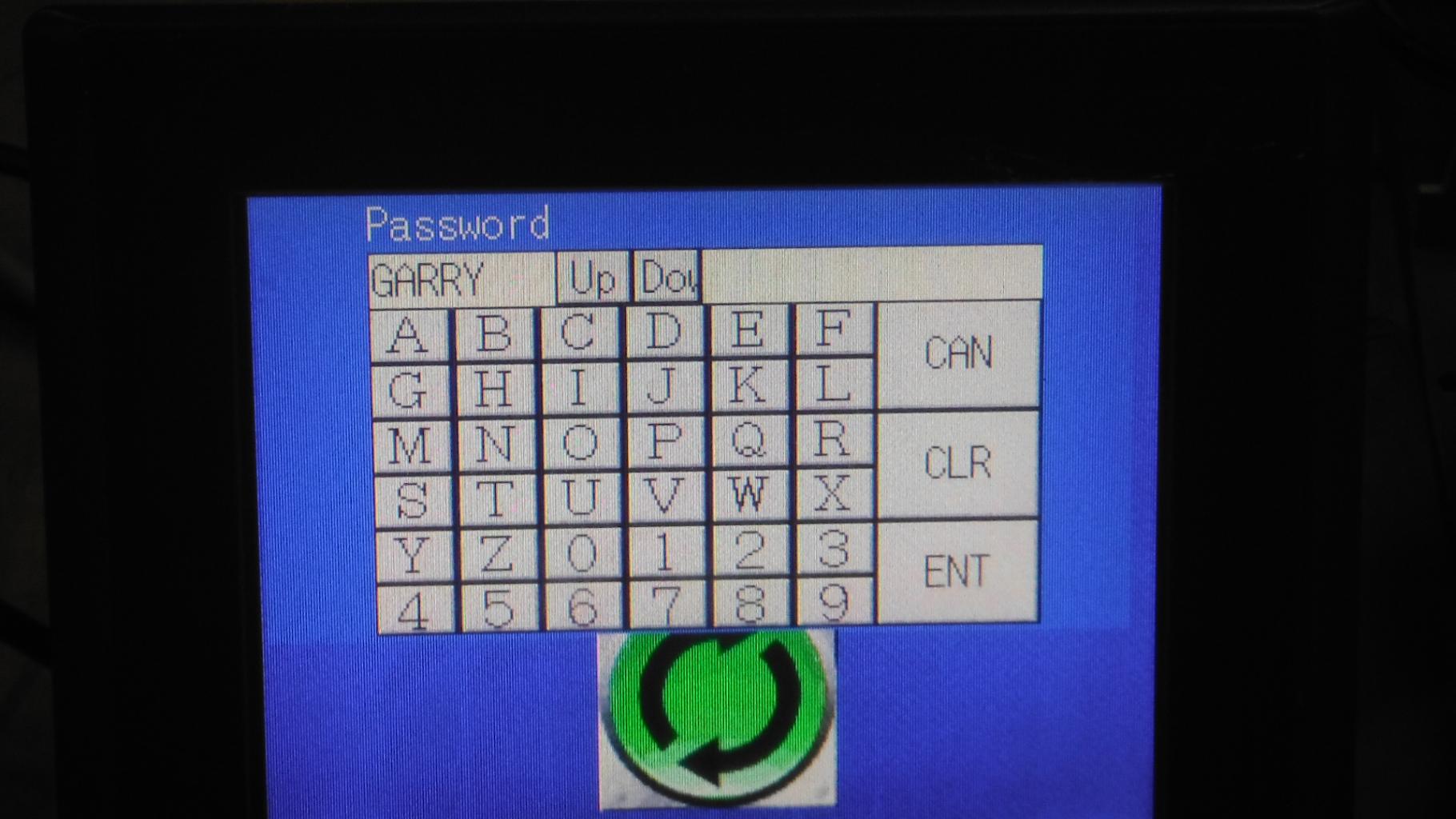

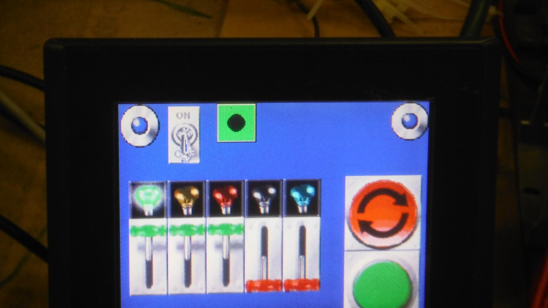

Here are a few of my touch screens to run the car, motor, lights etc.
There is a security screen, then after that is punched in, continues to the start screen and turning on ignition, fuel pump, water pump, fans, etc.
The PLC controlls the blinkers, brake lights, they flash 3 times then stay on, wipers, etc.
I'm thinking I might mount the touch screen in the steering wheel.

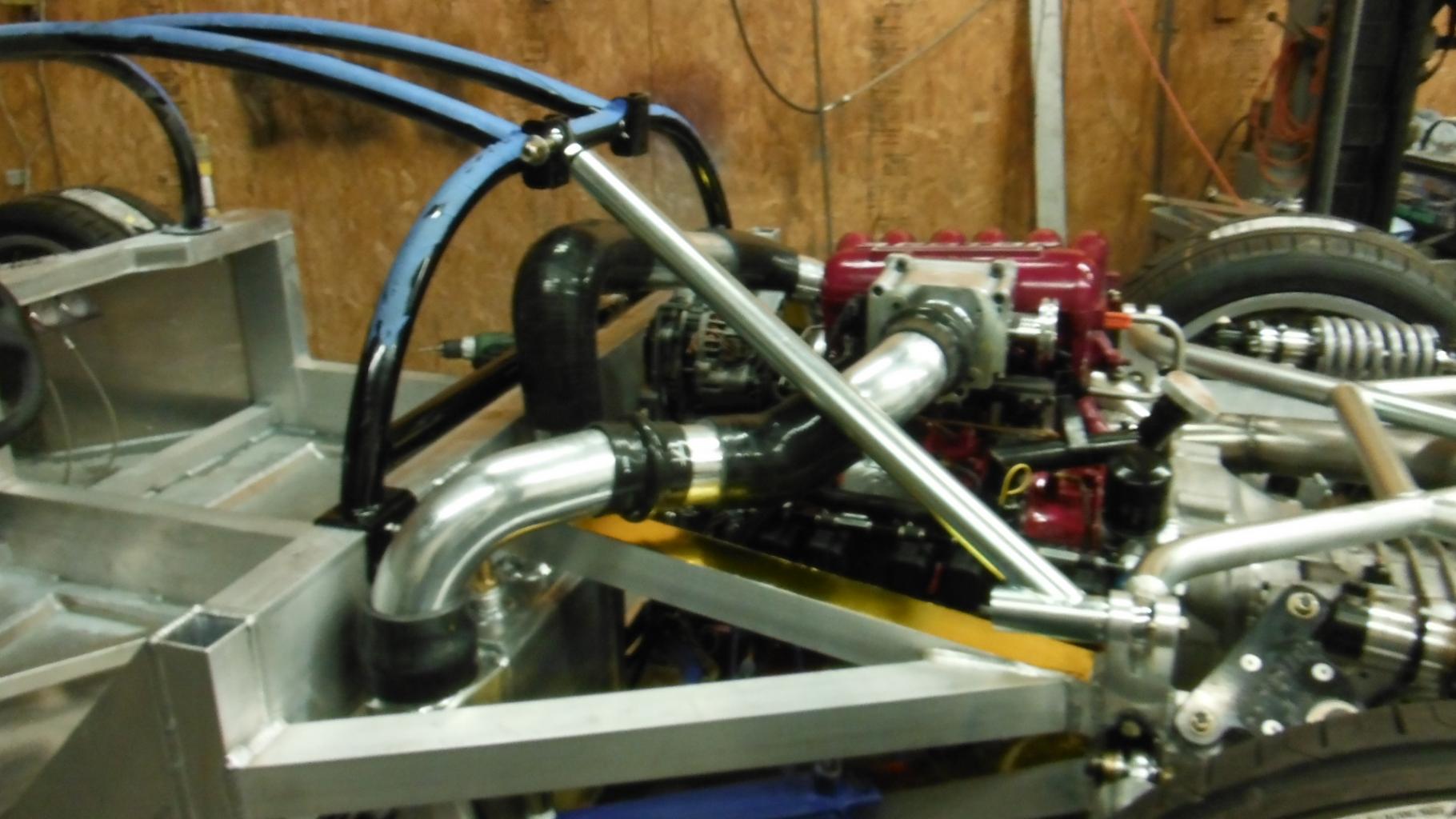

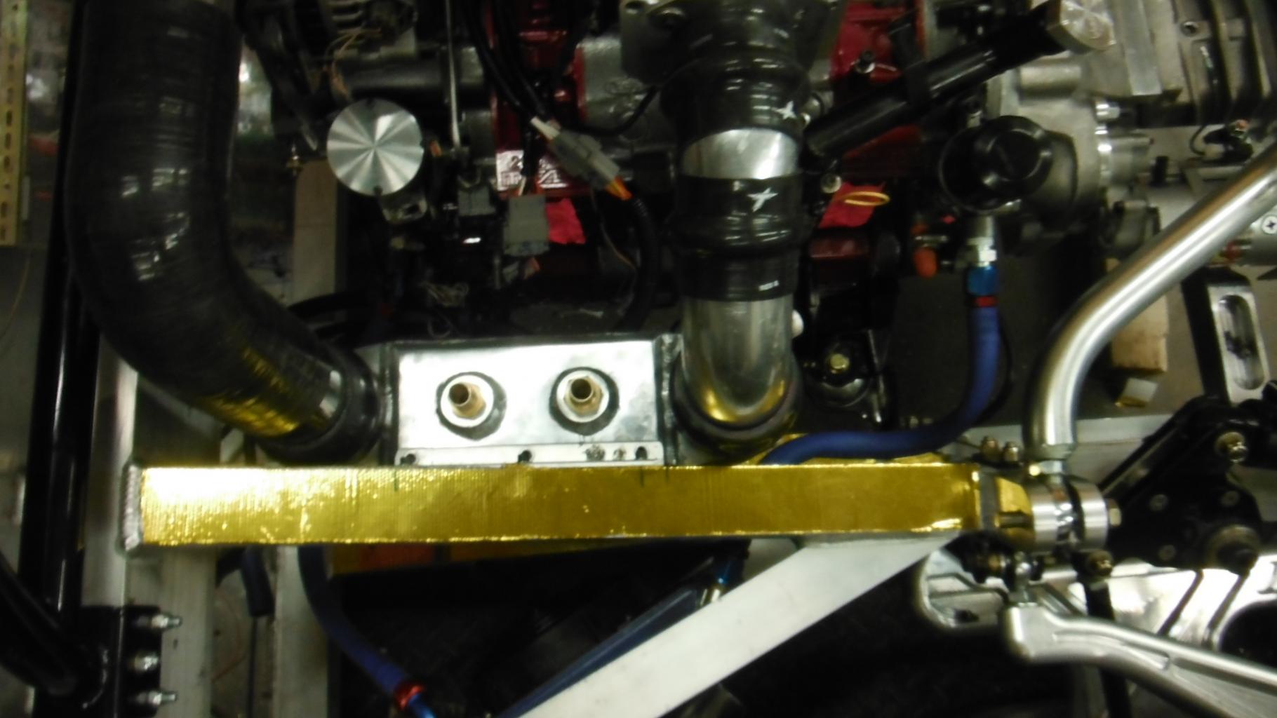

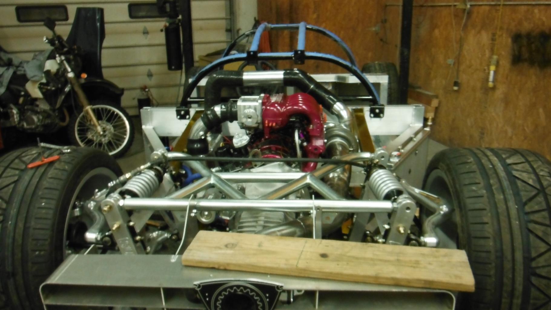

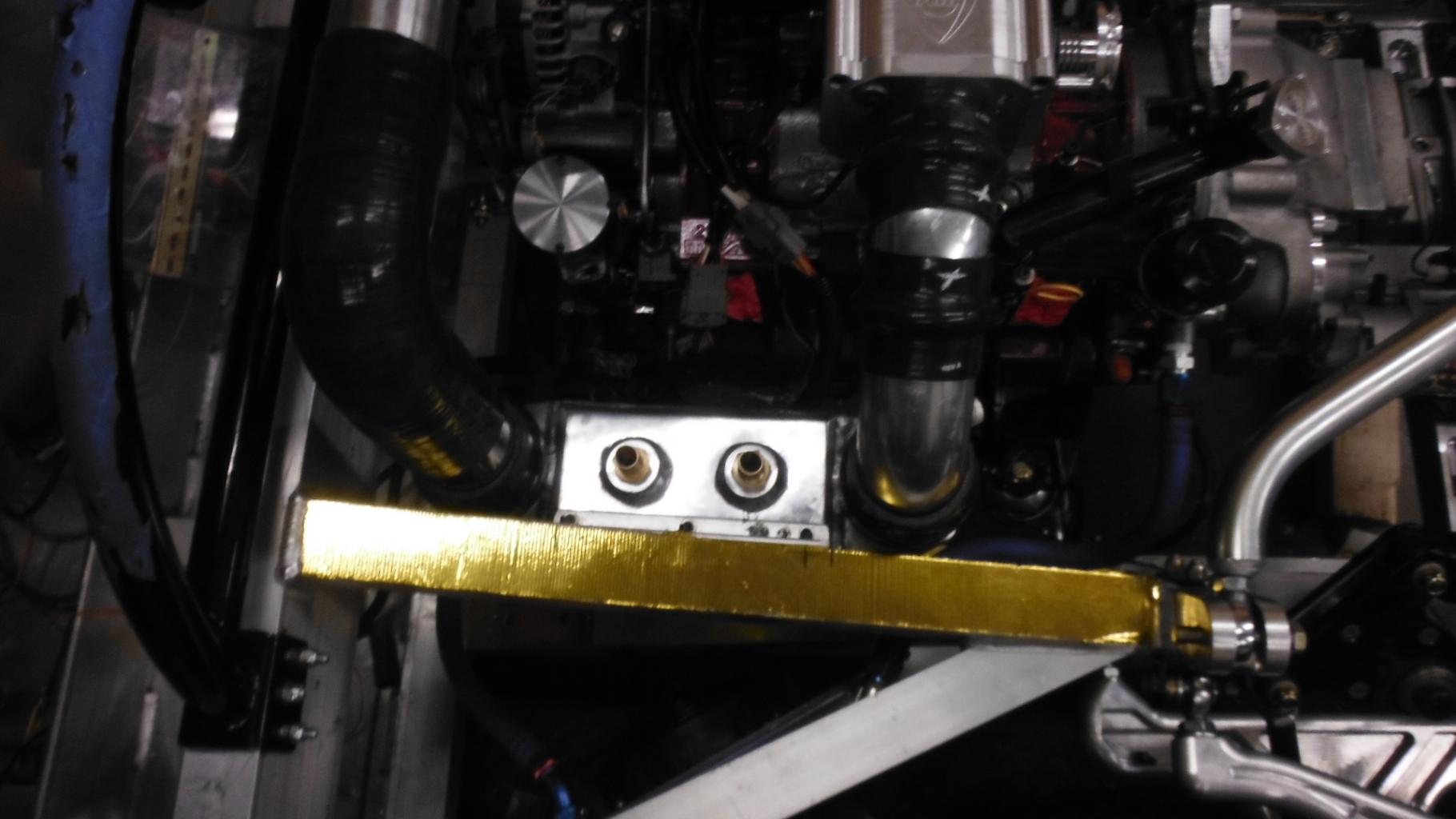

Turbo and intercooler plumbing, had to change a few things after I put the body on where I mounted the intercooler the first time, then putting the piece of the roll bar that mounts to the back, became another problem.
Its figured out, not to far out on starting it. Oil cooler mounted, intercooler cooler mounted, everything fits now inside the center section. The first picture shows how I mounted it till I put the body on, had to move it.DSCF0425.jpg

Coming along nicely. From the pics at least, it looks like you have adequately sized coolers for the IC system. My only concern would be the location of the oil cooler and heat exchanger and getting adequate airflow through them, in particular the heat exchanger, to prevent heat soak after anything more than a 1/4 mile pass. Since you are not running AC, why not mount the heat exchanger up front in the best airflow?
There is another builder who has located his primary and only radiator in that position. I'm sure I'm not the only one wondering how well it will work.
THe tube from hte turbo outlet to the intoercooler looks a bit rough. I think a tube with almost a continuous radious would perform a bit better. The 90 on the LH side looks a bit tight. Easy for me to say from the pics as I don'y know about additional interferences. Great job of getting it together. Can't wait to hear the vid.
Well hopefully between the air duct on the side of the car and each cooler have fans on them, the inter cooler has 2, the oil has 1, I do have room to run another oil cooler if needed.
I didnt know that it mattered about the plumbing from the turbo on the 90 degree part, if it will be better for flow, I can make it a radius, or use a couple 45 degree rubber couplers, this is my first experience with a turbo, blowers are much more simpler.
