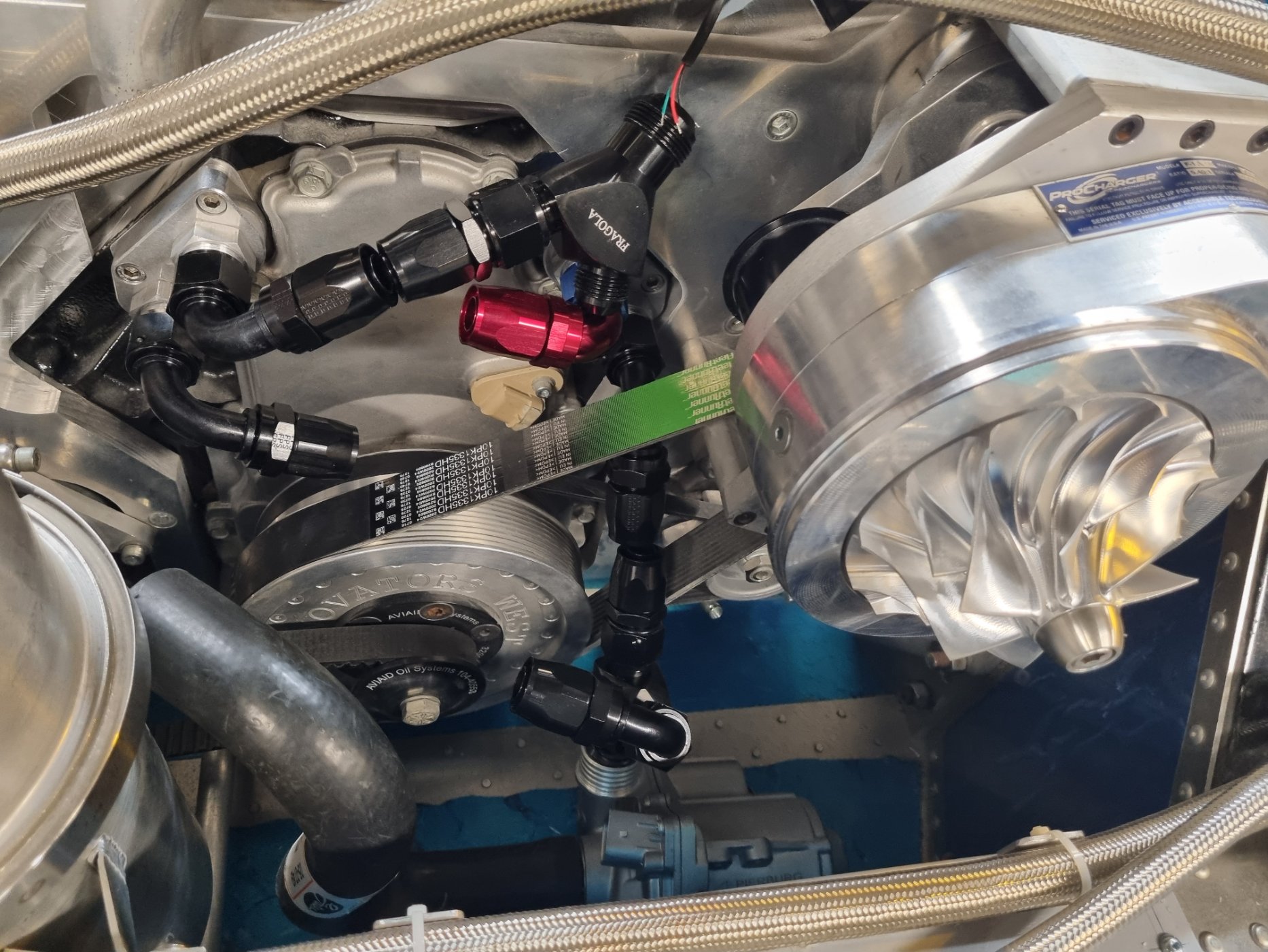

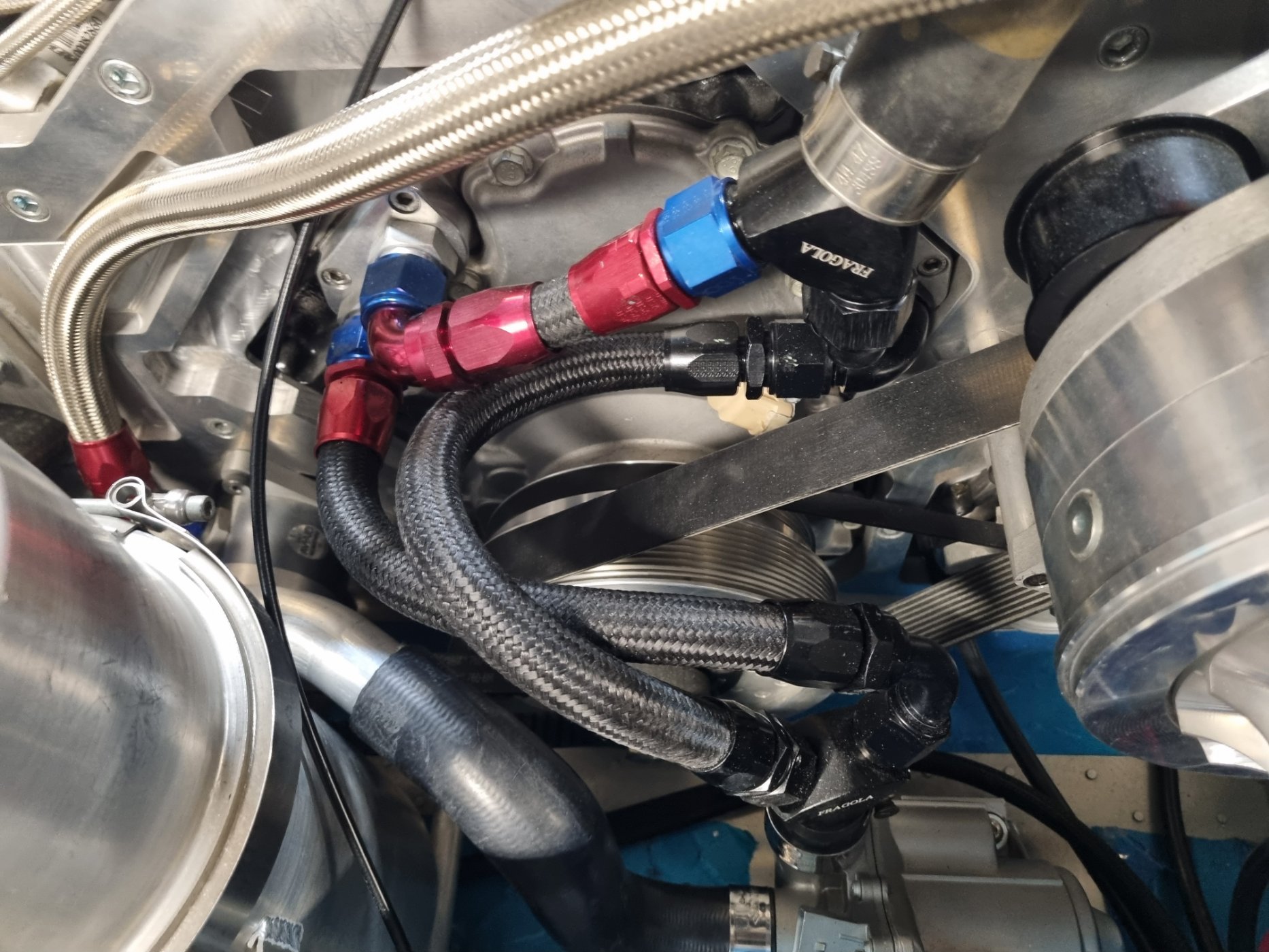

Pulled the old(new) water pump and trial fitted the Electric setup. There's a little more to it than I hoped. Just ordered another dozen bits and pieces.. now waiting on 2 US parcels. Phew no extra tax :)

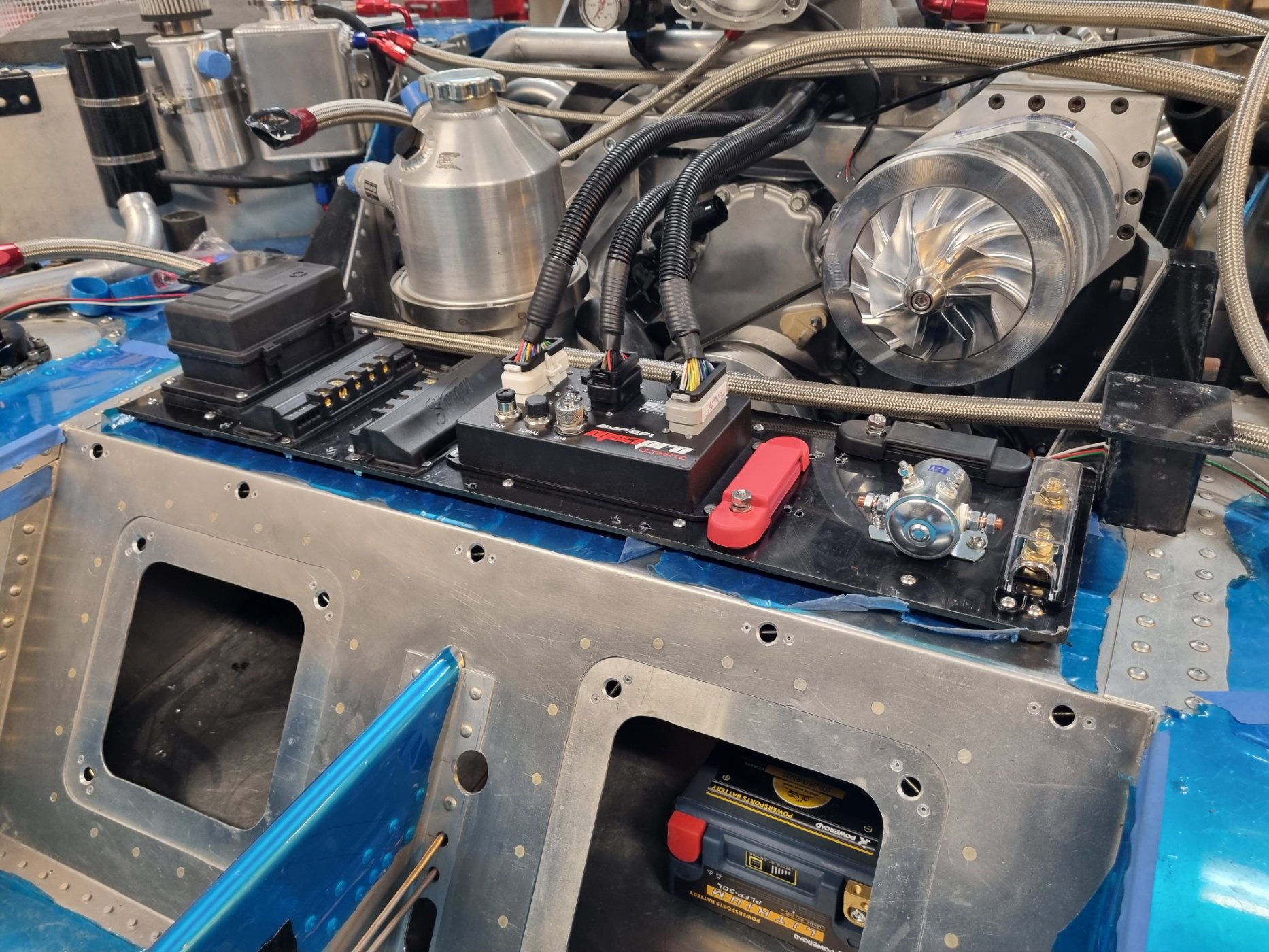

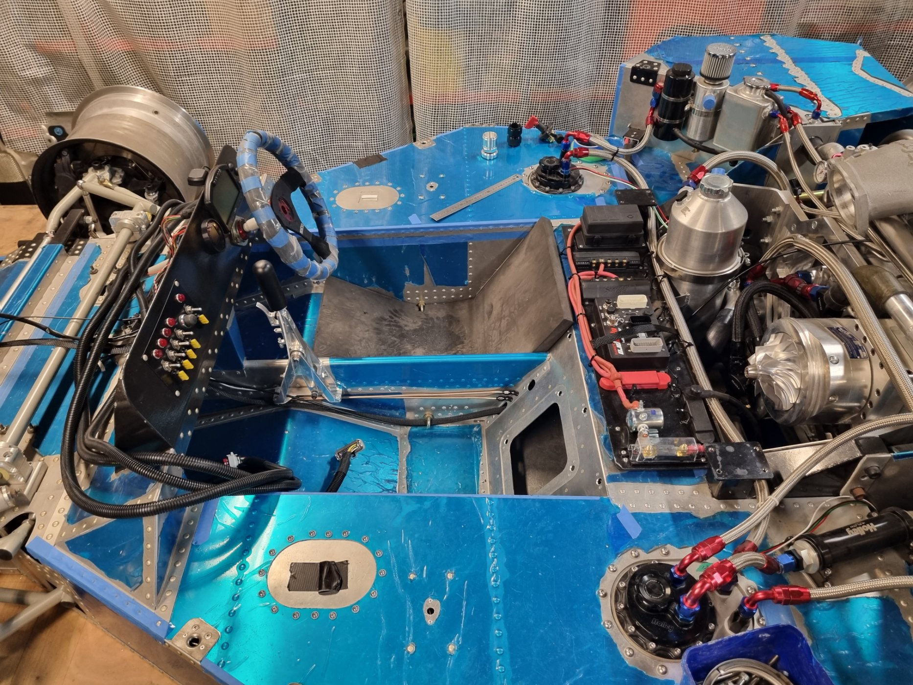

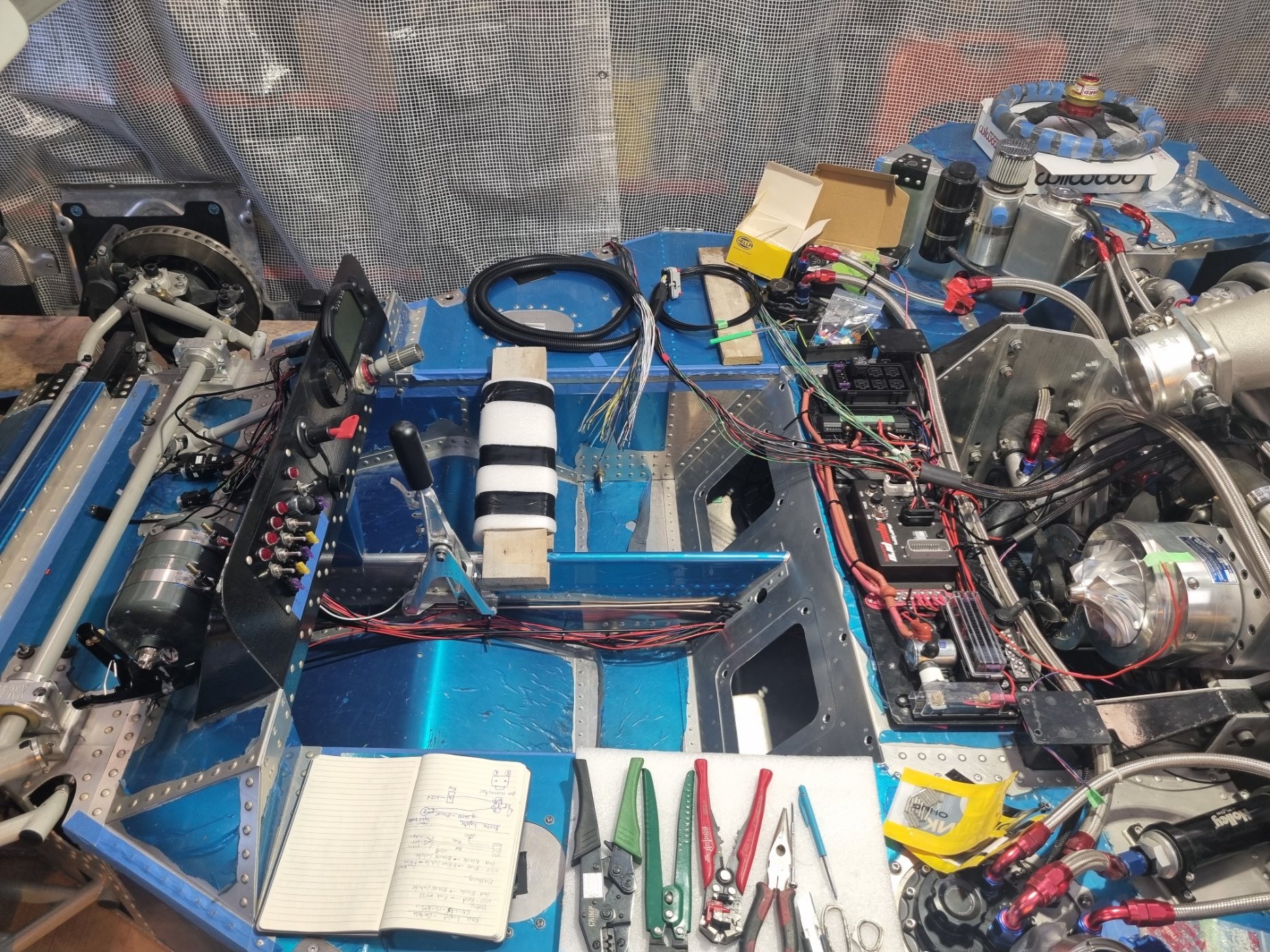

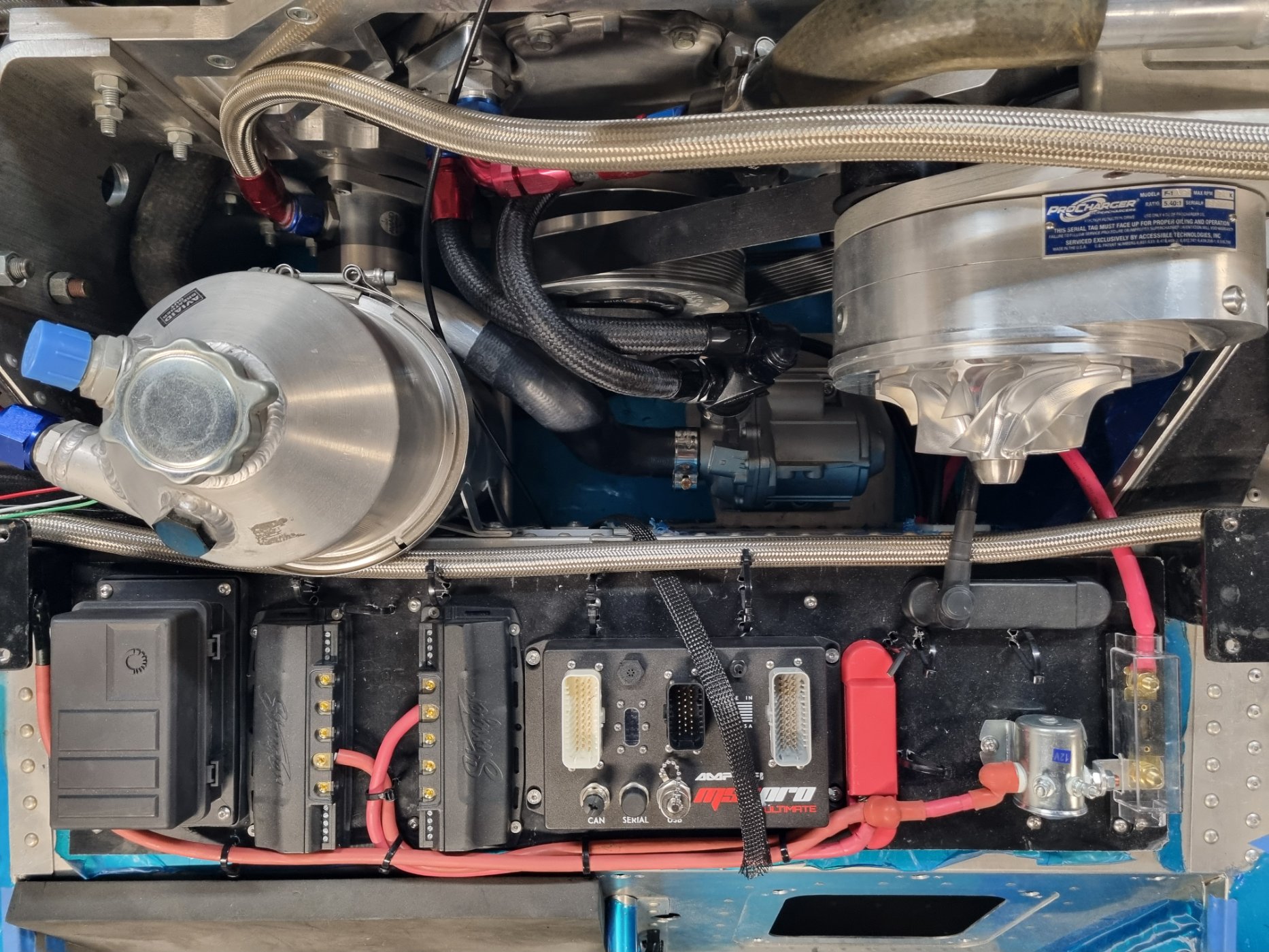

While I wait for parts I've made a start on the wiring. As a whole it looks a bit daunting but once you break it down in it's separate components it's OK.( I have been reading the 300 page MS3PRo manual for some years now.
I've just mounted most of the Electical components and will start to wire up the starter and charging circuits then onto the engine management, fuel, ignition, fans then displays and controls etc.

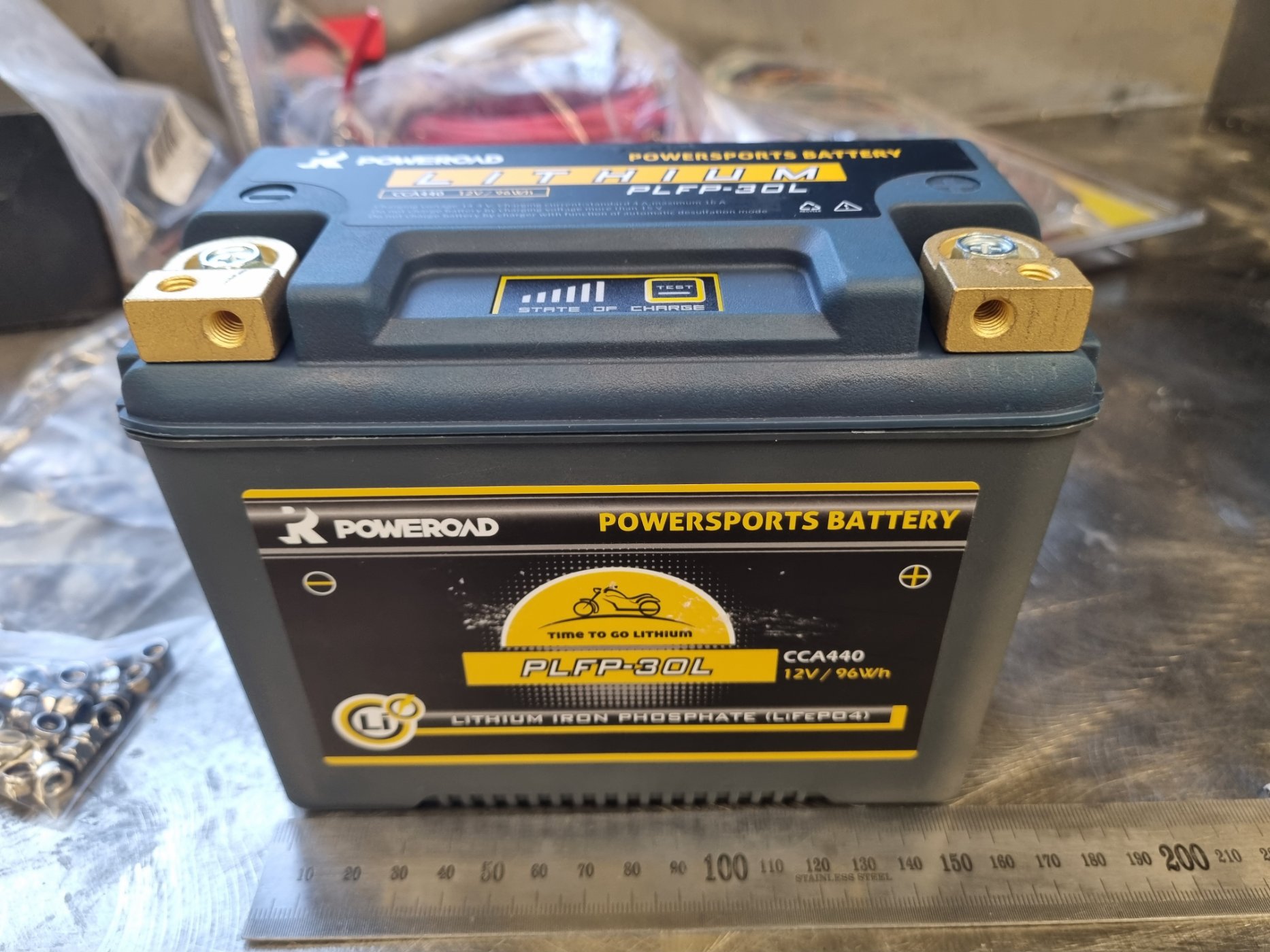

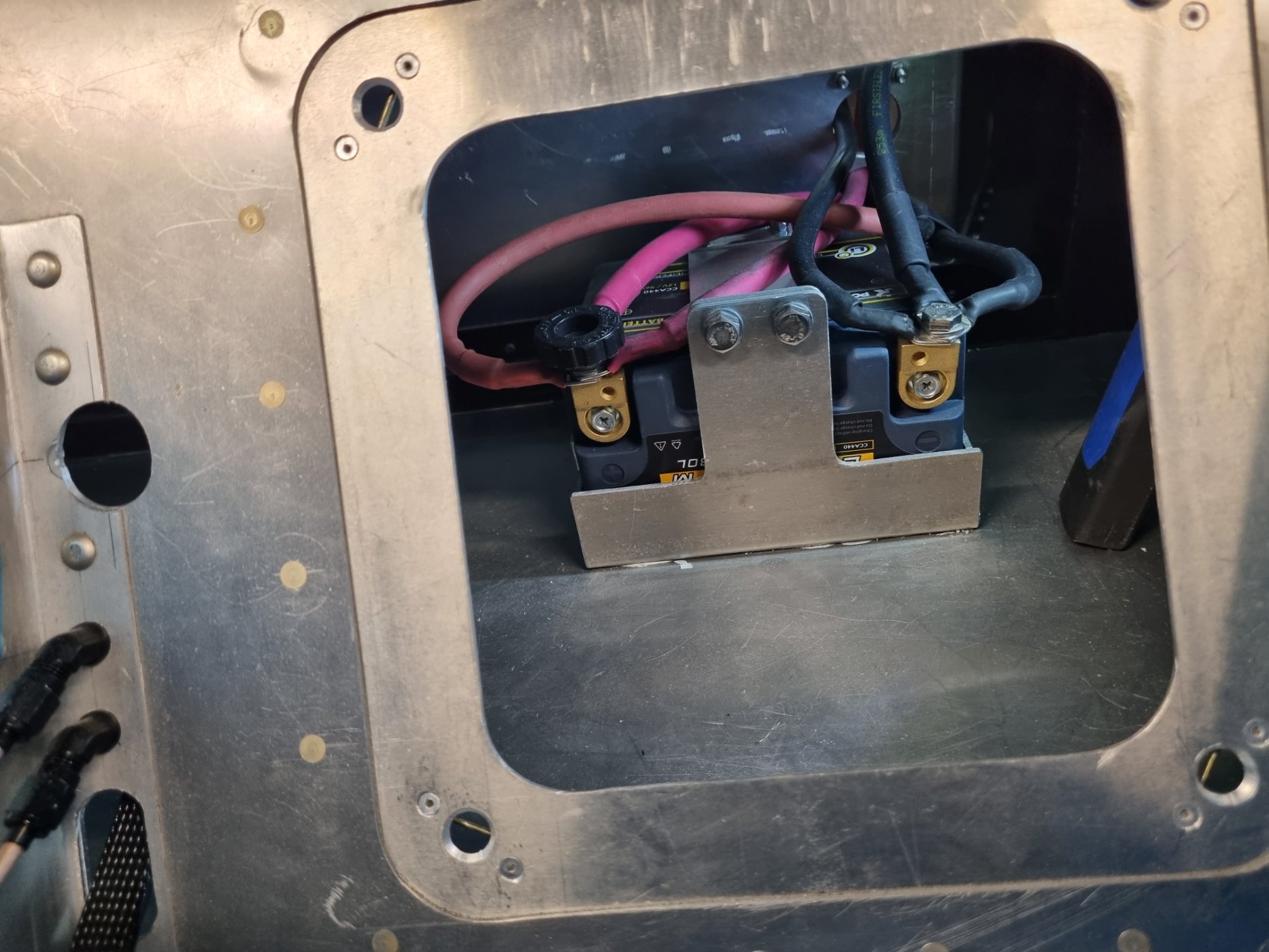

Been looking at a starter battery. Lead Acid and AGM weigh a ton, 20-25kgs. So I looked at Li-on starter batteries, there aren't that many near the South pole in NZ and cost a bomb. One came up on the radar. A powersports PLFP-30L Motorcycle battery that is rated at 440cca but tests at 730cca and Weighs 1.6kgs. 700cca meant to be ok for a 7ltr motor. These have been used already in powerboating and other track cars and seem to do the business. The Battery man said be prepared to be amazed. I am already.
So it came home with me. I'll set up a jumper system to help things out.
Andrew
Andrew
Andy,
I’ve been looking at theses LiFePO batteries as well and they sound pretty good. I was particularly looking at them due to their smaller size and weight for different mounting locations. I ended up settling on the front mounted battery location mainly for weight distribution and to keep it out of the cockpit just forward of the footwell bulkhead. I’m holding off on final purchase of the battery (traditional & AGM seem to not last like they use to) until I really need it but cost and availability will drive final purchase. With your battery choice, does it have the reserve/self jumping feature that allows it to activate a button to give a boost to the primary starting cells?
Hi Devin, no reserve button. They don't have a long cranking cycle time(obviously due to there small size) hence it will have jumper battery assistance in the pits. Also orientation is not an issue. Battery man said keep it topped up by the battery charger.
