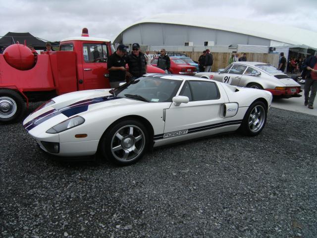

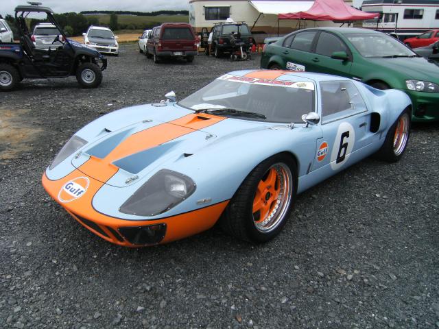

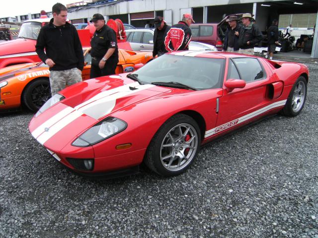

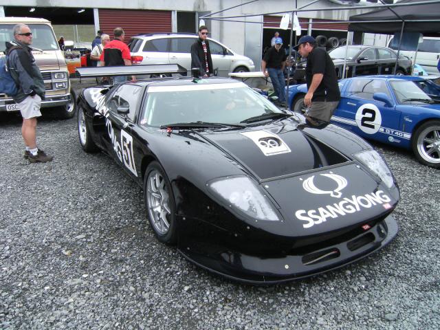

Went to the Chris Amon festival at Hampton Downs yesterday where there were more gt40`s than I have ever seen, one in particular claims to be a genuine Le Mans car, any ideas.

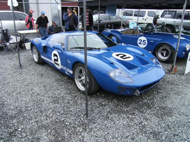

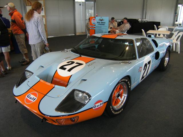

Went to the Chris Amon festival at Hampton Downs yesterday where there were more gt40`s than I have ever seen,[[[[ one in particular claims to be a genuine Le Mans car, any ideas.]]]]
I have also managed to upload on you tube a brief recording of my car at Pukekohe listed as `Mclaren m8b replica at Pukekohe` ?v=9uLXnm2HLE
Or a replica thereof, most likely an SPF with that # 2258 number and further down on the placard with ref to CSX? 1012 which is a MKII delivered to Shelby with the chassis number GT40 P/1012 & highly unlikely it would ever be in Gulf Colours... would have to have a T44 transaxle to be an 'original', the placard states ZF which is one option on current SPF's...

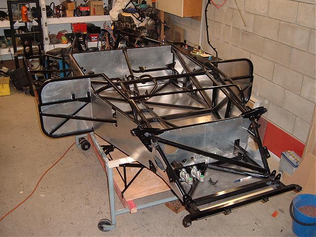

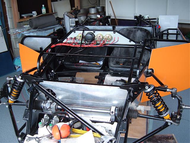

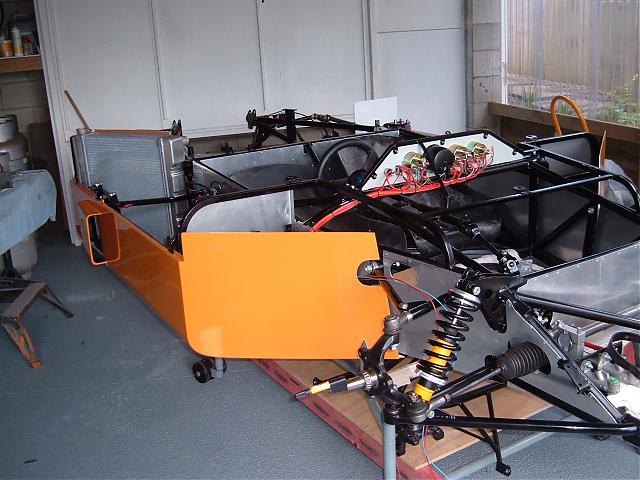

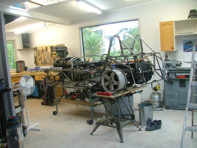

A 2 ltr 6 cyl Lotus 7 style car for `the wife`. Will post some pics to morrow along with a 1969 Dodge DART 2DR Coup running a late model Dodge Viper motor / gbox set up as an all comers fun saloon race car.My brother is a big Dodge fan.
cheers
It sure does not take long to fill the space up...

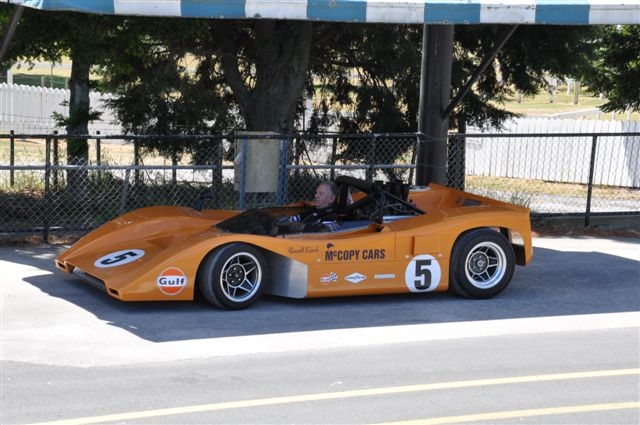

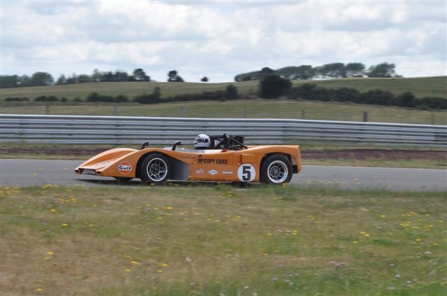

Finaly got some picture from Taupo, as you can see it was a very hot day so any shade was welcome.
Russell

Hi Russel, Are you quite tall?? you seem to sit quite high in the car and do you get buffered around in the wind much. The Allcomers car your thinking of, will you be able to run something like that in the "Classic Car Club" events or is there an actual class for that. The reason I ask is it always seems you have to have a car with some history or that is at least derived from the orginal car to run with the Historic type events, are there actually some people out there that just want to see these creations going again wheather old or just built to the old style with the same enthusiasum. It gladdens the heart to think that this may the case. Good luck withe the "7" project and keep the photos coming. Cheers Leonmac
not me...two cars went off before me, that run off area is very short so an extra careful other wise you end up joining the other circuit. I would not like to run out off brakes there at all.
