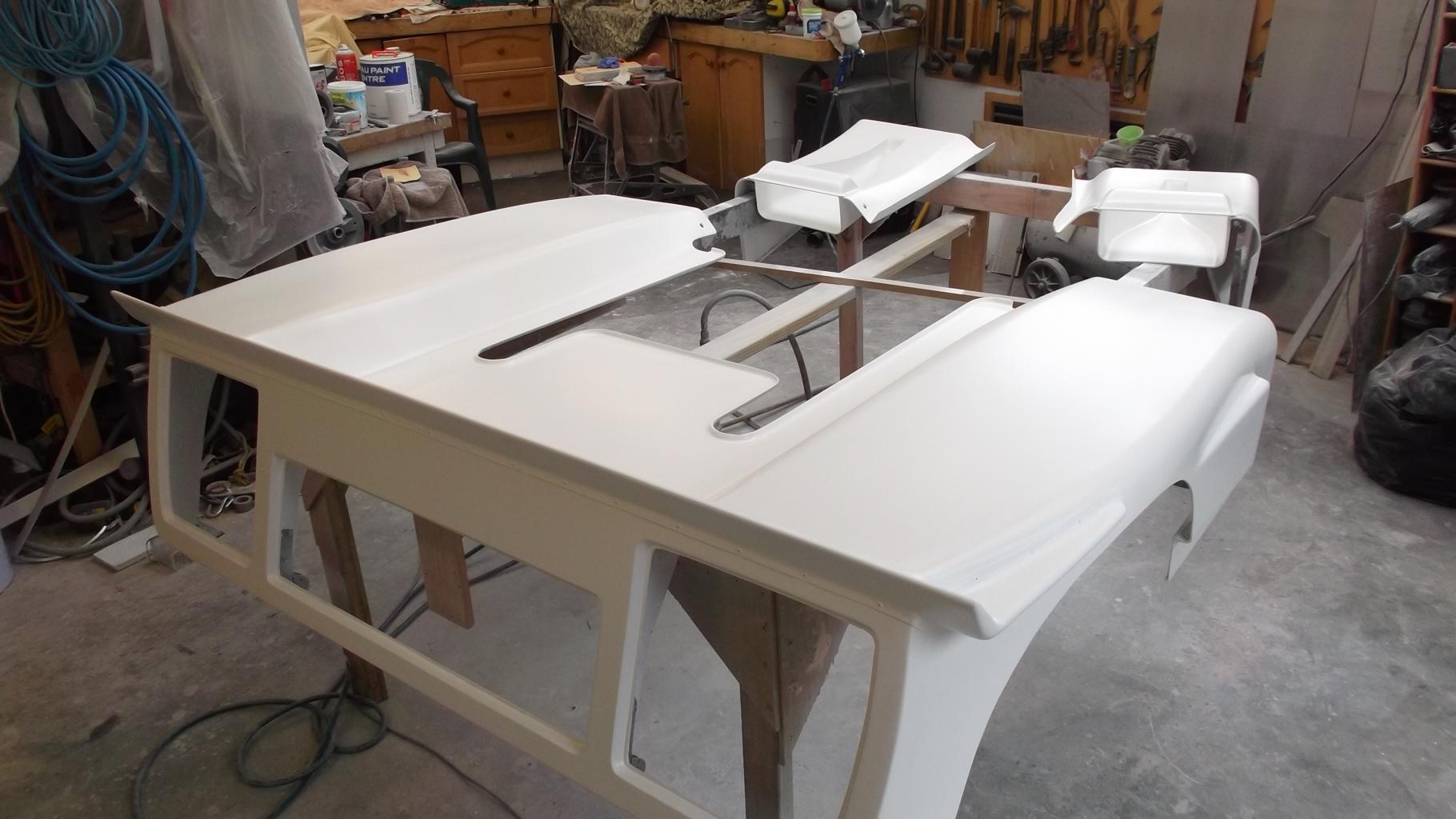

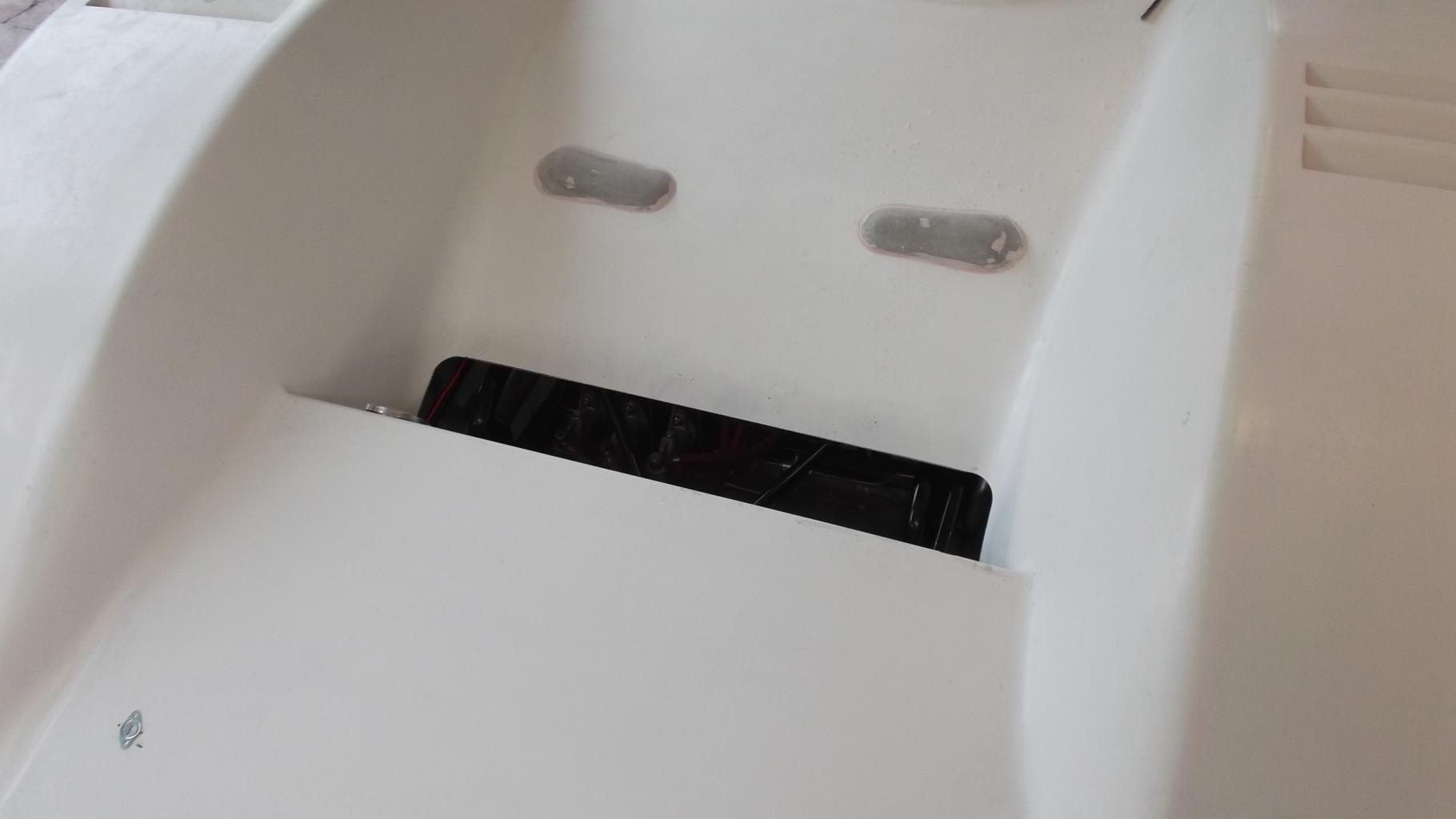

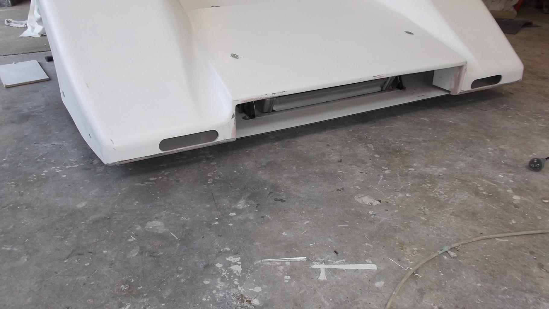

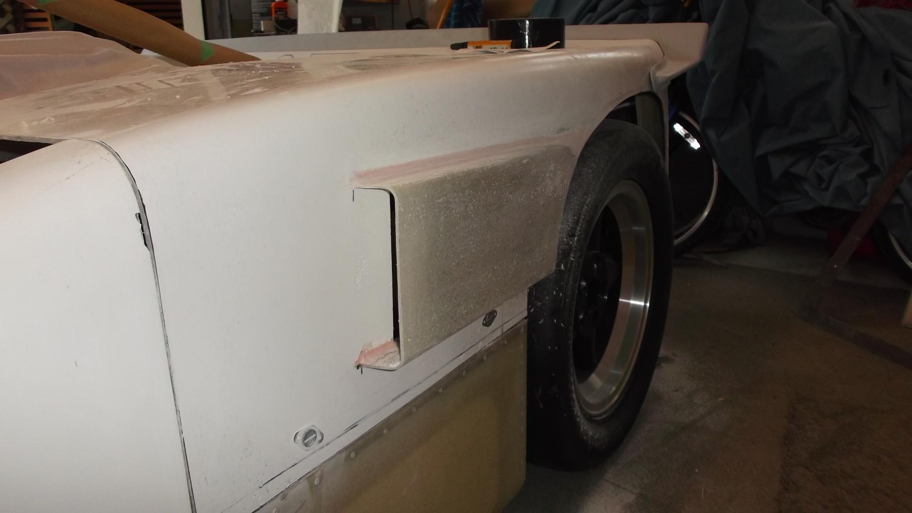

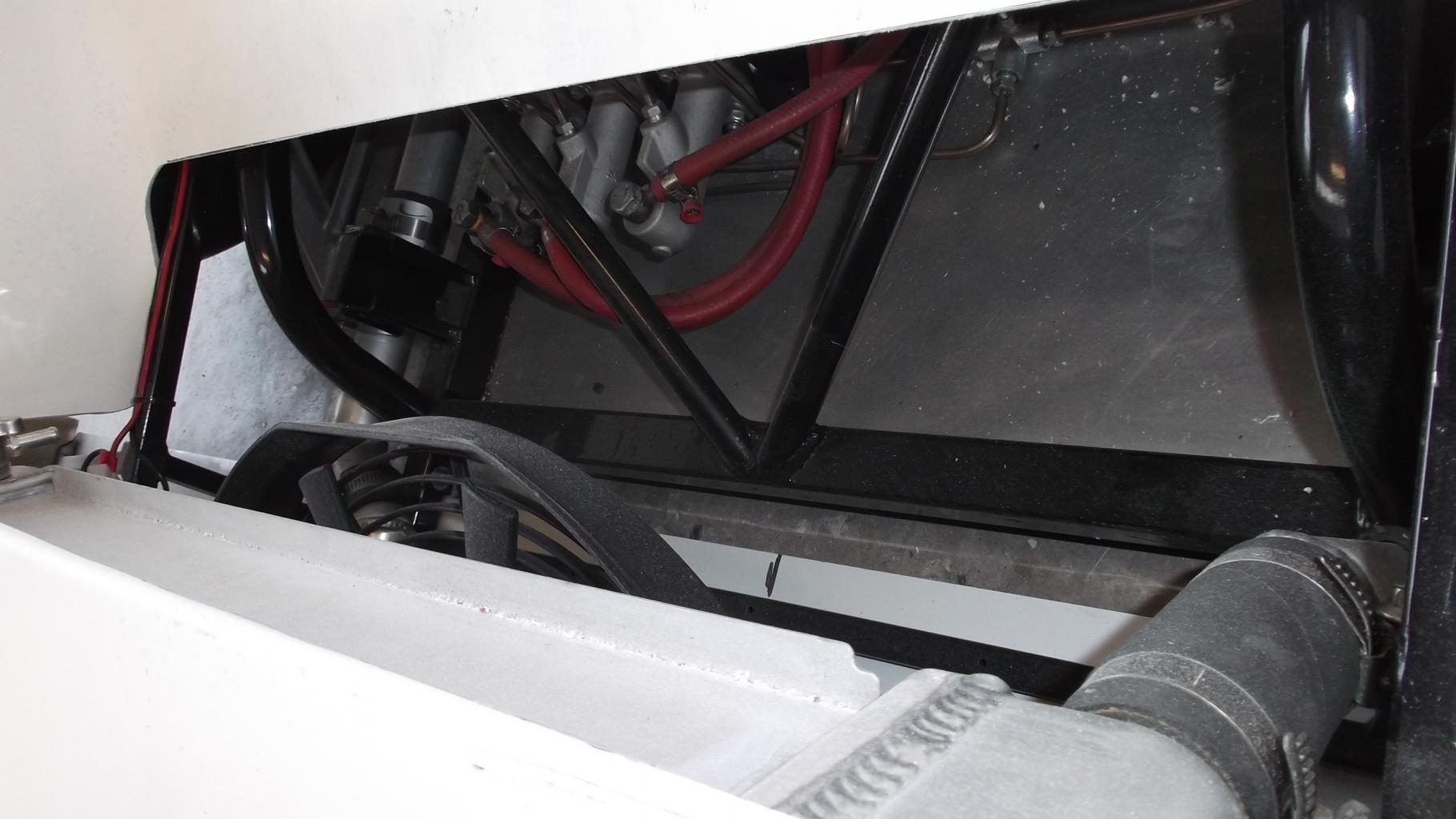

Been grinding away so some progress to report. Finally starting to take some shape now that doors are filling the gap. Considering how difficult it was to get measurements of the radiator outlet from the chassis to the mould, I am quite pleased at how the fit has worked out, even needed a couple of bubbles to accommodate the inboard shock tops. The off side door will be locked in place with Duzal fasteners because its only needed for fuel tank access and the drivers door will be fully functional. Used the be able to step over the sills into the old car but can not with this one. I have rounded off the nose either side of the radiator and also fitted the side air scoops in the rear clip which is fully tilt able now for engine access. These changes were not put into the mould due to the difficulty with extraction. Once all the body is fully set up, I will start the final sand ready to undercoat and paint. But first a really big clean up.

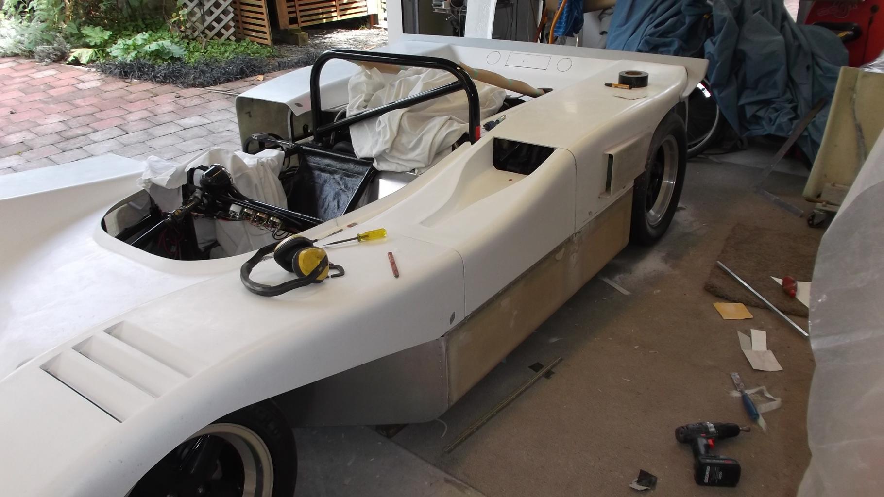

Hi there
All white now!
2 full undercoats and block sand followed by the third final undercoat and rubbed down with 400gt ready for the top coat which is on order.
Now for the major cleanout and reset up my temporary spray both for the final colour...lookin good.

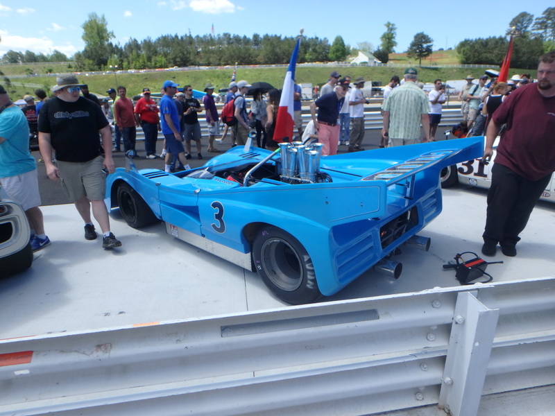

I spent this past weekend at Road Atlanta at the annual vintage car race, watching some original Can Am cars go around the track, and basking in the glorious noise. A McLaren M8F, A McLaren M6A, a Lola T163, several T70s; two Shadow DN4s, and others.
I was there in my my refrigerator-white pickup with McLaren Automotive insignia, my son and I in orange M8B T-shirts, with my 1/2-scale M8B go-kart on a rack in the rear of the truck - got lots of smiles and thumbs-up.

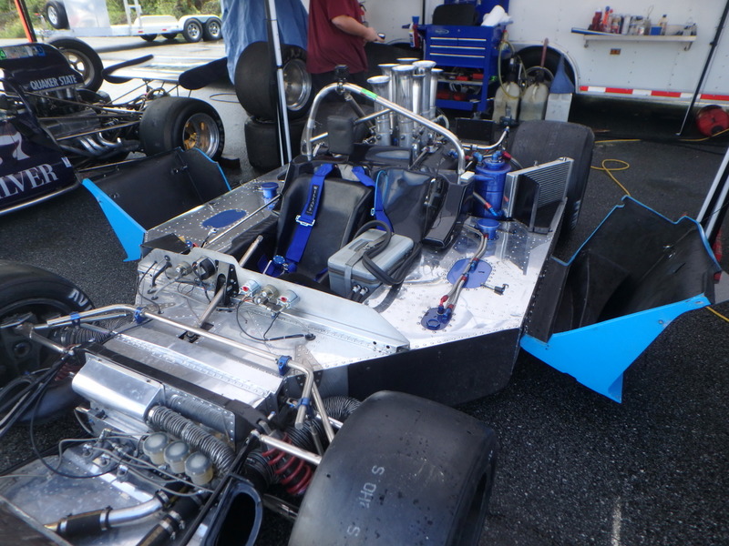

More pix -
Also - here was a 'zine article when I took the Kart in 2014. I bought it from the builder, Putsch Racing, and it's never been on the road - it hangs in my shop as a piece of inspirational art.

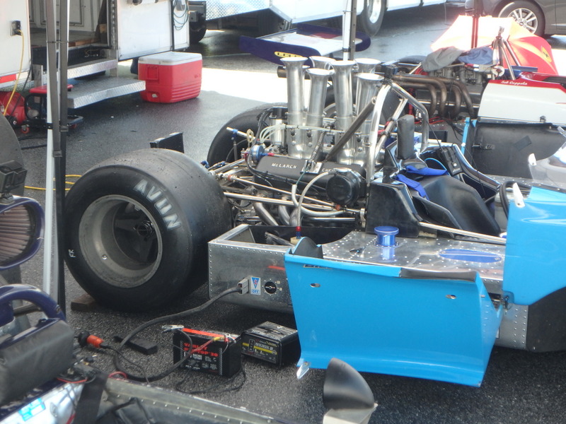

I did get to take some pix in the pits with its big brother!
<edit> I did get Brian Redman to sign the kart - he was Grand Marshall that year.
McLaren M8F meets M8B Go-Kart! Seeks Posh New Home; McLaren Owner Strongly Preferred

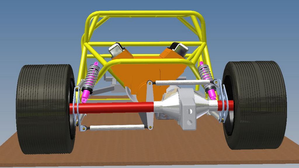

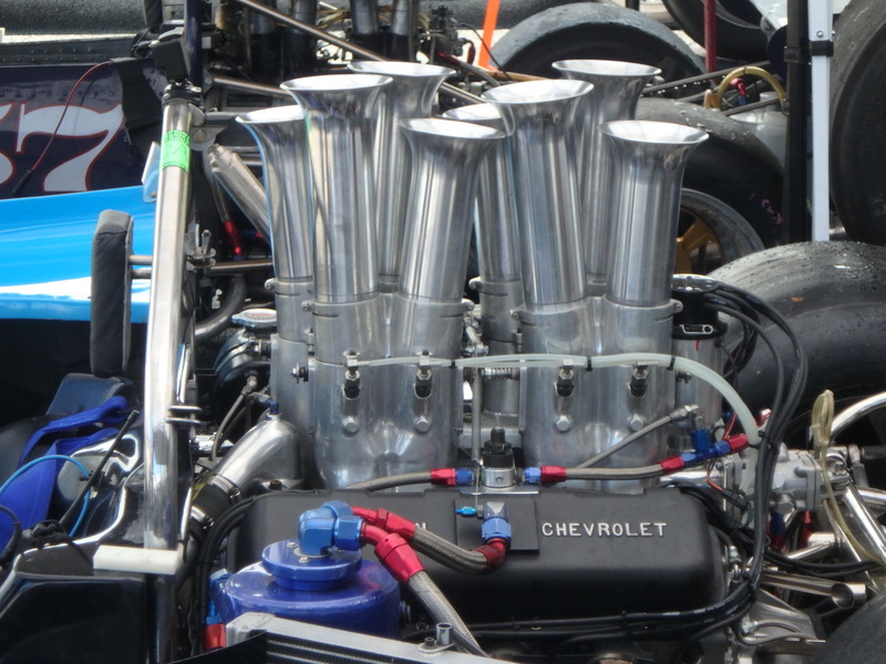

Also - I think I've finally firmed-up my approach for my M8B "tribute" street car project, especially after measuring and sitting in real M8s, and considering modern tire and brake sizes. Starting the CAD modelling now, so let's say a few years!
110-112% scale M8B, suspension-mounted high wing, the slightly rolled-under sides of an M8C, and the slight Coke-bottling of the body in plan view like a Lola T-173. Big-block Chevy of course, with an EFI-converted calliope-style mechanical injector setup.
The drivetrain will be of my own design; I'm prototyping it on my current Kelmark, to replace the SBC and Corvair transaxle.

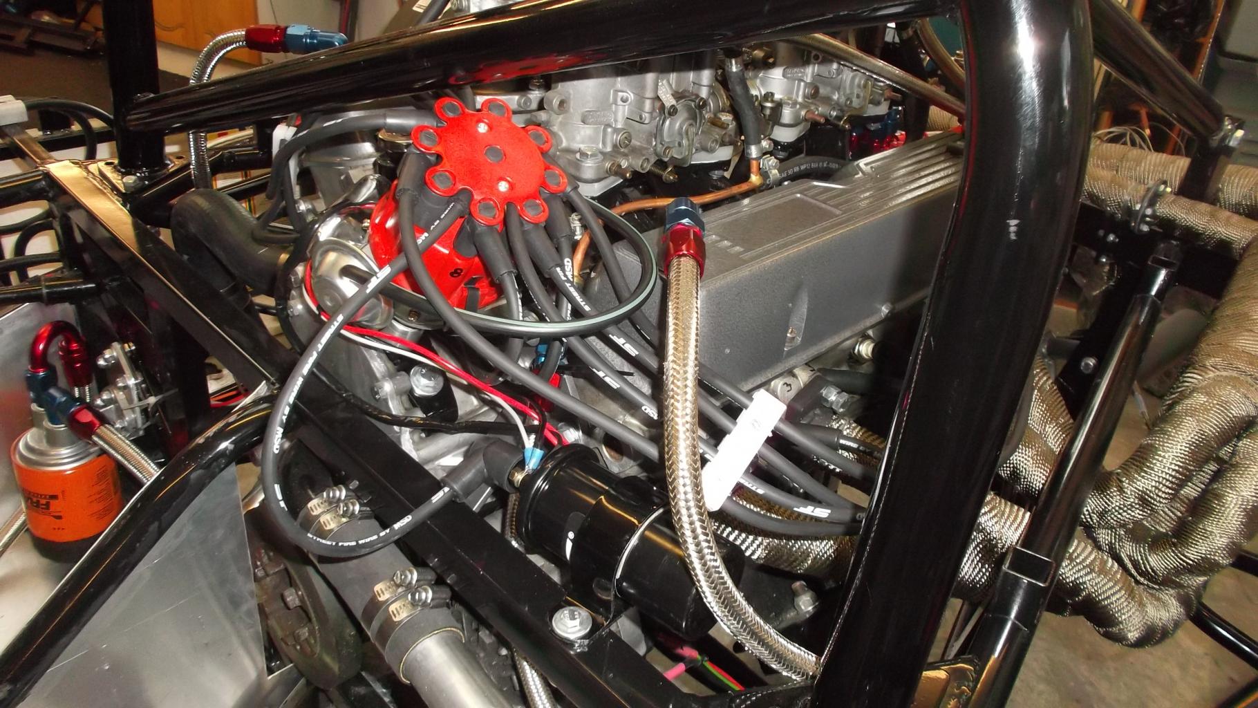

That's a cool little car, what motor is it running...all dressed up to look like a Chev.

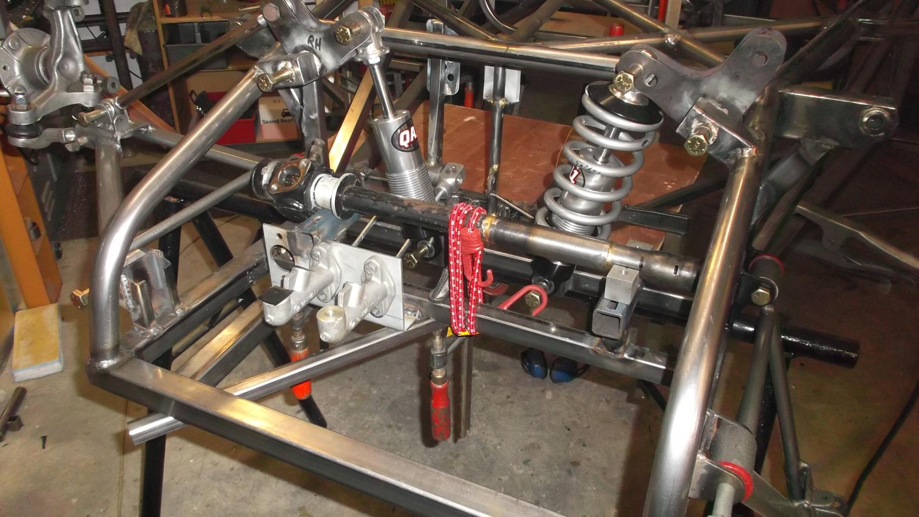

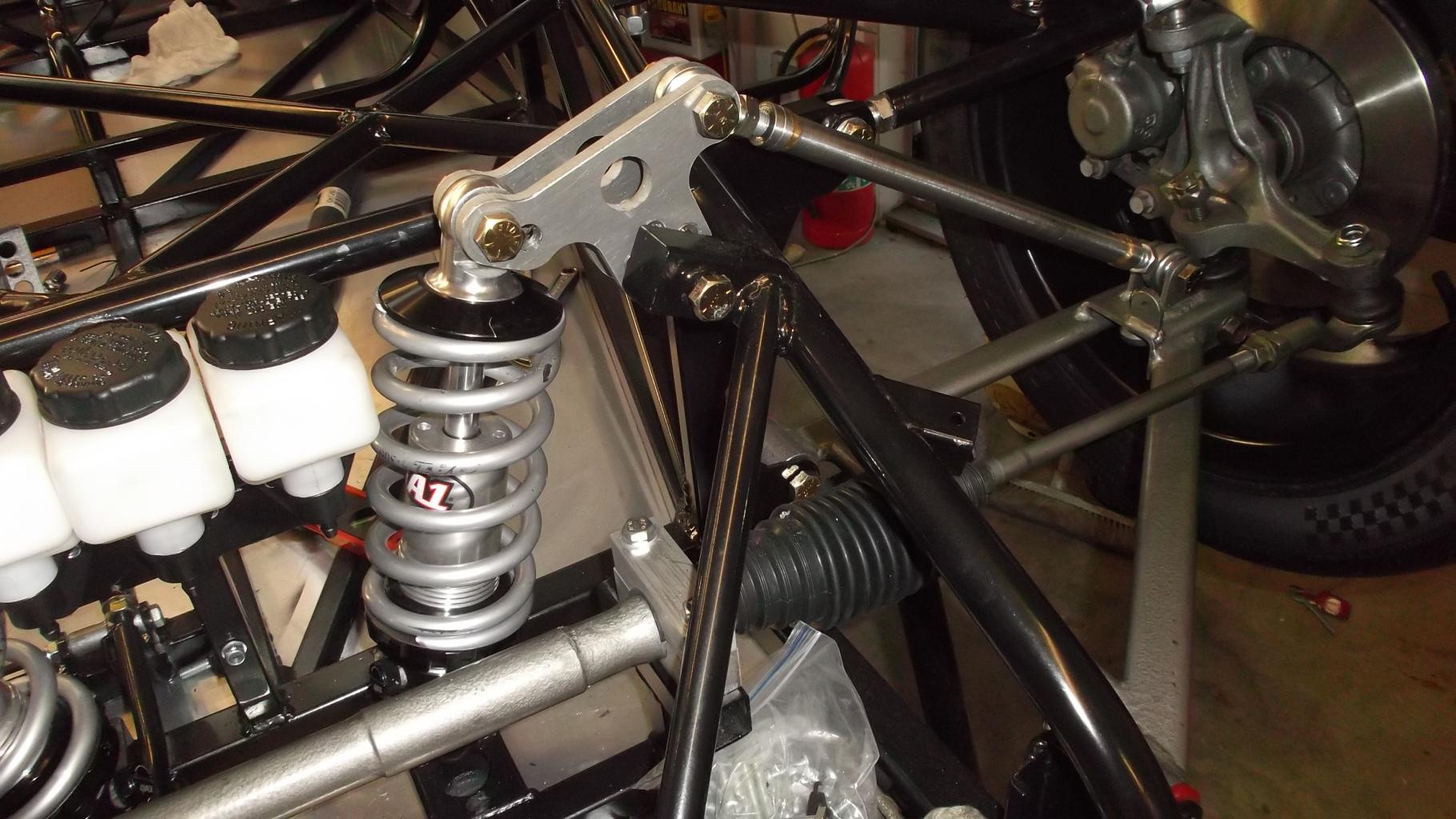

Interested to see that you were thinking of going over scale in size because the standard dimensions of approx. 4mtrs long and 1800mm wide seem more than adequate. Its actually a decent size when you see it in the flesh. I have played around with spacing on this car so could give you some measurements to think about if that helps. Do you have a measurement from rear axel centre to front of engine pulley. I have also put inboard shocks up front which also allows a bit more length in the `cabin`. I would not rule out doing another body some time in the future, but at present after almost 5 months of dust and crap...I am over the mess.

The kart has a "Chonda" engine - a Chinese copy of a single-cylinder OHV Honda. The chassis and engine are apparently standard for a spec class; I don't know which one.

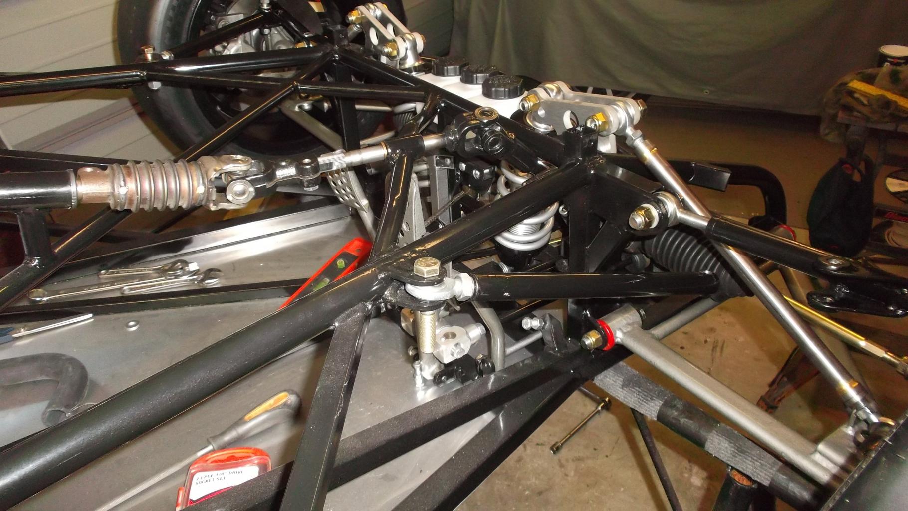

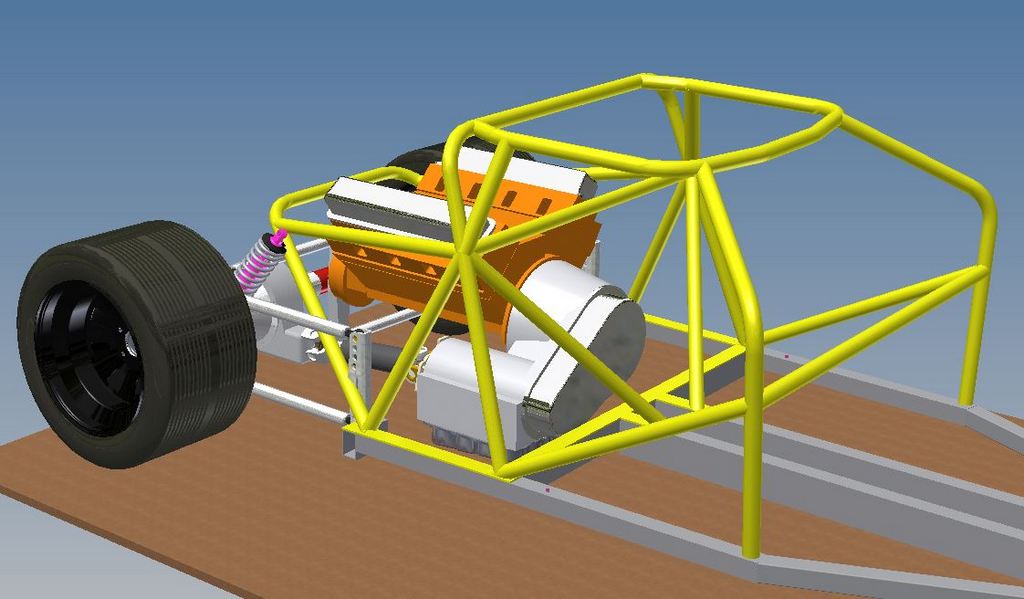

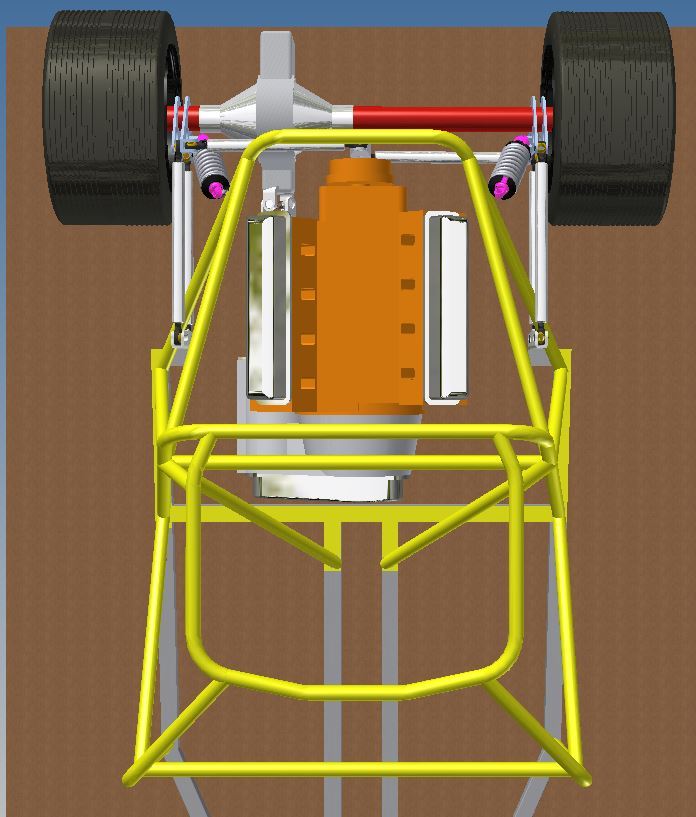

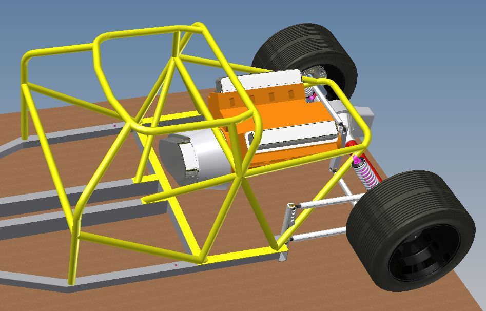

Proportions - yes, outside it seems fine - I've been able to be around them at vintage events (at least M8Fs) several times over the last, gosh, thirty years? It's more the "waistline" I'd like to raise, to feel more protected and "in" the car, but without scaling everything up, it looks wrong (at least in the CAD world). Also - my kit car now has a 94.5" wheelbase, and it is "twitchy" - fine for a race car, not so much for day-to-day - so I'm stretching the WB 10" (or 2.473680 in hectoliters, or whatever)

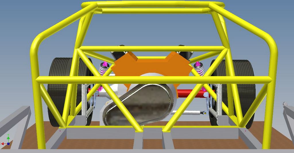

Below is my eventual drivetrain that I'm currently prototyping in my kit-car Kelmark, if I can digress a bit in your thread - It gets me some things I wanted - easy parts availability, a '70s vibe, absolutely bullet-proof even if drag-racing, the ability to change axle ratios easily, and an automatic transmission for traffic (I have three manual cars now, and that's fine). Also, the straight-line stability under acceleration (without huge development work) of a solid axle with a 4-link and a Watt's linkage. And, the entire drivetrain in front of the axle - the big-engine variants of this kit car had a complete Olds Toronado drivetrain and engine perched right over the axle - frighteningly tail-heavy and crude.

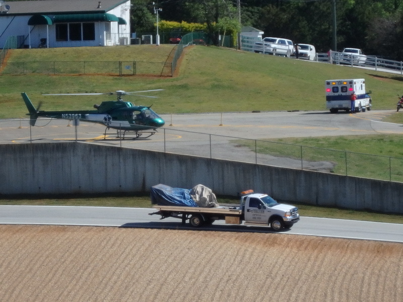

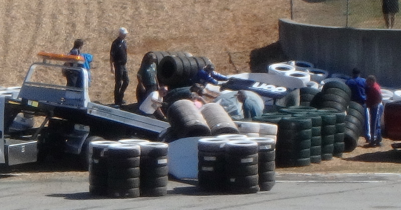

Another reason I've had to really think seriously about driver protection this past week.
I saw Craig Bennett's crash Saturday morning in the #101 Shadow DN4 at Road Atlanta, and it was just horrific. He tunneled under one tire barrier and hit another coming down the hill towards Turn 12.
With nothing around his body but folded and riveted aluminum, he broke both arms and both legs and his back. He will be a long time recovering.
Forrest - shook

Terry Oxandale
Skinny Man
Yeah. A roll bar only is no real protection when it comes to street driven cars like these. I can't imagine there would be any other outcome outside of being buried under whatever it is that you hit/hit you. And with a harness, you're not going to duck under whatever it is.
Without being flippant...if its going to bite...it will, no stopping it.

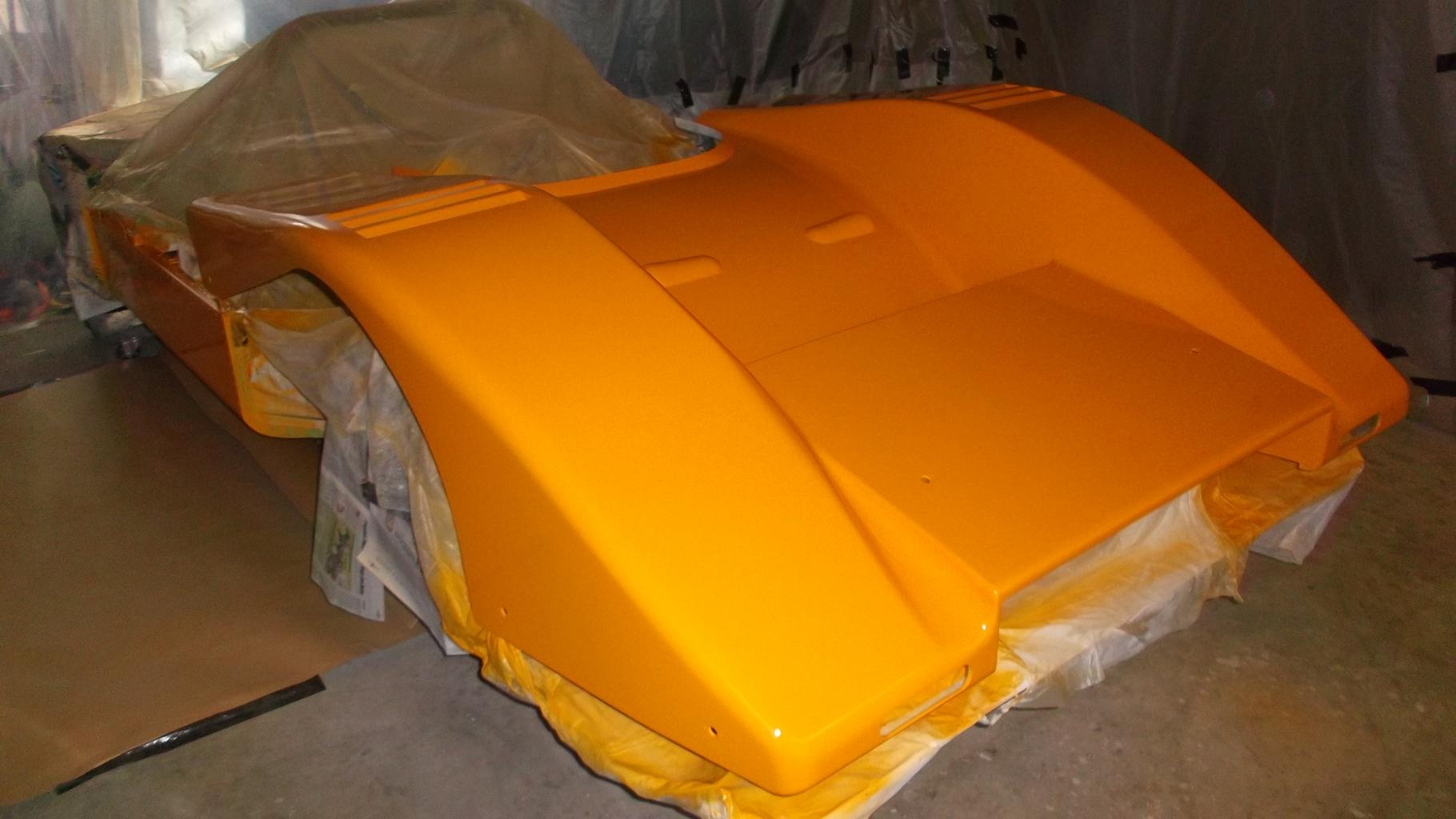

Finally after all these months of sanding we have colour, I am sure its a little more yellow than the first car how ever its the same brand and standard colour as before so what it is. is what its staying. Got a couple of runs in the hard to get areas so will survey the scene tomorrow once its all hard, no real biggies and still got enough paint to recoat again in total if needed.
Fortunately I still have a full spare set of decals so the big decision is do I put McLaren Cars or McCopy Cars on the side.
