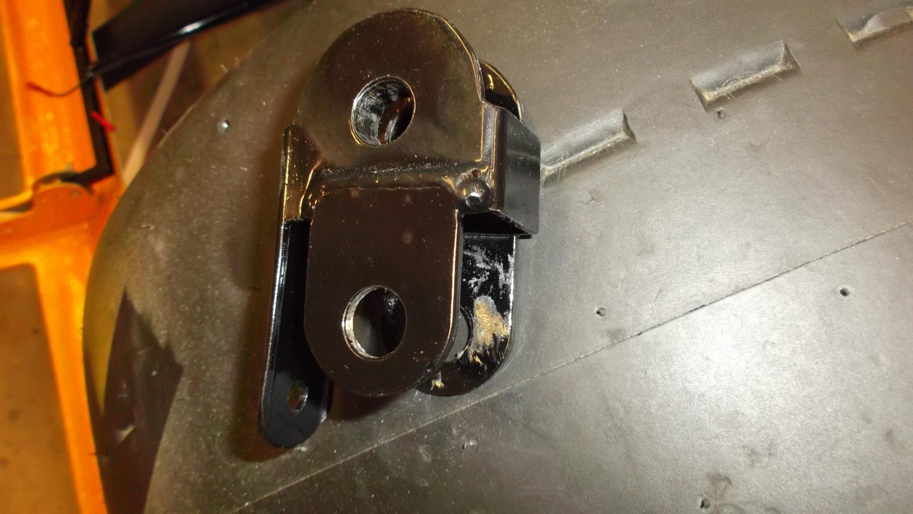

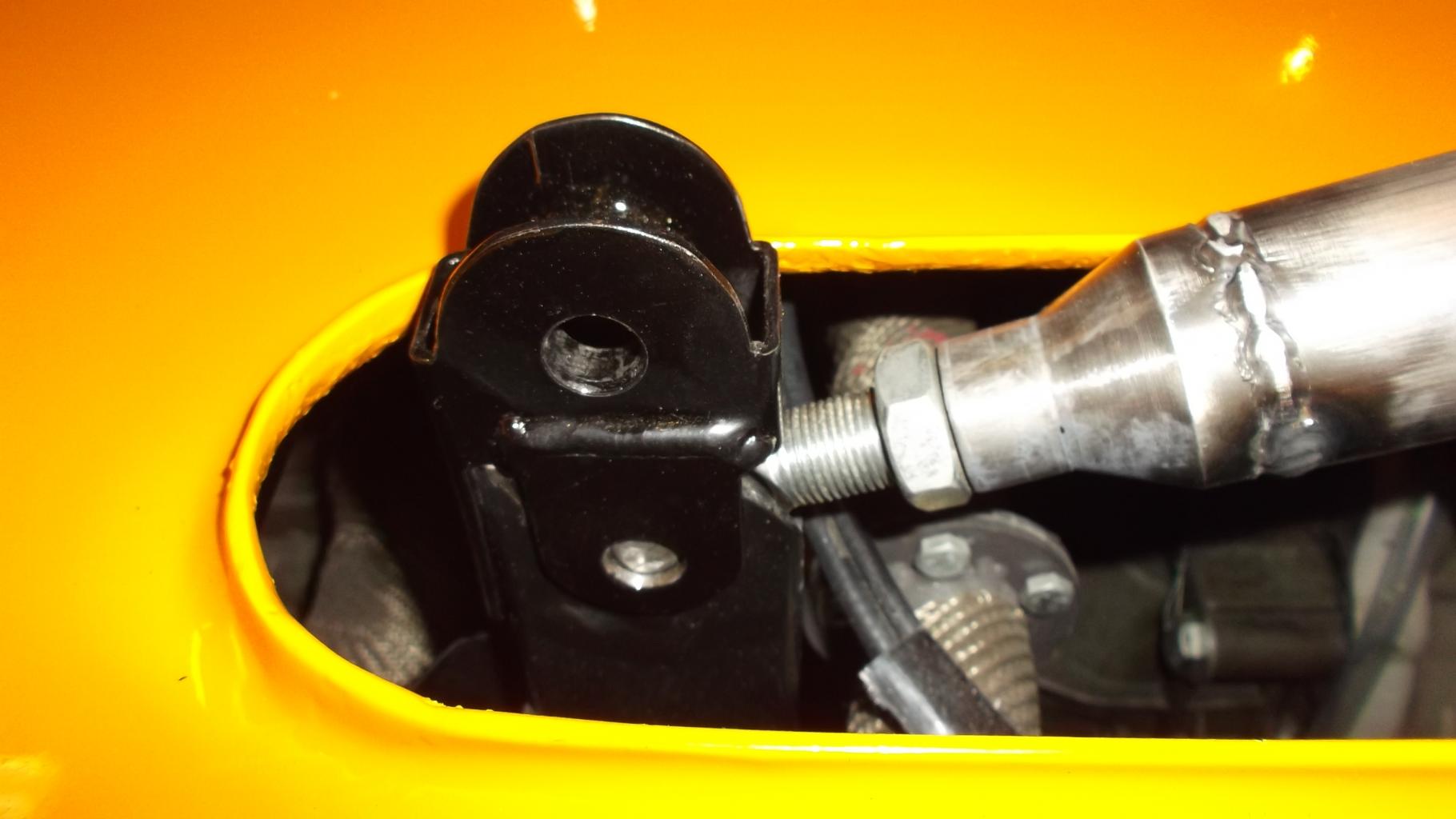

Shot of the mounting points for the wing? Please?
The wing mounts directly onto the top of the chassis where the Roll bar mounts, if I had been smart, I would have made the original mount part higher to accommodate the attachment. What I have done is make two small adaptors that bolt onto the same area to raise the mount up just above the body work so that release pins can allow the quick removal of the wing. I had only ever planned on the wing being for show how ever I do plan on doing a demo run with it attached early next year. Should look impressive.

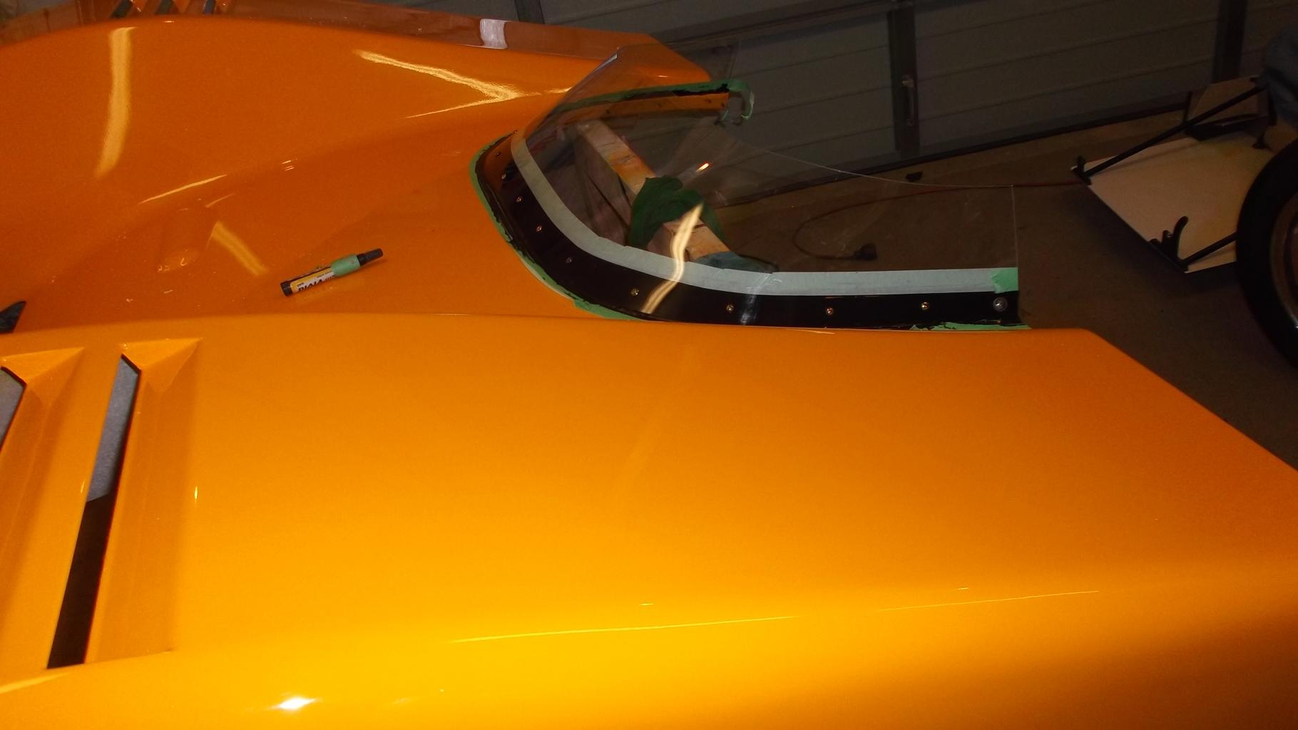

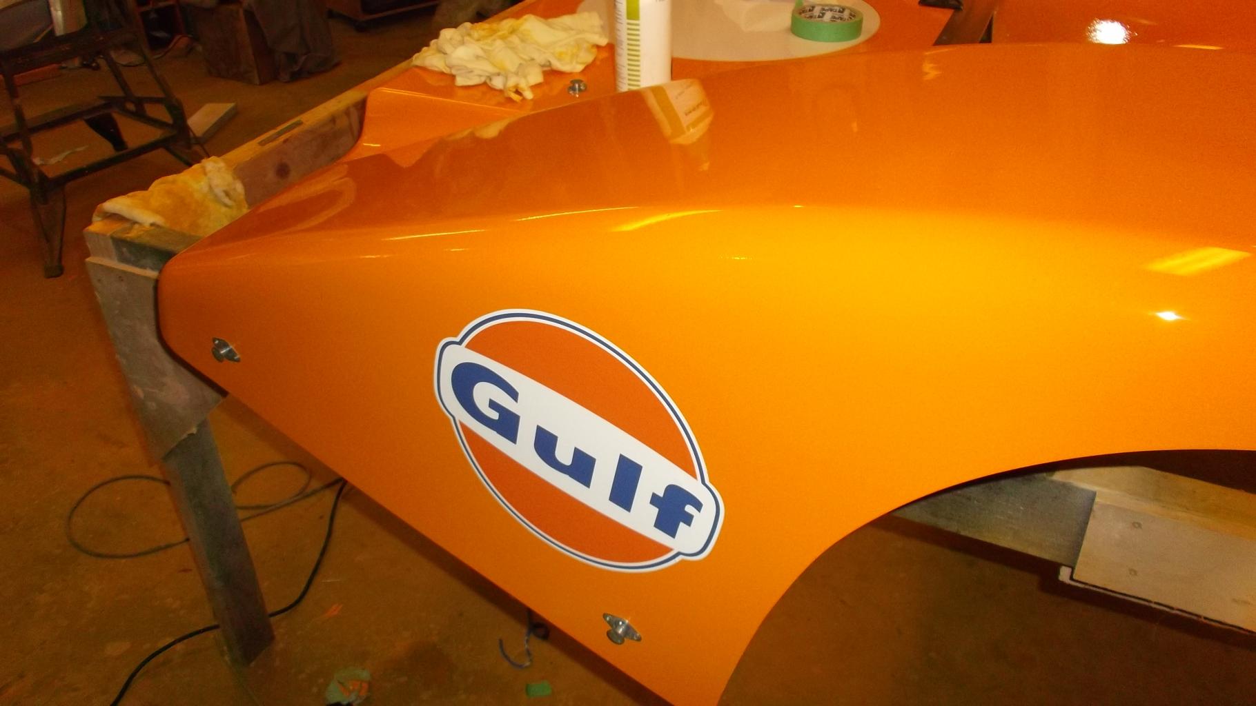

Getting closer, been a little busy the last few weeks so not much action. Have finally sorted out the paintwork and been able to cut and polish some areas that I was not happy with. So today, started putting on the decals and fitted the screen, waiting for the gunk to set then remove the masking tape.

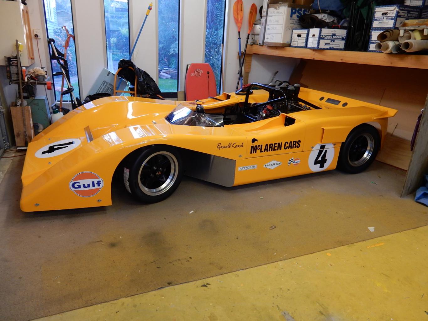

At last, the big reveal....Just completed the full decal set and am very pleased at the outcome. Had a few issues with paint (gravity) but have now got the cut and polish game down to a tee, so will address a couple of areas where there has been a bit of dust, nothing that paying a pro painter many thousands of dollars would not have cured. Have just got to fit the side screens to the doors and we are all but done.

You've DONE IT Russell!!!!
A brilliant work of automotive art you have there....
Congratulations!
