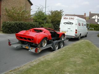

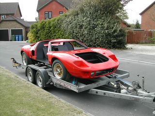

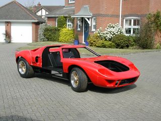

Today I took delivery of my MDA. This is MDA's latest MK2 chassis (That is Mk2 as in 2nd generation of chassis not a distinction between GT40 Mk1 and Mk2)
I opted for the Mk1 body with Gulf flares in red gelcoat.
The chassis is fully panelled and black powder coated.

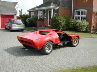

Very nice, good to see a build thread go up here! I know you're extremely happy with your car, update us with progress. What is the color scheme planned?
R

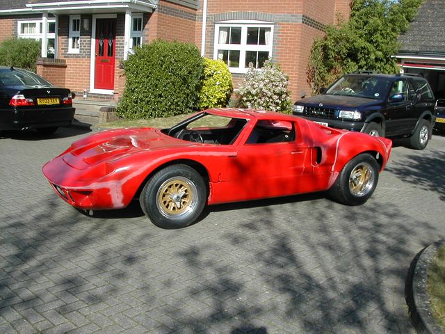

I am looking at the Scuderia Filipinetti colours, Red with White stripes and gold wheels. I still might change my mind but that's the way I'm heading right now. I nearly went for a yellow car with black wheels as I like that combo too. I just didn't have the balls.
Yes, I am extremely happy right now. It's only been 4 months from placing my order to receiving the car, which in my book is pretty good going. I am pleased with the quality of work that MDA have done preparing the chassis.The body is a little rough in the areas that are bonded together, the actual mould looks good though (No ripples). I don't mind that too much. If it looked too pretty i'd be scared to touch it !
My first job is going to be initial sanding and preping of the body as I need something to do that doesn't take too much of my cash. Once I've recovered from the initial outlay, I'll start building it mechanically.
At least that's the plan.:D
Keep you posted.

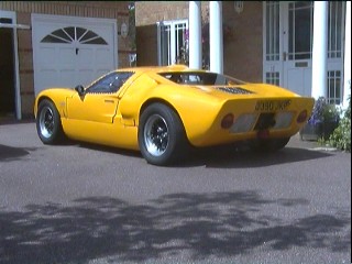

Yellow with black wheels. Sounds like my old car!
The new one might have to be a bit brighter.

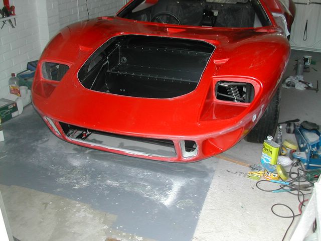

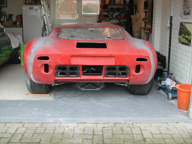

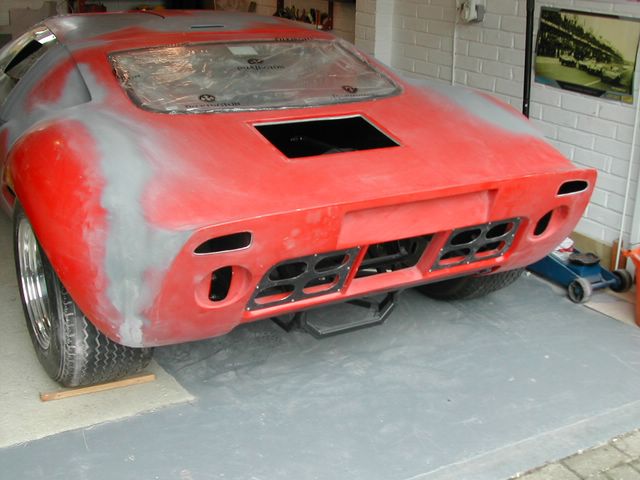

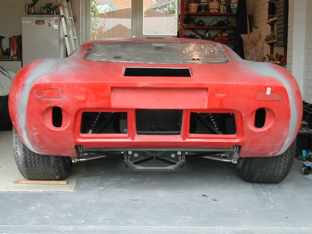

Started Sanding and filling. Placed all the panels loosely on the body to check initial alignment. Doors had to be trimmed on the back edge about 1/4" to fit. Still enough material left in case I need it when I finally gap the body. Think this process will take a few months !

The wheels are reproduction Halibrands from 'Image' wheels. I especially liked the champagne style with sunken sections.They are 3 piece wheels but with the bolt pattern hidden on the inside of the wheel. Looks as original as I could find and MDA recommended them.
They are 15" diameter, 8.5" fronts and 12" rears, offset to fill the arches. I asked MDA to do this prior to delivery so I can't take any credit there.
Tyres are Avons 215/60VR fronts and 295/50VR Rears.rockonsmile

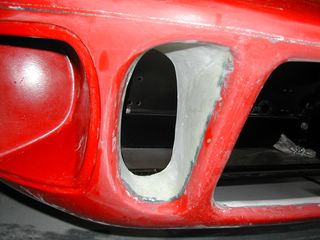

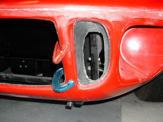

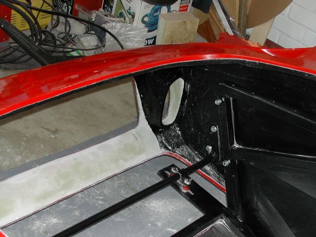

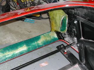

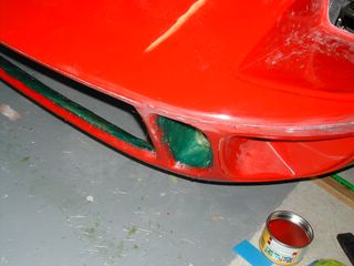

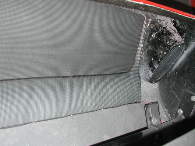

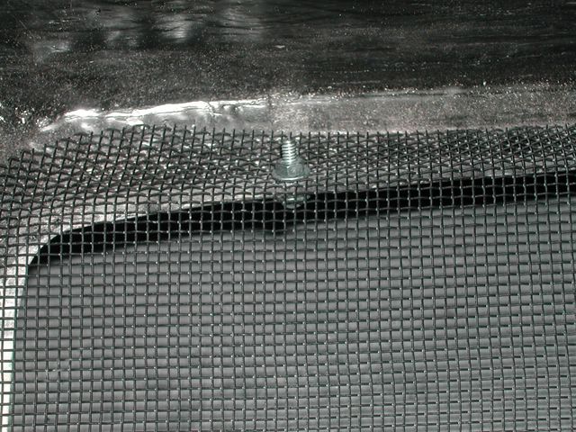

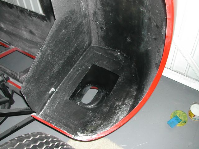

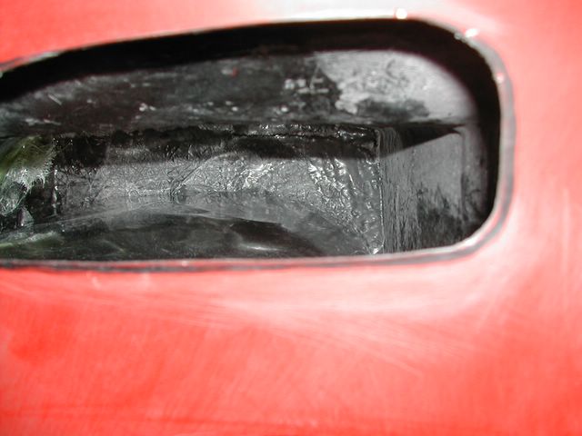

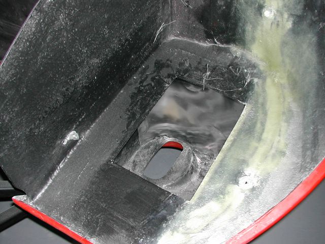

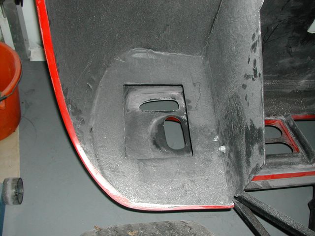

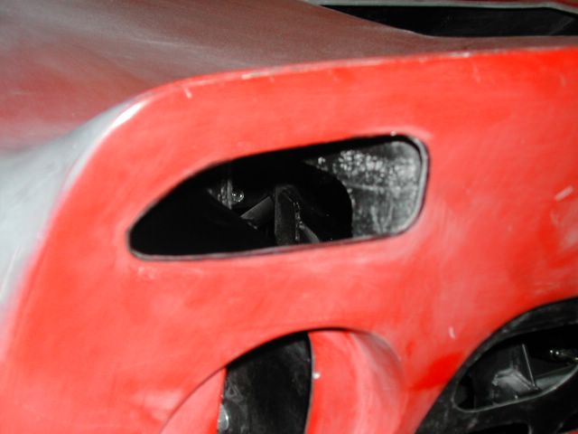

After studying some archive photos I decided to add some detail to the front intake. It seems that on some cars, the front brake ducts finish further inside the car. With the books I had to hand it seemed to me that most of the cars that seemed to show this were the later gulf cars, which suits me fine.
I also extended the bottom of the main intake back inside the car. I'd seen an original a couple of weeks ago at Brands Hatch with this feature and it made me think. It seems to provide more regidity to that section as well as more surface for a painted finish. I like to see the stripes dissapear into the car in this area.
Comments welcome

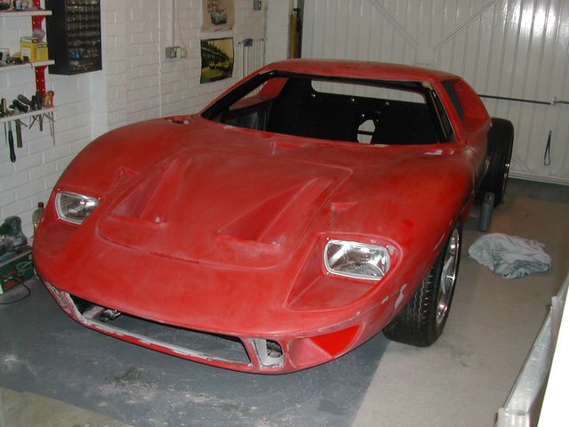

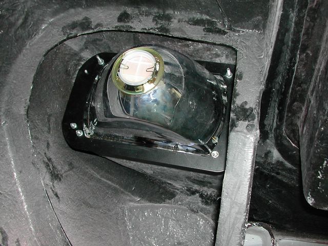

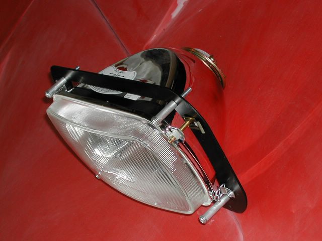

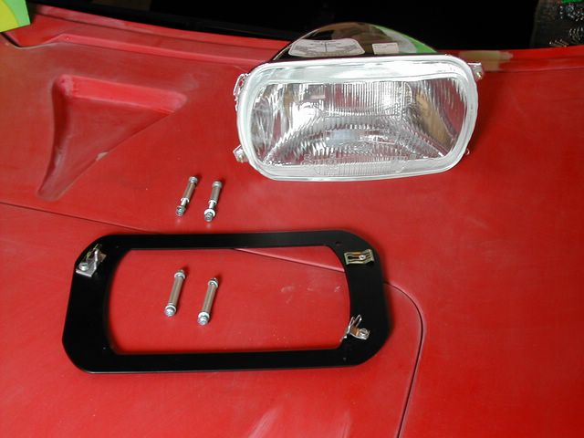

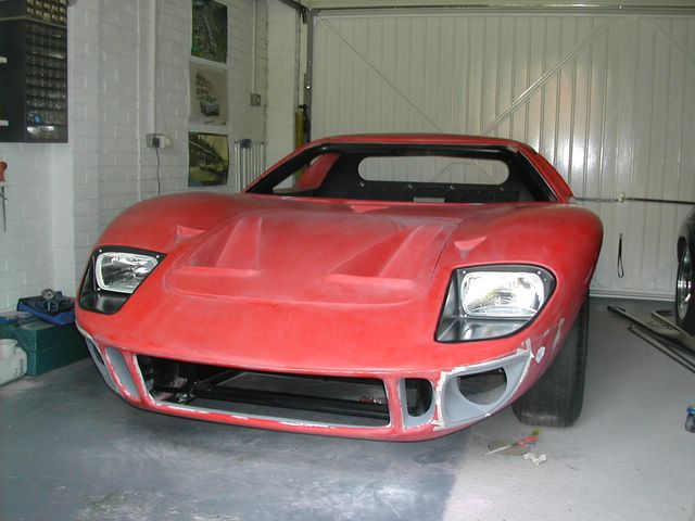

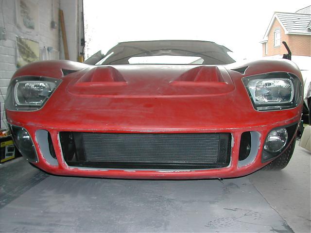

Headlights Fittted. She has Eyes !

Getting ready for the 5 3/4" spot lamps. I have the lamps, now just waiting for the mounting bowls to arrive in the post.

Nice work. I like what you've done with the ducts, it gives them a whole different appearance.
I was wondering where you got the buckets for the spot lamps, and if they are adjustable after being mounted?
Phil

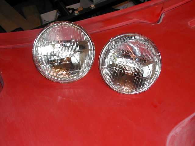

Hi Phil,
The spot lamps I've chosen are 5 3/4" headlamp units from a Triumph Vittesse. The old Triumph herald has square headlamps but the Vitesse (2.0 litre sportier version) came with 2 round lights. Normally the headlamps mount on the outside with a mounting ring and a chrome trim to secure it to the bowl which is on the inside. I intend to do away with the chrome trim and mount the lamp to the bowl all from the inside using spacers so that the lamp will just appear through the round cut out.
I will post pics once I'm done with it.
Lamps and bowls I ordered from Rimmer brothers in the U.K.
Parts Spares & Accessories for Triumph MG Rover Land Rover Discovery Freelander Defender Range Rover & Rover SD1
Here's a pic of the lamps.
Cheers Martin
Martin
Thanks for the info...I think the mounting you described, having the lamps behind and thru the opening, looks much better. I am definitely not a chrome lover anyway. Also since the plexi covers go over the opening it will be a nice look. I had tried for a while to find bowls for a smaller lamp (4 1/4") but nothing with adjustment was available as far as I could see. I think the bigger lamps look good anyway. Maybe a pair of H-4's would look good in there.
