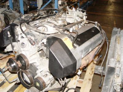

Wondering if anyone has any thoughts on a Mercedes 5.0 engine in a GT40... I have a Merceds 5.0ltr engine which is a very sweet running four cam engine, all aluminum, 4valve/cyl, compact, puts out 410hp/400ft/lbs at about 6,000, 50lbs lighter than SBF. With a custom inlet manifold, 48 Webers, appropriate cams and exhaust I suspect that 450/450 is about right. Crazy idea?

That looks like a really clean motor. I was toying with putting a 4.0l all aluminum Lexus motor in a '40, however in NA trim the Lexus lumps are only good for about 300-325 FWHP without changing cams. I think another litre of displacement would make for one very nice setup. You'll need to check the motor's dimensions to see how much different they are from the SBF, and how much trouble it will be to shoehorn it in. The DOHC configuration is always going to be taller and wider than the SBF cam-in-block design. Headers will be a real challenge, too, of course.....

Hi Pat, well, the goal isn't really to be different or difficult, rather, see if there's a better mouse trap delivering great HP, lighter weight, and smoother operation than a SBF of equiv displacement. The Merc engine is a much more developed engine putting out materially greater specific output per pound and per cubic inch than a 302 Ford...

Hi, yes, you may be right that sticking with the EFI and remapping the ignition is likely to produce equivalent hp to the webers. Plus, installation of webers will absolutely require reground cams and who knows what the best ramp/profile would be for those. Was really only thinking of the webers for visual appearances sake. Will need to think on it a bit more!
