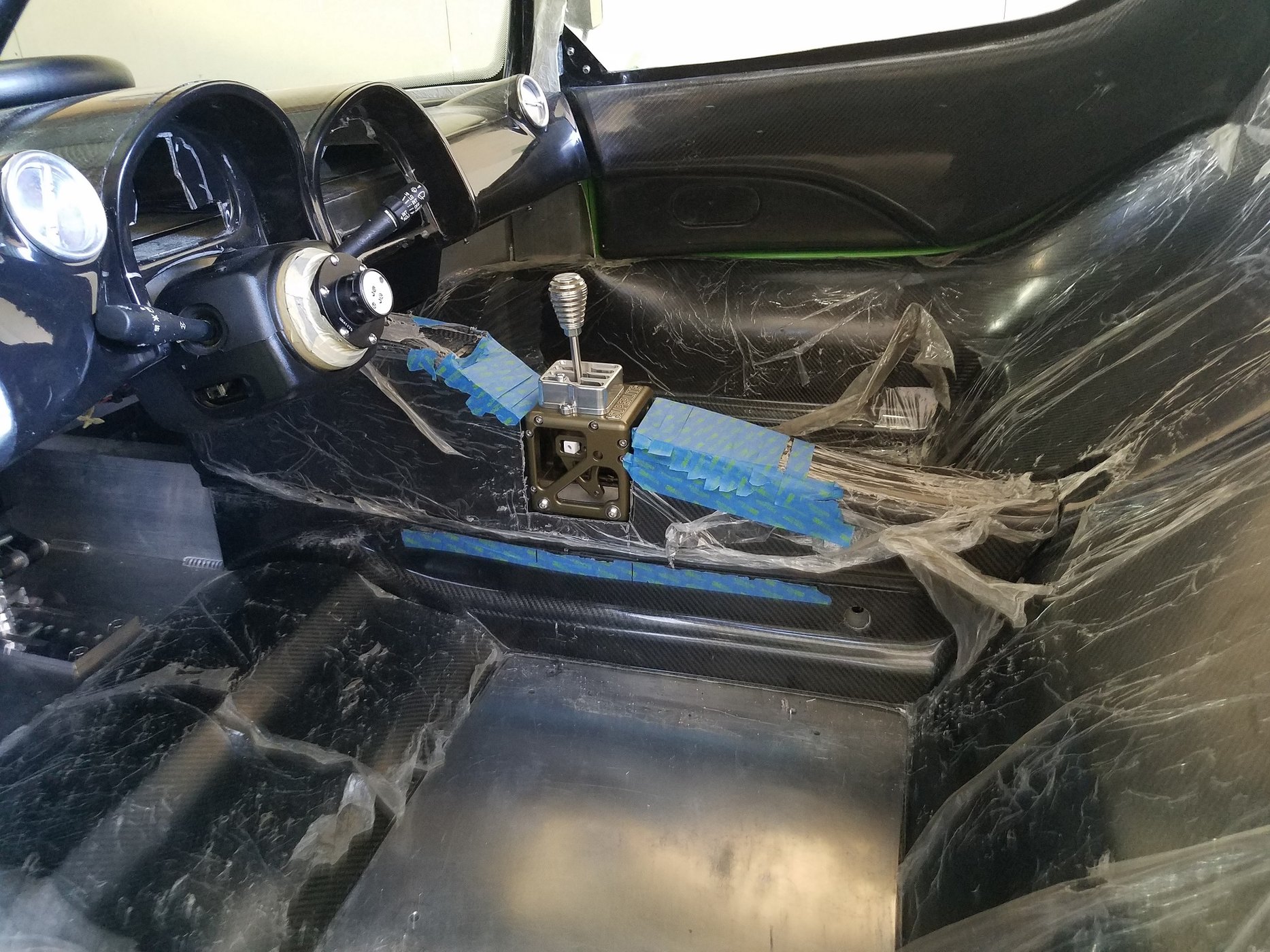

Progressing slowly and don't have a lot of pictures, but have managed to get the seats mounted, seat belt mounting brackets built and tacked together (will final weld at final assembly) and have started to integrate the new Superlite shifter into the console. I think the skeleton of the shifter is a work of art so want it to be visible in the final interior. Attached is the first cut at how it will fit in. Currently working some closeout panels to allow access to mount cables and to integrate into the gage panel.

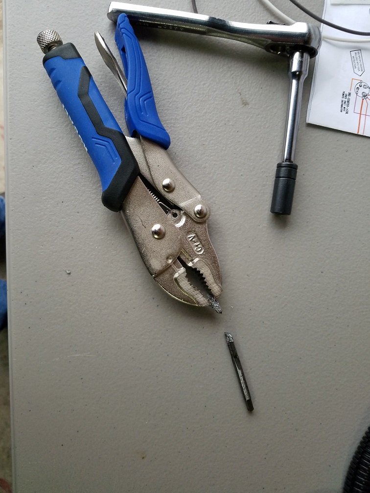

Oh, and my luck finally ran out on this aluminum beauty. At least I could be the pieces out!

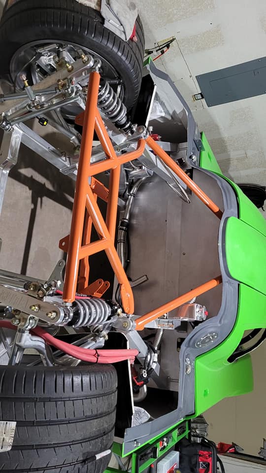

Once again moving the project, this time to Colorado. We picked up our "retirement" home last spring and will be spending more time there over the next few. The nice thing is acreage and a separate shop building I have set up for the project. Not huge shop, but room to move around and room to keep things organized. Will also be down the road from Cam so perhaps some inspiration and periodic advice (hint). While I tried to get started when I moved the car back to Florida in late 2019, COVID consumed me last year and spend much of the year away from Florida I was not able to get much done.
Over the past month here in Florida have gotten my bearings back on the project and made some project.
- aligned all 4 wheels to chassis, set caster/camber
- aligned body to wheels and bonnet/boot to spider
- finished most of the wiring, about all that is left is a few relays under the dash and the gage/switch hook ups
- AC hose and electric set up and run back to engine bay

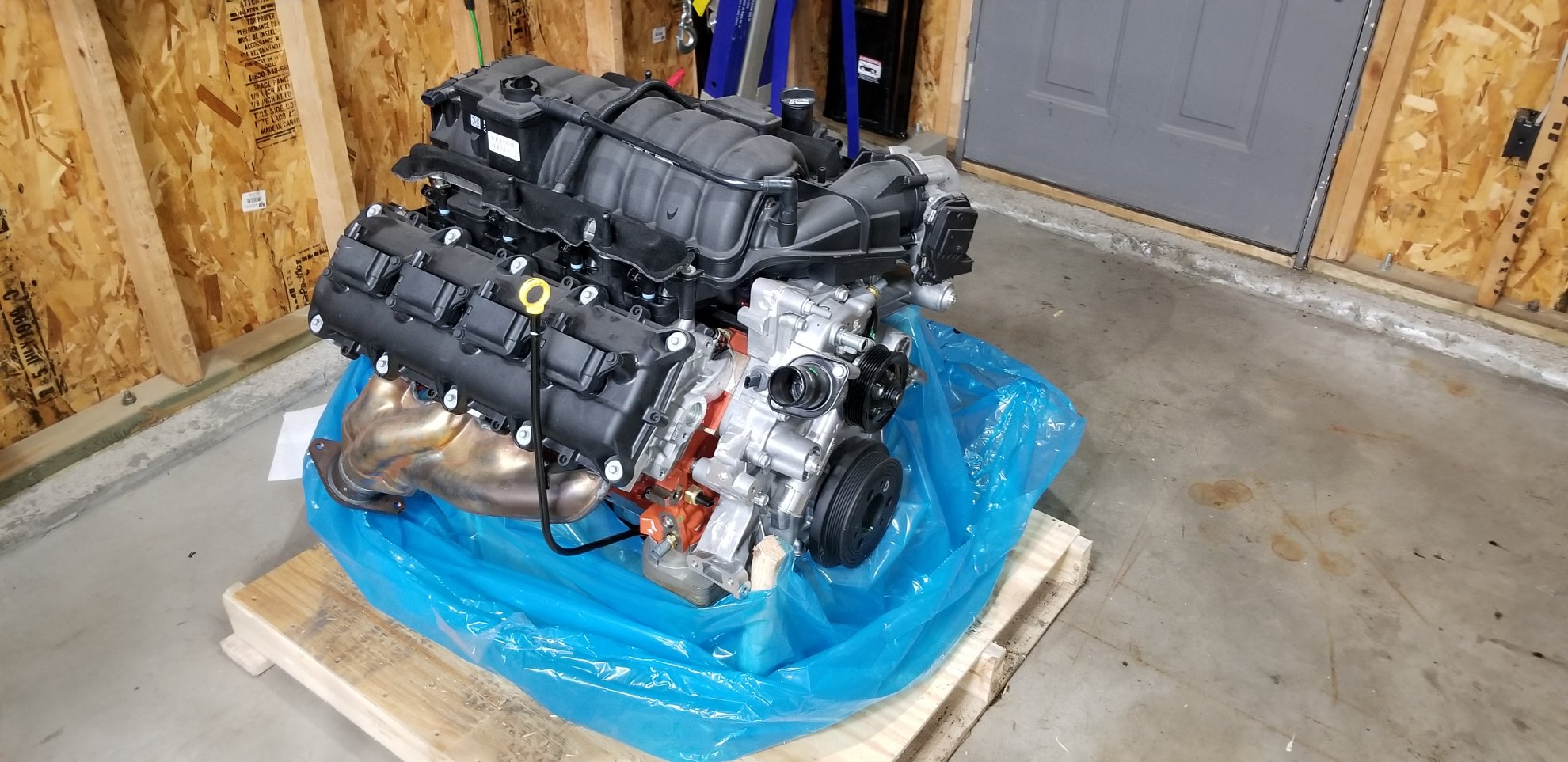

4 years and 2 days ago, I ordered my SL-C and on August 19, 2017 it arrived at my garage in Florida. Since then, have been detoured by work moving me to Texas for a few years, setting up a shop in Texas only to have it broken into and my equipment stolen, moving back to Florida and now to Colorado. What started to be a 2 years project has been turned into a life journey. But we are back up and running in Colorado and I have almost figured out everything I was doing in each of the starts and stops, and found most of the parts. Today was a big day with the motor finally arriving. The amazing thing is after clearing a spot for it in the shop yesterday in a short sleeve shirt, I awoke this morning to 6 inches of snow and more coming down. Undeterred, an amazing UPS Freight driver came up the hill in the snow (I live at 7500 feet and he came up from Denver), backed down my driveway and rolled the crate into the shop. Still much work to be done, but now feels like I am at least getting closer to finishing it now. More pictures to follow....

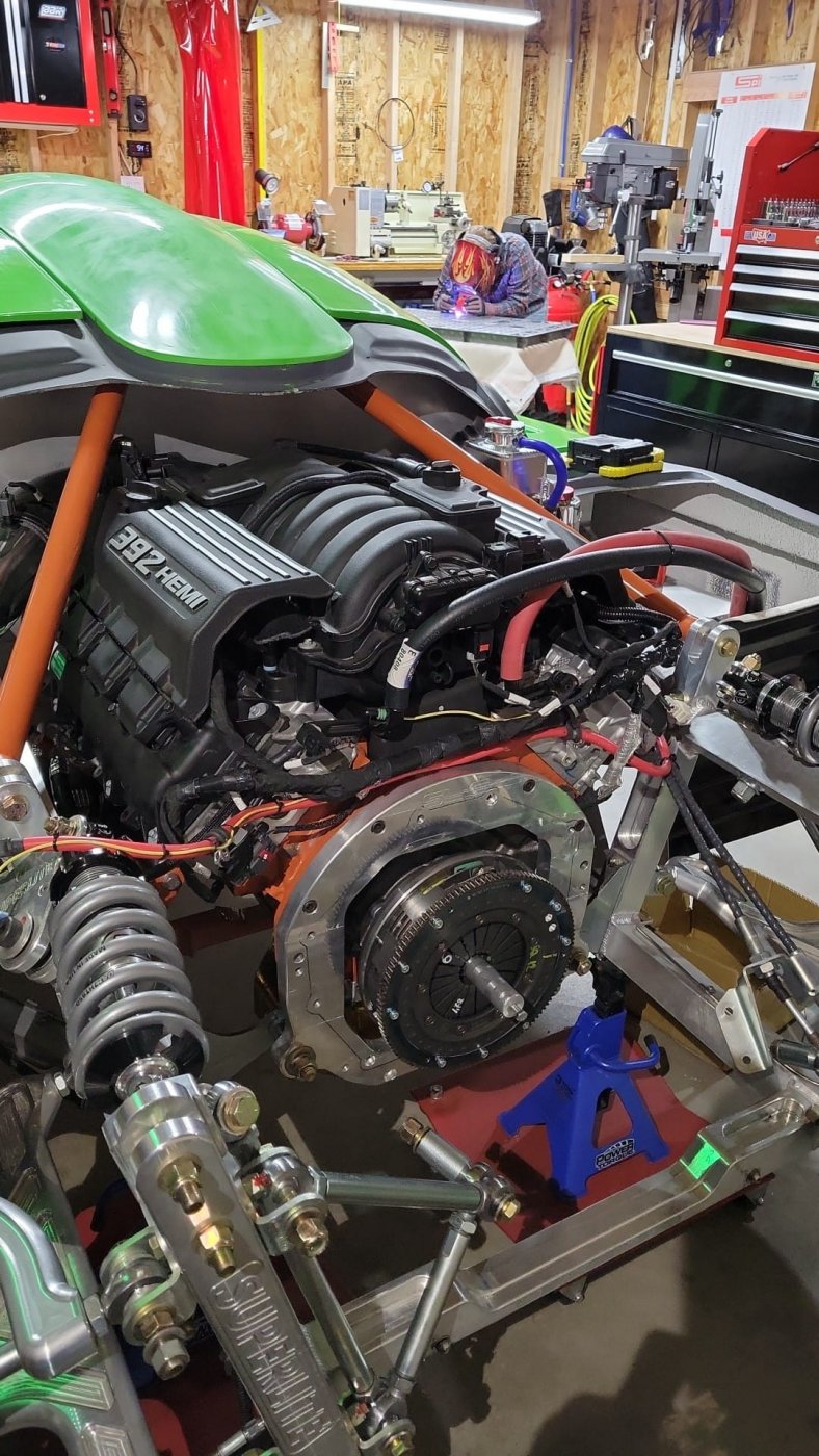

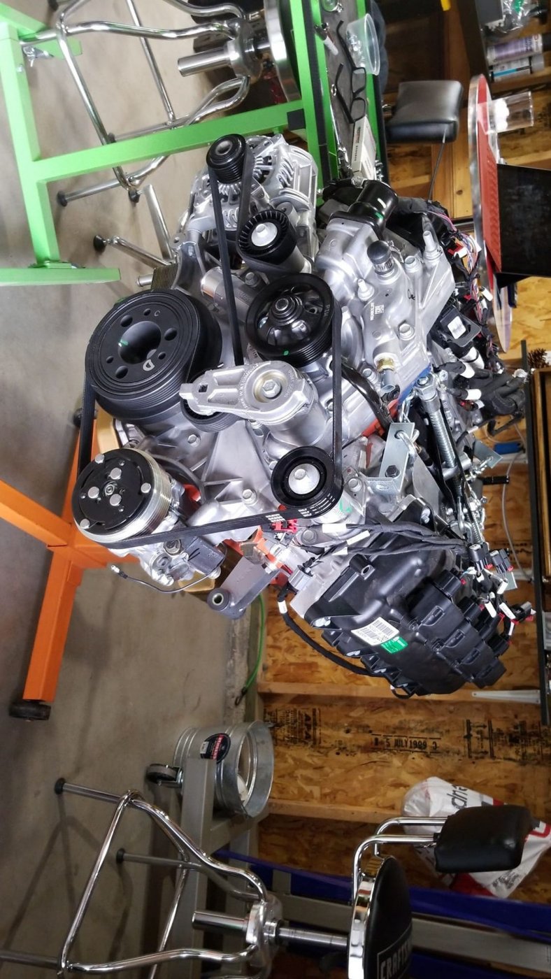

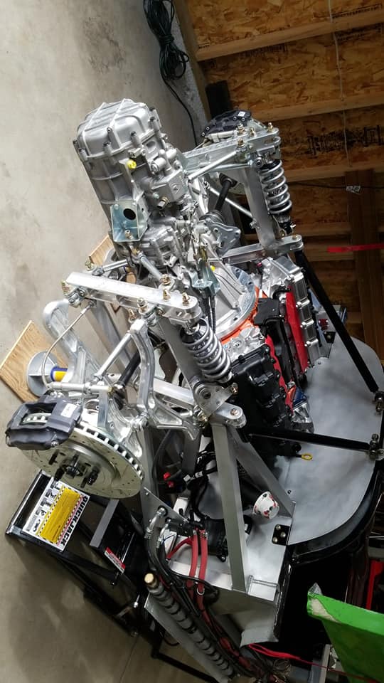

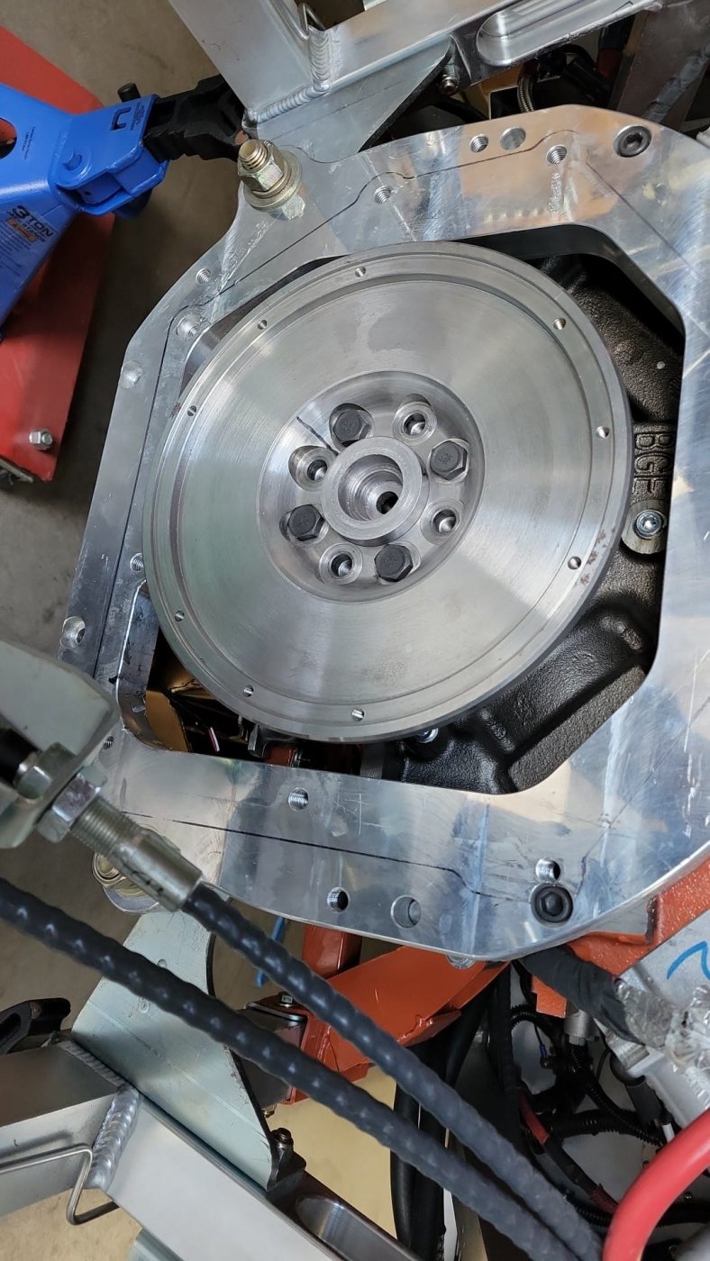

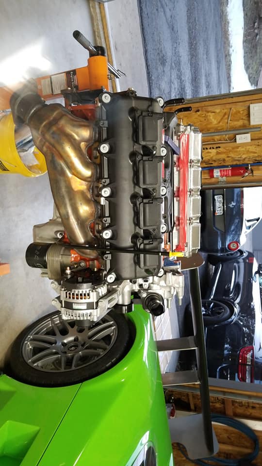

Trying to catch up on what has gone on over the past 8 months. Been posting on facebook but wanted to get some pics here to continue the build thread. This year has been about fitting the engine and mating it to the Graziano. To do that, needed to build engine mounts, spacers for transaxle mounts, adapter to install a pilot bearing in the Mopar crank that will mate to the Graziano and then trim everything to fit the engine into the back of the car. Lot of measuring and splitting of differences to get the motor to best fit the car. Also needed to build the AC compressor bracket and work all of the wiring for the engine as well as finished the wiring in the interior and got some of the wiring completed. As we stand on Thanksgiving morning, the engine is in, clutch installed and waiting on the orings to install the throw out bearing into the graziano. Once I have those, in goes the transaxle and we can build the exhaust. I have a set of headers cut up to clear the suspension in the back and will be welding those up soon those up soon.
Trying to catch up on what has gone on over the past 8 months. Been posting on facebook but wanted to get some pics here to continue the build thread. This year has been about fitting the engine and mating it to the Graziano. To do that, needed to build engine mounts, spacers for transaxle mounts, adapter to install a pilot bearing in the Mopar crank that will mate to the Graziano and then trim everything to fit the engine into the back of the car. Lot of measuring and splitting of differences to get the motor to best fit the car. Also needed to build the AC compressor bracket and work all of the wiring for the engine as well as finished the wiring in the interior and got some of the wiring completed. As we stand on Thanksgiving morning, the engine is in, clutch installed and waiting on the orings to install the throw out bearing into the graziano. Once I have those, in goes the transaxle and we can build the exhaust. I have a set of headers cut up to clear the suspension in the back and will be welding those up soon those up soon.View attachment 119124View attachment 119125View attachment 119126View attachment 119127View attachment 119128View attachment 119129View attachment 119130
