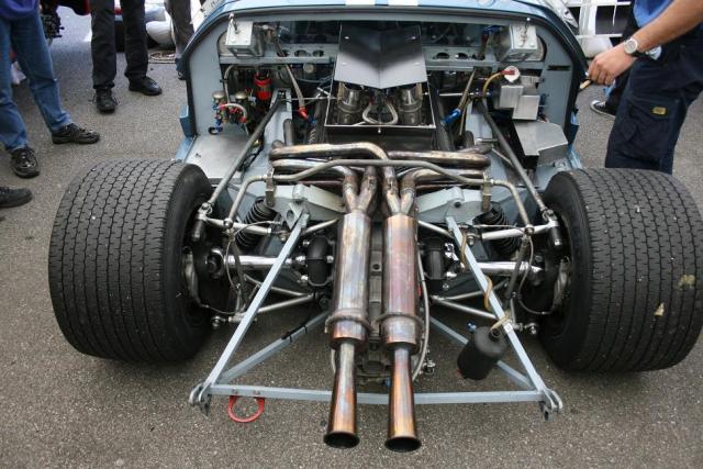

I was at Superformance HQ yesterday with a friend admiring the cars yet again. I was shown some parts including spare rear clips. I have a MKII, but I have always admired look of the rear clip without the snorkels. Here is a picture of 1047 at Amelia Island with the look I like:

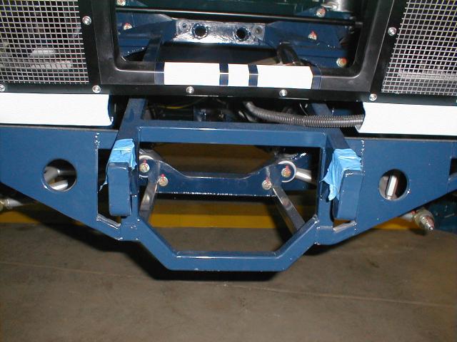

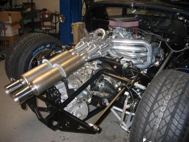

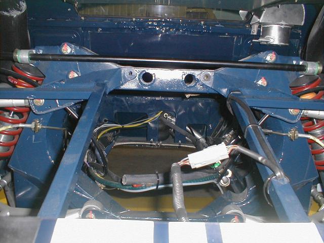

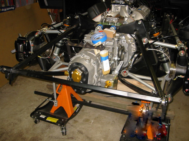

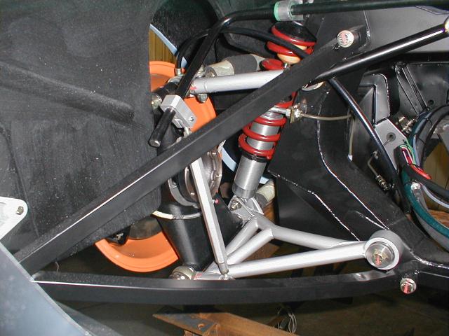

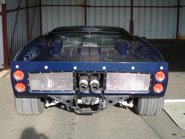

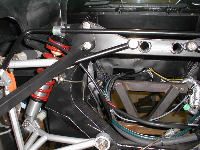

I have not done it, but the rear "afterstructures" on the MK I and MK II are diiferent. The MK II has the quick jacks inboard set about 10-12" apart where the MK Is are 30-34" apart. I have one of each here so I can post pictures if you wish. The tubular structures that bolt to the rear suspension carrier are also different per MK.
The front and rear clips will interchange otherwise, although the MK I sills are flared at the rear EXCEPT on the optional "narrow tail" MK I.

Here are pictures. Note the difference in the MK II (Dark blue tub) rear structure and the MK I (Black) tubs. As I measure it, the MK II oil cooler will clear the MK I rear clip so that is NOT an issue. To do the MK II to MK I "chango-presto" will only require the rear structure and the clip. Or vica-versa, whatever floats your boat.
See these photos of the two of the three cars I have in stock (Sorry, Ron, shamless commercial plug here)

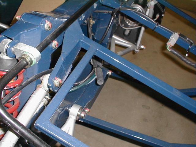

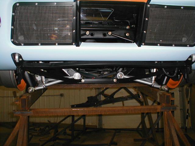

call me kooky, but when I look at the hinge points of the MKI and the MKII rear clam they look like that are at roughly the same location in space.
I think you are saying that that entire structure from the shock attach point back is different between the two, no? I am starting to see it in your pictures...

Mike,
The rear clip pivot points for the different Marks ARE the same, but the quick jack support structure is different and the Mk I tail is not notched to clear the narrower quick jack points of the MK II. That is the difference.

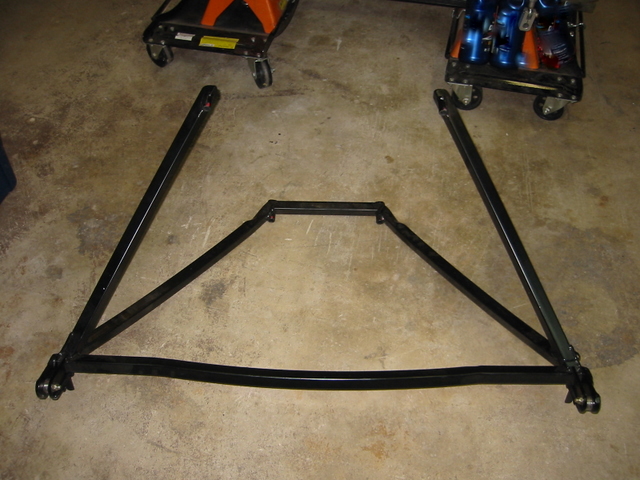

I see...I just saw this picture someone posted on another thread which helps me visualize the MKI.
Thanks Rick.

Mike, hope tese help.
