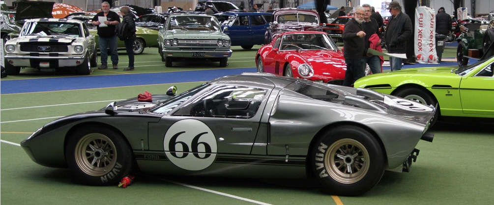

As far as I know, for a long time MKII bodies were not available from any kit manufacturer other than ERA. Holman and Moody also offered a MKII, but very few (if any) were sold. With Superformance coming on to the scene, and Tornado offering a MKII, MKIIs have become more common. Mine has a MKI front and MKII rear (both from Bill Hough) simply because I like that look. I believe at least one original MKI was produced in that configuration, and some early MKIIs (called MKIIa by some sources) also appeared with the MKI nose, after the failure of the "long nose" variants. Some of these had a triangular cut-out above and behind the front wheels.

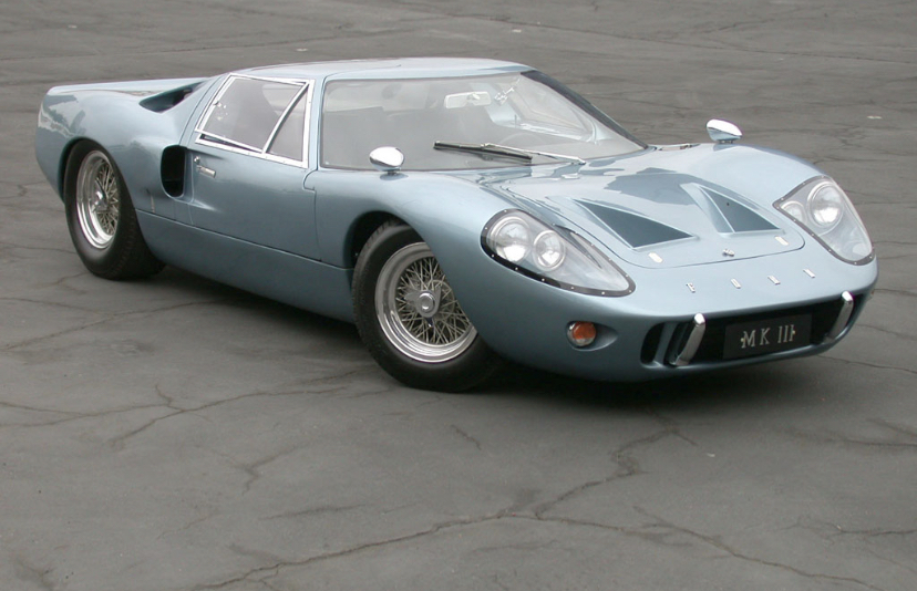

I like the 4 lights of the Mk3, but the Mk1 rear.
Also like the Mk3 side windows more than the small opening ones.

Also like the Mk3 side windows nore than the small opening ones.
So do I!!! It makes sense, in this day and age, to make things more ergonomic and a little window in that large opening doesn't quite fill the bill. The MKIII had roll-down windows, IIRC..it was meant to be a road car, not a race car.

Hey Jim - good to see you are still around. Sparro did fit some to a MK3. But was that his creation or an imposter?
Been pestering Andy for years to offer a Gulf rear clip with a MK3 front clip. I know the front clip is longer but it could be done. Perhaps just the MK3 headlight “buckets” grafted to a standard MK1 front clip.
