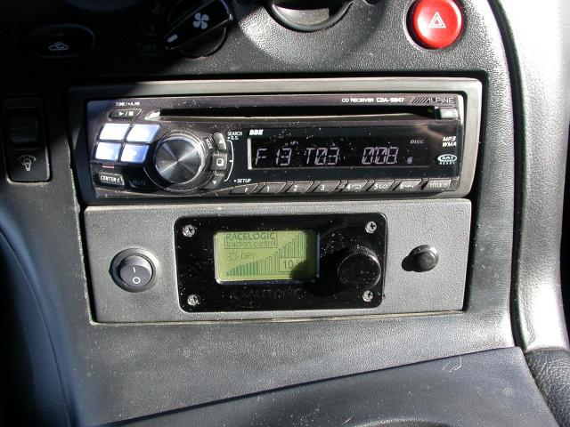

Definately looking forward to the progress of this build. Looks like no $$$ spared. Just a thought but while your at it why don't you add a 4 channel ABS system. It'll make the car safer for "street use" and allow you to piggyback the Racelogic onto the wheel speed sensors. If not you'll have to fab some bracketry to get the wheel speed signal.

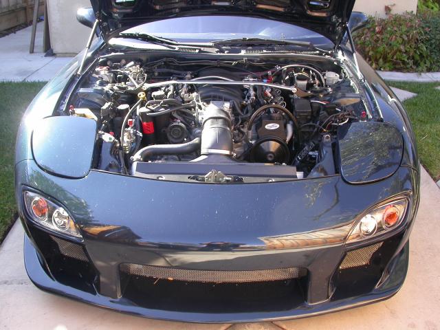

I'll second the comments that the Racelogic isn't the easiest system to install. A couple years ago a friend and I put one in my LS7 powered RX7. It was a two day process but back then we had to hardwire it into the injector harness and ABS system. Honestly I don't think I could've done it by myself. That pre-made adaptor harness would've made things alot easier. It turned out nice and works well. Honestly, it makes the car faster and takes away the need to "pedal" the car out of the hole. Set it to 10% slip and stand on it. All you need to do is point it straight and shift.
