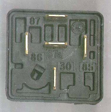

most relays run with the Bosch system
30 is from power supply fused (battery)
87 -87a is to lights
86 is a ground
85 is a power supply from your switch.
85-86 is to an electro magnet, it requires a ground and power to pull it down.
when it does it contacts the term across 30 and 87-87a, main power supply to lights is delivered.
your relays may have a pic printed on them.
I always disect the relat into 2 sections ,high current 30-87-87a /low current 85-86
You can also supply power to term 85 and ground term 86 through the switch on the dash but i dont think you have wired it that way
My guess you need a ground on either term 85 or 86 as you have already pointed out.
you need a wire from you switch going to either 85-86,what ever is not being used by the gound wire.
power supply on 30, lights on 87-87a
Jim
Quite right Jim, but don't forget 87a is normally closed & 87 is normally open (ie trigger coil off). With the trigger coil powered they reverse positions.
Thus a single 5 pin relay could be used to switch between high & low beam for instance or a 5 pin relay like this can be used as a standard 4 pin by ignoring 87a and leaving it disconected.
Brett seems to have a pair of 4 pin relays & working backwards from the terminal numbers as Jim suggests should be helpful. As long as the pin connectors are in the same positions on the loom & relays, be careful !
Had closer look at your pic
I am assuming that your top wire blue/white trace is from your dash switch and it is 12v supply, then you need to remove blue loop wire and make that a ground.
Steve yes bosch do have swithing relays as well as 5pin duel supply.
But as you stated brett has 4 pin so he should be ok as term # will still be ok .
Jim
