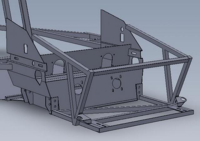

Some new things happening. Also you get to see a bare naked CAV GT monocoque up close and personal. These are really strong cars.
What we have here is the new rad cradle, this differs from the stock CAV in many ways. The Series 100 cars had no upper cross tube, lower diagonal tube or tubes connecting the top of the rad support tubes up to the cowl. Basically the stainless cladding was tying the rad cradle to the cowl, with just two mounting bolts going sideways into the lower front suspension mount area and a few pop rivets.
A high ramp angle driveway or bump could bend the cradle and or distort the stainless cladding resulting in misalignment, squeaks, possible paint/composite damage.
The post 100 cars have the top connecting tubes and the whole affair is weldled onto the chassis, big improvement in strength.
This is the third one we've made, but the first from part files generated in CAD. It also allows us to make the new rad cradle fit with ANY generation CAV GT as we have the data. It is a bolt on part, easily replaced or removed for repair.
There are a few bits coming in from laser cutting this week to finish it up. I'll post the finished part asap.
As a sidebar, the new rad cradle will be available as a service replacement part as Autofutura no longer makes the pre 100 rad cradle, FYI.

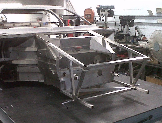

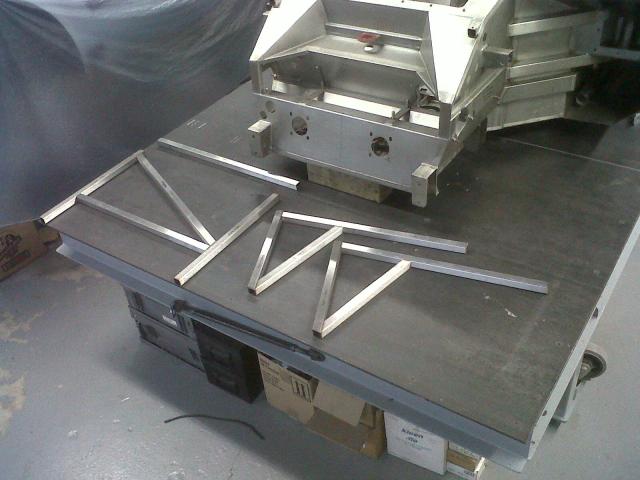

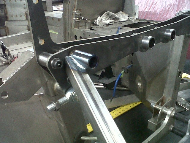

Ian Clark
We've been working on a few sub systems for this car. It will receive all the latest greatest updates, mods and spy gear (ooops wasn't supposed to say that, sorry M.)
The pics below show our ZF Transaxle Bracket prior to tig welding with the new rear body subframe under construction. This subframe will unbolt and leave all the suspension on the car.
Also the weight and torque load of the drivetrain is carried by the transaxle bracket and motor mounts, no trans mounts on the subframe with ZF or Quaife applications.
We've already done one on our Gulf car with the quick lift tongues so it was a natural choice. This time we're going with the roll off pivot / mount instead of a pivot bolt. It's less work to R&R the rear clip should the occasion arise. More pics as the parts come in from water jet and time permits.

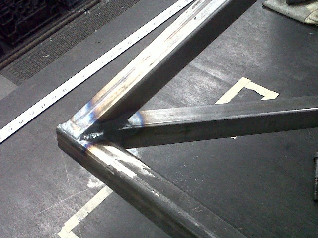

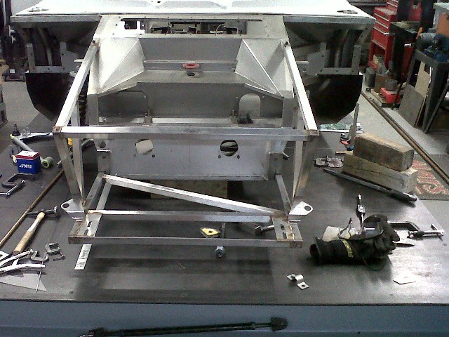

Ian Clark
This is the front subframe fully tig welded, with lower triangulation tube, rad mount pockets and front hinge slots. This subframe also unbolts from the chassis in case of replacement, no need to zip disc off the old part and weld on new. More pics to follow... Cheers
